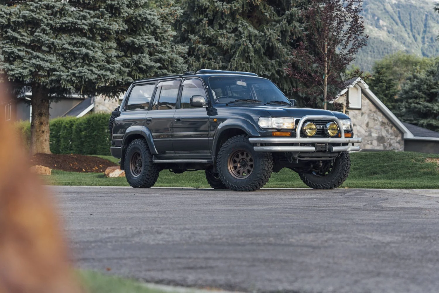

After selling my old Tacoma I knew I wanted an 80 series Land Cruiser. I searched the American market for a couple months before researching the diesel models and deciding that the benefits of an imported cruiser outweighed the disadvantages. I picked up the truck on June 18th 2020 after being imported by Steve with Land Cruisers Direct. The truck had 157,000km on it and has all the factory options (swingout, fridge console, winch, headlight washers, altimeter/compass, etc.). Here is the first pictures I took of the truck, just minutes after leaving Steve's shop. Before picking up the truck I had a bit of work done to the truck as well:

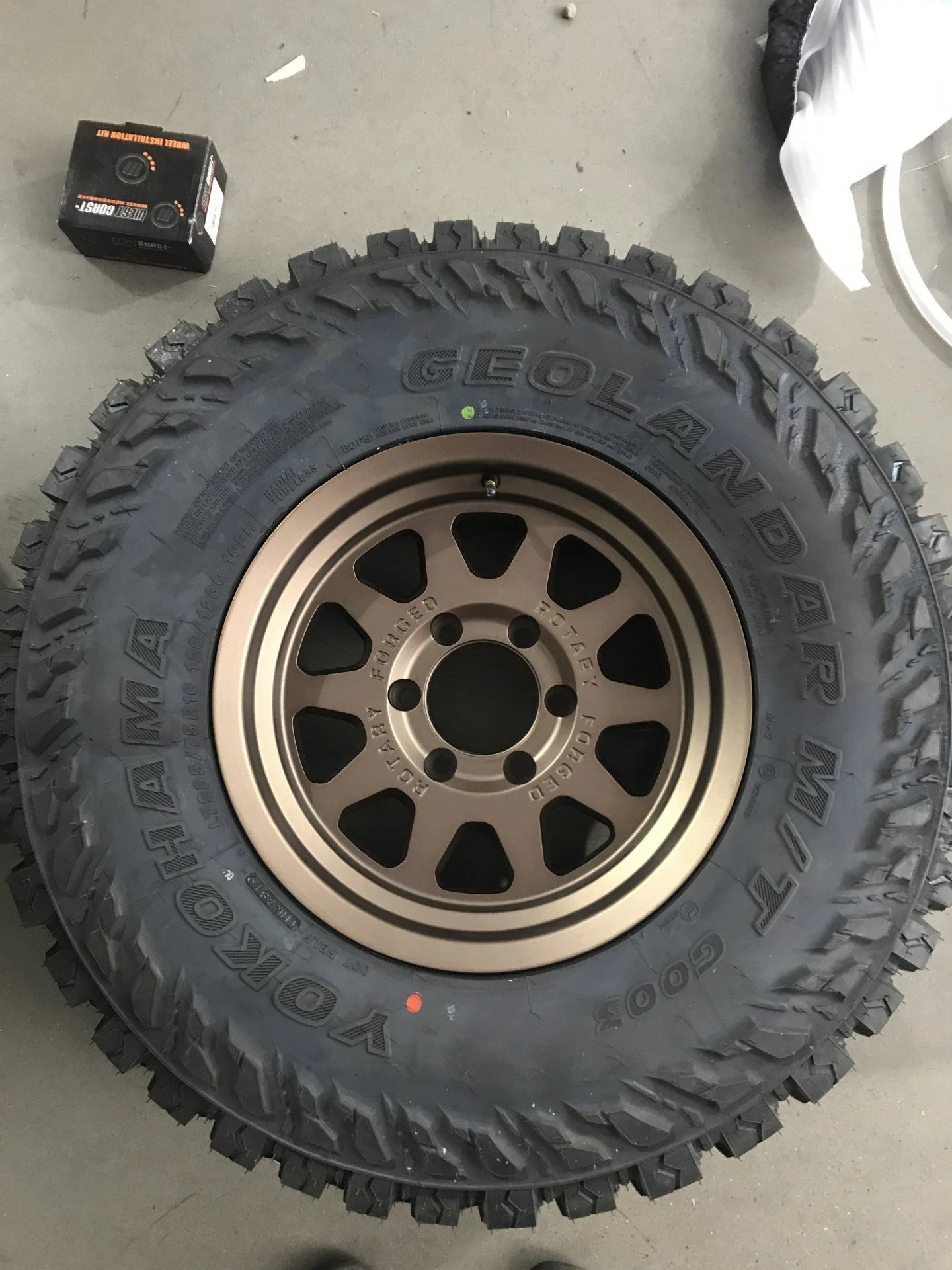

The first step after we picked up the cruiser was to get the new wheels and tires installed. I opted to run a set of 287/75 16 Yokohama M/T G003 paired with some Black Rhino Stadium wheels. I ran the same tire on my Tacoma and loved them, they have low road noise for an M/T and have great traction off road!
In concept it was easy - drop the truck off at Discount Tire, eat lunch, and come back to pick it up and drive to the rental house for the night. Turns out though that the BR wheel has a center bore that fits the cruisers (112.1), but it tapers in to accommodate for a center cap. Being that I was in SLC and I knew of no local companies I started to call around and see if any wheel repair shops or machine shops could sneak me in and bore the wheels out. I got beyond lucky and was able to talk with Kory Watkins (who owns D.R.P. Machine in West Jordan, Utah). He was able to get the wheels boreand I was able to test fit in the parking lot. I cannot recommend his shop enough, they were all super nice and he only charged me $100 ($140 with a tip) and I was on the road!
Wheels - Black Rhino Stadium (Bronze) in a -10 offset in a 16"
Tires - LT285 /75 R16 126Q E1 Yokohama M/T G003
View attachment 2407865View attachment 2407888
I was moments away from ordering these rims for my 62 when I stumbled across your thread. Seems a safe bet that, like you, I would need the taper bored to clear my 62's hubs (106mm hub bore for a 62).
With the wheels machined, are you able to use hub-centric rings? If not, how well do they hold their balance on a removal/remount?
Thanks for any insight you have!
