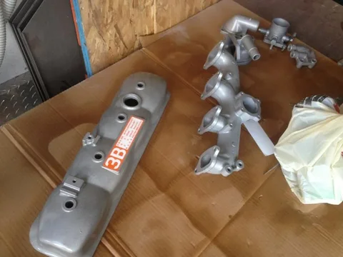

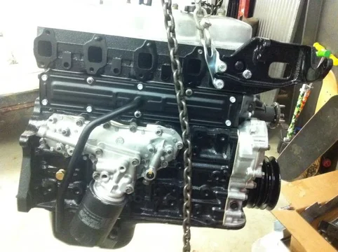

To paint or not to paint the winch? I was thinking of matching it to the color used on the mirror arms, which is close to the grey used on the newer winches. Other option is just to clear coat it.
clear coat is what I did for all of my aluminum engine bits after a nice even bead blasting and I like the way they turned out.
First two pics are parts of the engine in my 42 when I did the head gasket last summer. The third is from the engine I originally built for my 45 but is now going into the 42 with a new H55f and lower gears in the t-case.
