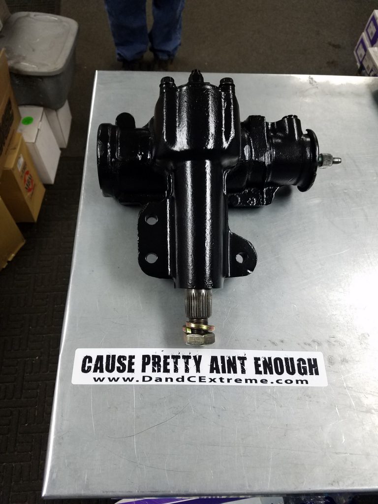

West Texas Off-road. They did a great job with quick turnaround on my mini truck ps box.
west texas offroad odessa tx - Google Search
That's the wrong West Texas Offroad. I've used WTOR and they are great. Quick turn around and will upgrade an 80 box with the 105 sector shaft if you supply it.
