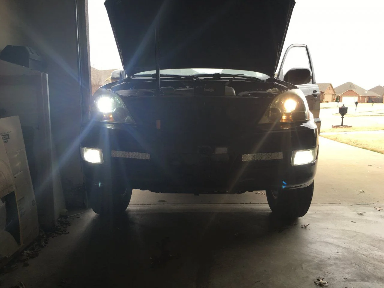

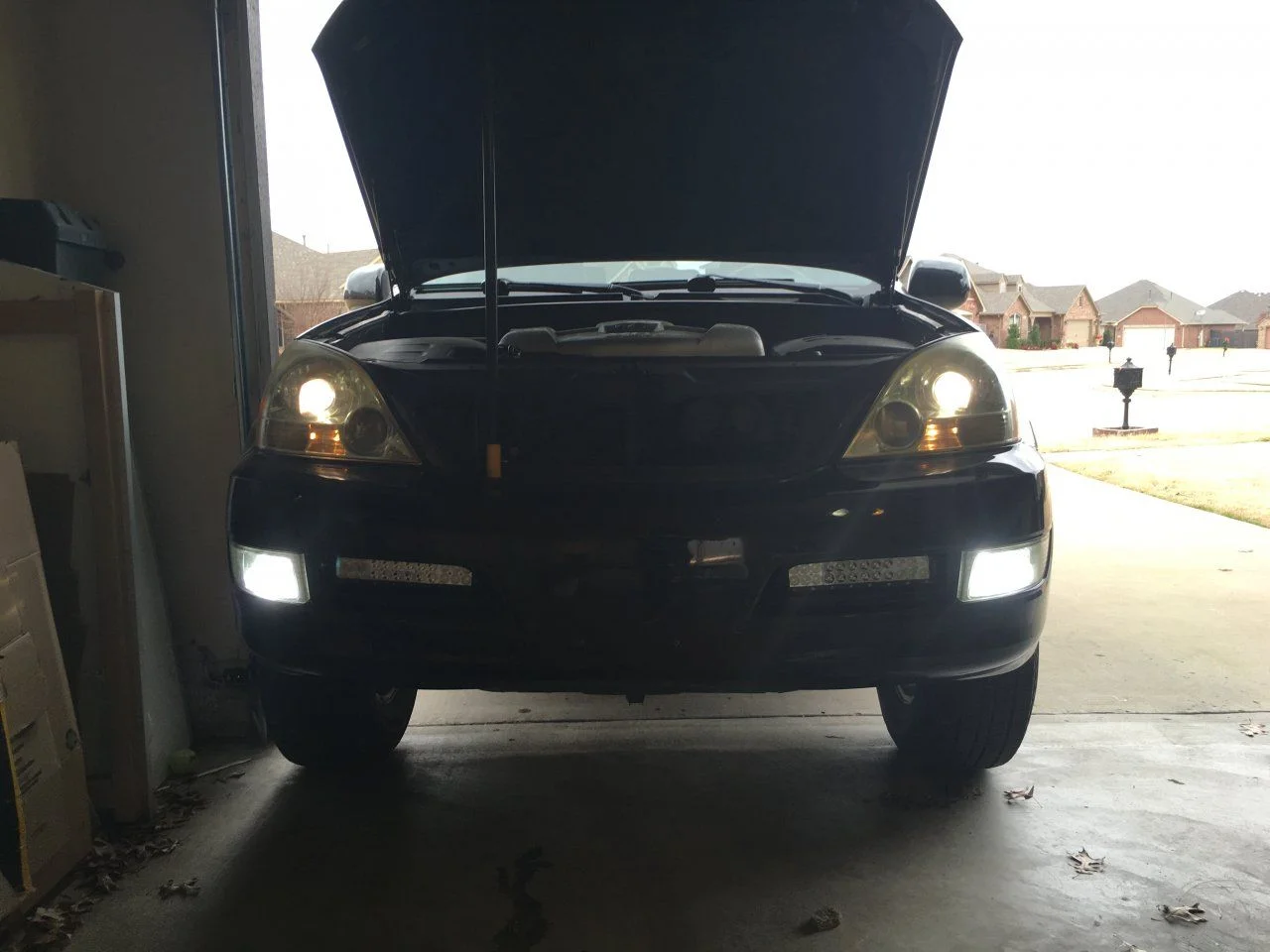

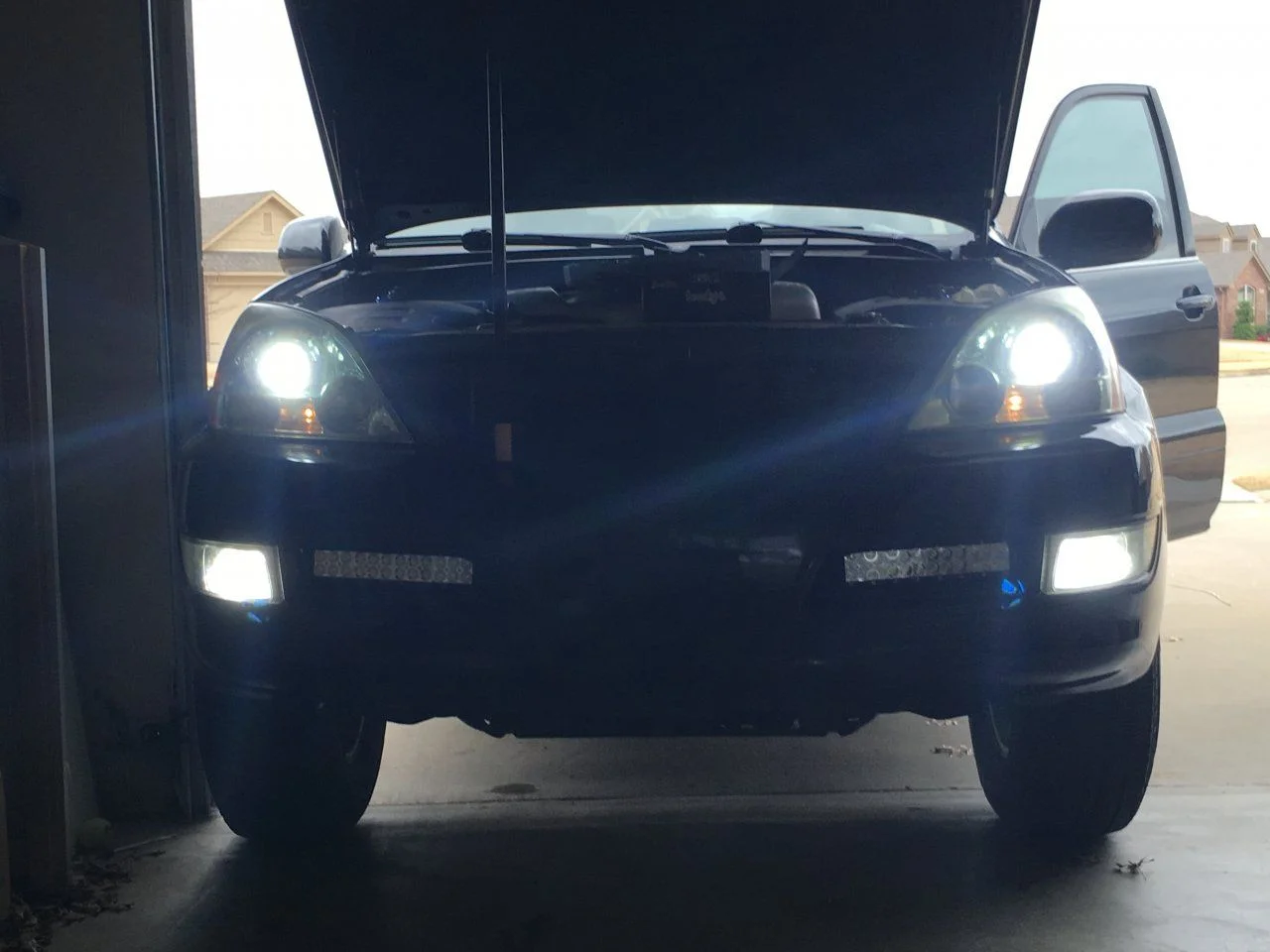

The LED headlights will be here Saturday or Monday and will post pics once they are installed.
Well I must say first impressions are very nice looking LEDS. The crisp color is what I have been looking for. I will take some time at night this week to adjust them. The kit seems well made and the plug in play systems was great. I did have to move the battery out of the way to install the DS head light but was able to tighten the battery back down with no problems. I will let you know if there are any malfunctions but over all very happy.
adjusting the LEDs has helped but the throw pattern is not as far down the road as I would have hoped. With all that being said the cut off line from the halogen projectors is much cleaner and crisp and the light is much whiter than any of the 5000k or 6000k HID systems I have had in the past. I am happy with them over all. Also knowing that I have 7200lm LED bars to throw anytime I need them is a great comfort.
Update,
LED head lights are very nice! I readjusted the headlights and they are just as good as my wife’s 2010 gx460. They even have a pretty sharp cut off line. Very happy.
