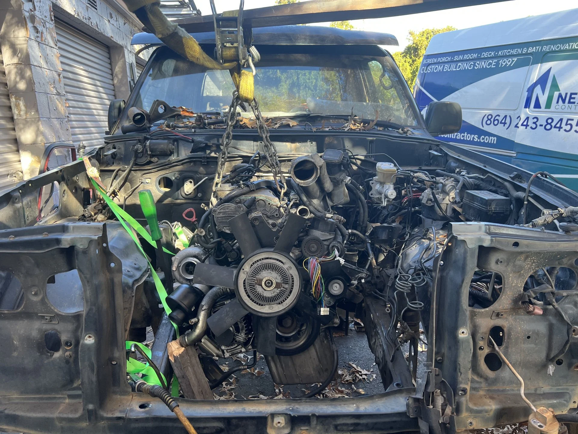

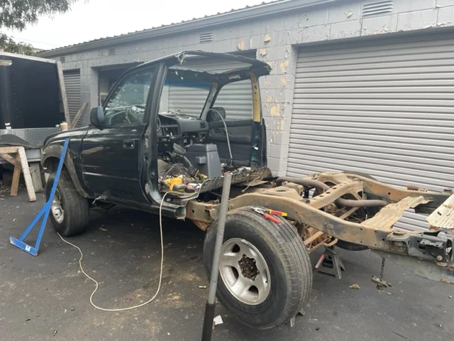

Well underway on my currently Un-named (Taking Suggestions) next project and due to it's unique nature I figured I would start a thread as I am sure I will run into some obstacles that will need answering.

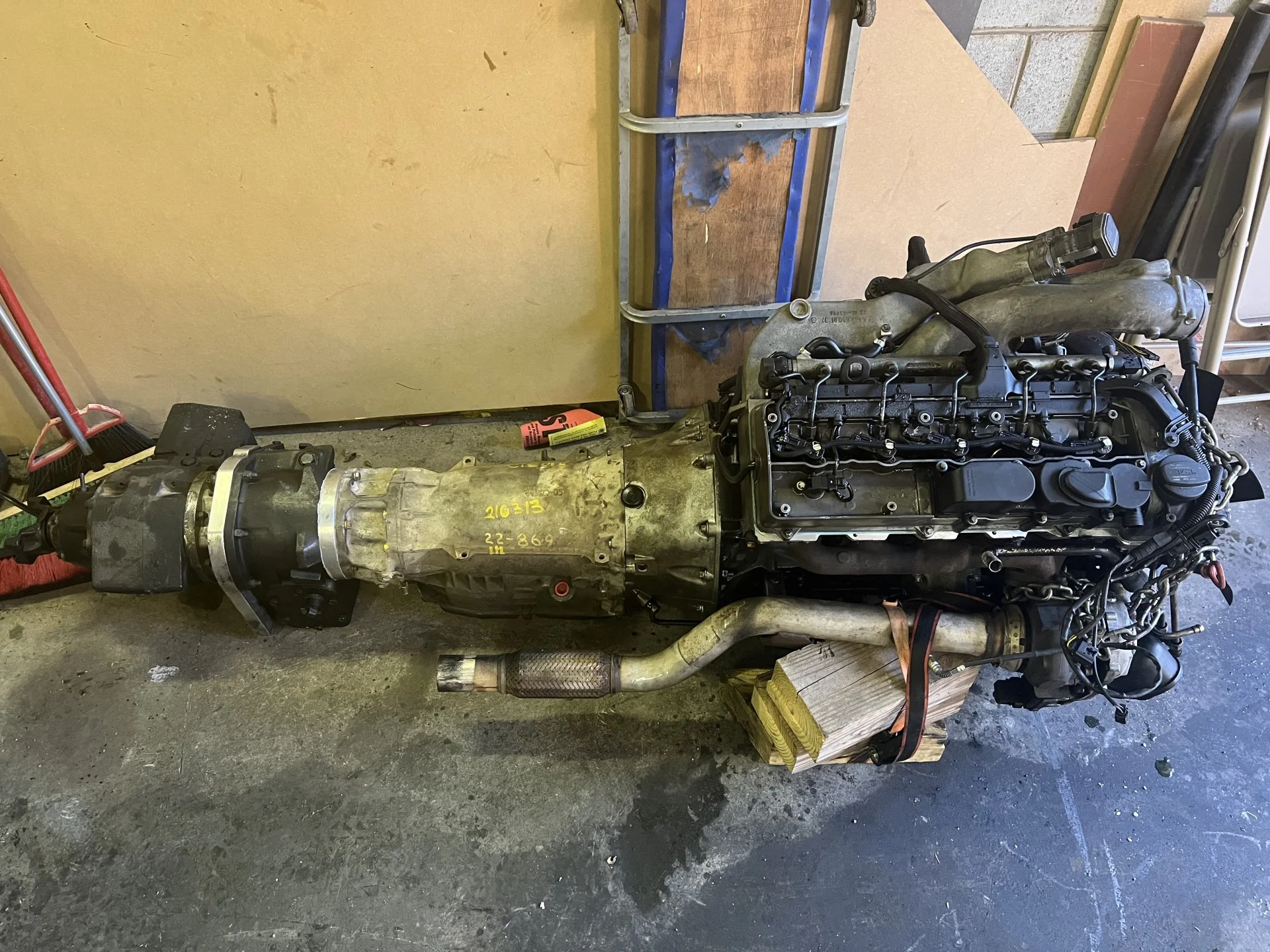

Donor truck is a 1994 FJ80 body and chassis.
Donor engine 2005 Freightliner Spinter OM647 inline 5 turbo diesel
Donor transmission is 2 part.

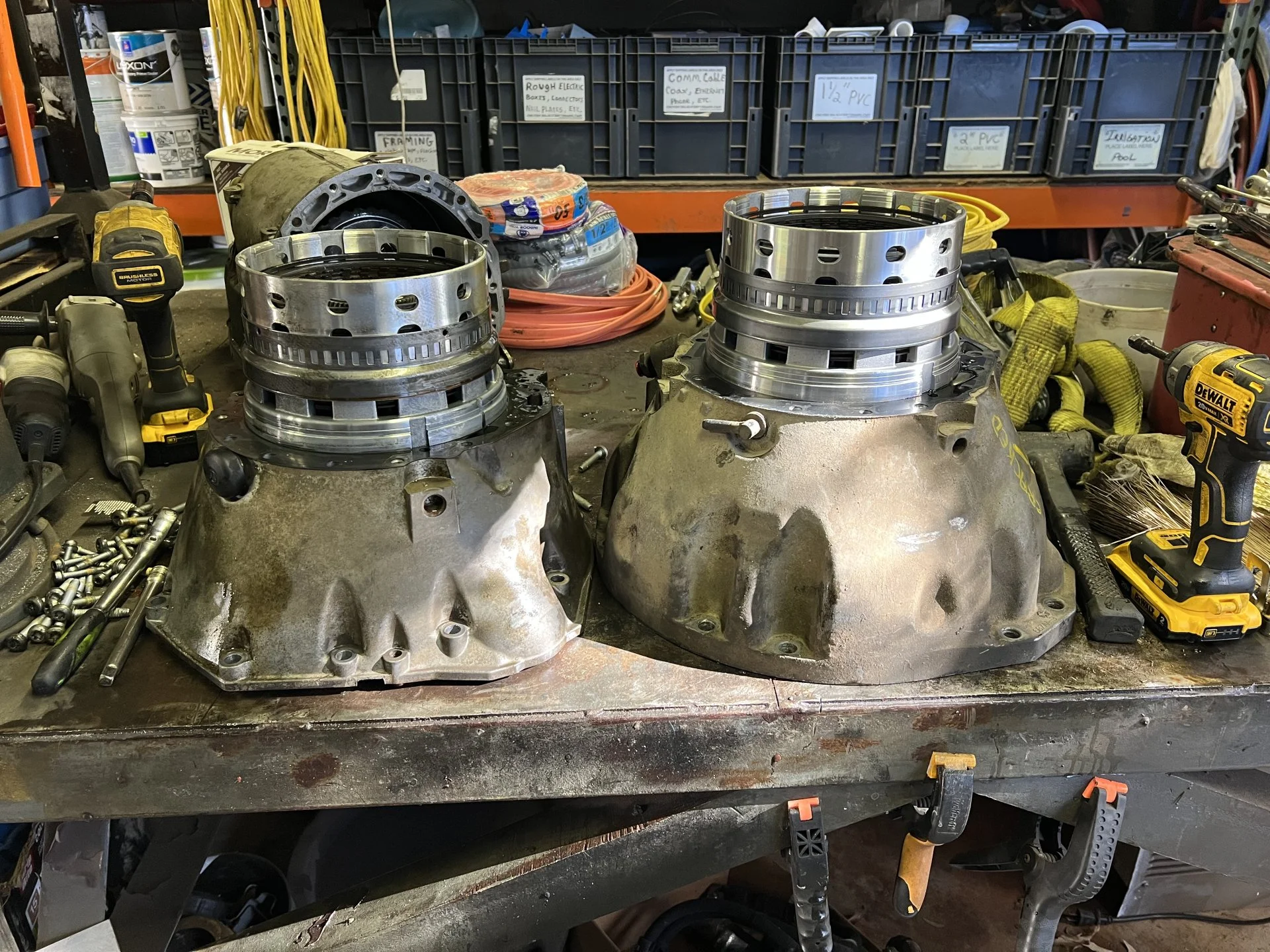

Part 1: Bellhousing and torque converter are from the 2005 Sprinter which has the 2WD Mercedes 5G-Tronic transmission also know as the W5A 580 , 722.6 and the NAG1.
Part 2: The transmission itself is a NAG1 from a 2015 Jeep Rubicon.
Both vehicles use the same transmission except the case casting for the 4WD version has a different tail housing as it allows the 4WD extension housing and coupler to bolt up the transfer case. The internal components are the same I just need to bolt the bell housing and converter from the Sprinter van to the Jeep transmission.

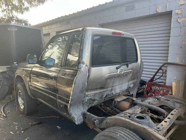

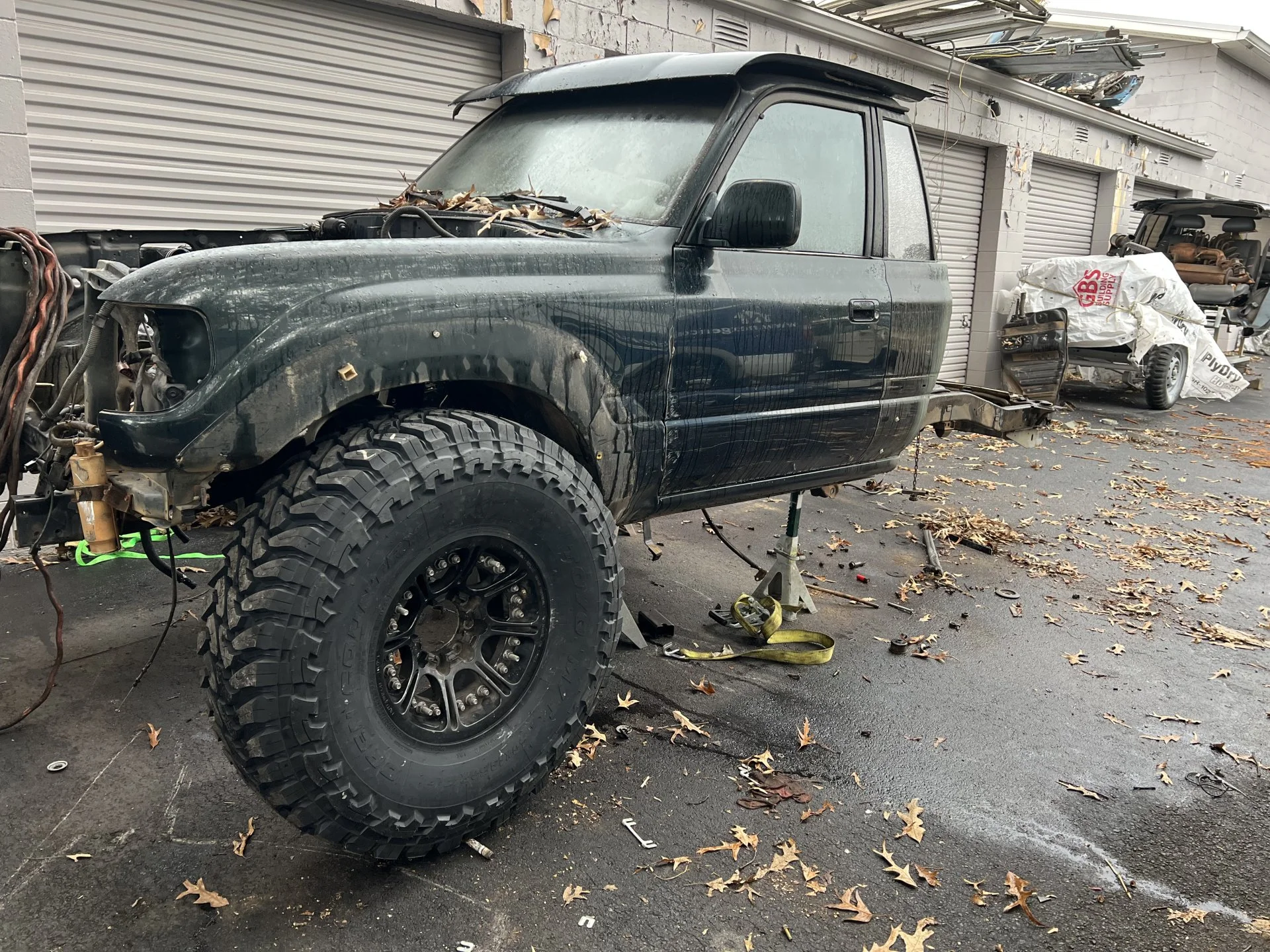

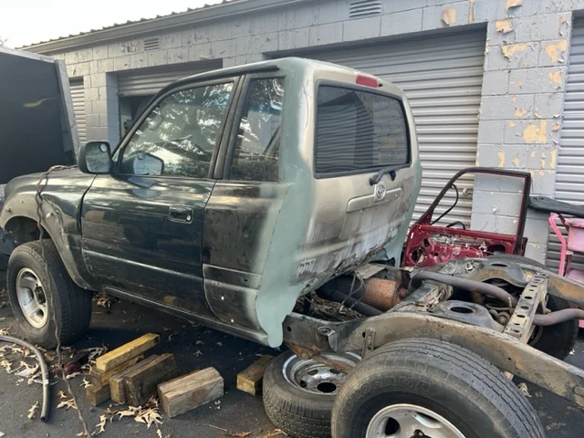

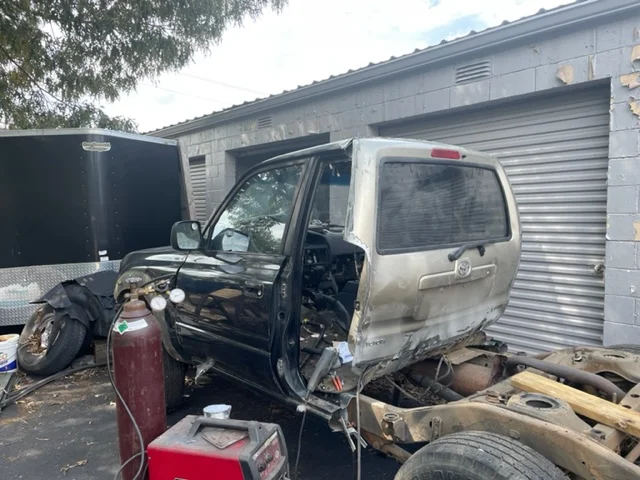

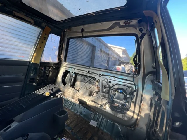

Pretty simple cut and separation once seats, carpet and gas tank are removed.
Had a banged up tailgate from my 2003 4Runner laying around which fit around the sides and top perfectly. Will be nice to have roll down window.
Metal patches made using a cardboard template
Lots of seat room with the angle of tailgate
Patching done ready for Raptor Liner

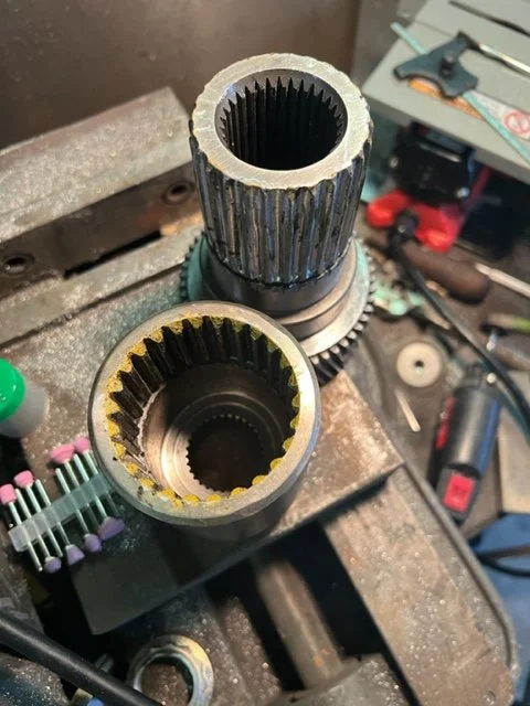

After lots of searching and talking to machine shops, Advance Adapters and everyone else I could think of including @GLTHFJ60 who helped with some machining and metallurgy concerns, I came up with this process which I determined would be the most efficient way to produce the pieces I need as no one makes them.

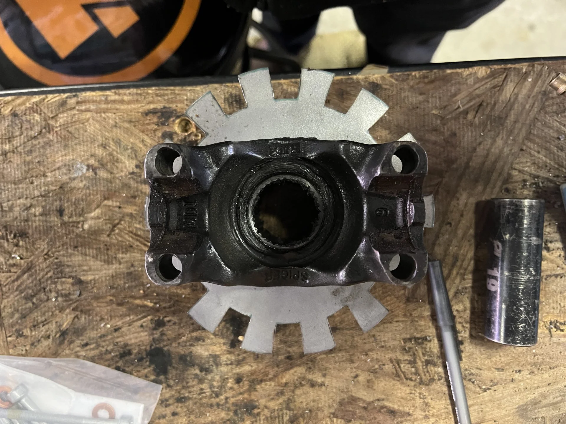

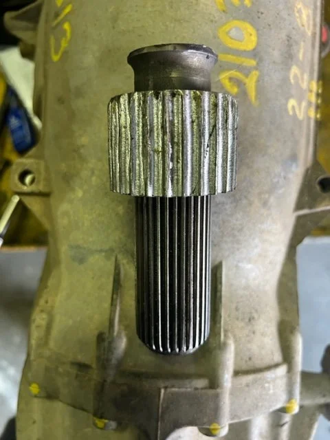

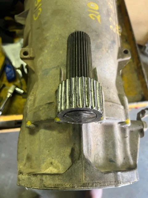

I used an input gear from a stock 2001 Ford Excursion NV273F transfer case which has an outside diameter that is exactly the same size as the inside diameter of the Jeep NAG1 output coupler at the bottom of the couplers spline grooves. I was able to use a paint pen and paint all the spline tips of the coupler and insert the tip of the ford input gear to mark the end of it. Once marked I used a 3" cutoff wheel on a die grinder to carefully cut in the first 1/4" of the male splines into the ford input gear to verify it would work. After verification of fit I used a small sliding square to draw spline cut lines the rest of the way back to to the first shoulder on the input gear. I then roughed in the splines carefully with the 3" cutoff wheel. Once roughed in I used a small tapered carbide cutting bit to work down the spline channels to V them to the approximate profile of the couplers grooves. This process was mentally a little daunting at first as I thought it would take forever but I actually only took about 4 hours or so of grinding and worked great because I didn't have to weld anything and worry about heating the metal up to the point of messing with its tempering.
Section of the 31 spline ford input gear cut off and inserted into the Jeep output coupler. Also kept the rest of the original ford input which still has some of the new splines cut into it so I have a pattern which I figured if this reducer/couple ever fails I may be able to have the extra piece scanned and have once water jetted as a backup.

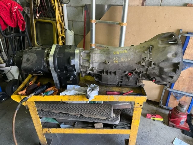

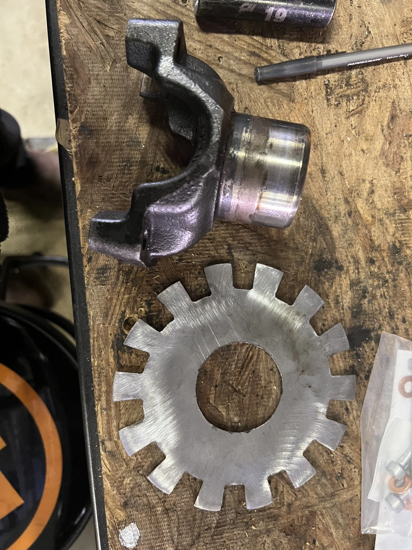

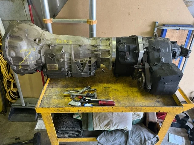

Bought a Ford C6 transmission main shaft on Ebay and cut the tail end output section off to use as a stub shaft to couple the NAG1 and the NP203/205 together.
The C6 spline length was perfect and will only be able to float front to back about 1/8"

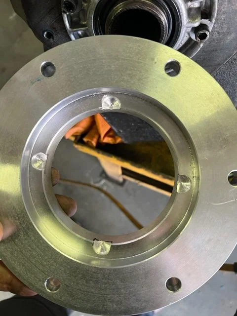

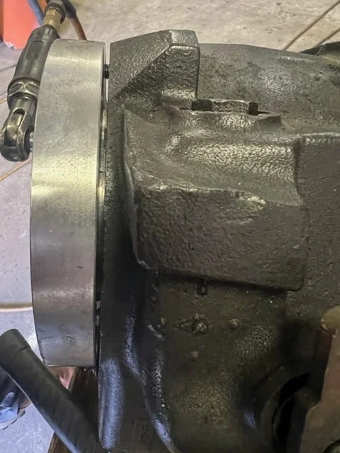

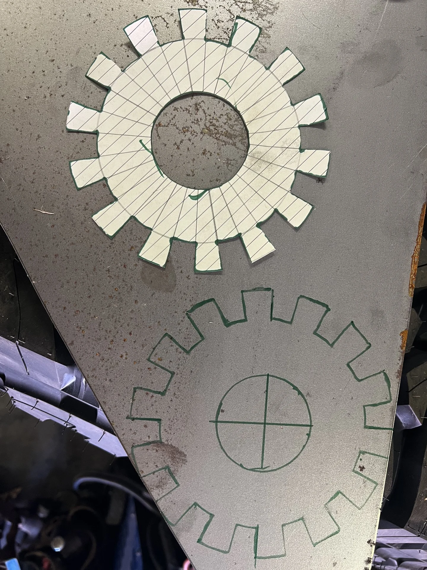

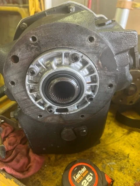

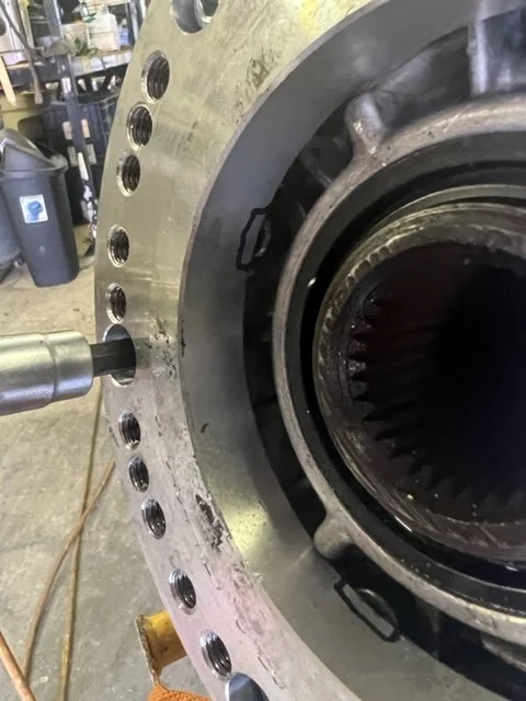

I bought a 1" Atlas Case spacer from Advance Adapters which is almost a perfect fit. I had to space the Tcase because the NP203 input gear & retainer sticks out beyond the case about 7/8" and the Jeep NAG1 output coupler is about flush to the back of the transmission case.
I had to drill recessed clearance holes for the socket cap screws that hold the NP203 input retainer on.
Gap from the retainer screws.

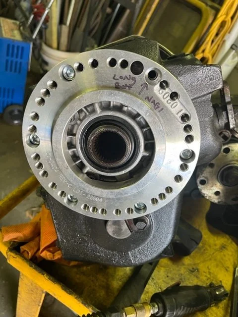

Adapter bolted up. One of the holes of the NAG1 lines up with the NP203 case so I will use a longer bolt in that hole. Also Advace Adapter part number for this spacer is AS-0404
All bolted together. I only had to drill one new hole in the NAG1 case to line uyp with the adapter the other 5 lined up.

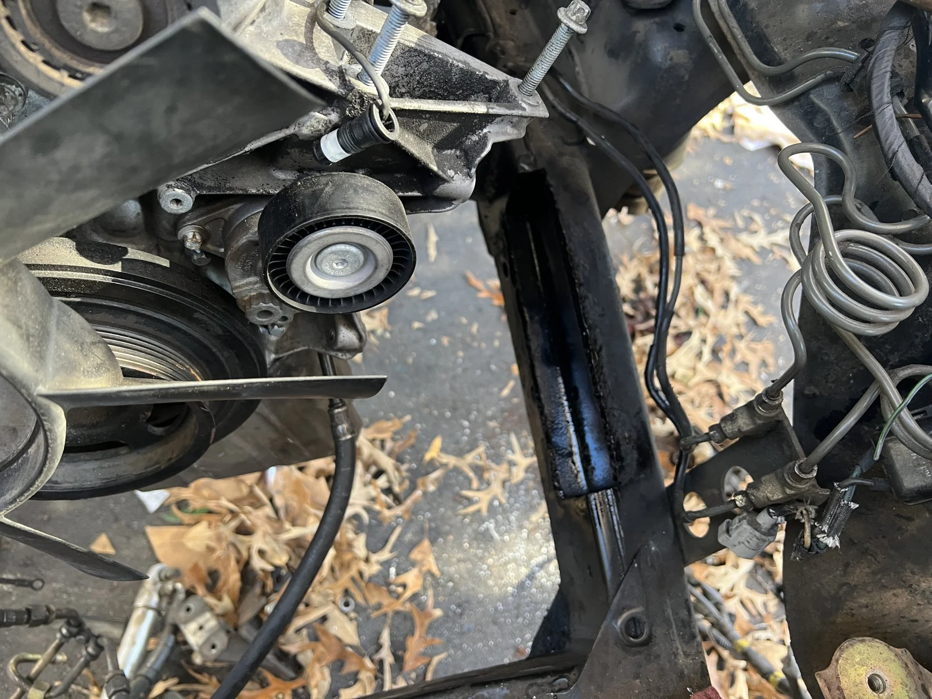

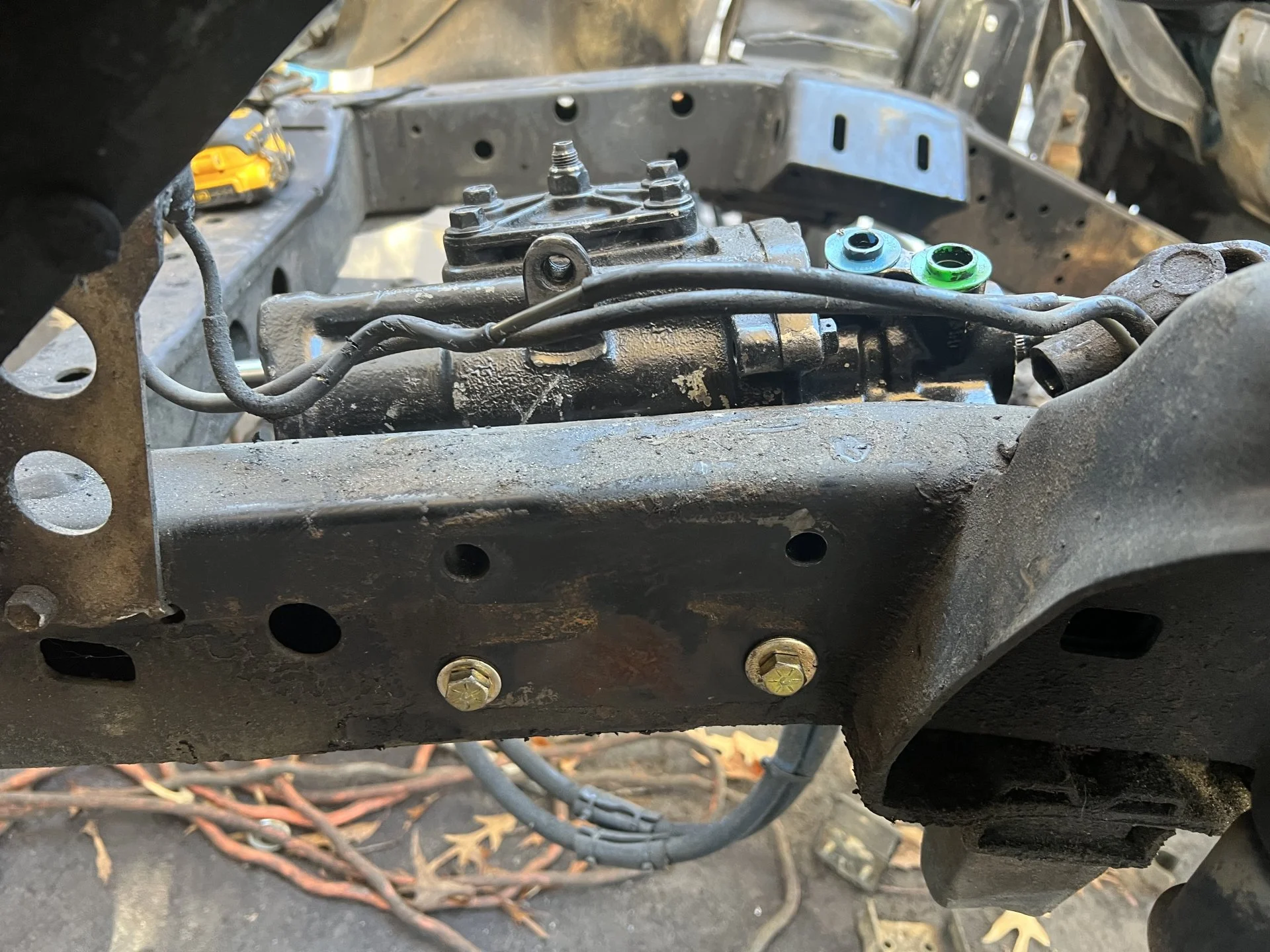

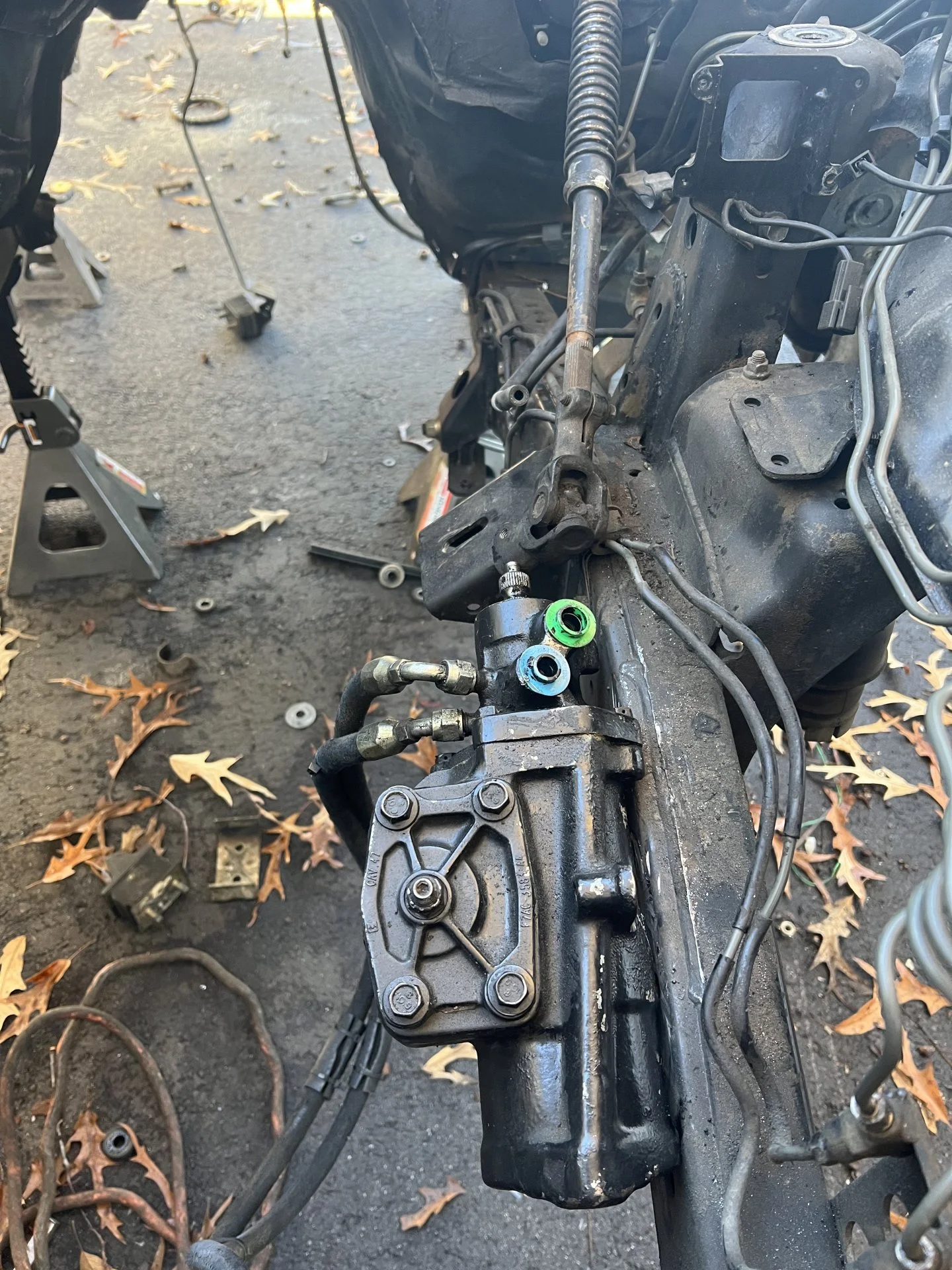

Porkchop progress lol. Think 40’s look nice! Ford gearbox bolted right up to Toyota gearbox holes just need to weld a bracket on top of the frame to catch the top bolt hole. Also the Toyota steering shaft was the right length just need to swap out the joint for the bigger ford spline shaft. Question is will the engine fit with it in there.
