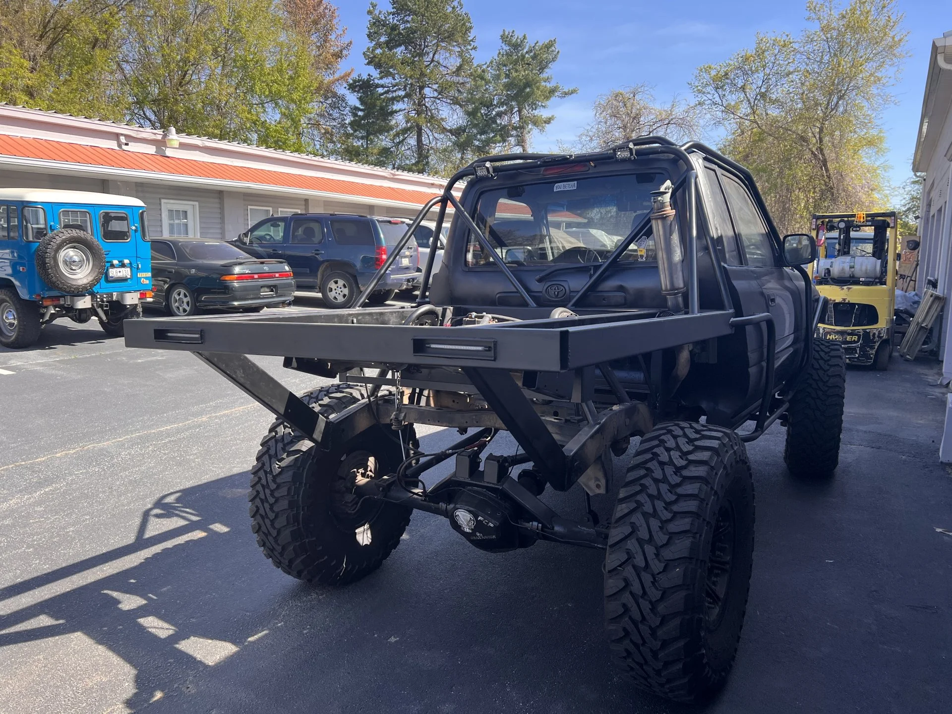

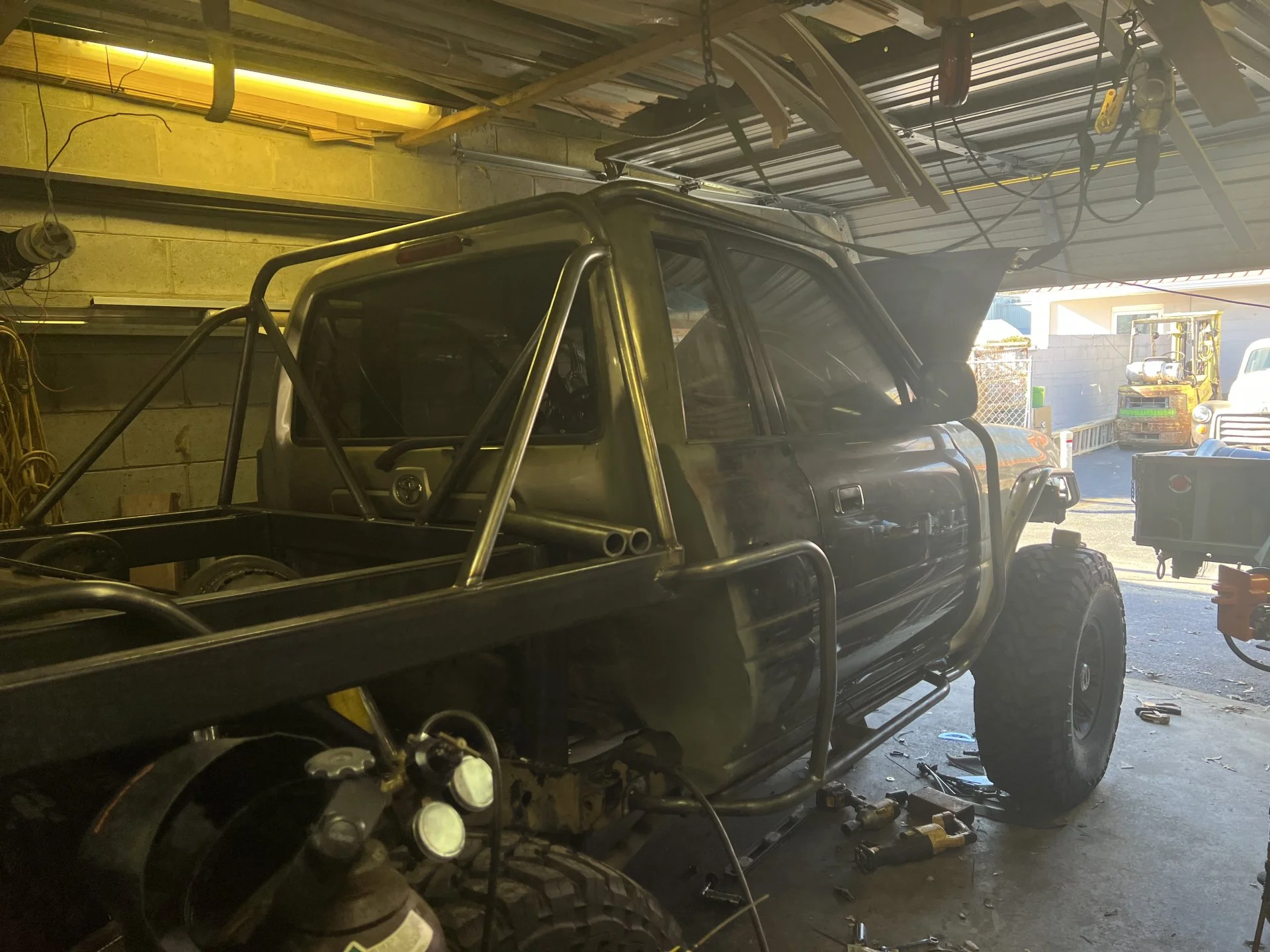

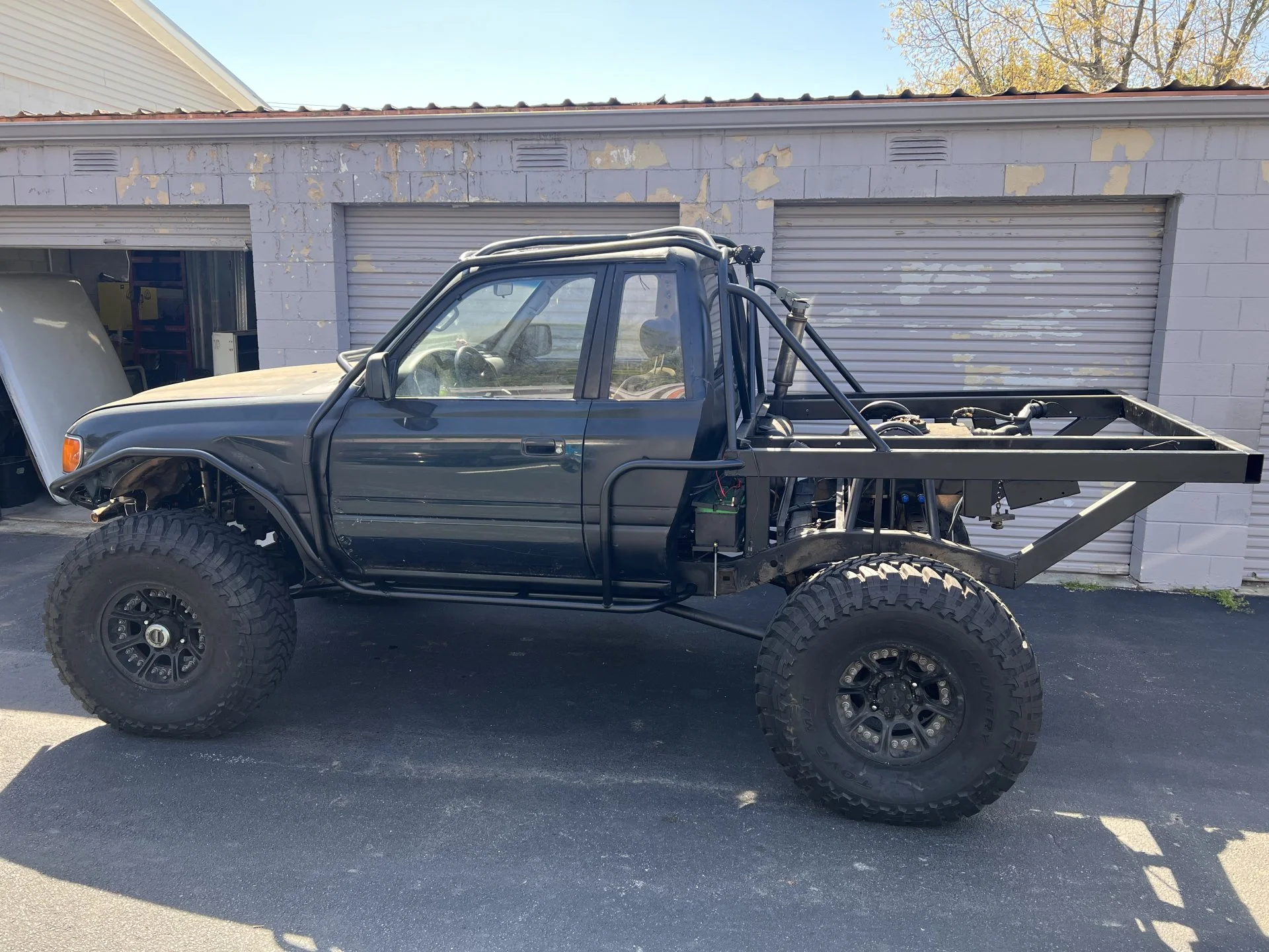

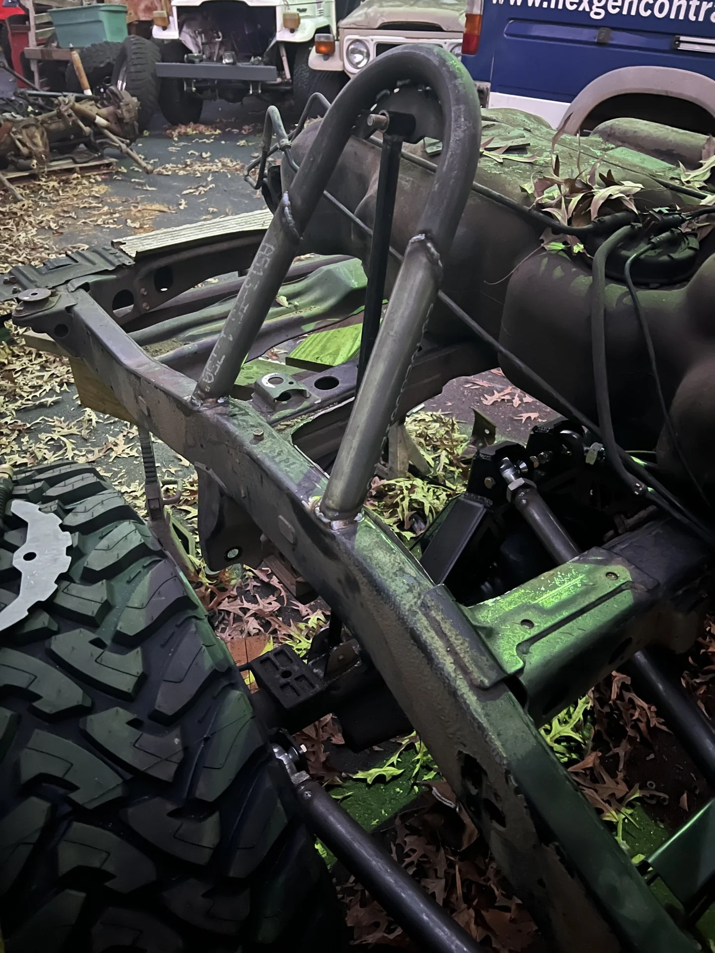

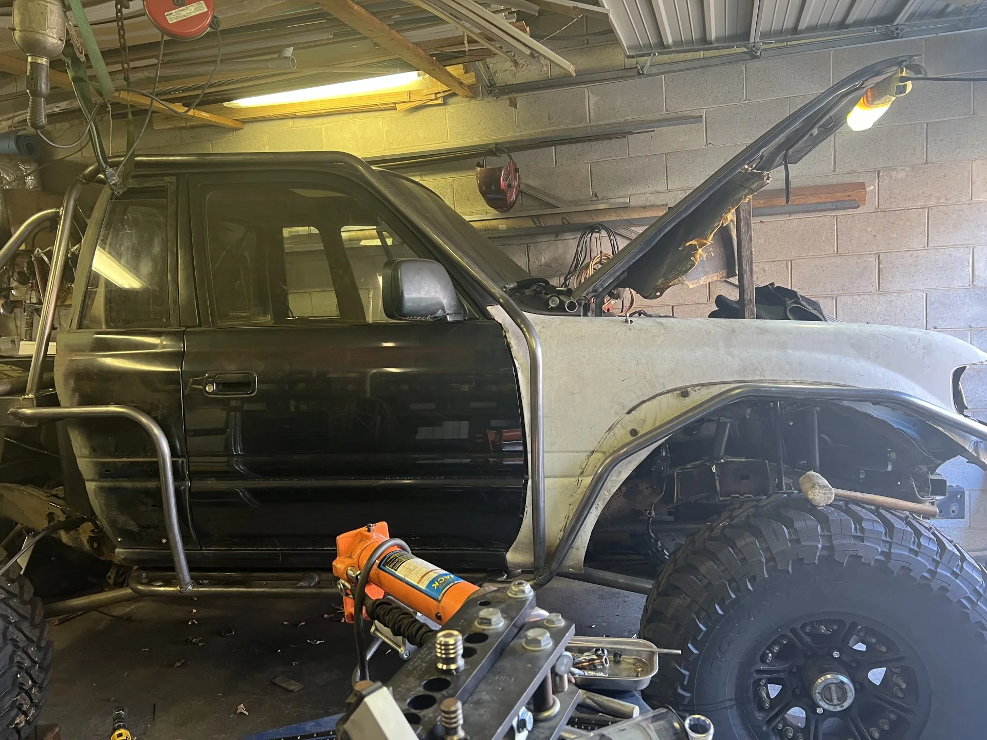

Been making some good progress

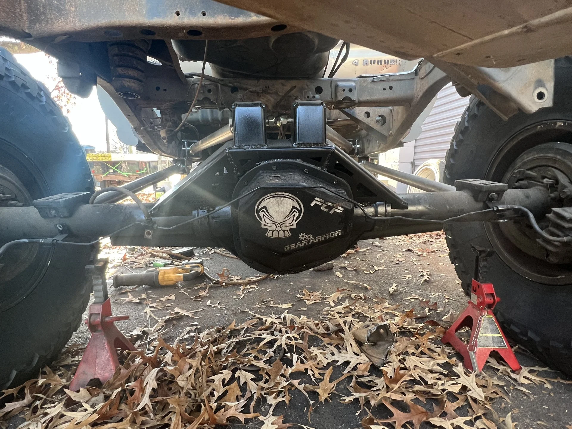

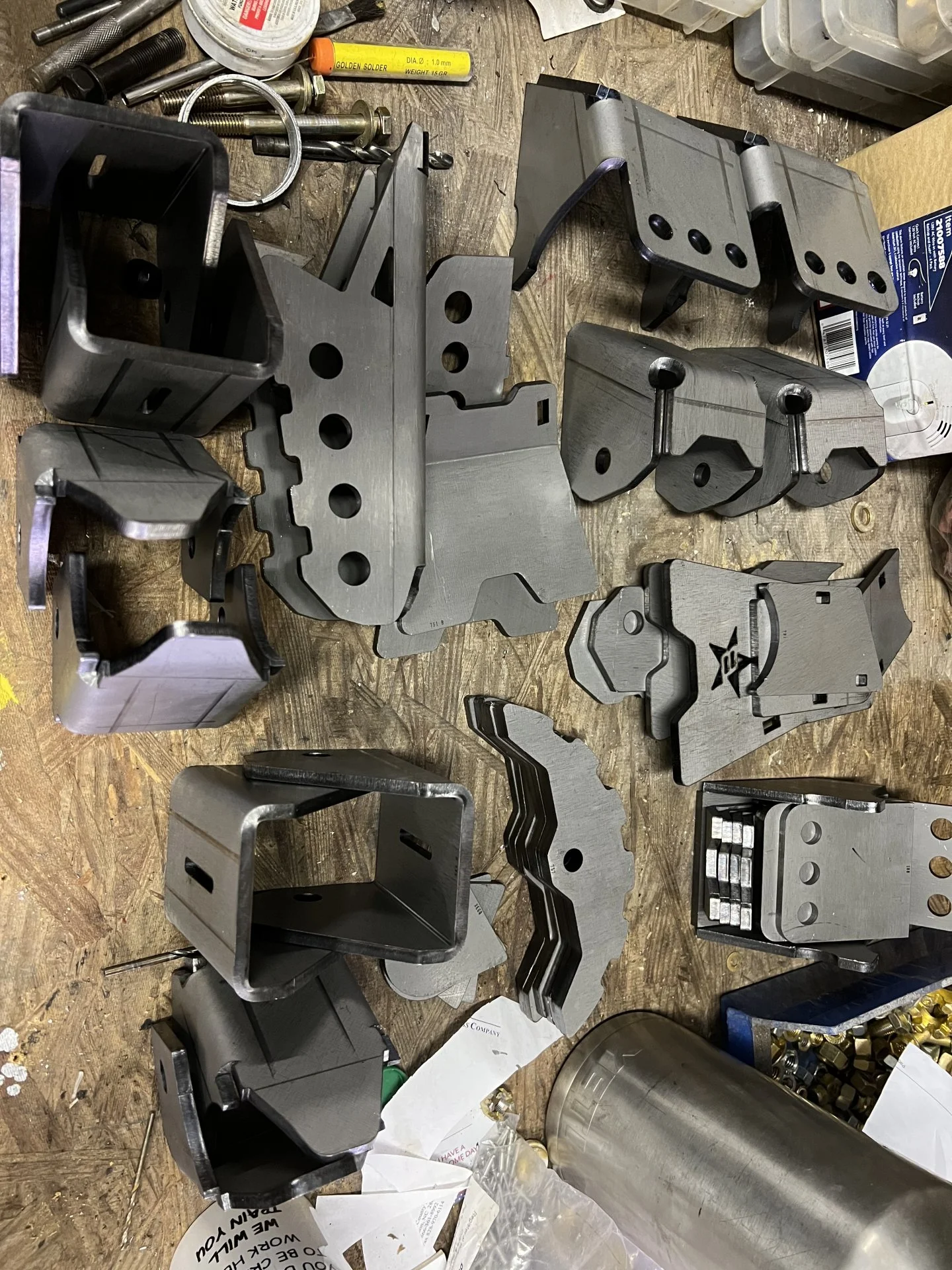

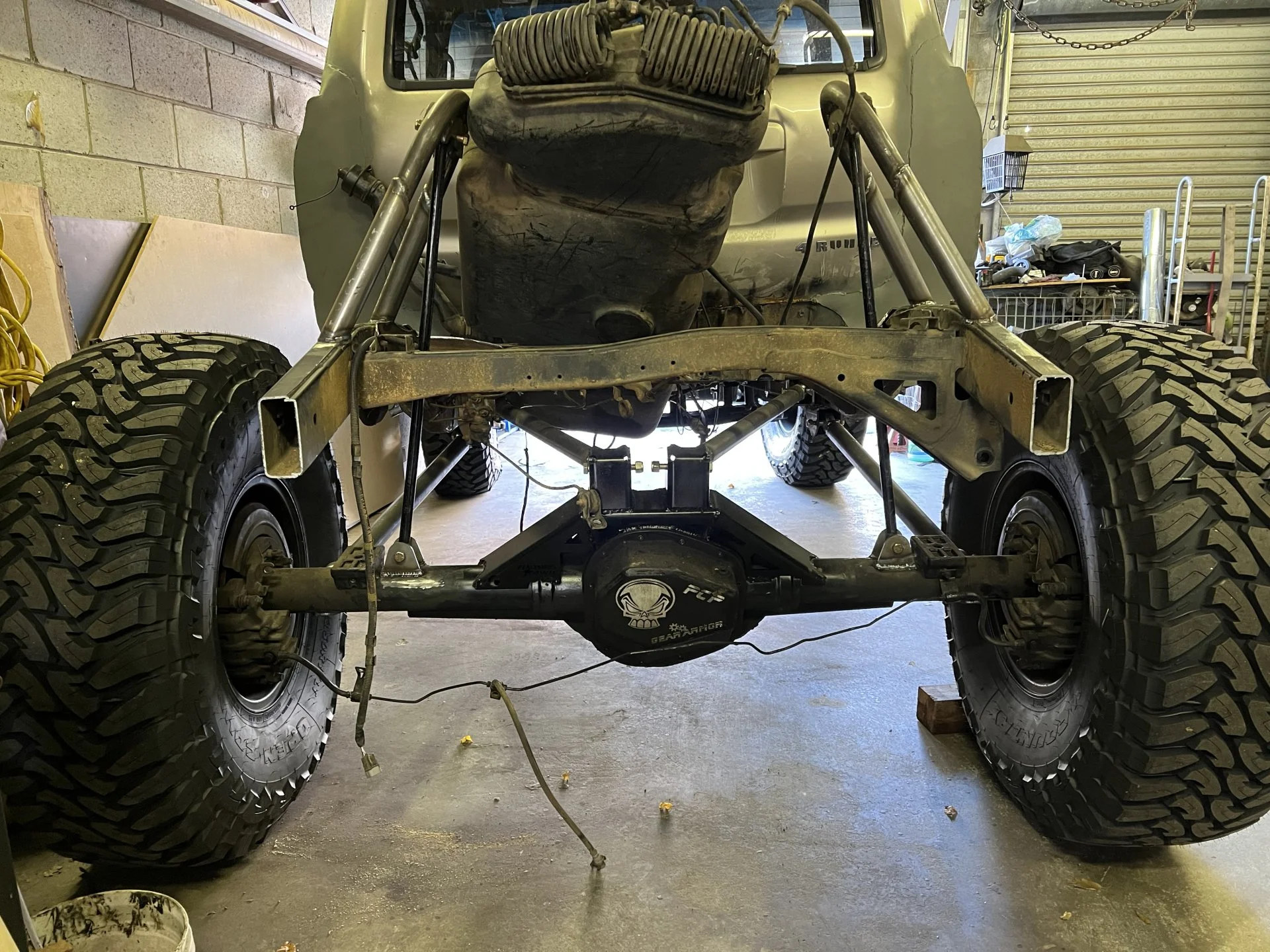

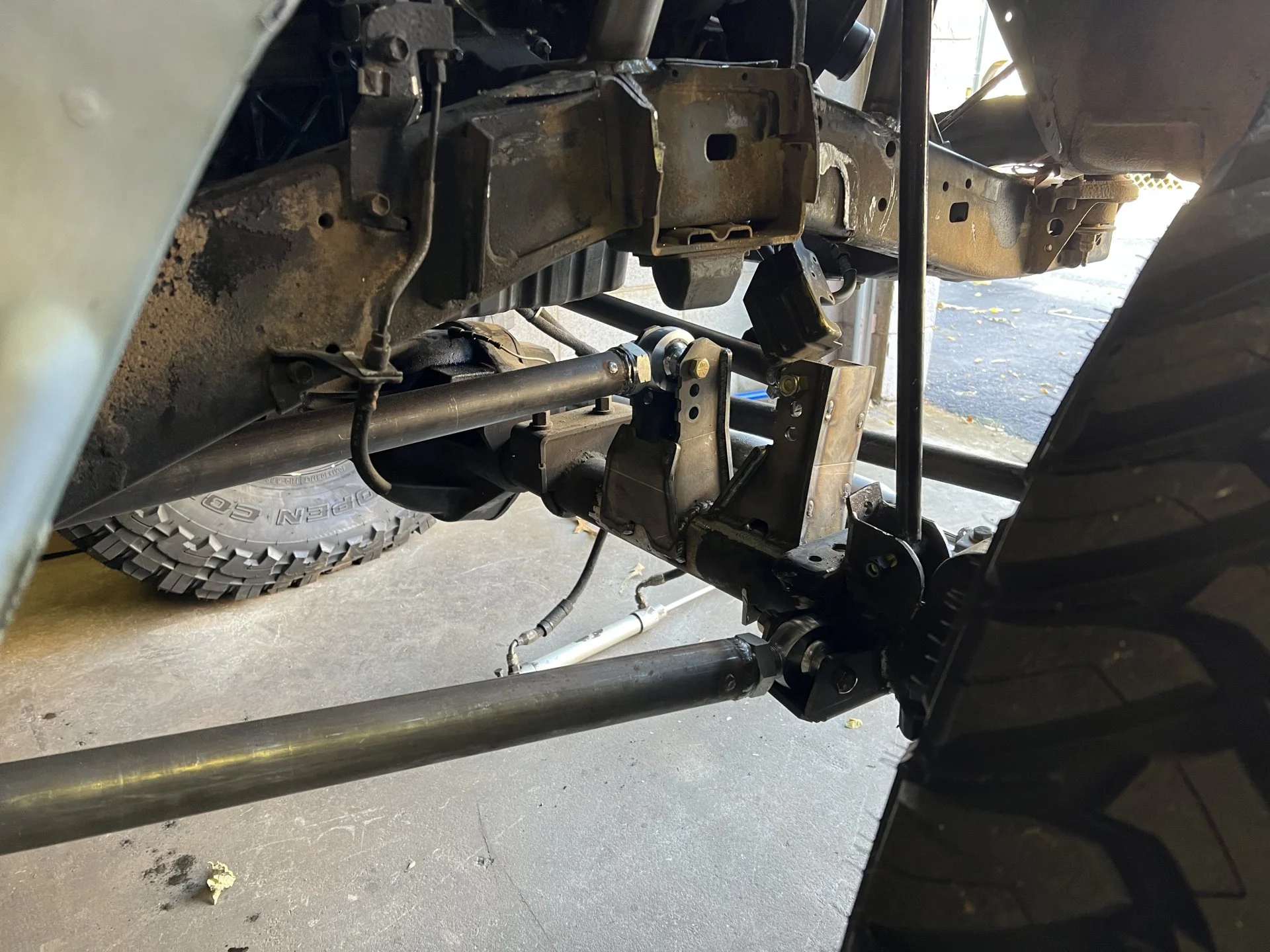

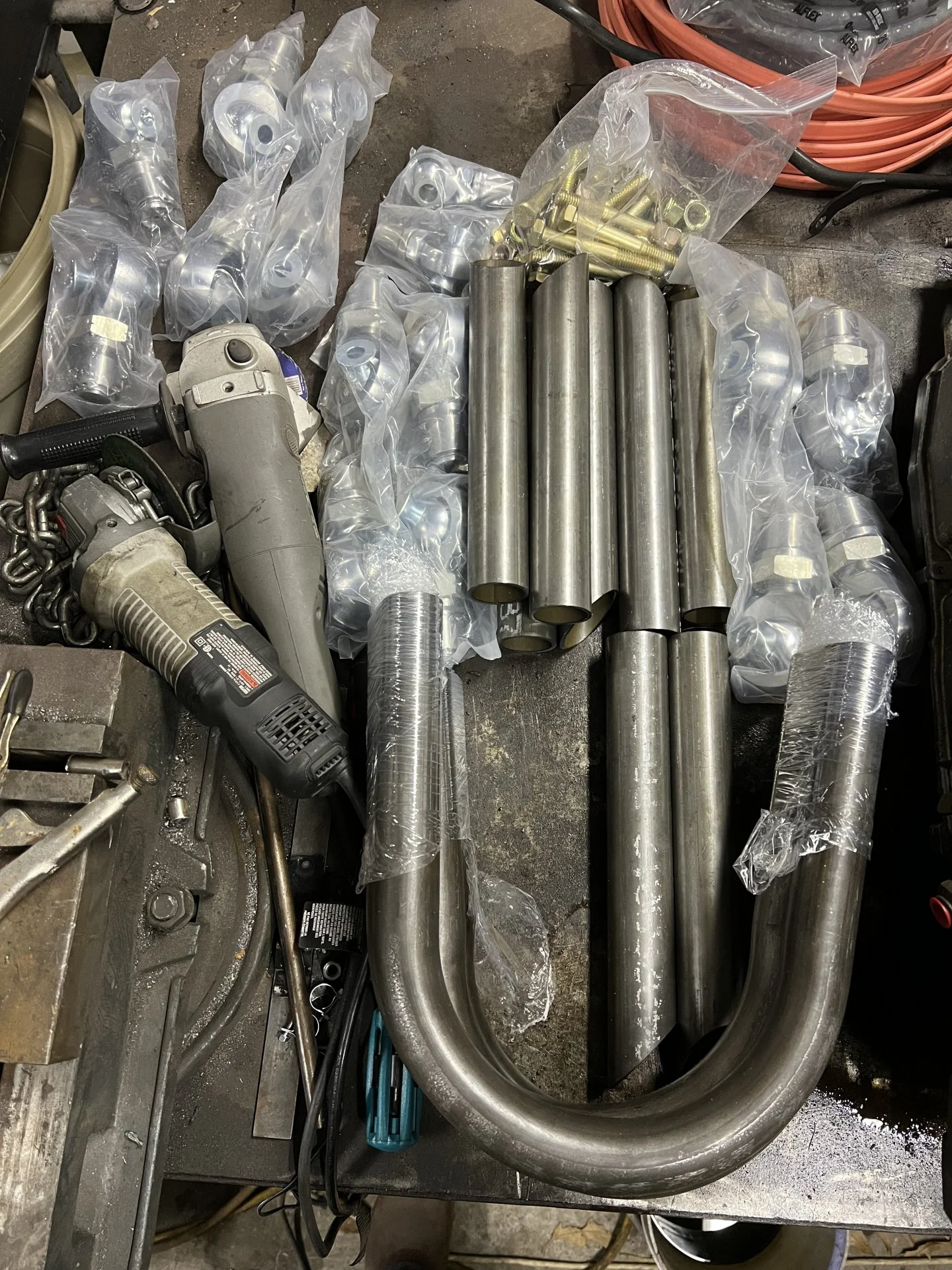

Barnes 4wd link kit deal on Black Friday

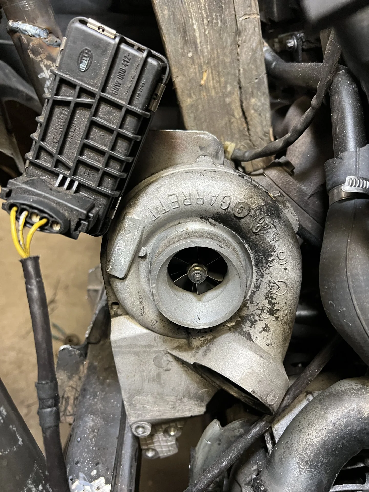

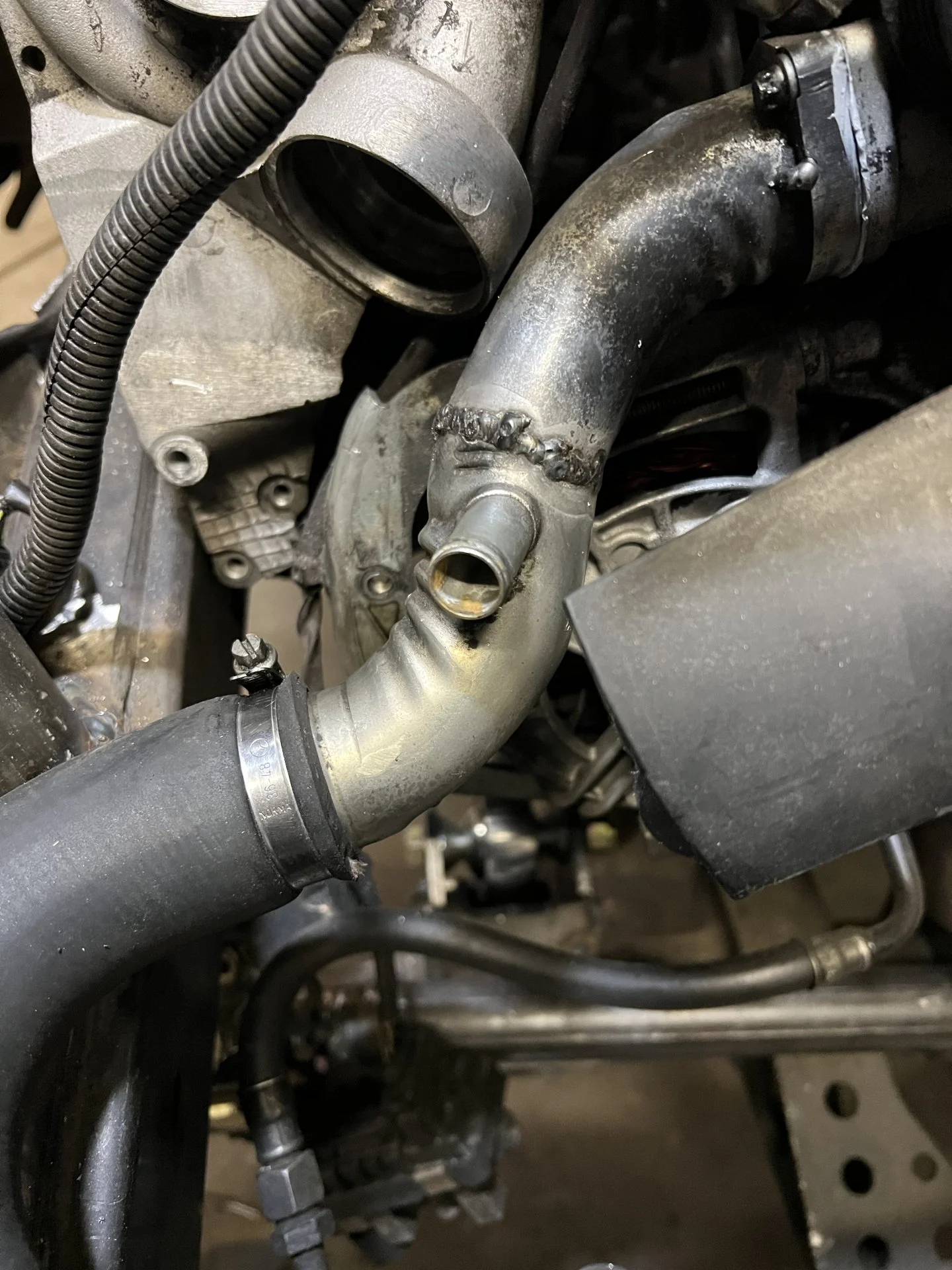

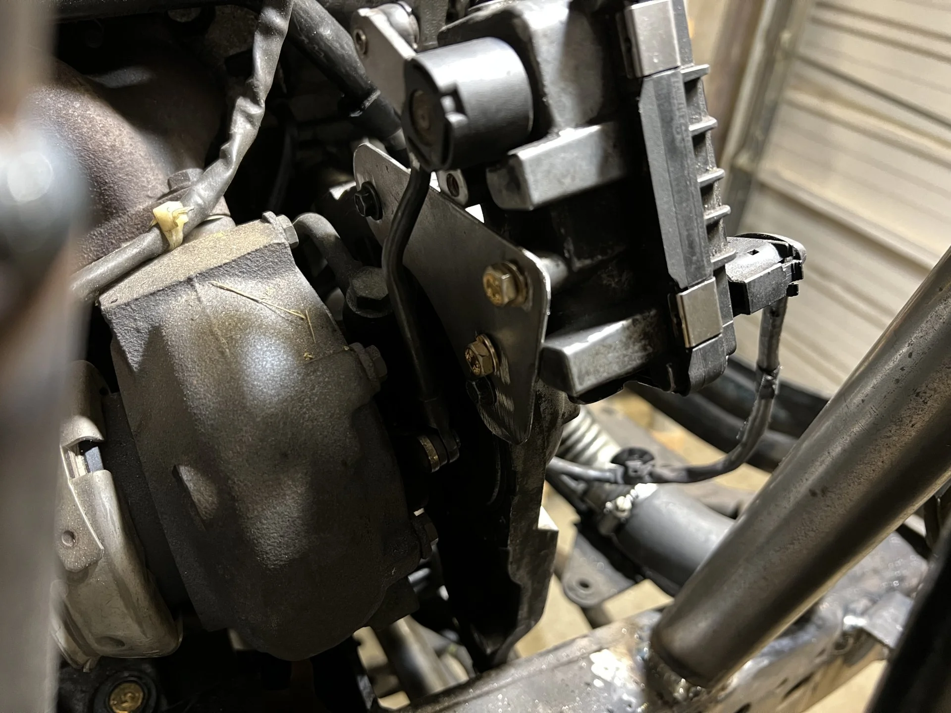

Had to relocate the waste gate control from below the turbo to above it so it wouldn’t hit the frame and new motor mount. Also had to shorten the lower coolant pipe so it wouldn’t interfere with the frame.

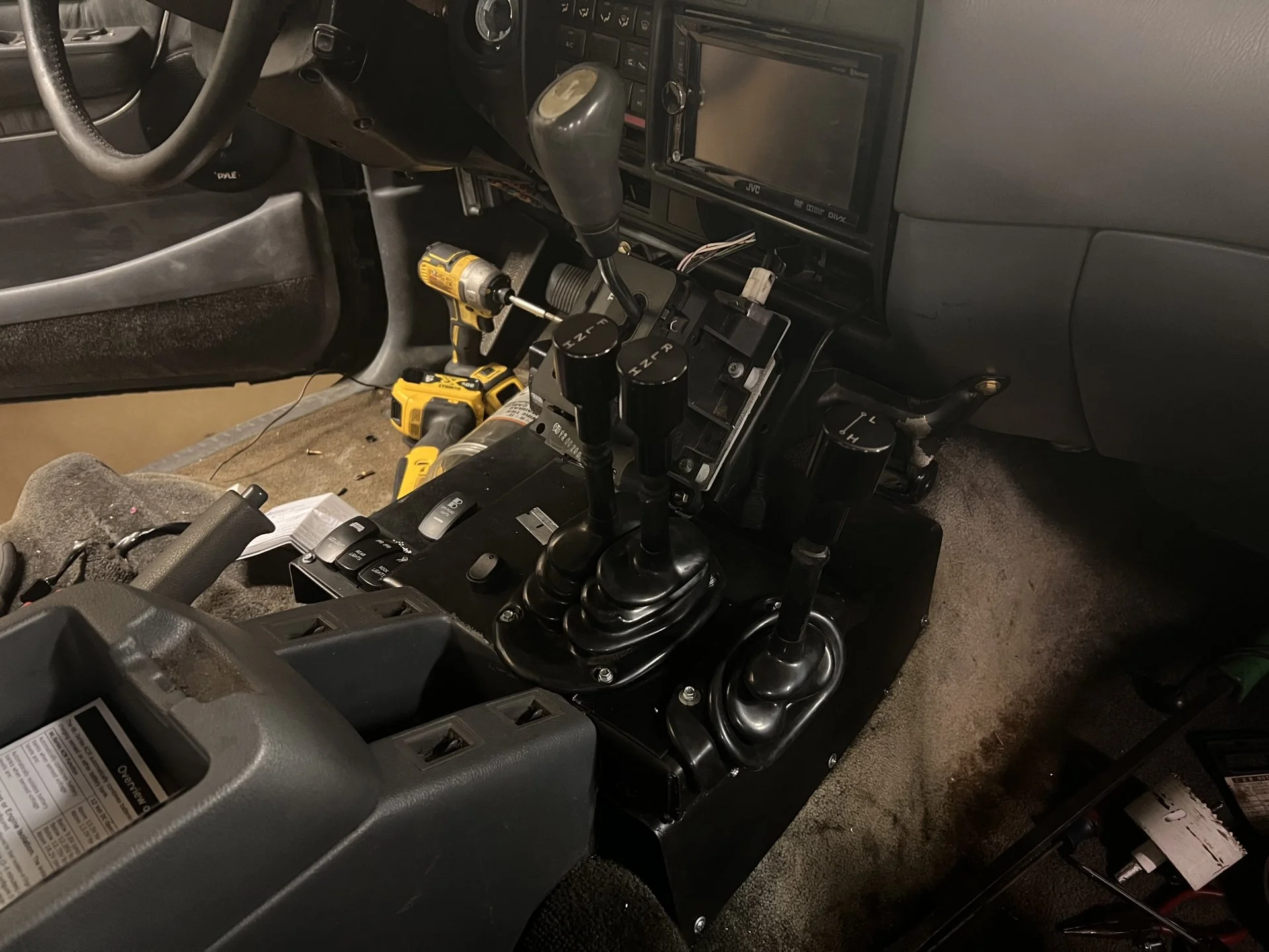

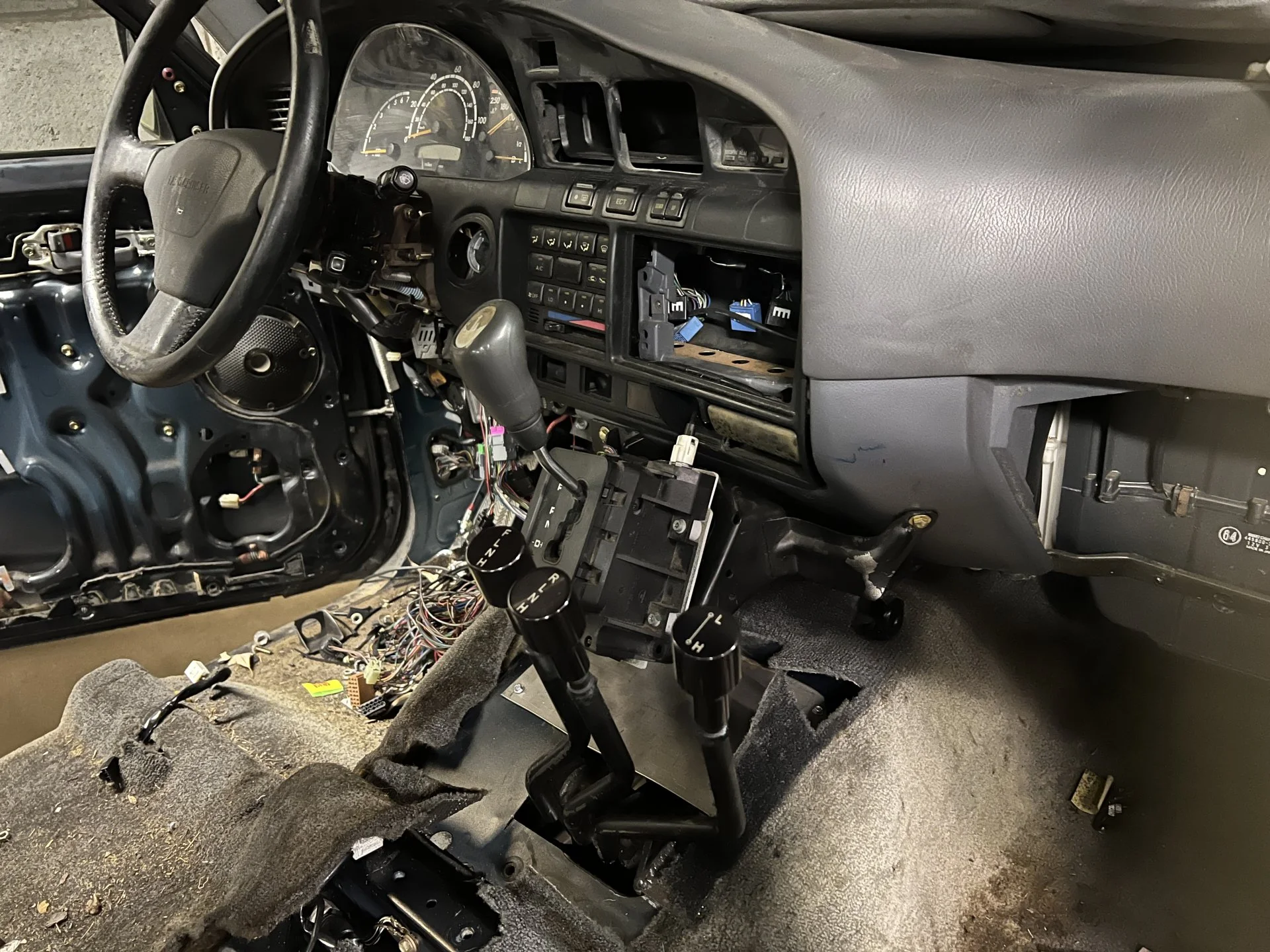

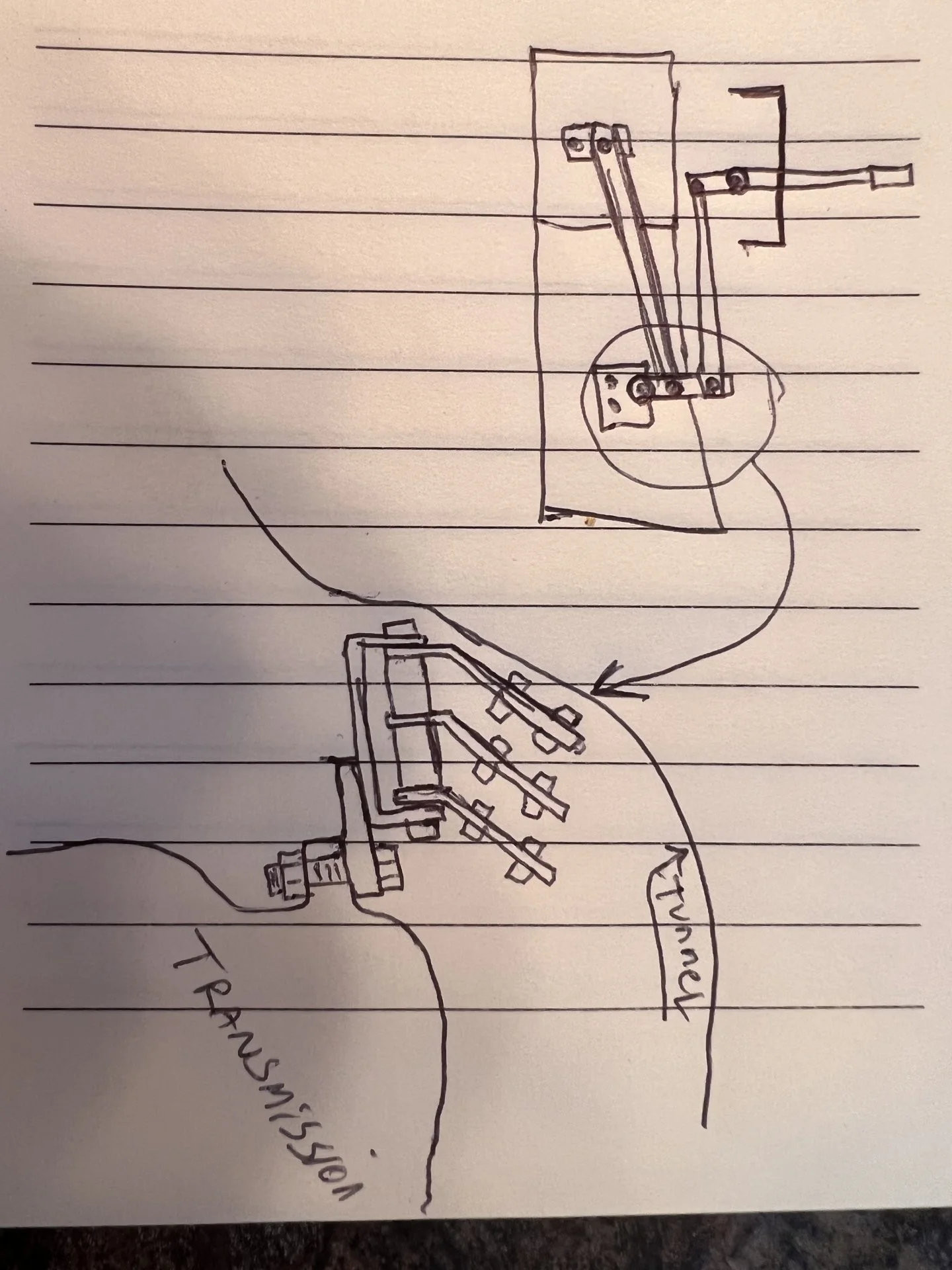

I am going to be doing this in a project soon was we’re the issues you had installing the triple stick?
The location of the shifters is almost directly above the transfer case so in order to get the proper direction and throw of the linkage I had to make a linkage bracket that sits forward of the shifters on the transmission housing that have the shift rods that go back to the tcase.
Basically had to triangulate the linkage. The issue was squeezing it in there because the tunnel was tight for my custom shift bracket to fit while also having proper clearance for the shift rods back to the tcase connections. Crude drawing if that helps. I will try to get pics when I’m back in town.
Thank you for sharing. Sounds like your challenge was space not necessarily the product or technical. I am installing on a different vehicle with plenty of room, so I don’t think I will have that same challenge.
Can you reach those locker switches when stuck to your seat because of a locked seatbelt?

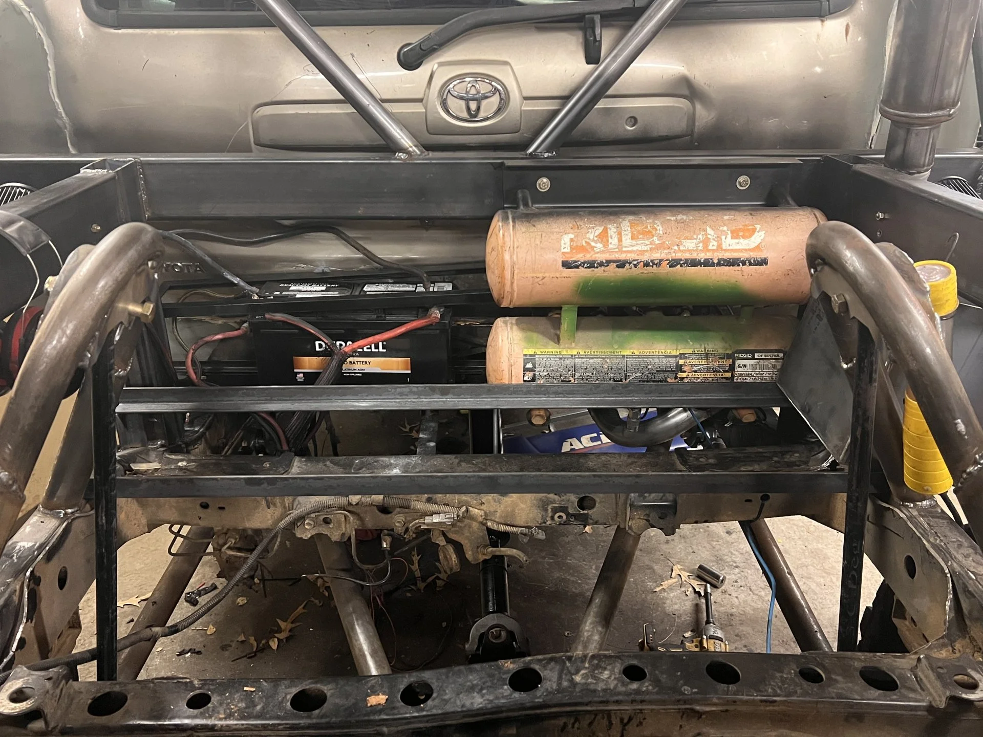

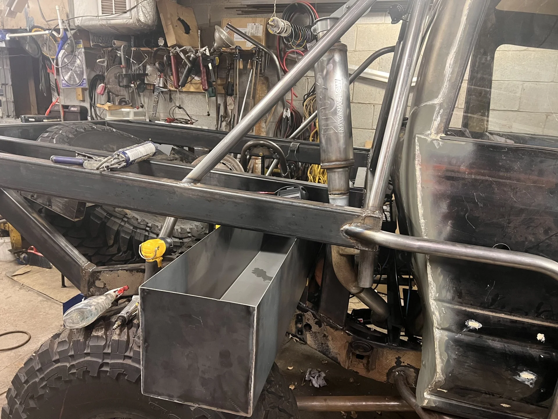

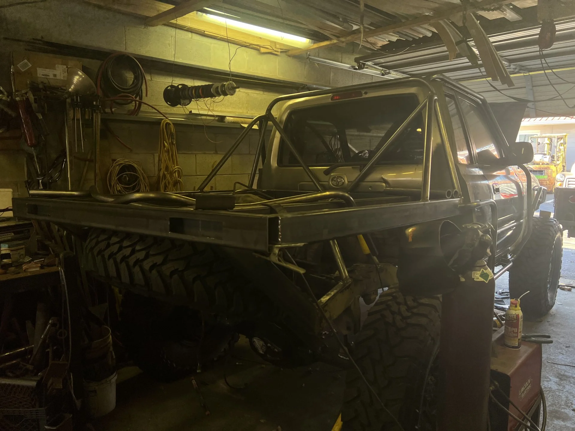

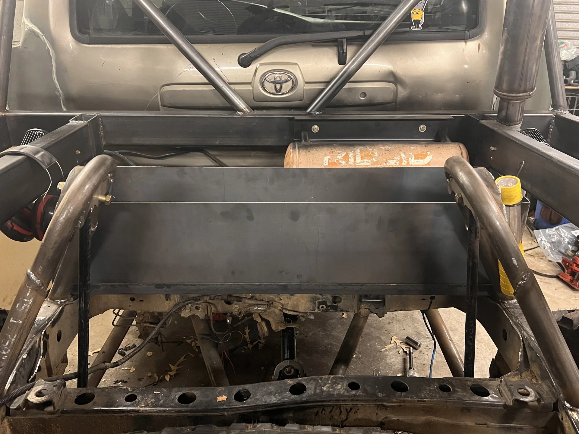

Had enough room for a under bed slide out toolbox. Also re-purposed an old compressor tank for my air system.
Not sure I don’t have any seats yet… I might need to carry a poker rod 😂
