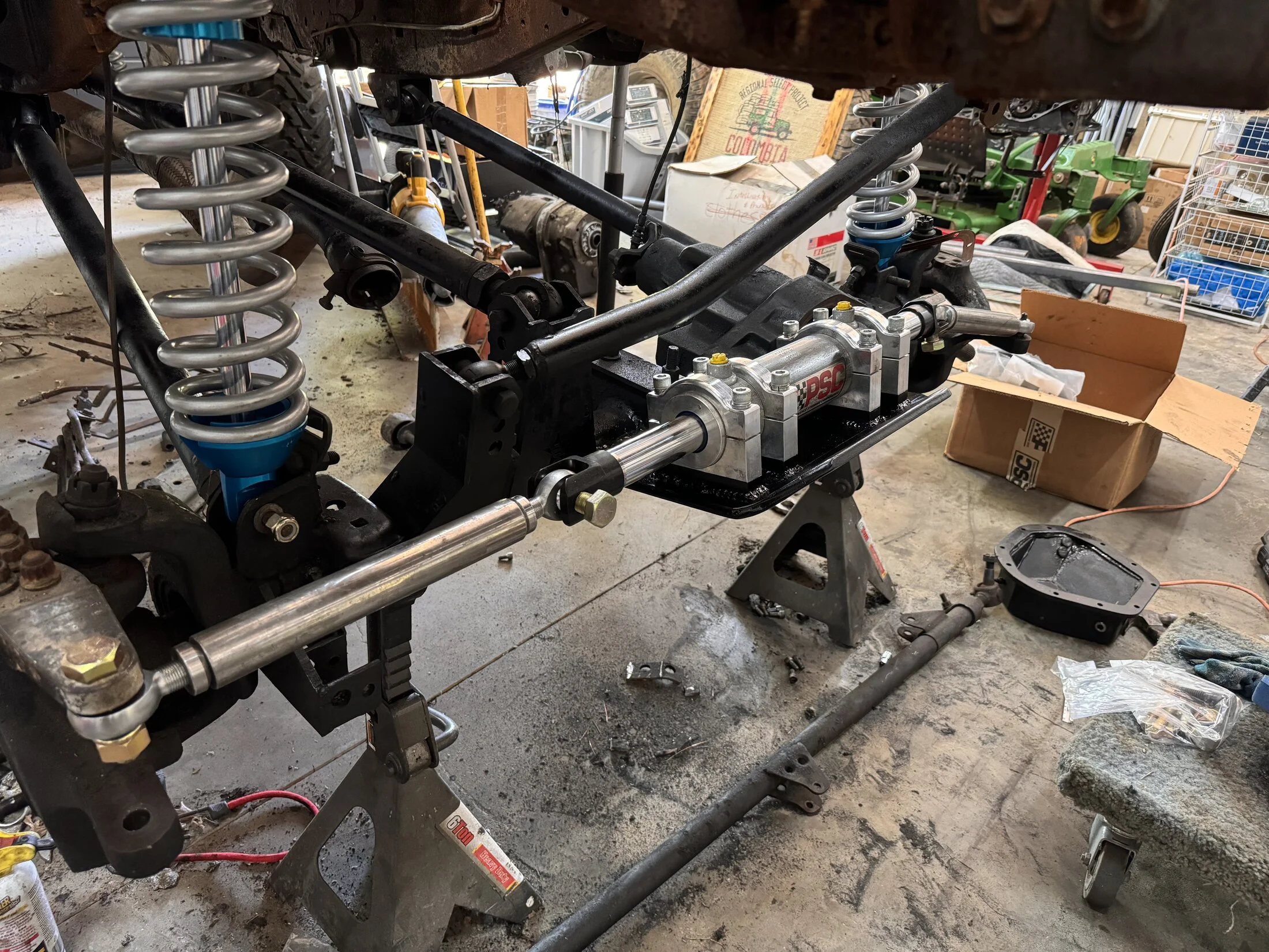

how hard was that, do you use any of the old brackets or strip the frame completely and make measurement and weld s*** on.
Yeah pretty much had to strip off all the old brackets down to bare frame and then start welding the Barnes brackets on it really wasn’t too bad took me better part of the day to get everything mounted to frame and axles

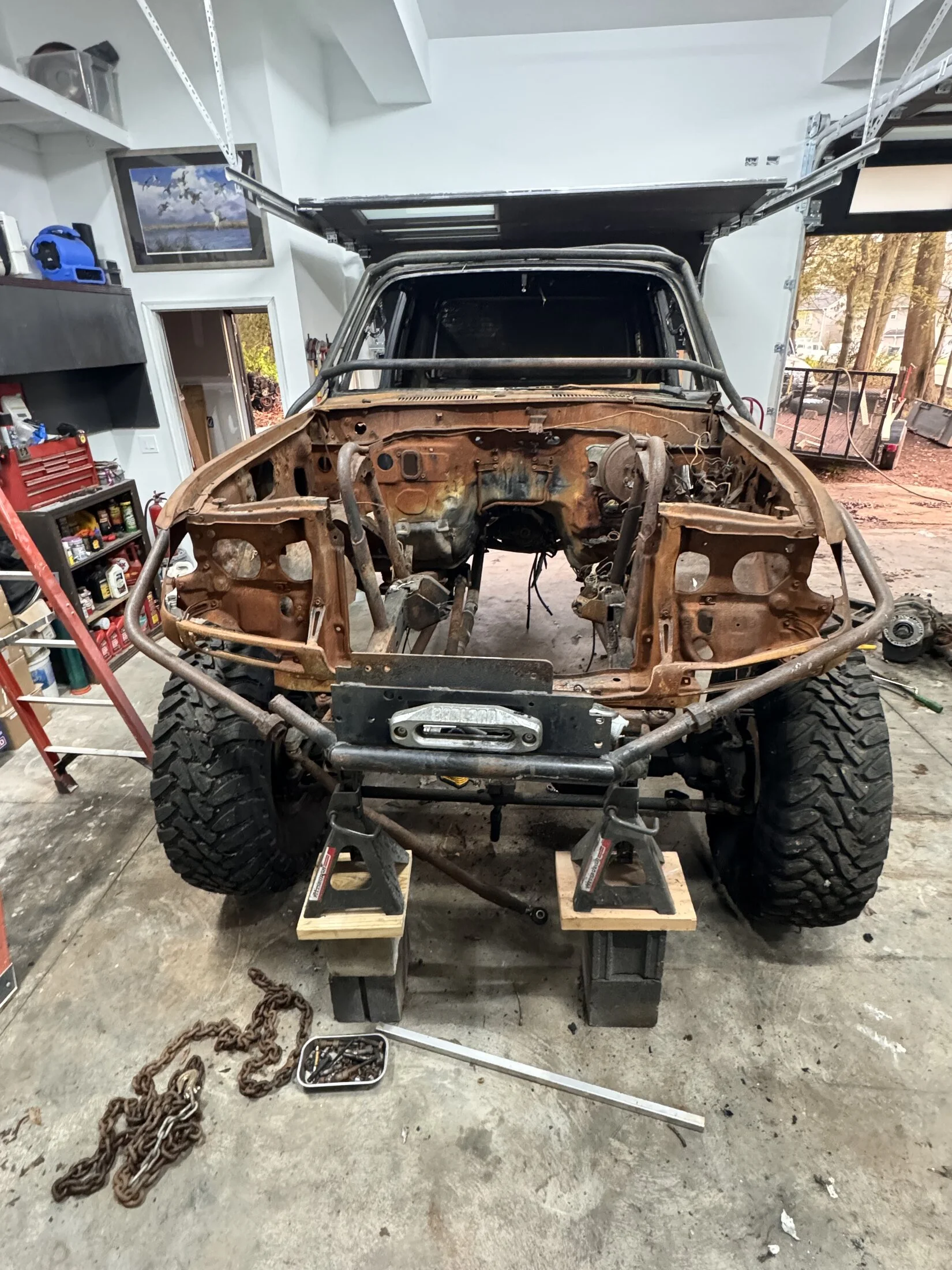

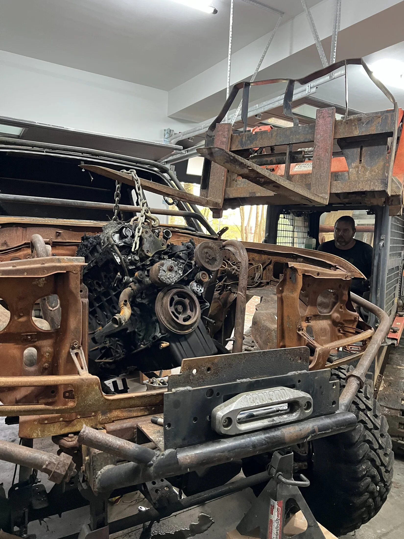

After 2 1/2 years since Porkchop became
El Chicharron I have finally gotten the bug to start working version 2.0. This time….far less electrical crap!

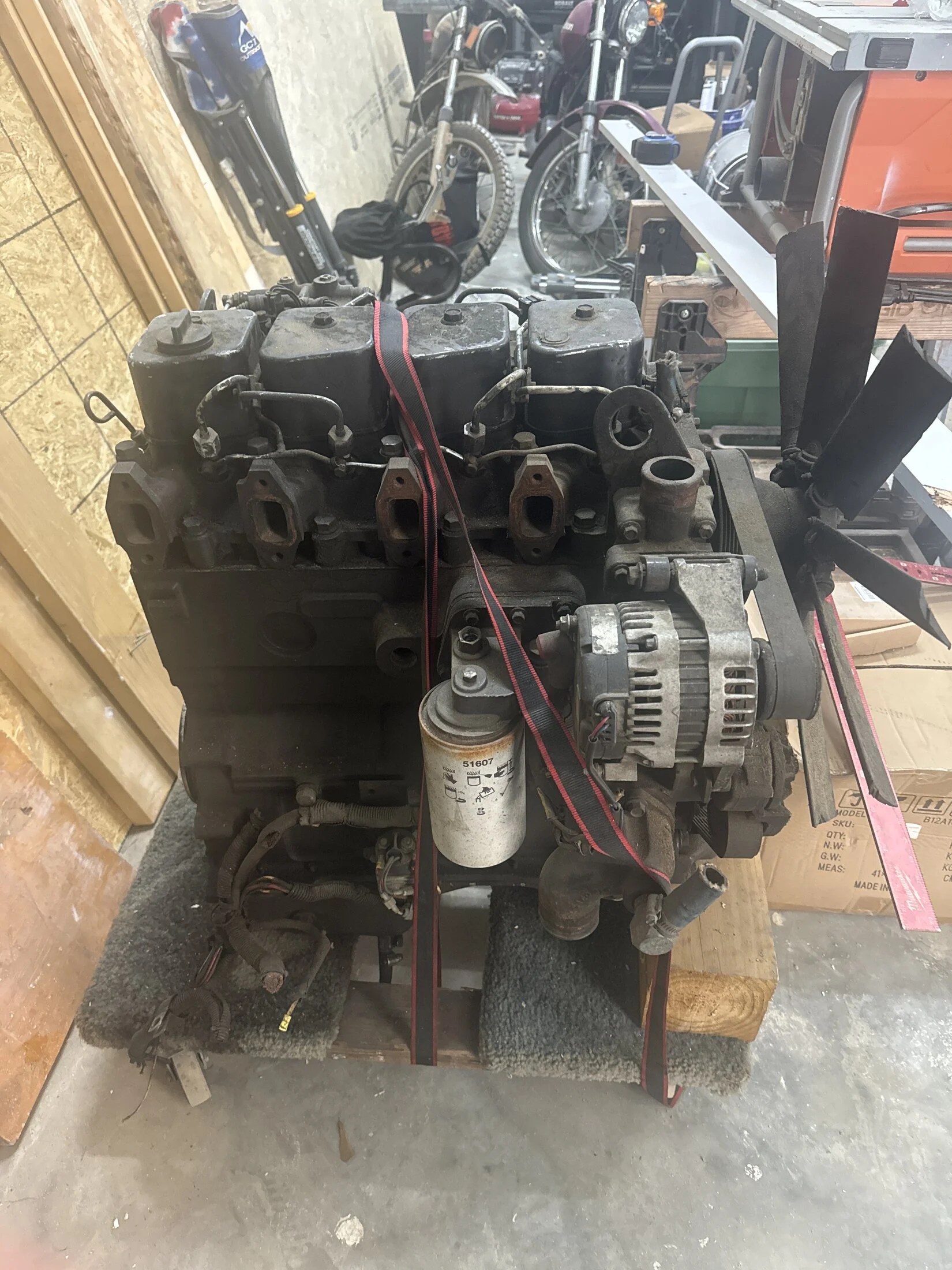

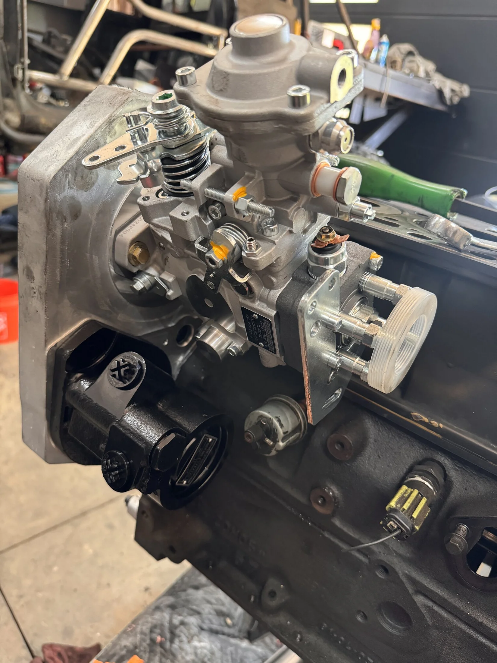

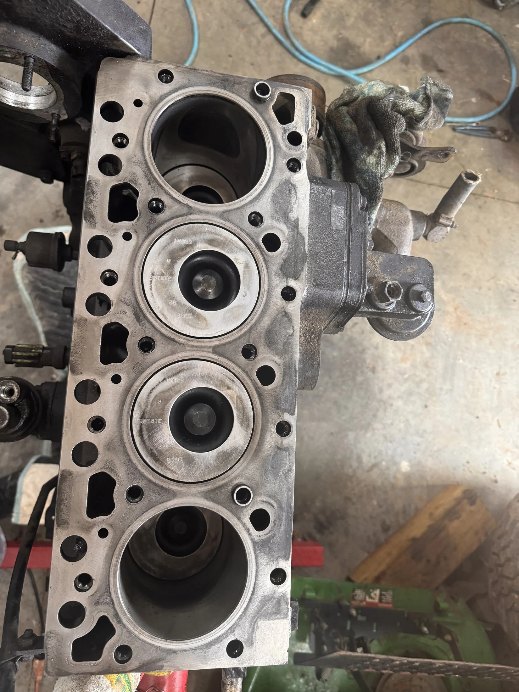

What's the planned drivetrain set up?
It's a QSB4.5 (he got from me, running junkyard crane engine) that I think he's going to put a VE or p-pump on, with NV4500 and doubler if memory serves.

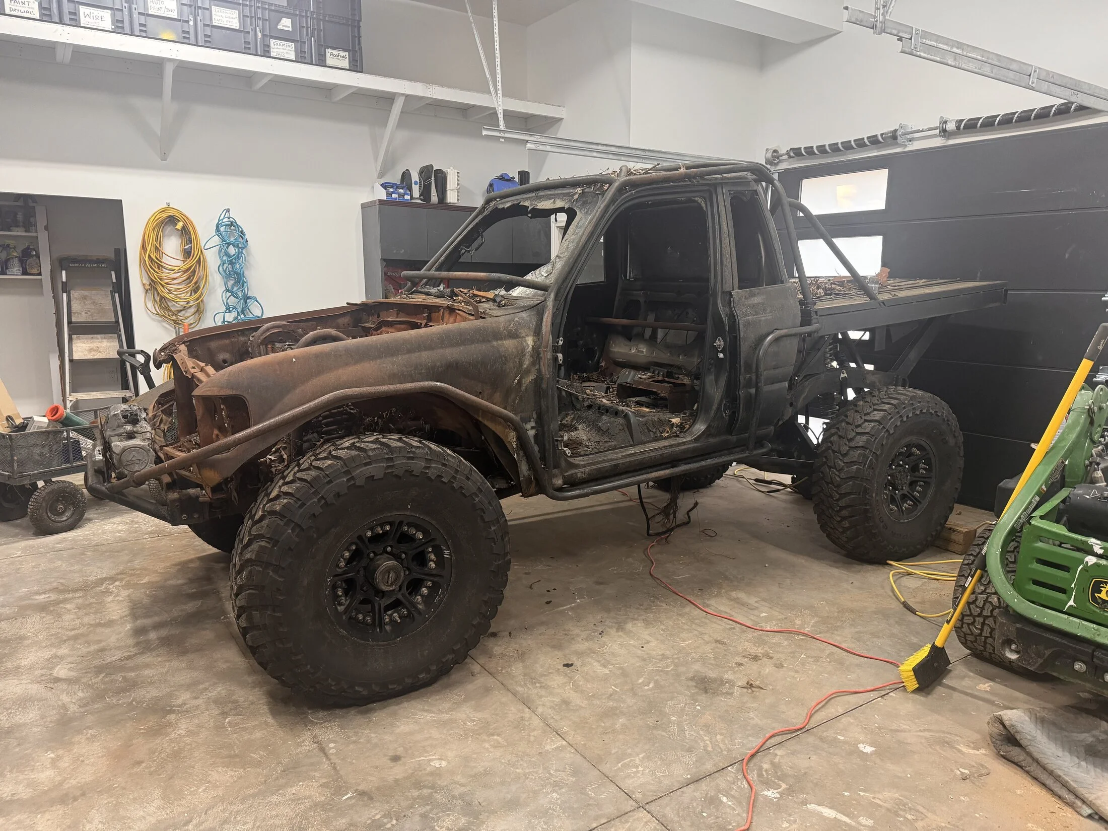

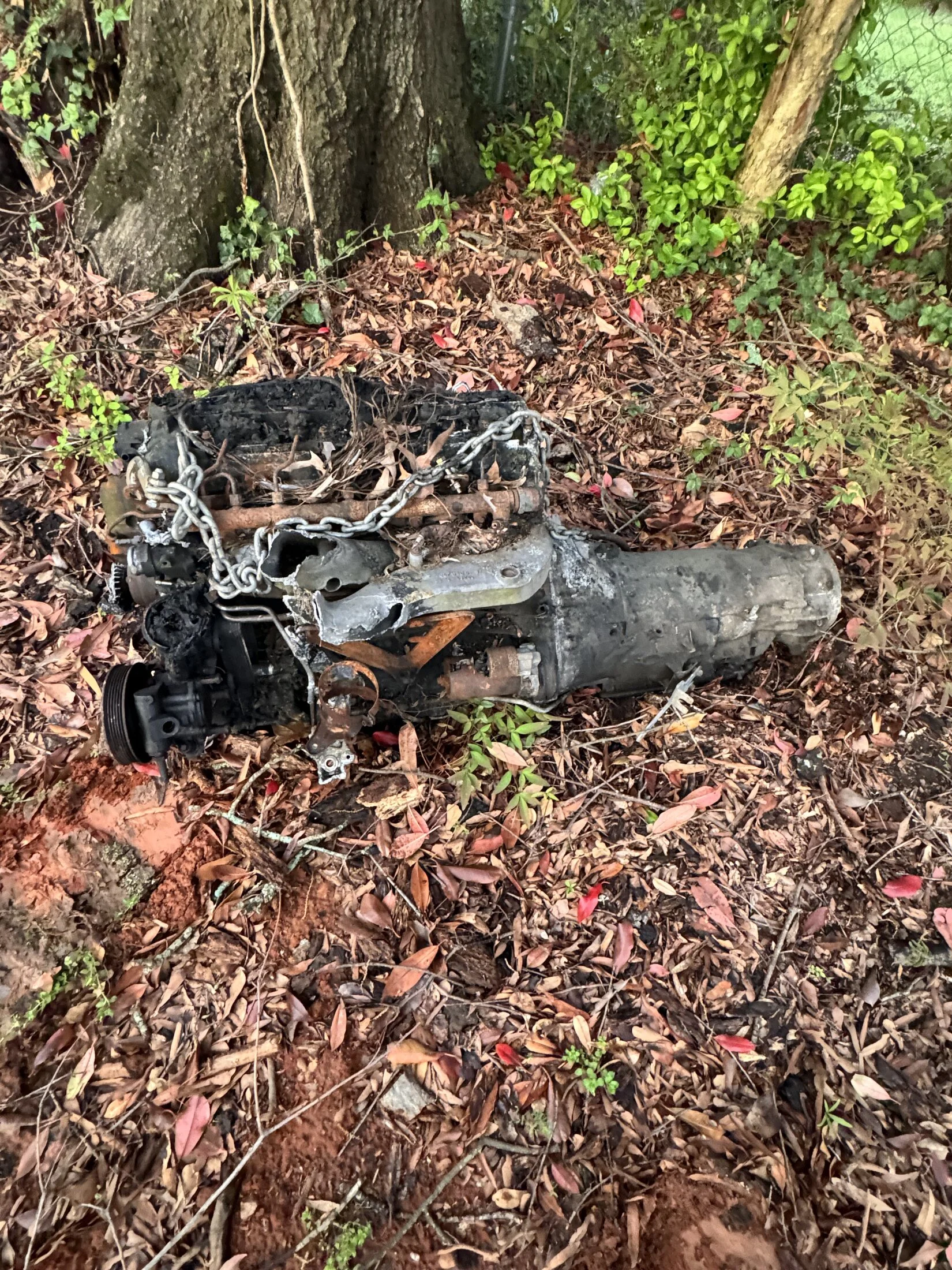

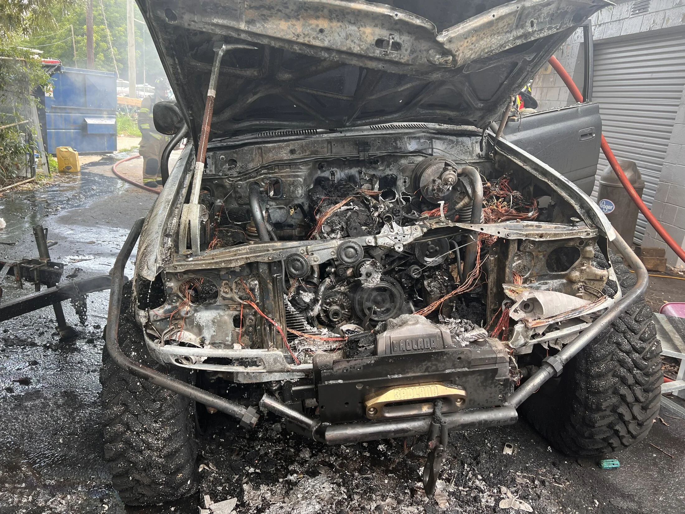

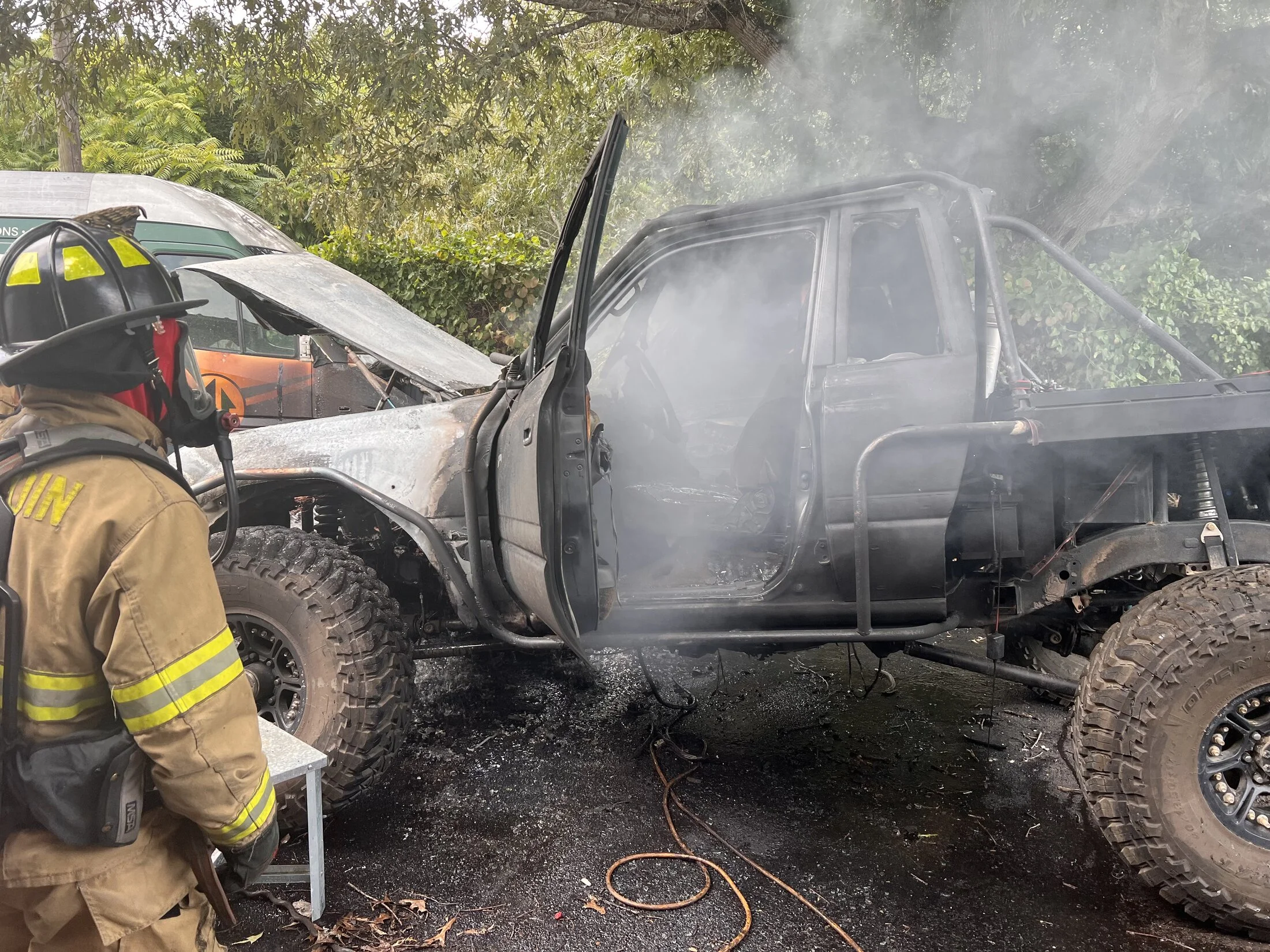

That is a bummer. Do you know what caused the fire?
Correct just need to find the mechanical pump and turbo/manifold setup.

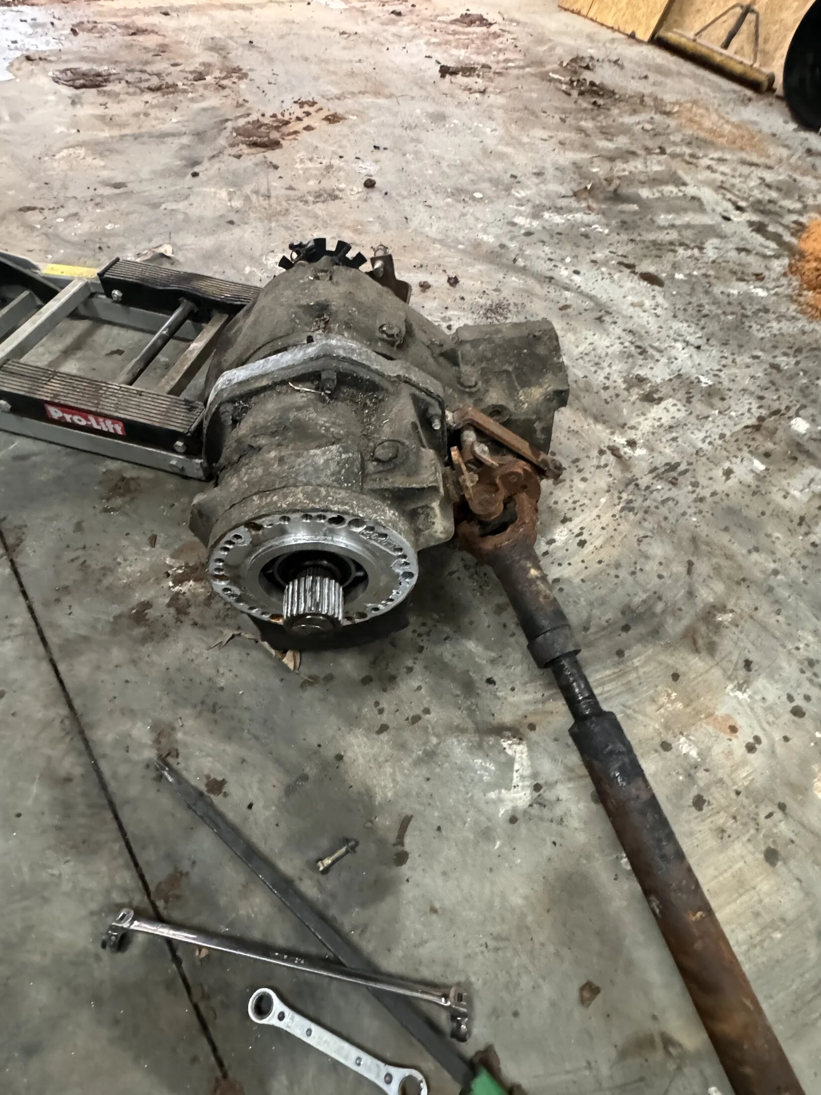

NP203/205 doubler with ford prorock tons. Also need to replace one 40” Toyo MT that’s probably a little to melted to wheel but then again may be pretty grippy now lol.
Yes it was a short in the alternator which caught fire. Small enough short to not blow the main fuse from the alternator but enough to smolder and catch fire. 🤷
Did you go with a Chinese steering pump or find a unicorn? I paid for the ludicrous priced NW adventure fab to give me warm fuzzies via adequate pressure for my hydro boost unit.
