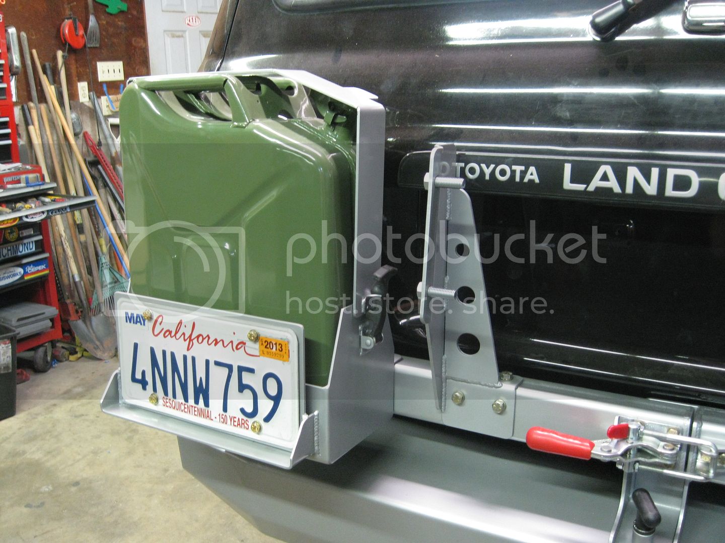

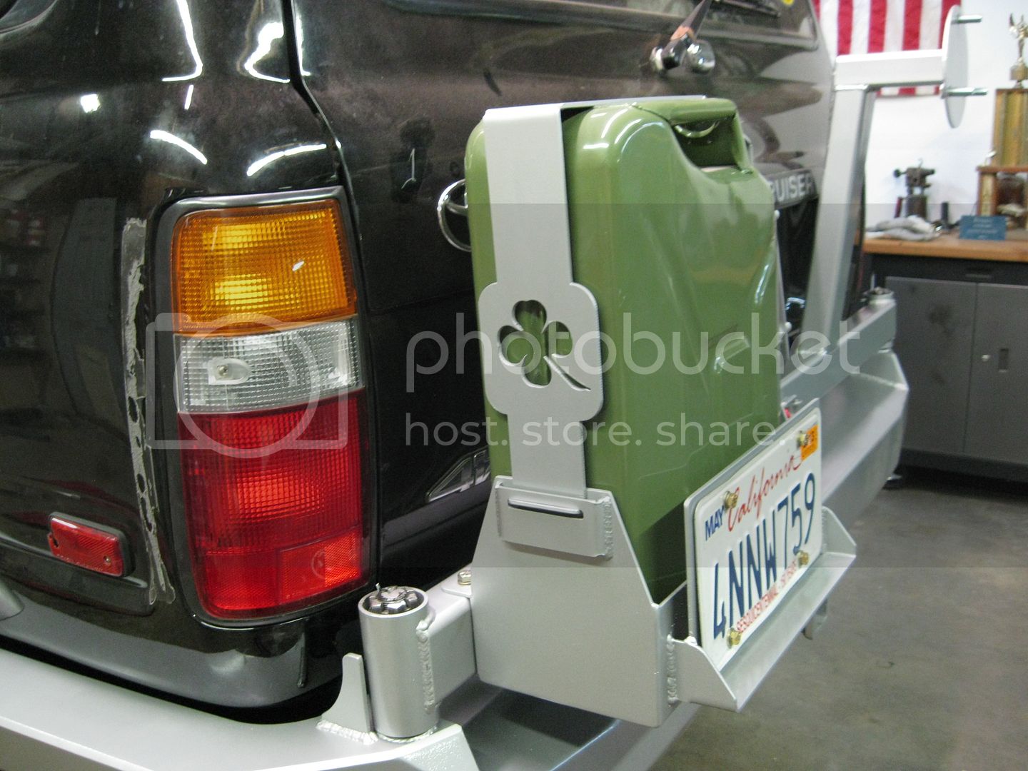

Thanks Thad I am glad too see you are happy with the bumper. And have been and am trying to figure out a way to make a holddown and locking system for the jerry cans and will post some pics when I finally get it figured out.
Hey Sean - what about something like this?

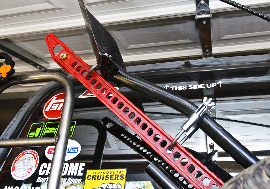

Also, I know we talked about mounting a Fiskars shovel to the bumper. This is what I ended up doing :)
Worked out perfectly
