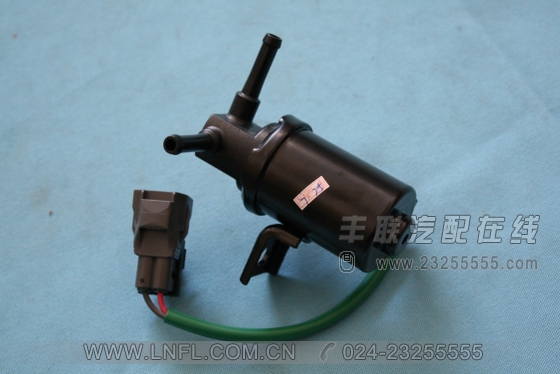

swcruiser in looking at the list for the 100 tanks, are you going to include the two way fuel valve and relays? that valve would be especially important.
valve
Semlin,
I am not totally familiar with the 100 tanks as they are different than the 80s so Im not sure what part you are asking about. The 80 has a external transfer assembly. My understanding is the petrol 100s have this inside the tank. so you can wire and plumb the tank to transfer into the breather of the main tank as many of the 80 crowd has done. This will be included. The diesels do not. Im going to clarify how this is handled with the diesel tanks to make sure i want to bring those over.
i am not sure either as my epc has no diagram for the fuel tanks, but the two fuel lines have to converge and there is a solenoid part in the oz epc that does not appear in north america
VALVE ASSY, FUEL TANK SOLENOID RETURN
77720‑60070
and there seems to be a bracket to mount it
BRACKET, FUEL SOLENOID VALVE MAIN
77716‑60100
it may look like this (image search for that p/n but from a chinese website)
