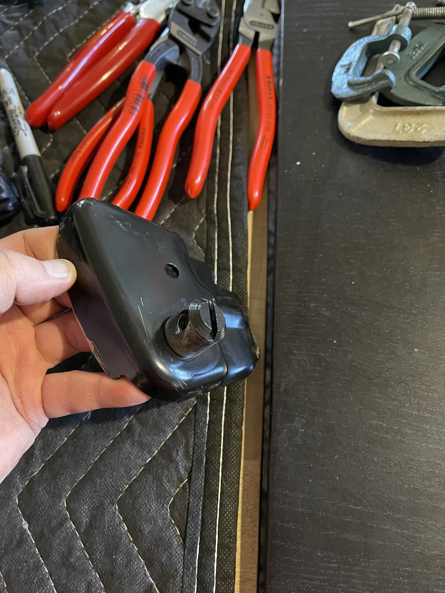

When it arrived, I found the armrest was made to be mounted on a slotted stud with a threaded/tapered bolt running through it. I had two options - machine this, or find one somewhere. After quite a bit of searching on parts sites, I called a rover salvage yard who was able to cut the bracket/stud out and ship it my way.

Weird rover mount - the large side of the thru-bore is aimed at the top of your rear tailgate roughly:

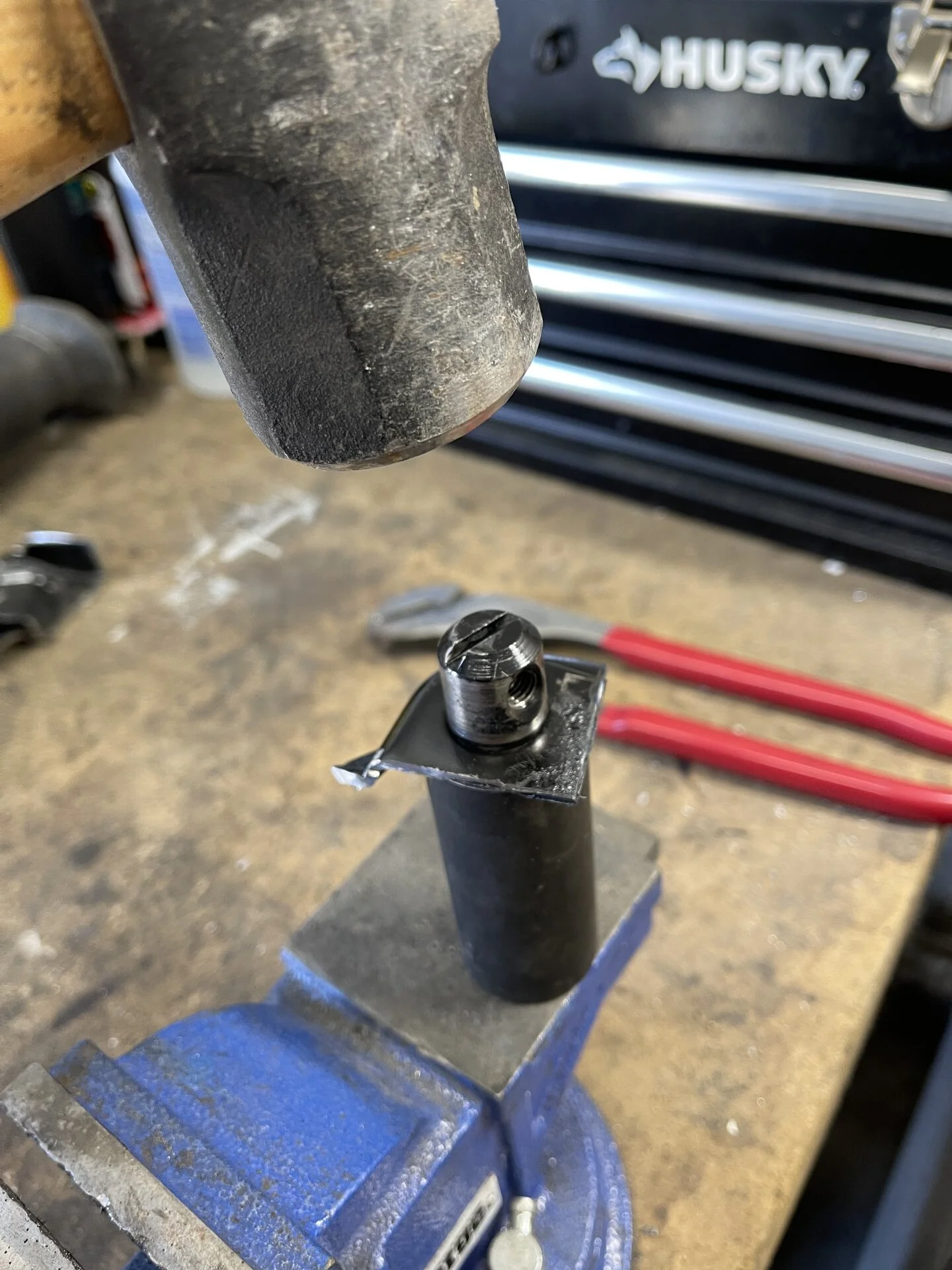

Grind the tach welds from the back of the stud and tap it out. Watch your fingers.

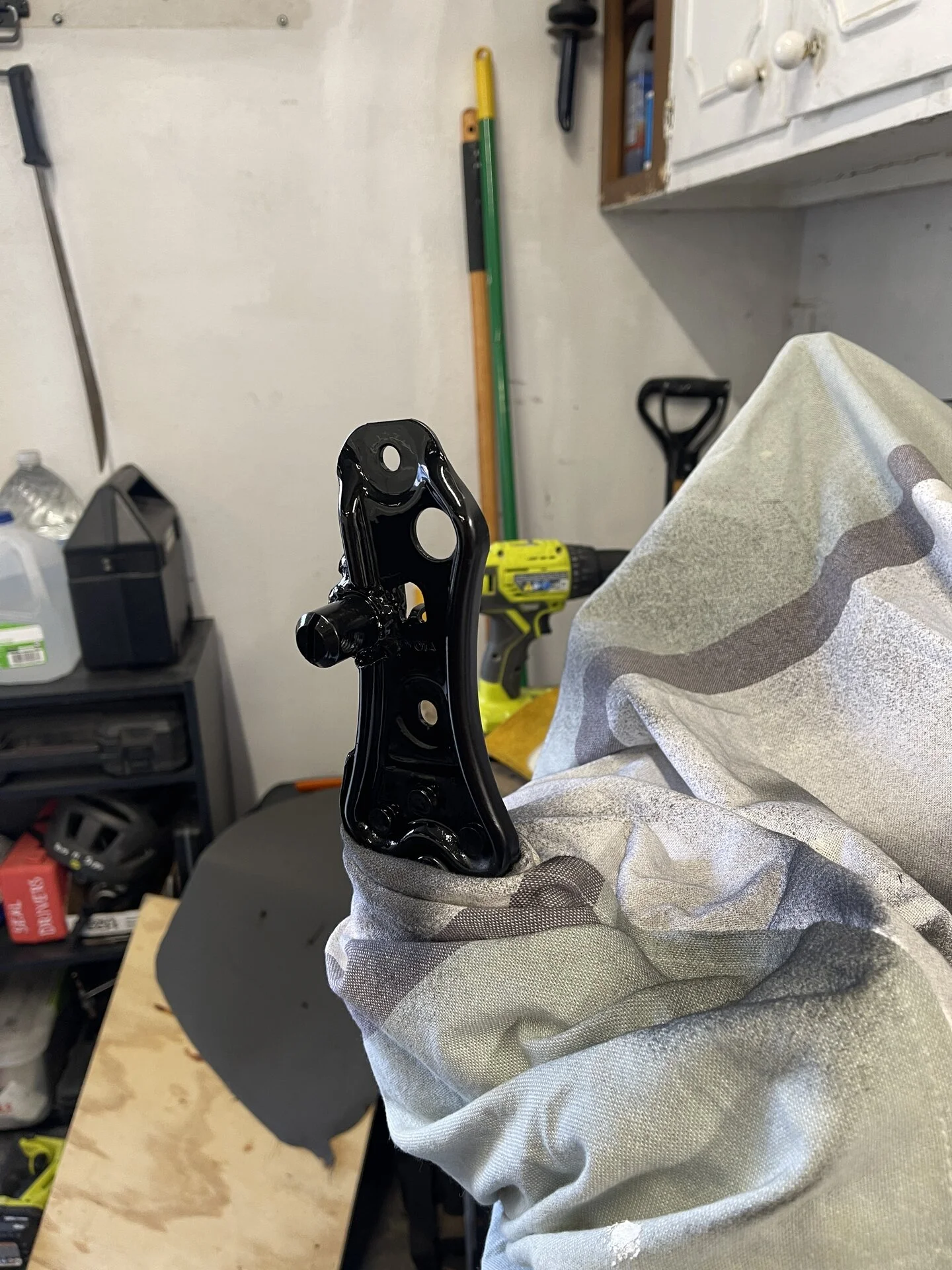

I was happy with it, so I boogered it up with some welds, cleaned it up and hit it with some VHT chassis paint:

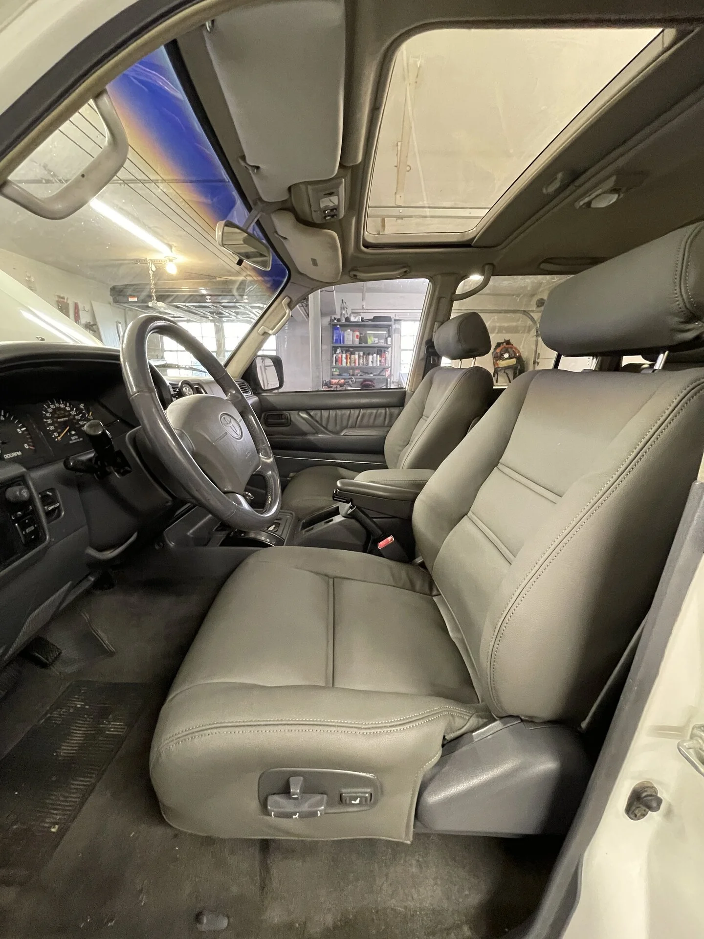

And the results.To me it looks almost factory:
