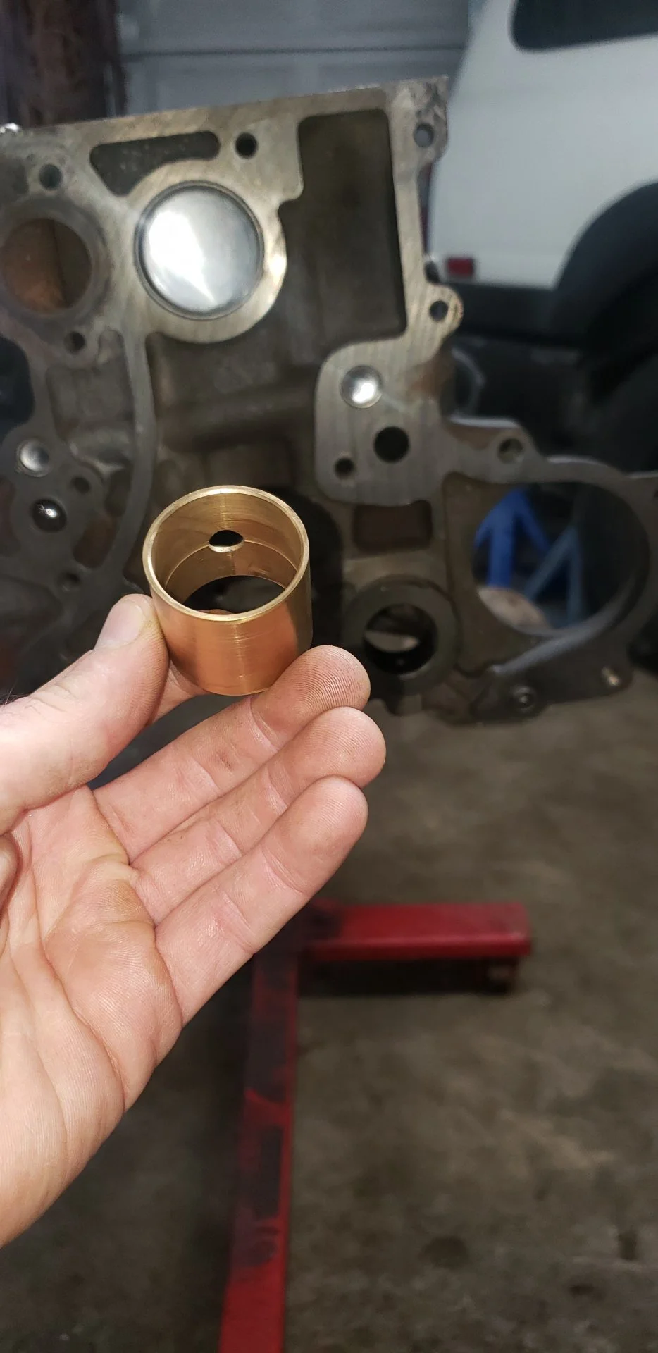

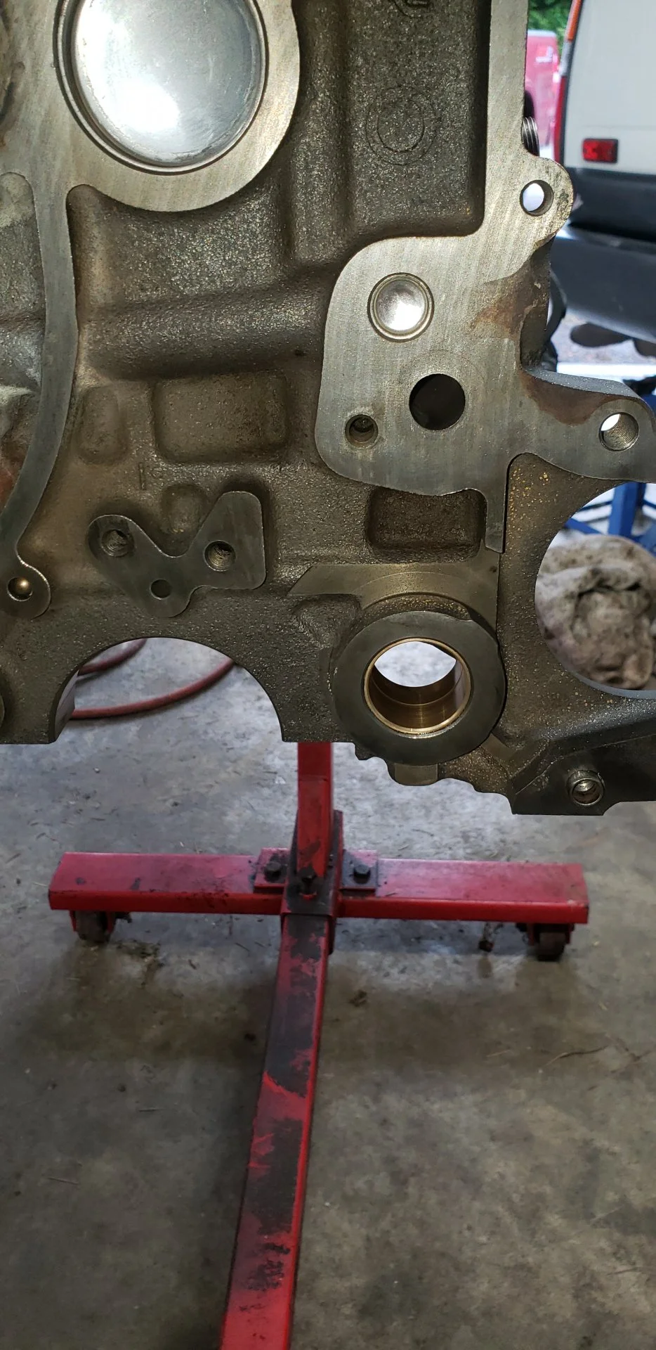

Ok I found that bushing but my question is what way do I put it in? The bushing has one hole on the side but the spot to press it in has a hole on the top and a hole on the bottom towards the pan. Do you remember?
This post might help.
