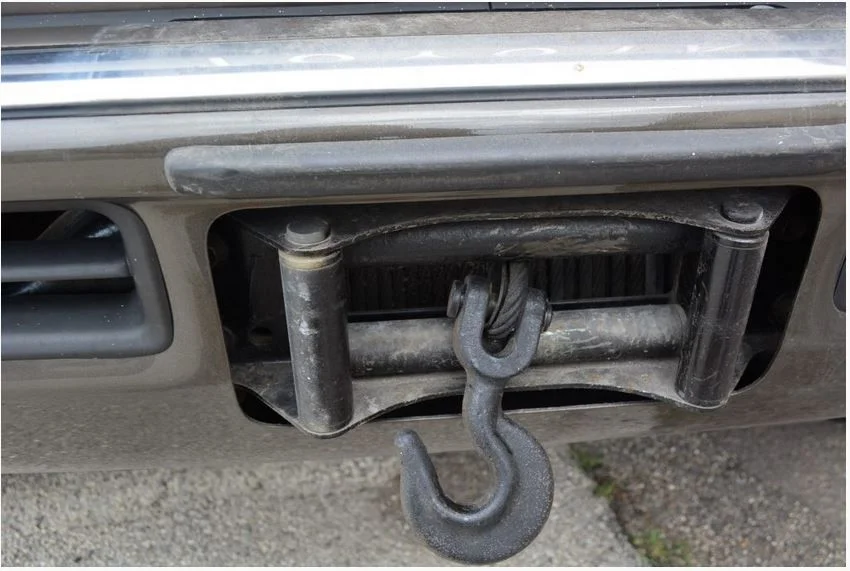

I've got a question for you real gurus out there. My 80 Series truck is a JDM, right hand drive 1HD-T 4.2 Turbo Diesel. It came with a factory winch.
I used my truck s a second vehicle, winter driving/home depot/etc.... So I removed my winch because I was afraid winter road salt (here in New England) would destroy it.
I was thinking about replacing it with a front receiver mounted, removable winch.
I can find 10,000lbs winches under 100lbs. Synthetic less.
Question, is this winch any good? I can not find any specs or ratings on it.
It is extremely heavy, Maybe 150lbs. Guestimation.
Is it any good, are there tricks or updates to this unit, Like maybe a replace the cable with a Synthetic rope?
Keep-Ditch-Sell, Looking for any word or recommendations.

Those OEM winches ar very robust, a few of my freinds in central american have them on VX HDJ80s. But fairly slow geared IIRC. Why no keep it?

From memory it's an 8k winch, or there about. The bumper is the real killer. If you plan on offloading and using the winch for recovery the bumper will get destroyed.
For that purpose I'd pull everything and sell it and put on something more substantial.
On my first truck I went with a Slew shortbus and hydraulic winch. A hydraulic with synthetic line is probably the lightest winch out there.

And you right-on, the bumper is extremely light, (and with the large cut out, I don't expect it to be strong)
I can see it getting destroyed very quickly.
