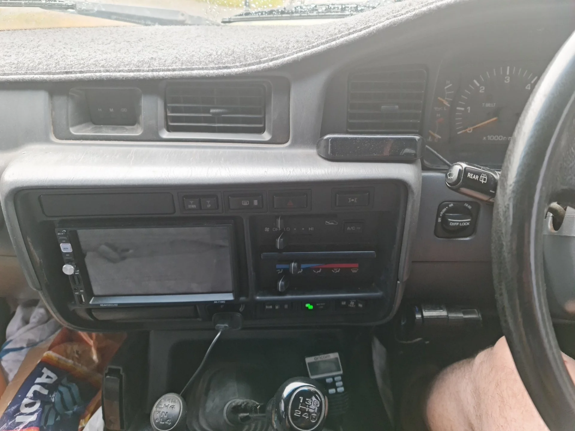

I just bought a generic cheap unit from ebay, direct from China. Here's the one I got:
At the time the price was $63AUD, a steal. Came with an inbuilt GPS function too. I got this ISO adapter harness:
So around $70AUD all up. Here's it installed:
Gives me AM/FM radio, bluetooth from my phone, offline maps navigation (handy for remote places without cell signal, which are very common here in Australia), and it's hooked up to the reverse camera, which is the main reason I wanted a 2-din fullscreen unit like this. I hooked the camera up with that rear heater button you see on the bottom right. The "LO" position is "Auto", which means the camera will come on automatically (within 1s) as soon as I pop the car into reverse, and turn off when I go out of it. The "HI" position turns the camera on manually regardless of which gear I'm in, and center position is off. When I get a label maker which can print white on clear, I'll re-label the button.

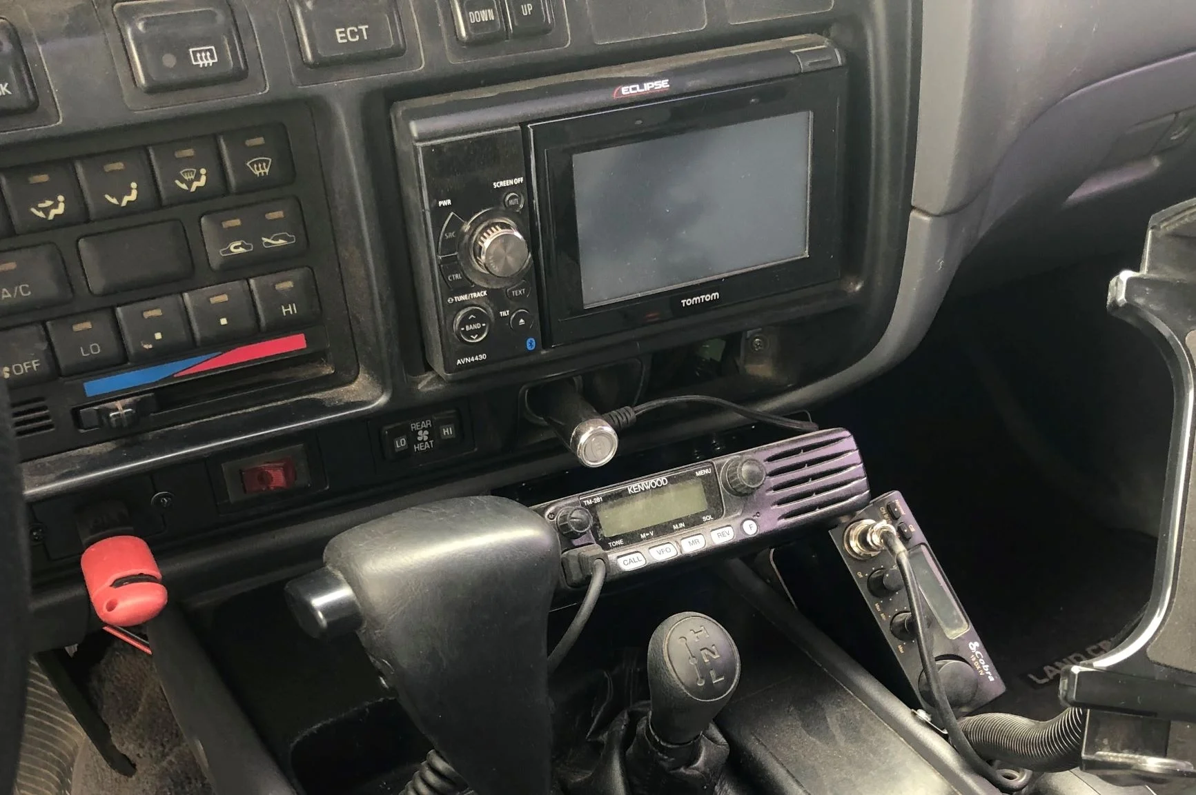

Several years ago, the LCD on my OEM radio/CD/cassette unit bit the dust. Oh everything else worked - I just couldn't see or verify what was playing or radio station was on. So I replaced it with an Eclipse head unit with a removable Tom Tom GPS unit:
I mounted the USB connector so I could change thumb drives with one hand. Also remove the Tom Tom/display unit when the temp drops below freezing to help it last longer. But recently, I need to replace the radio/CD player in my 1998 Ford Ranger, that is also double Din - very similar to the 80, which is why your thread caught my interest. So, I've been wearing my eyes out looking on Amazon & Crutchfield the last week or so. I decided on a Boss BV9386NV unit for several reasons. The reviews on Amazon show that even the higher priced units($300-$600) have occasional problems and dissatisfied customers - so you just make the best pick that you can with the features that you want. Some of the newer ones have dropped the CD drive and I like having it as a back up, although CDs suck off road, due to the bouncing around. A larger screen would be nice for running Gaia if you're able to put the app on the head unit and run it on your phone. I run Gaia on my iPad and have a holder for it, but a large screen on a head unit would be better - for off road bouncing.

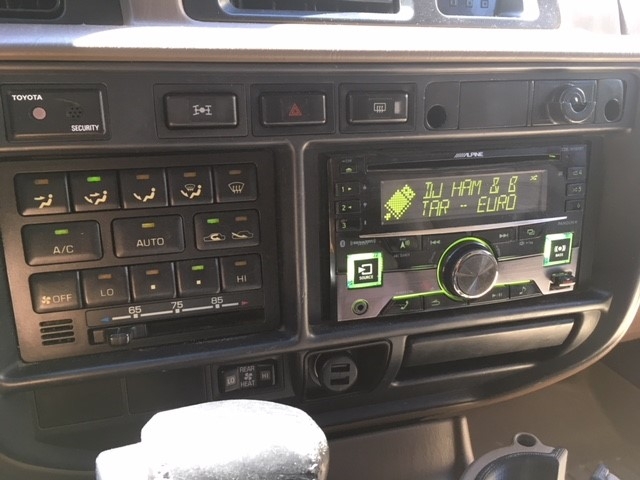

I've got an Alpine CDEw265BT which they don't sell new anymore. You can find used though on ebay. It's got modern features like bluetooth, USB and Ipod connectivity but is not touch screen (which I don't care for in these trucks) and allows you to adjust the lighting color to one that matches the factory green. I think it looks like it belongs... could just be me though.

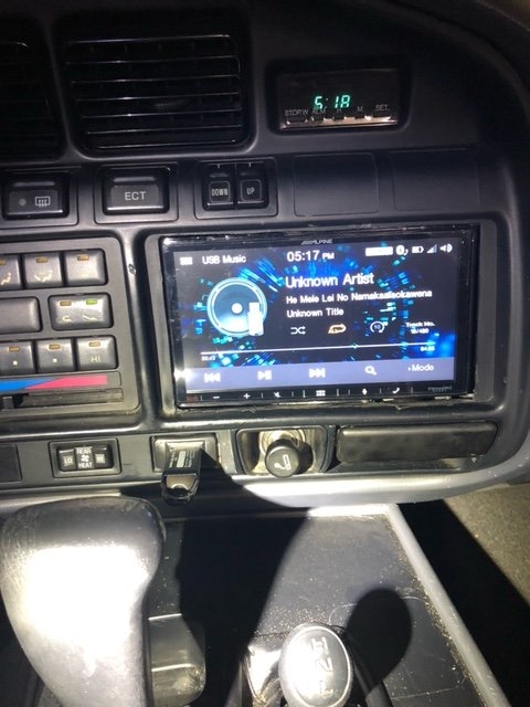

I recently installed an Alpine ILX-w650 with KTA 450 power pack. Great unit with Apple Airplay. Added a USB to one of the blank cut out on the dash (Next to the lighter).View attachment 2666458
I've got one of these that I started to install in my LX450. It looks to me like the mounting bracket alignment isn't in the right place for my existing mounting holes. Were you able to reuse your existing factory brackets, or did you do something else?
Thanks!

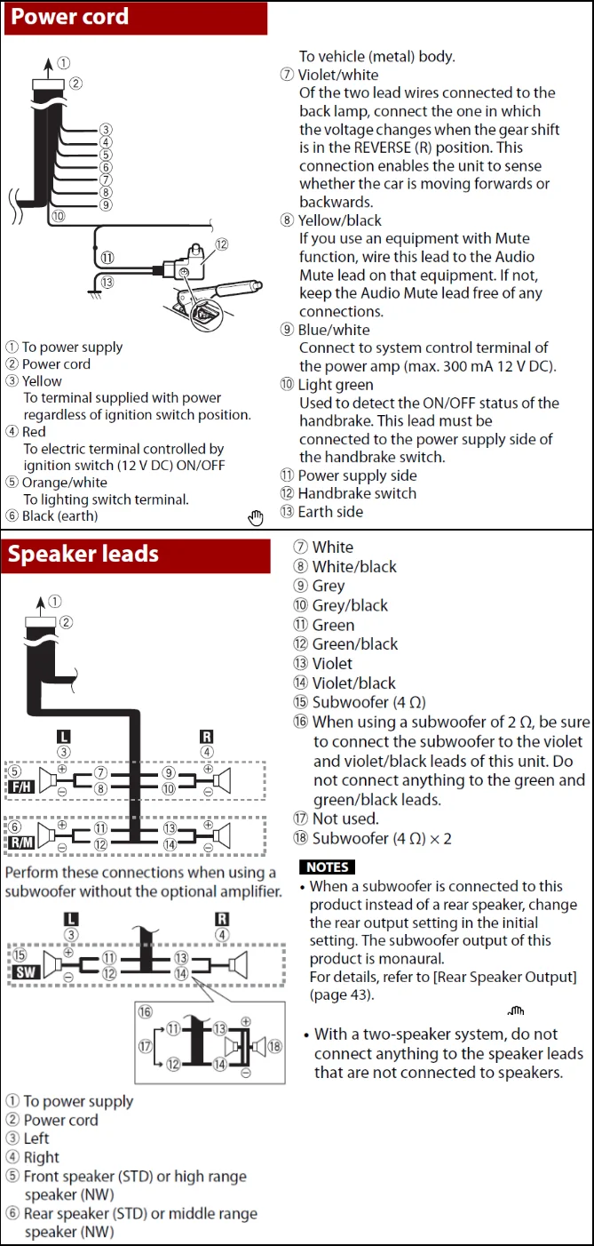

Anyone have any idea why my aftermarket headunit does not turn on and off with power, but rather just its own power button? I've confirmed the wiring is correct.
Only time I have seen this happen is when the yellow(constant 12+) from the headunit is hooked up to the Red (switched 12+) on the adapter harness. But if the wiring is correct it may be a programming issue in the new headunit. What's the make/model?
Sorry for hi-jacking!
I will triple check the wiring when I have time, tho I am confident I did not mix up colors haha.
I have a Jensen MPR2110 using a Metra 70-1761 Receiver Wiring Harness.
Also, generic info you can google anywhere but probably nice to have in this thread for completeness sake: What all the coloured wires do on the conversion harness you buy to go from modern head unit to toyota wiring. Once you plug in the conversion harness, you can see what the colours convert into on the Toyota end. ie. from memory the orange/white which is used to detect whether or not headlights are on is actually a yellow cable on the toyota side. The conversion harness sorts it all out for you though.
