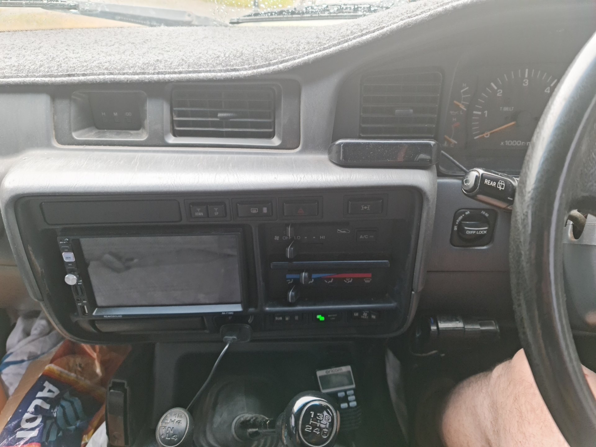

I just bought a generic cheap unit from ebay, direct from China. Here's the one I got:
At the time the price was $63AUD, a steal. Came with an inbuilt GPS function too. I got this ISO adapter harness:
So around $70AUD all up. Here's it installed:
Gives me AM/FM radio, bluetooth from my phone, offline maps navigation (handy for remote places without cell signal, which are very common here in Australia), and it's hooked up to the reverse camera, which is the main reason I wanted a 2-din fullscreen unit like this. I hooked the camera up with that rear heater button you see on the bottom right. The "LO" position is "Auto", which means the camera will come on automatically (within 1s) as soon as I pop the car into reverse, and turn off when I go out of it. The "HI" position turns the camera on manually regardless of which gear I'm in, and center position is off. When I get a label maker which can print white on clear, I'll re-label the button.
wow cheap. a few Q's: hows the audio sound quality? screen clarity? and can you run a second reversing camera for a caravan?
Sound quality is as good as you get from stock speakers - I haven't changed them. I'm a sceptic of how much difference head units make with audio quality at all frankly, it's just a DAC running into a MOSFET, not much to screw up there, and they're all made on the cheap out of a factory in China or Taiwan, same same.
Screen is clear enough, certanly more than adequate for a reverse camera fine.
There are two video inputs, one dedicated reverse camera, one "aux", so you can do two camera inputs on the head unit. I actually have two different reverse cameras on my 80 actually, one at bumper level, one up high, but I got fancy with some dash switches and manage this outside the head unit. I can switch between the two cameras and set them to auto (comes on automatically in reverse), always off, or always on.

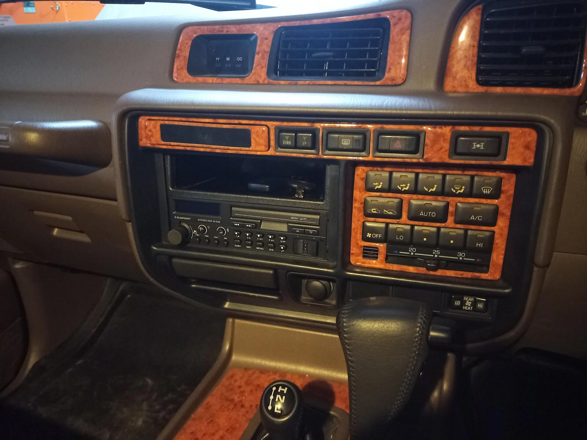

I went from jdm japanese only jdm double din touch screen head unit to this single din with storage compartment.
I realized that any touch screen display will sit way too low to be practically usable. I also wanted an oem look. Since 90's cars do not have a lot of storage, it helped me in my decisions so that i could also get a storage compartment for wallet and phone, etc.
I chose the blaupunkt Frankfurt rcm82, its got phone connection, blutooth, sd/usb slot/aux input / remote usb input, oem look and also RGB led backlight that can be adjusted to be any color you want or (Toyota oem green)

Although I think the one pictured is the Blaupunkt Bremen SQR
Indeed thats a Bremen SQR 46 DAB, and I intend to get one when I can budge on spending $450 on a head unit. Looks great @charlay61
