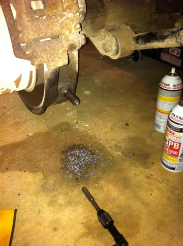

It was noted in another thread that shocks were not required for a car to be road worthy. I can confirm that as I drove my junk to the crawl with essentially no shocks. In fact the lower bushings on the rear shocks had disintegrated, and I had to zip tie both rear shocks to the shock brackets just to reduce the noise from them rattling about.
I ordered shocks (and new rear springs) when I got back and set off to replace them this weekend. Front was pretty easy except for the fact that the driver's side upper stud is directly under the master cylinder and there's virtually no room in that area to turn a wrench. The rear was another story altogether.
I had read numerous threads/how-to's which warned about breaking off the rear lower shock bolts, and I took just about every precaution I came across - soaked the bolts best I could every day (and sometimes twice a day) for over a week with PB blaster, beat on the bolts a bit before trying to break them loose, tried to actually tighten them before trying to break them loose, and used a ratchet and cheater pipe (as opposed to an impact) to apply gentle constant pressure as I tried to loosen them. The only thing I didn't have at my disposal was a heat source...and that is probably why I broke both bolts off.
After reading all those threads ahead of time, this seemed like a very common occurrence and I was prepared to have to drill the bolts out and re-tap the threads. What I was not prepared for was the amount of work involved in doing so. I read one thread where a shop quoted the owner 5 hours of labor to do this. At the time that sounded ridiculous, but after last night I can confirm this too.
I'll be the first to admit that I'm learning about this stuff as I go, but last night involved about 3 hours of this process - get under one side of the truck, contort body into very uncomfortable position that allows you to both obtain leverage on the drill and keep the bit in line with the boss (or whatever that thing the shock bolt goes into is called), drill at a slow speed until the material gets hot or your body gives out from holding the jacked up yoga like pose, clean hole and drill bit and apply oil, move to other side of the truck, and repeat...going back and forth until both sides are completely drilled out.
Eventually I made it through and was able to tap new threads and get new bolts in (although they are too long and will either need to be cut down or replaced). This isn't cotton field sexy, but here's a pic for posterity:
My Brother N Law is bad ass. Good stuff JT!
