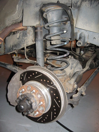

I run 100-series OEM pads on the front with Slee cross-drilled and slotted rotors, on the rear I run Slee cross-drilled and slotted rotors with Duramax Gold CMax 80-series pads. I also run the Slee stainless brake lines.
I firmly believe my braking performance increased with the 100-series pads and the Slee cross-drilled and slotted rotors. I think you guys know how weak my legs were after the accident and I never had an issue slowing my truck down and my truck is heavy.
None the less, in regards to the holes in the rotors, I just pressure wash them after wheeling from the front and rear and I haven't had an issue yet.
I highly recommend the setup. I swapped the rear 80-series pads for the Duramax Gold CMax pads and haven't noticed a difference.
