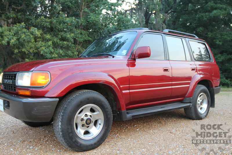

If it just weren't maroon!
If it were any color someone would say that same thing, just insert the color at the end that others don't like.
Personally I like it....I like the lighter red better though.

that truck IS awesome but that color is the WORST one Toyota ever did

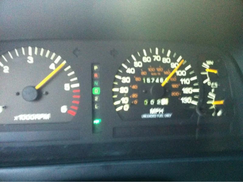

No sweat on the 100. It is priced right. I may get a FS post going on it and keep this 80. It is the cleanest 80 inside on the planet at this point. More details later on that. The OEM parts took care of the running rough at idle and I found some vacuum lines unhooked and the check engine light went off. Gauge is still showing it running hot but I pulled the cap and hit the water in the radiator with my IR gauge and it read 150*. I need a sending unit. Got it up to 105 mph tonight. No vibrations. Smooth as glass. Needs tires and an alignment and some small things. FS thread going up tomorrow.

the 80 looks good, but I can't get past the color...my favorite 80 color is the grey.
Tom over here in Auburn, being that he works at APR, loves to go fast and in his 80... he routinely goes that fast in his junk.
A few months ago, I filmed myself on the interstate doing 110 in the tundra. Sadly i just should have filmed it normally. but I started through the FB app and it would never upload and I ended up loosing the video. I had about 20 miles of NO ONE on the interstate due to a wreck so i decided to open it up.
The picture at 105 was blurrier, this was all I got
I hear it smooths out just past mach1 right after a big backfire. No personal experience - just what I heard.
I did that in my LX but blacked out just after 106... woke up in 1972. Groovy.
