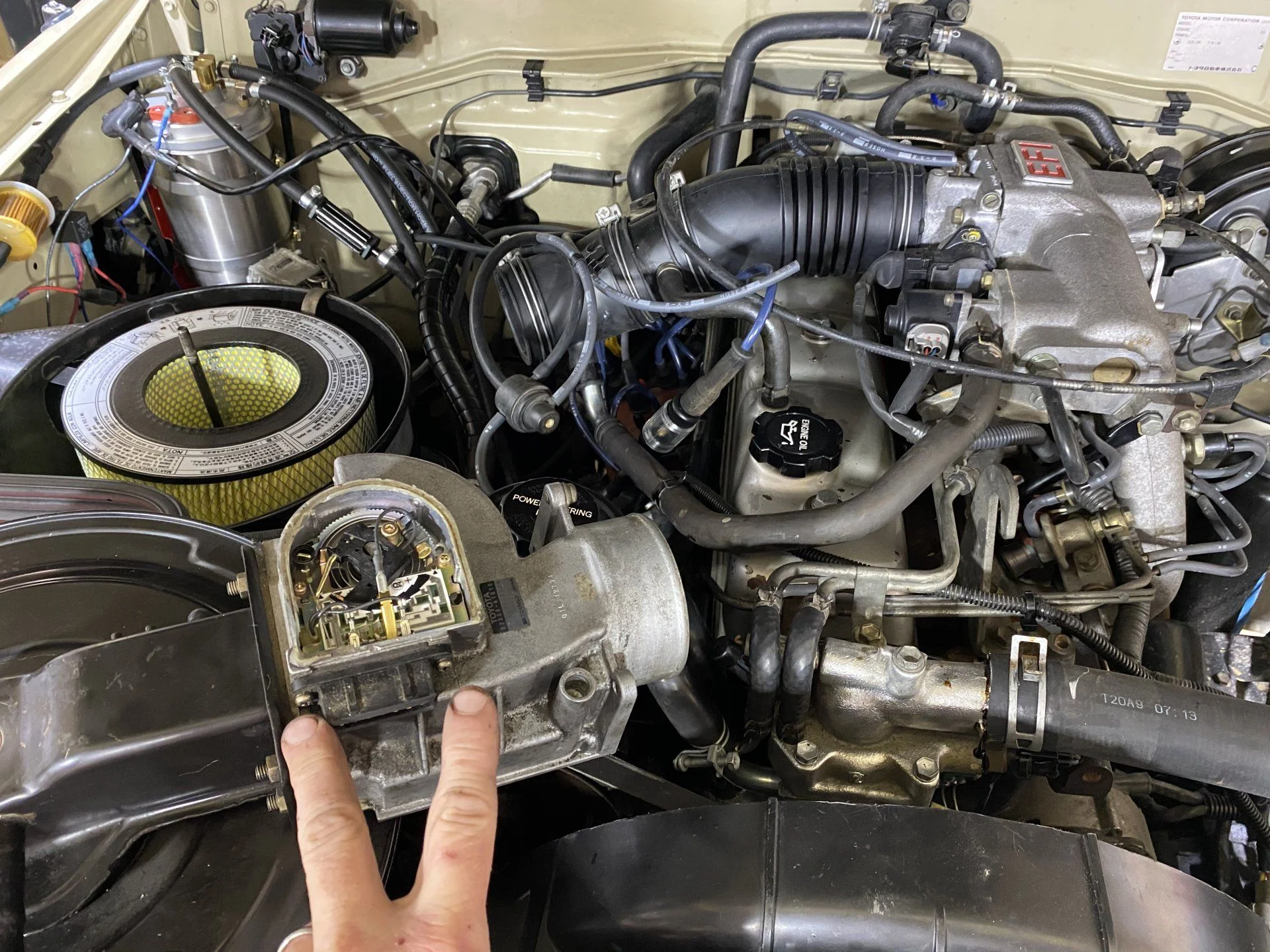

Don’t ever unscrew these two screws and take a peek.
A quick mud search would’ve told you that. You’re screwed now. At least you have a broader selection with a 3fe and can pull from a 62 or 91-92 80. If you screw up one from a 93-94 80, that’s when it becomes as issue. Stay away from the Chinese knock off. Will appear to be OEM, even comes in a Toyota box. A proper reman doesn’t exist either as they are usually opened to be cleaned and damaged. That leaves you with used. Make sure it was removed from a running truck. If seller has a 3fe see if they can test before shipping. If you find one that is way less expensive than others out there I guarantee it will not work correctly.
What is it and what happens if you do?
Air Fuel meter.
The clips are barely on the circuit board and they separate.
Going to get them soldiered back hopefully
God...that looks like the miserable clock spring/gear mechanism inside the POS e-locker motors that everyone loves so damn much.
Haha. TRIPLE LOCKED OR DIE!

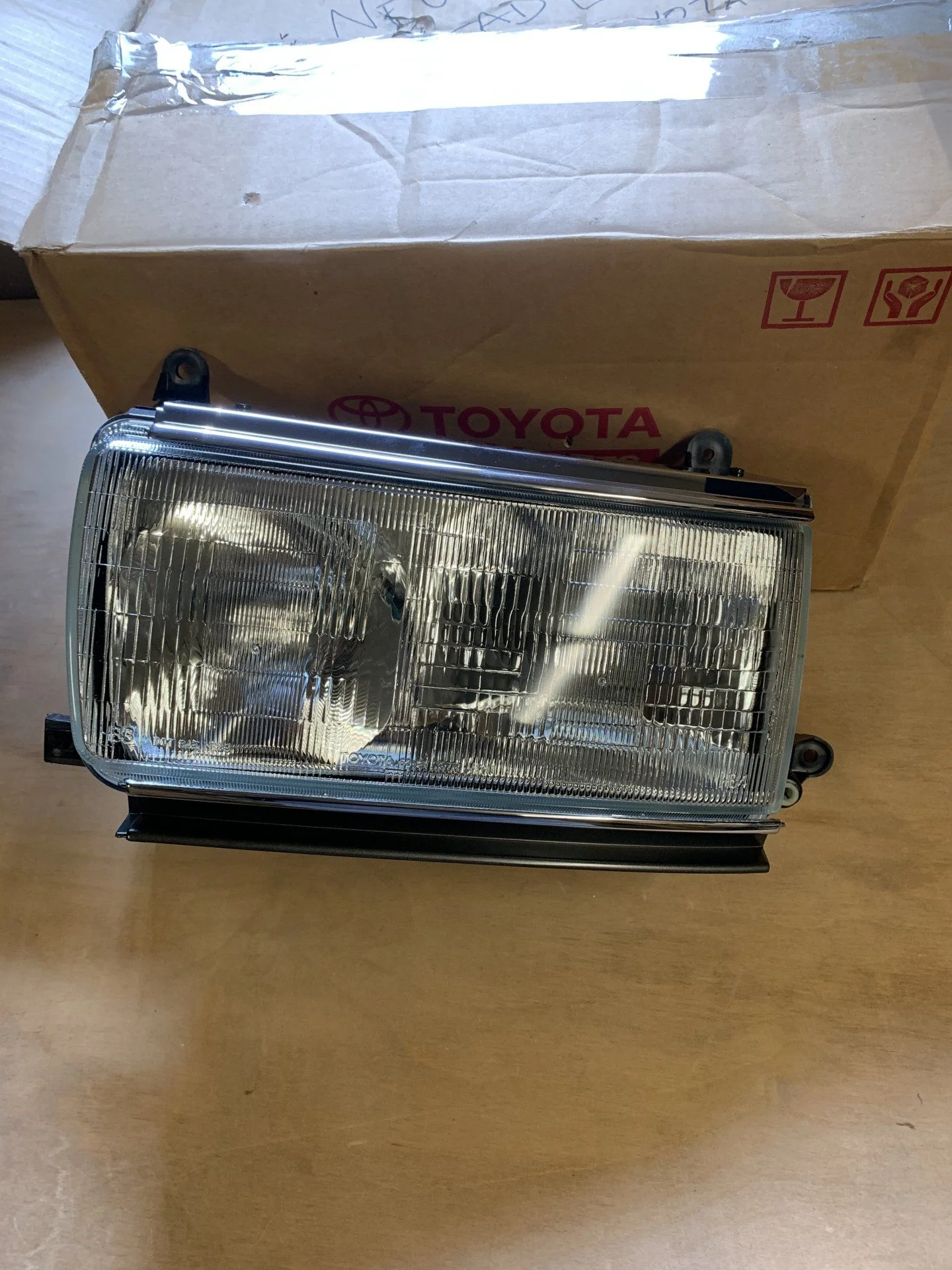

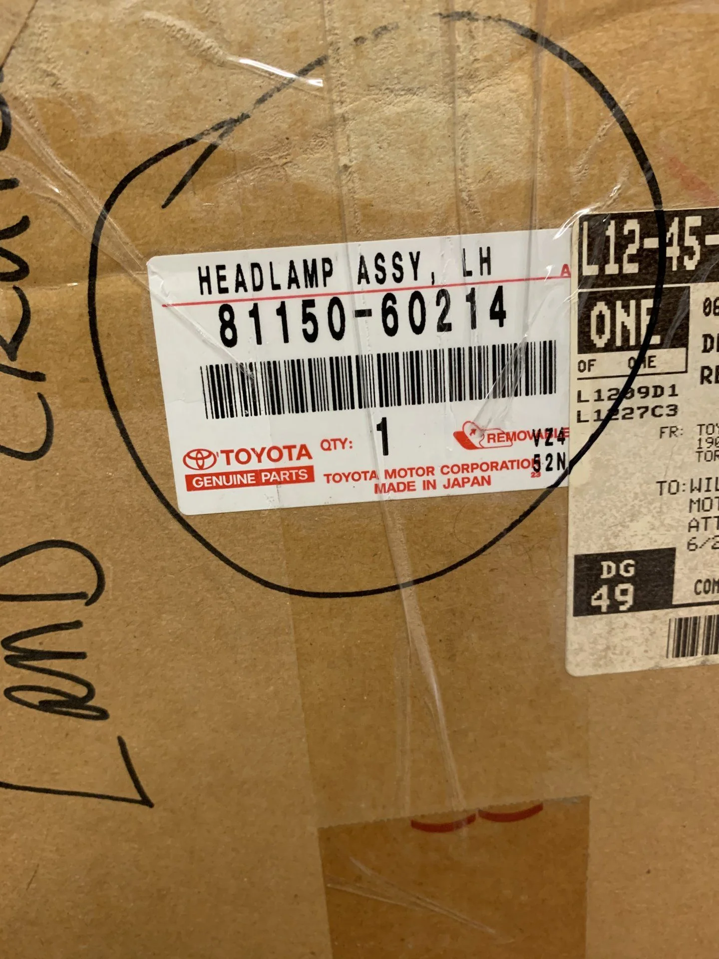

Talk about a blast from the past. Part number, 81150-60214 shows it’s for 91-94 and I just cant bring myself to install it on my 94 as it will just get destroyed and I will have to cry. Im sure I can retrofit it into my 97 but am going with depo’s instead. For the time being it will live in my closet...if you can use it make me an offer as I have no idea how to price something that just doesn’t exist anymore.
I'm glad I'm not the only dumbass around here! I soldered mine back and it was a PITA, but it works and runs better than before. Only thing is the CEL 24 is showing now.
I found a mention of this guy on ebay, RESURRECTED AUTO PARTS | eBay Stores. No affiliation. Yours looks about the same as my '94 AFM.
Edit: If someone on MUD is a good solderer, then they could make a good side job of repairing these AFM's from the earlier 80 series. For some reason those two screws tempt a lot of people to pull them out, and as soon as you do, the solder on the tabs comes apart and no go.

New these are about $2000 shipped. I have $1500 in it. It has been installed in a truck but was never used.
