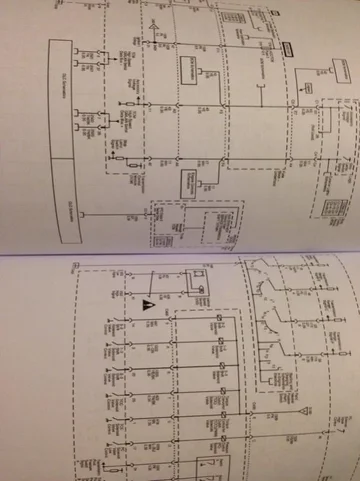

Rob is gathering parts. He has the part time kit. ordered the adapters. and now that he sold the lowrider. He is now looking for a V8.
Well. He has, an 80-series.
80-series- Check
Adaptors, mount kit & part time kit- In Transit
AU is 17 hours ahead of us
Computer with VATS removed and correct tire size and gear ratio-Check
Stand alone harness-Building my own
I am now having nightmares from these diagrams
Engine/Trans looking hard for right deal. Found some options but currently the weapon of choice is a Frankenstein 6.0 (6.0 with ported 5.3 heads) hoping for a better deal. These LS motors are EXPENSIVE to rebuild. Found a bunch of low mileage 4.8L but can't justify an engine swap for only 0.3L.
Trans is beefed up 4l60.
Still need to find some sort of wheels/tires I can use as rollers. If anyone has any laying around let me know. Don't care about looks just need to hold air.
