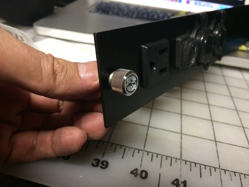

Finally decided on the thumbscrews for the skinny panels. These are captive, spring-loaded thumbscrews. They are similar to what you would see in the computer/networking world. These are JUST for the sign panel or the power panel. These are not for the large main panel.

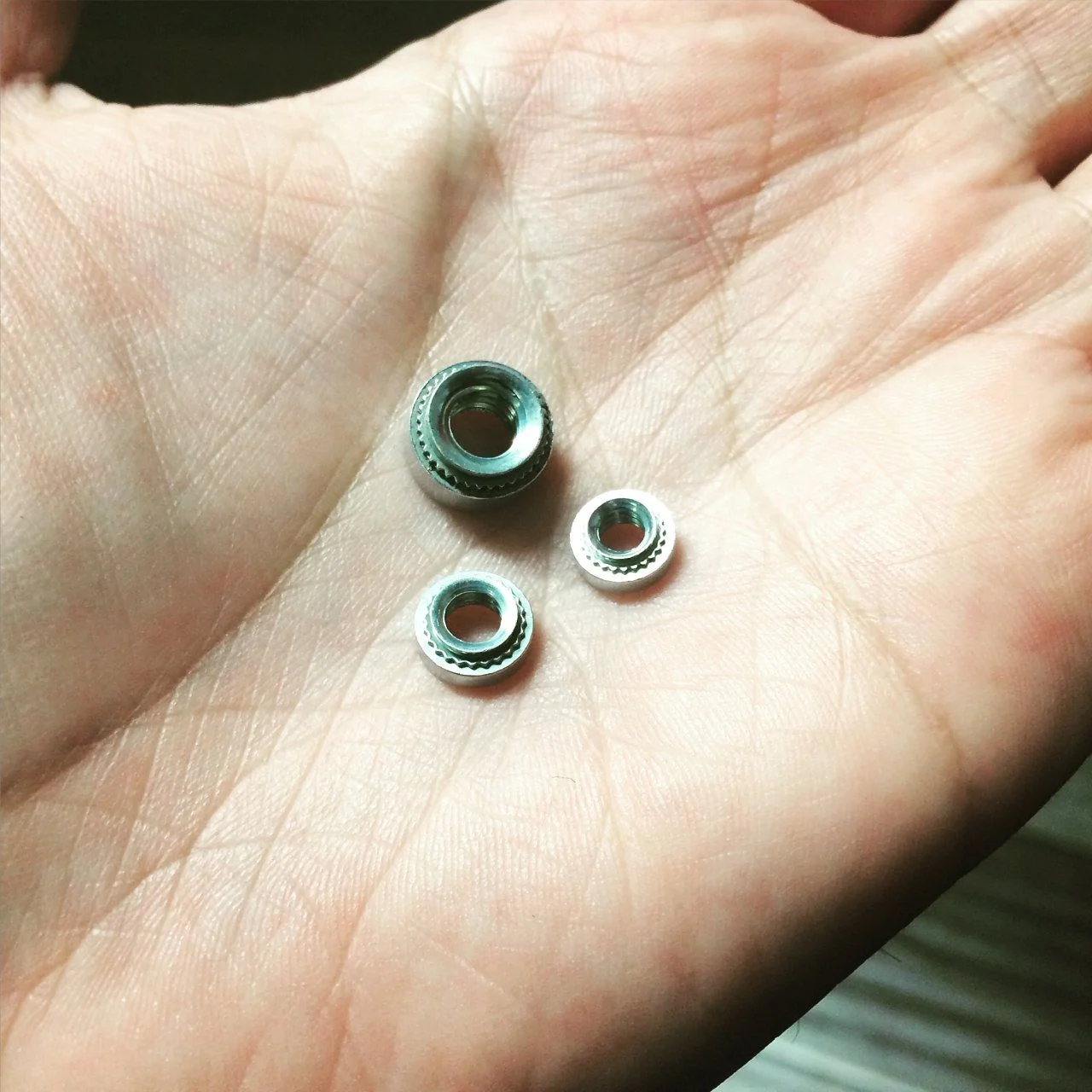

How are those nuts held in place? Back in the day we tried them and found them to come loose especially if you tried to install them after powdercoat, so we went with rivnuts instread. Application was more severe though, so could be a good solution here, just curious.
PEM nuts so arbor press. For the application it's overkill.
