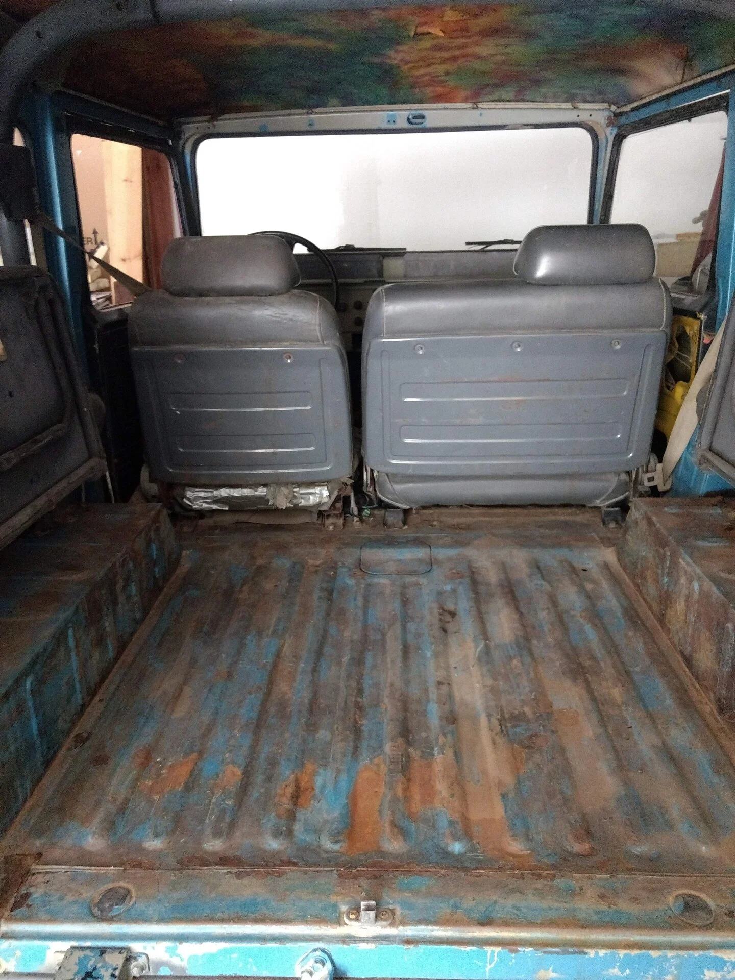

Here is my 7/79. Best pictures I could find. Looks like the long bar is on the passenger side. Vehicle is somewhere else to look at. Top is off a early 78 that still uses the hard top for the seat belts. Third mounting point is not the wheel well. It bolts to floor at the back of the seat. My 73 FJ40 uses the wheel well for the jump seat belts. With a roll bar it uses one of the four roll bar mounting bolt for the jump seat belts.
The one picture with rust color cruiser is my 68 I pulled the roll bar and seats belts out of a wrecked 79 back in 1983. Sure I kept the seat belts in their original sides. It's the same way.

Here is how it is s on my 4/80
