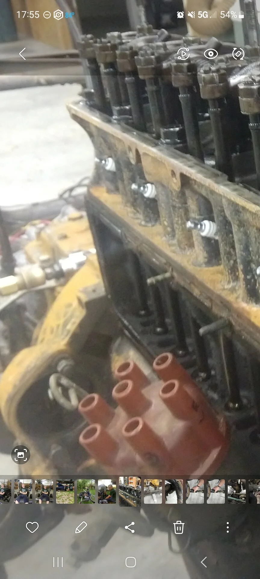

The dizzy in picture is a points dizzy based on the cap. A USA ‘78 was electronic so you need to understand that the dizzy AND coil/igniter are part of this equation.

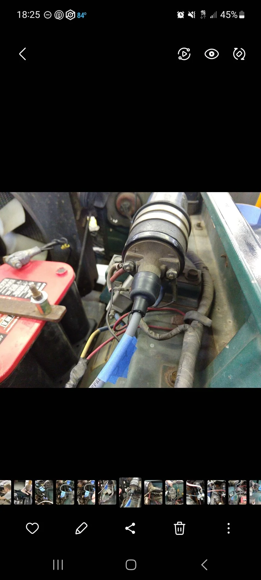

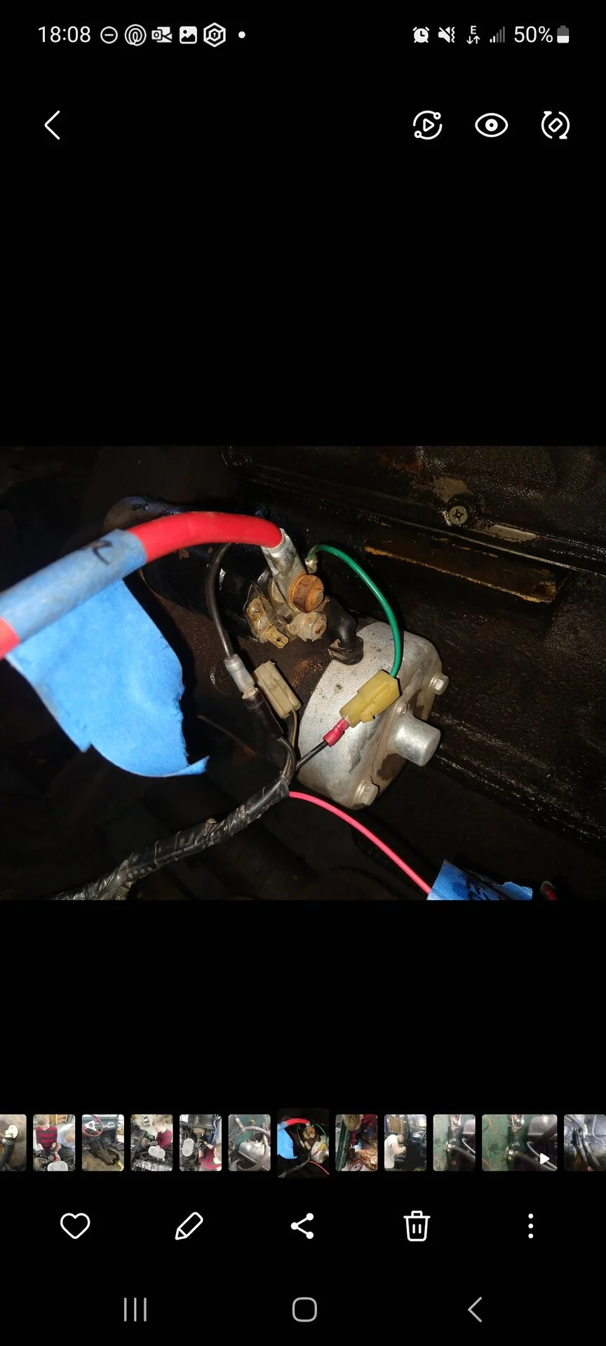

That's not a '78 coil/ igniter. Looks earlier.
Correct - for a USA market truck that is pre '75. USA Market '75-'77 used a coil/igniter combo to take the load off the points. Non-USA markets generally only use the coil/ballast resistor with points which is what the OP currently has.
