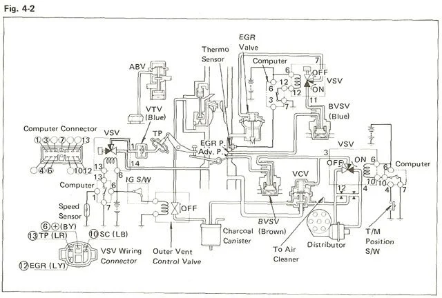

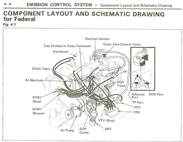

Gents I'm currently sinking too much scratch into my 60' trying to get it running well to by a 40 FSM, but am still trying to pass smog in my 40 and don't think my hoses are hooked up correctly.
Can someone help me out with the PDF's?:cheers:
Here are the '78 Fed spec from the FSM.
