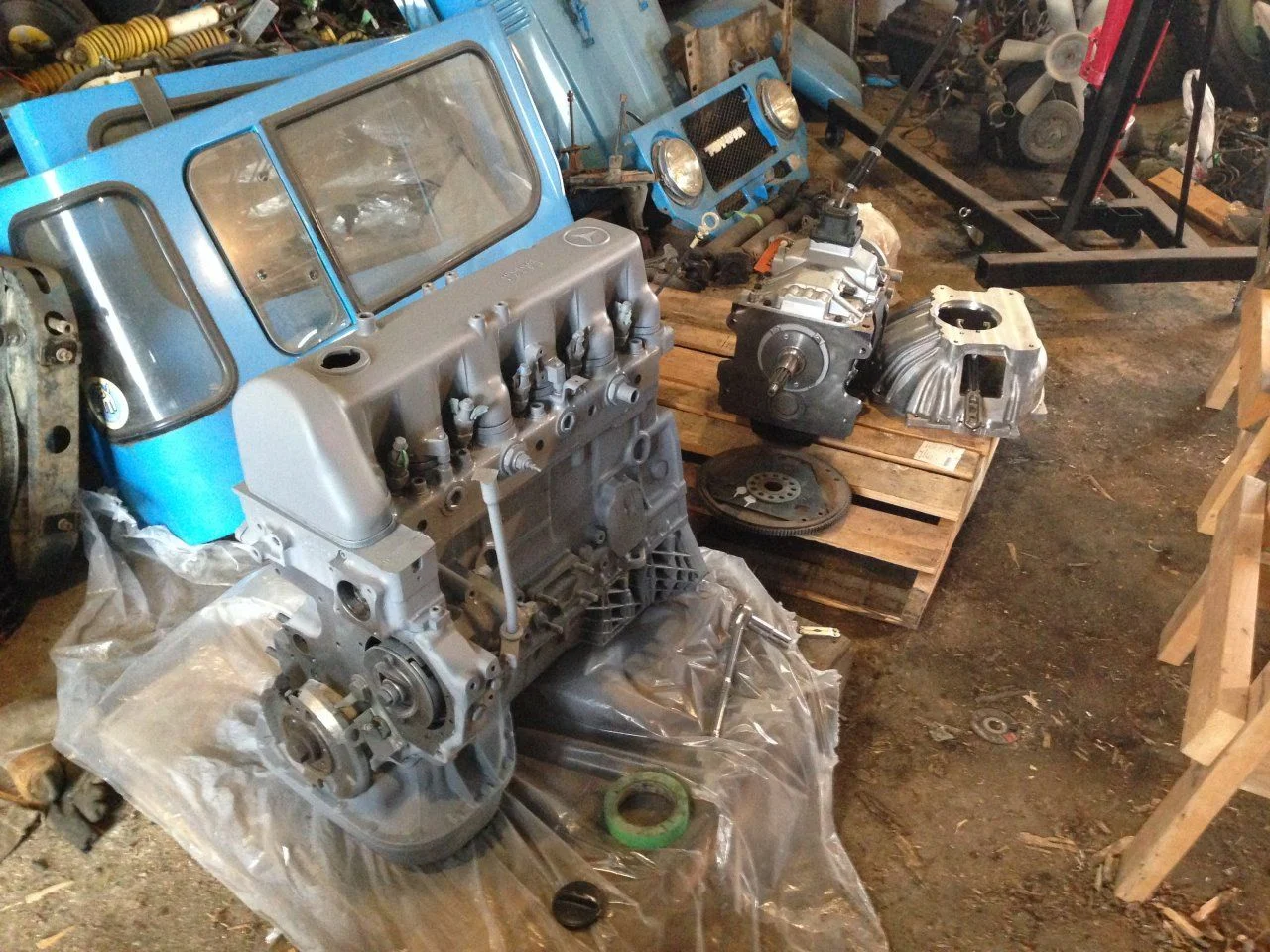

so here's what was inside those well packed boxes!! this is the beginning of my own version of the icon hopefully. I hope to do this truck justice though for the purist you'll want to read other threads. my purpose is a modern type drive line, diesel, unique and keep the old school look and character. plus it'll be super capable. It'll take a while yet but let's see what I can do.

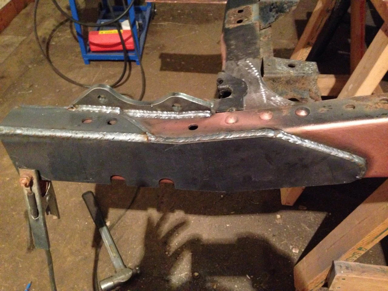

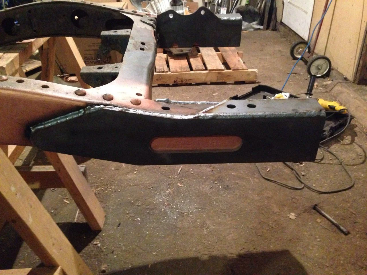

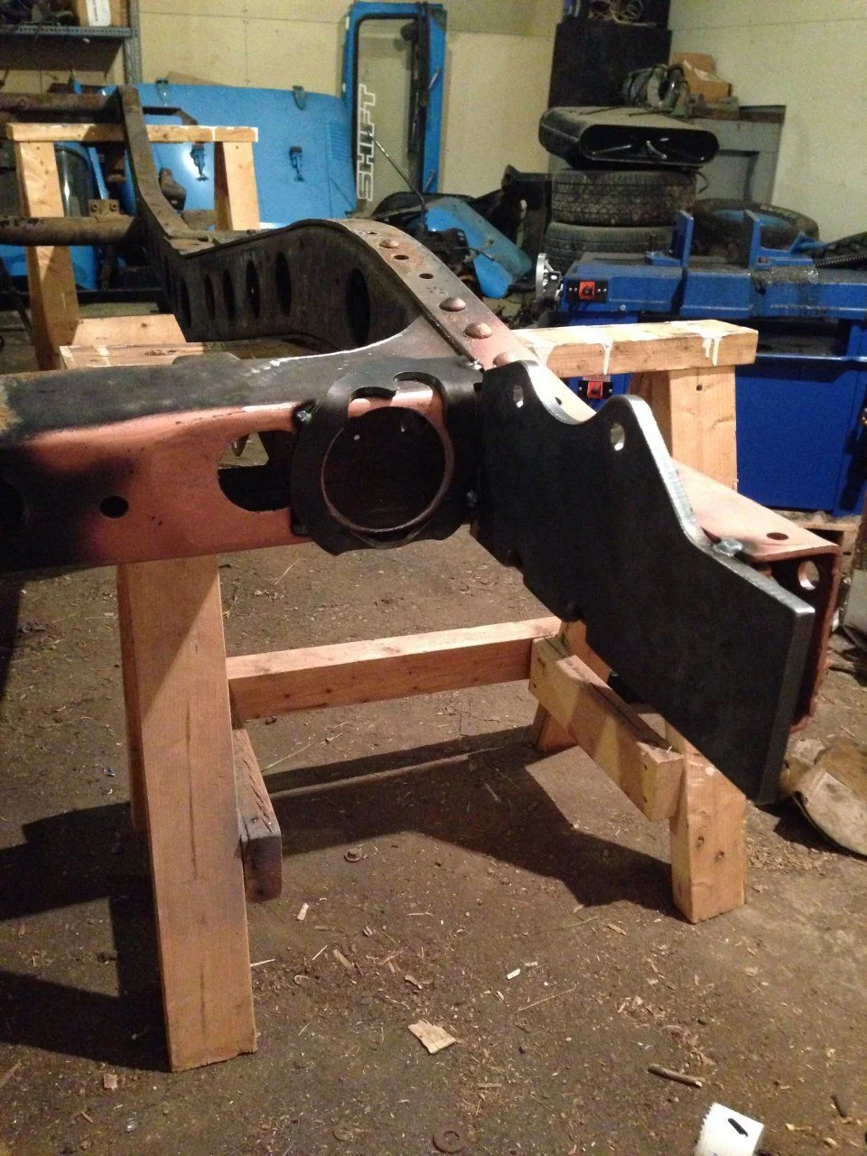

I finally feel like the build has begun. I started welding stuff on tonight. I got the 4x4labs power steering plates a few months ago and started putting them on tonight. they fit pretty well but there are a few gaps here and there to span. I think they're going to look good and my bonus here is I can flip my fame to get nice welds underneath too. I'm not very good at welding upside down as I'm still pretty novice at it
I cut the hole in the outside of the crossmember but my drill bought the farm on the far side. it's a good drill and less than a year old so hopefully I can get a replacement. I then tacked the rest of the plates in place and started the long welds

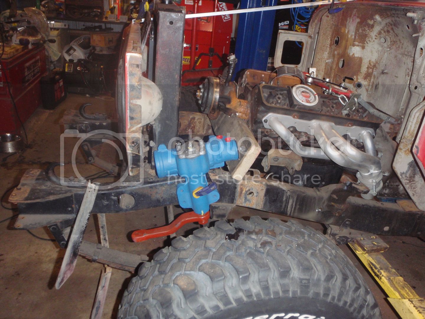

ordered a power steering box today and it got me thinking. what colour should I go with it? black like the frame to keep it hidden or should I go a light grey that'll stand out a little. should I clear coat it to keep the natural cast colour? truck will be smurf blue but I don't want it any real colour. just black, grey or natural I just don't know which one. I'm leaning black like the frame
spent some time in the shop again today. i have pretty much finished up welding my power steering plates in place. just waiting for my steering box to come in so i can adjust where the bolt holes sit and i can finish up this step. I'm getting to the point where theres not much i can do with out getting the next set of parts. they'll have to wait to january to order so I'm into next years budget. guess i'll have to work on my trailer instead. i did prime my engine today. figured i should get the self etching primer on before it rusts at all sitting waiting to go into the chassis. my plans are to go flat black for the accessories and the valve cover/oil pan. main block is going to be mercedes green from 1981 in respect for the car it came out of. here was it's last hurrah!

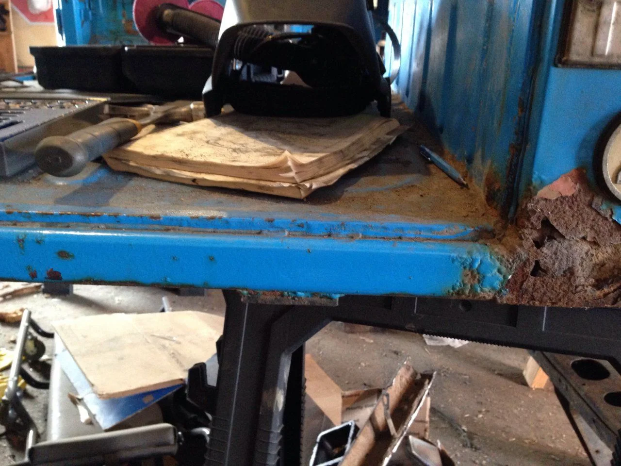

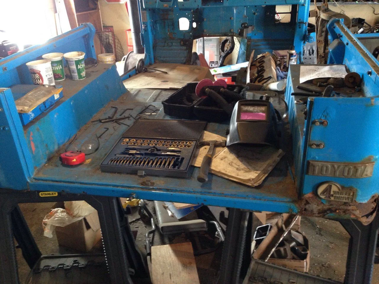

Steffen has recently posted a beautiful rear sill reconstruction and it got me fired up to try it out myself. as I went out to measure up the 2x2 steel tube length I noticed that I have a notch in the top of the sill just in the door opening. I then noticed that the straight section is full tube measuring 1.75 inches wide. the horns are 2.25 inches high and look original. is this the POs attempt to fix a rotten sill. should a 77 fj40 have a notch in the sill like this one? thanks for any insight.

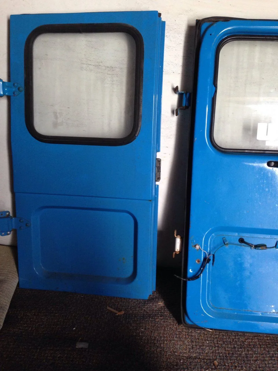

also these are my doors. they are rounded inside and square outside on the corners. are these the correct year?
thanks. i guess i'll have to figure out what actually needs to be rebuilt on my sill and and include the notch. seems that other ambulance door 40s have the same notch. that might make it a little more difficult but not impossible.
