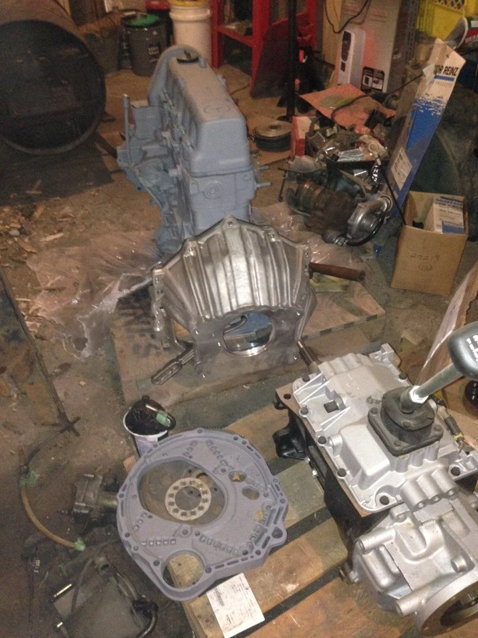

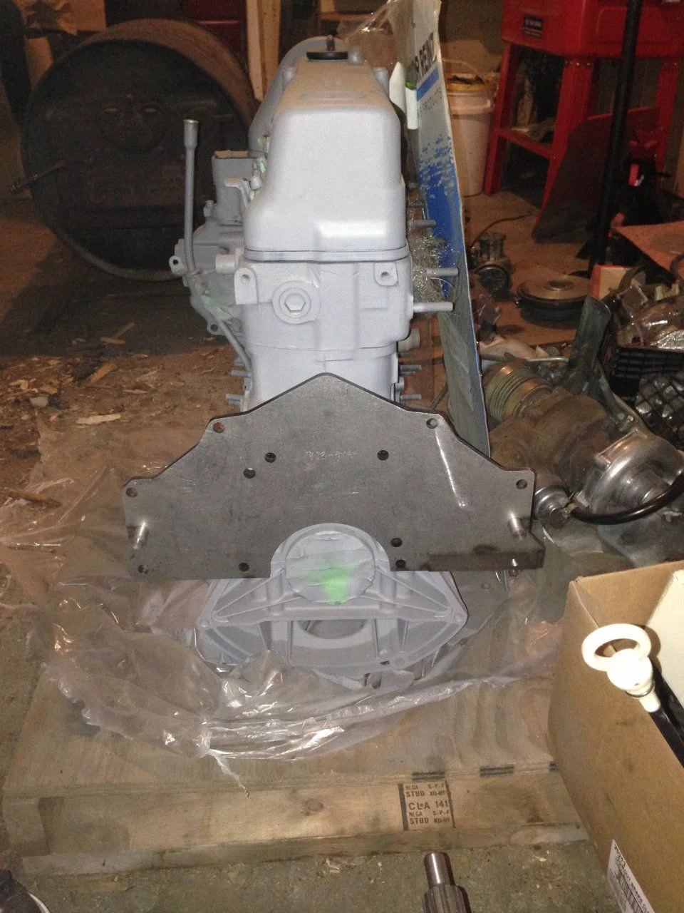

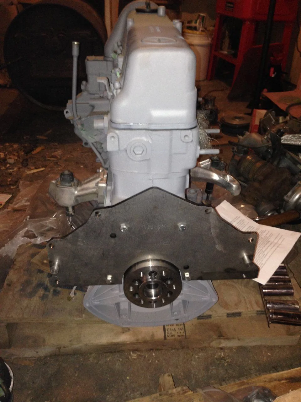

i think the adapter kit is going to work. i spent more time putting an axle together last night but trialed the adapter.

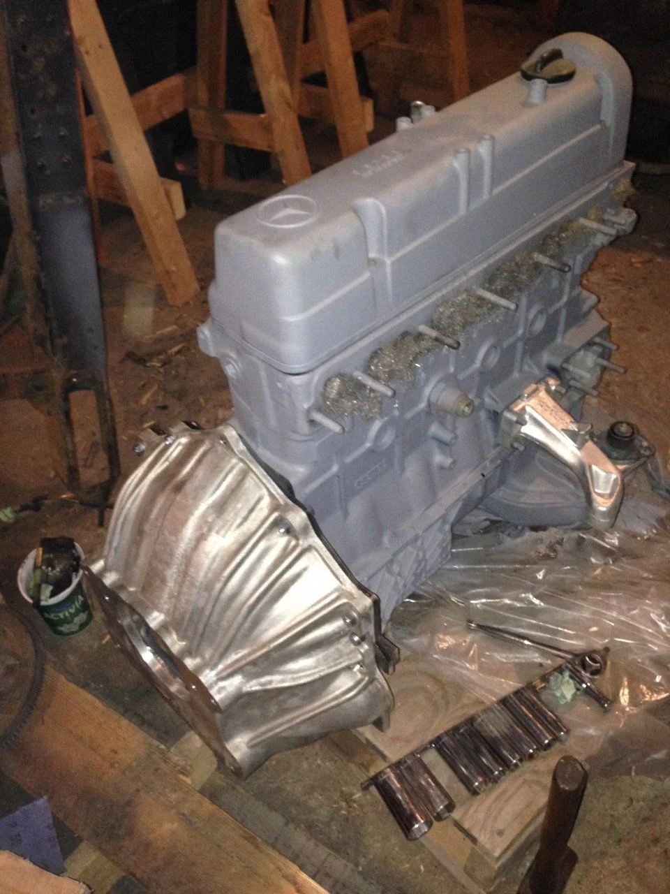

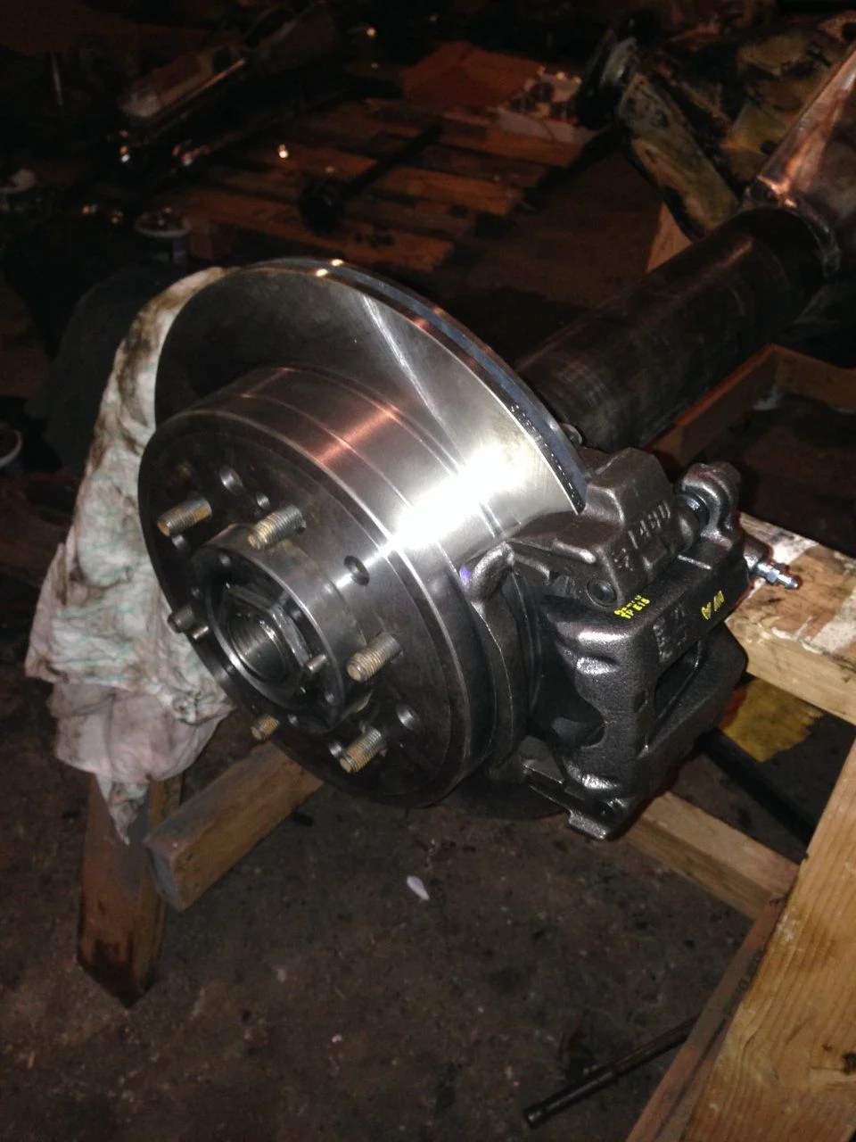

here are a few mock up photos. no seals or gaskets yet and no brake hardware yet.
ill post more in-depth install pictures and description when i actually assemble them for the last time! i love finally working with NEW parts! not all rusty and stuck!!!

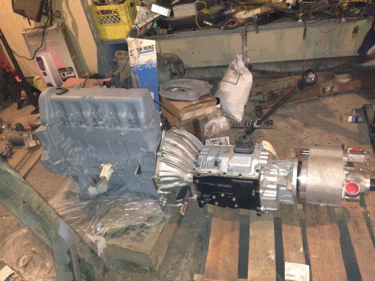

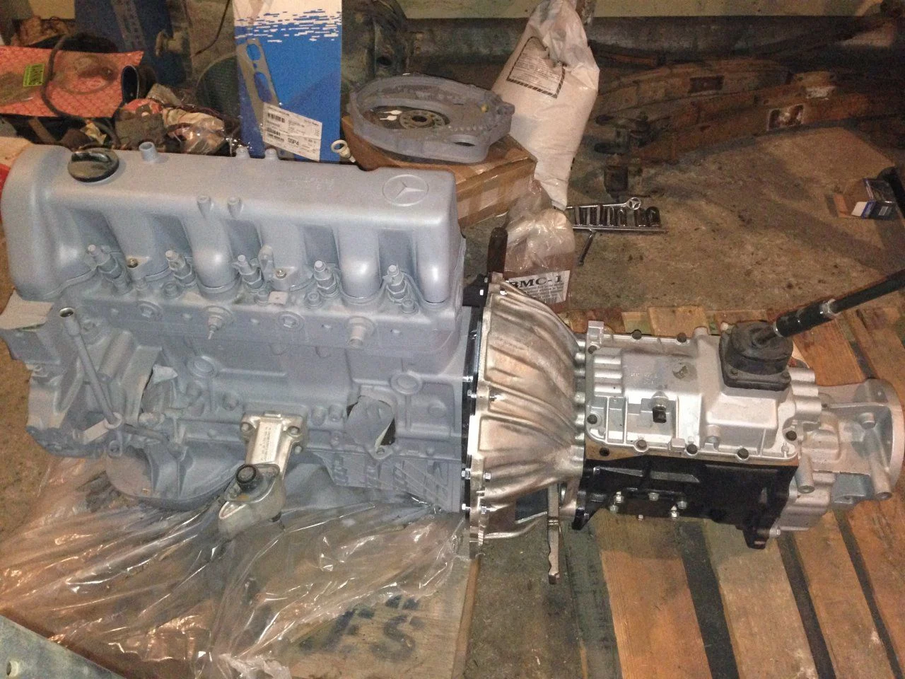

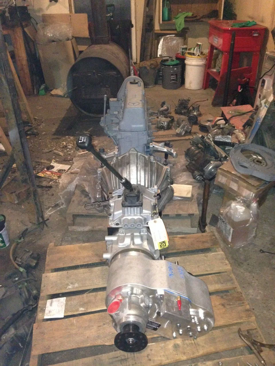

on the other hand the moment I've been waiting for nearly two years finally came...
the engine and tranny are finally mated!!! this is again a dry fit and no clutch and flywheel are in there yet but the adapter seems to fit!!
wow I look at these pictures and my shop looks like a disaster with all the parts laying around. even I wonder how I can build anything in that mess. I guess it's soon time to reorganize it. I'll need the room in the next couple weeks to start mocking the frame up!!
so far so good. i mean what mess!!

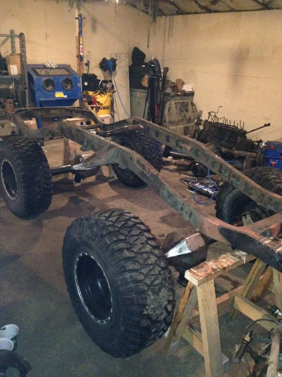

hoping that tomorrow I'll get to start organizing and positioning the frame in my shop to start mocking up suspension and motor mounts. my tranny mount is wrong so I need to find the right one. then I should be ready to build a cross member.

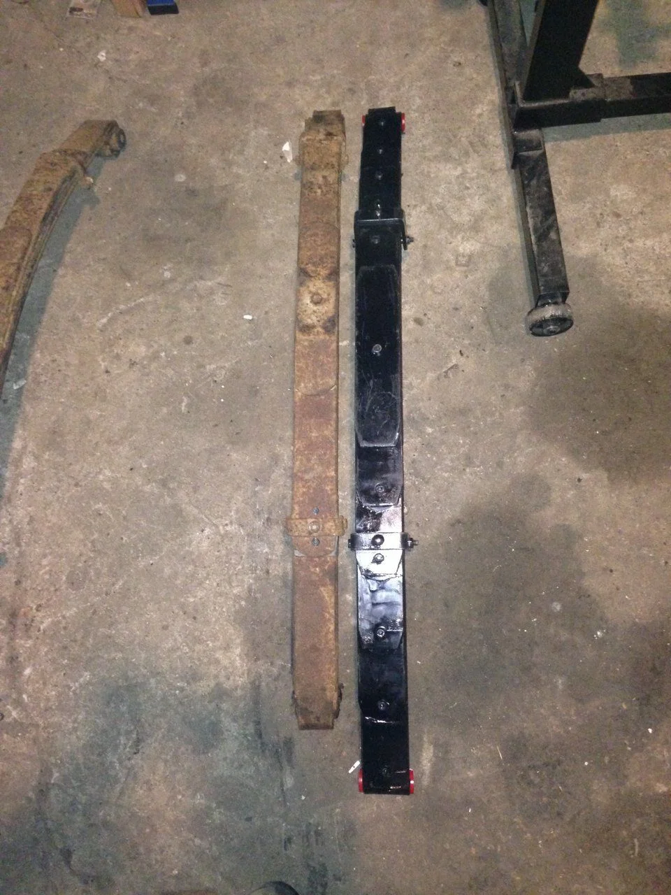

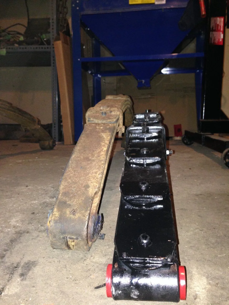

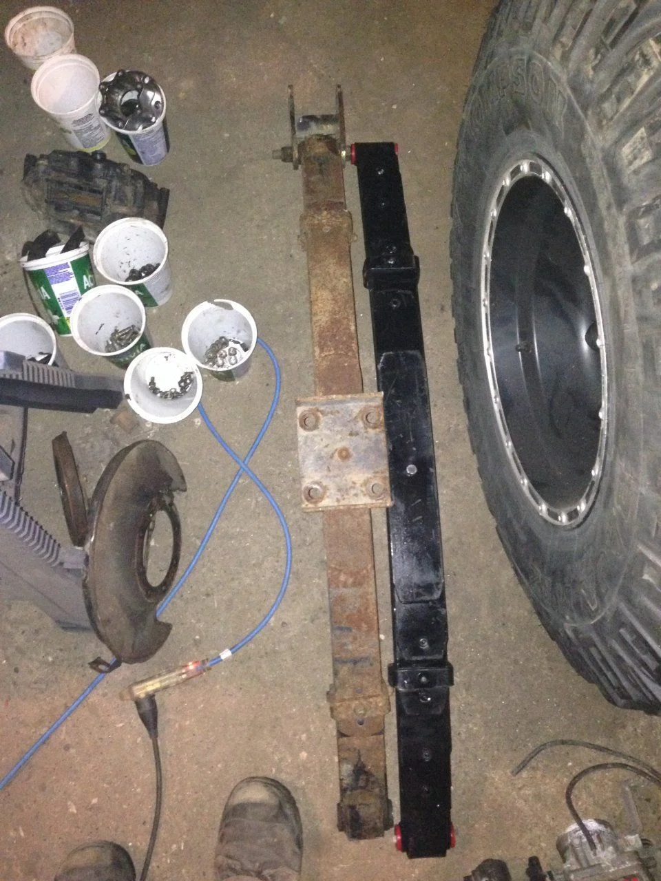

here's what an upside down frame would look like on the axles. I played around a little with lining up spring hangers etc but realized that my old hangers won't work with the size of spring bushings I have so I ordered some new hangers and I'll have to get some spring pins. then I'll start the tacking process to get evrrything lined up the. do a final weld around everything. I'm still trying to find ways to keep the COG down so I may cut some areas that double up on metal which would make things taller. we'll see how fancy I feel like getting. here's the difference in springs I got from alcan
these are the front. pretty much same length but are built 1inch under stock height to mimic a well broken in stock spring.
