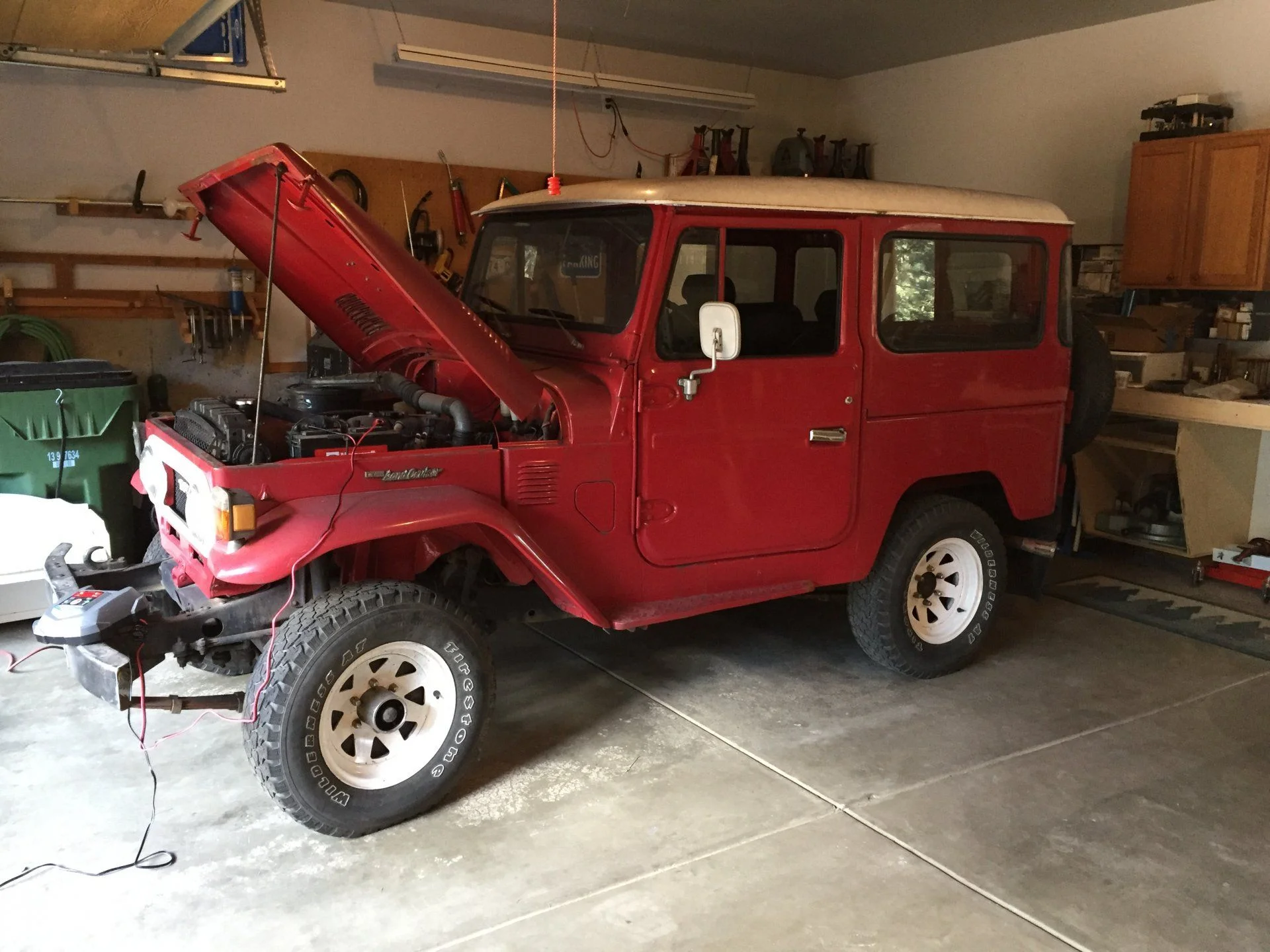

I'm new to the Toyota world (and the diesel world), but have been a long time shade-tree mechanic so I like to think I'm pretty competent. I took on a project for my cousins to get their '77 BJ40 kicking again in two stages... first, diagnose and repair the existing B motor and second, install a 13B-T in its place to make it more competent at altitude here in Colorado. I will probably start a build thread when we get to the 2nd part, but I wanted to see if there were some opinions on diagnosing the B so we know what's really going on in there before we remove it.
The backstory...
They bought this truck a year or so ago from Texas, and had it shipped up to Chicago. It ran fine in TX, but after ~120 miles in cold weather, they had a fairly catastrophic failure. A few freeze plugs blew out and it bled out of coolant and started hemorrhaging oil from the passenger side. They took it to a local mechanic (Midas, I think) for an opinion and they put new freeze plugs in it but weren't able to stop the oil leak. They called it a cracked block and unrepairable (enter the 13B-T plan).
They dropped it off at my shop yesterday and I took a quick look at it and saw this...

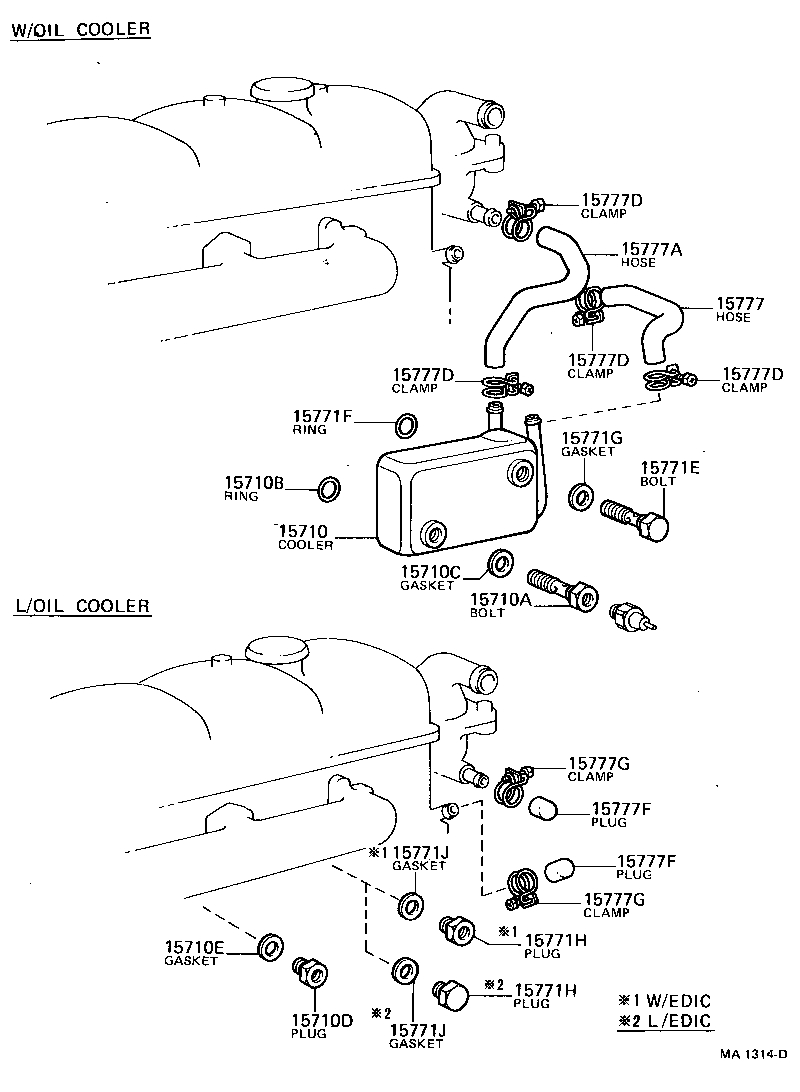

So I'm curious... Is my logic in the ballpark? Is the pictured cracked housing even an oil cooler case? I was under the impression that if the B motors had one that it was externally mounted and coolant ran through from the front of the motor (thermostat housing?). However, the 3B seems to list it as the oil cooler case. See below...
Thanks in advance! Looking forward to getting into this project.
Yes, that is an external oil cooler assembly which is cooled by circulated coolant. My guess is you're on the right track with this. If Midas didn't screw up the freeze plug install, then I'd try to source up a used cooler and go from there. You might be lucky and NOT have a cracked block however if it froze hard enough to blow out the freeze plugs and crack the cooler than it was frozen very, very hard.

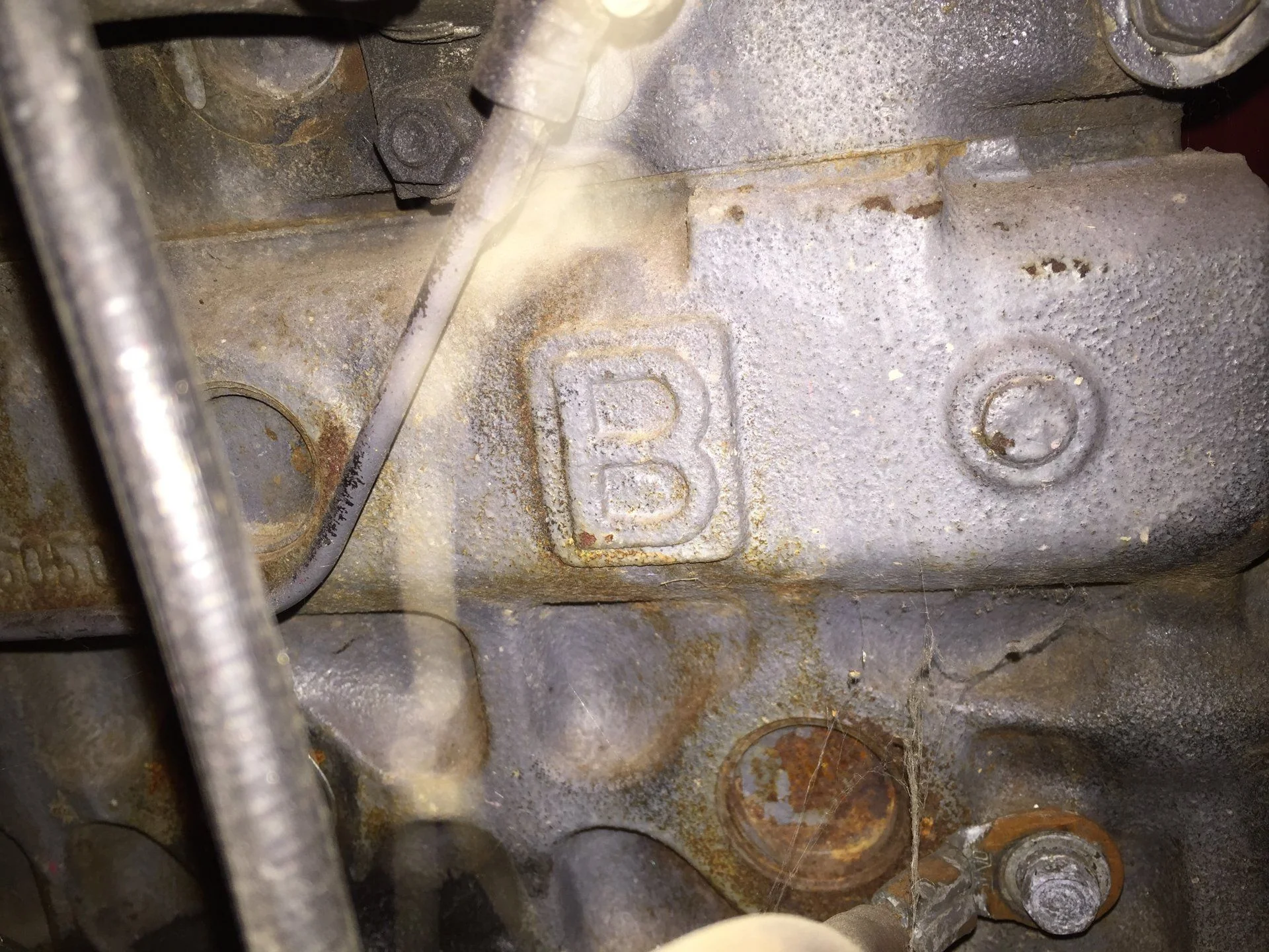

If you want to know for sure if it is a 3B or B just look at the engine block here and you should see:
:beer:
Thanks for the feedback, guys. I am sure it's a B block, but I was confused by the 3B style cooler housing as well. I have started looking around for replacement covers but am pretty shocked by some of the prices... Mostly around $650. Seems about $450 too much, but I guess that's what happens when they don't make them anymore. It feels like a tough sell to propose spending $650 on a gamble for whether or not there's further damage inside. Might end up pulling it out and selling it as is and go forward with the 13BT in that case.
A pic of the block stamp :)

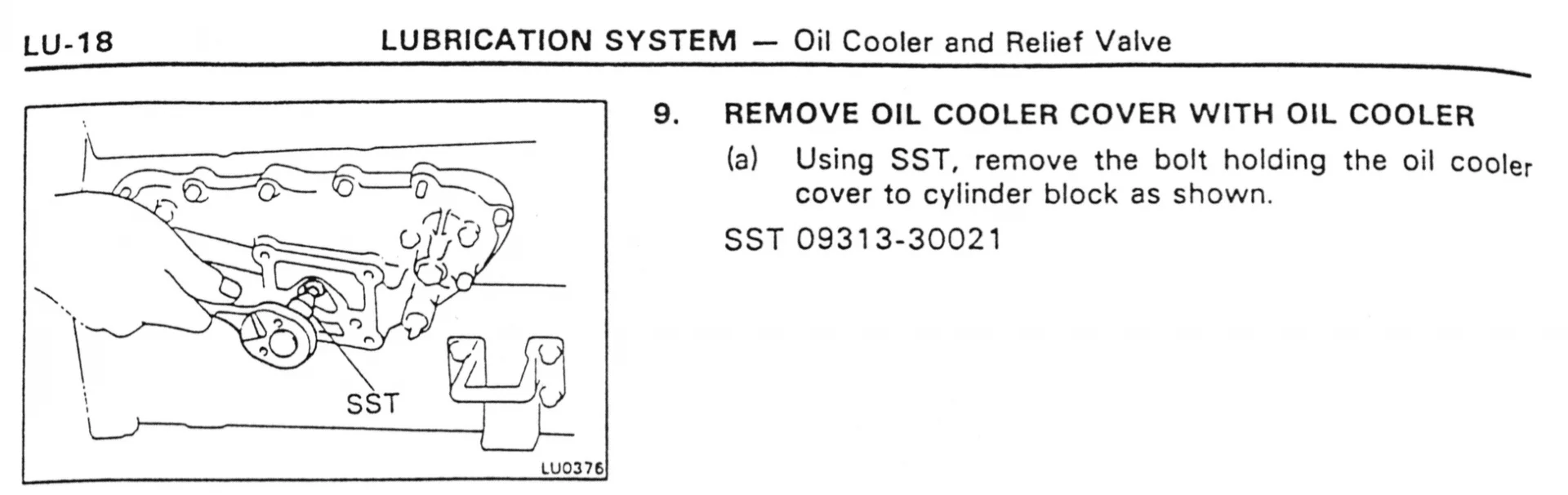

Thanks so much for the feedback, guys. I am going to go ahead and remove and inspect the oil cooler while we search for a replacement. Looking at the B engine manual, it suggests that you need a Toyota SST to remove the cover. Is this something I should try to source before I open it up or is there an alternative tool that will work?
No. I wouldn't bother with the SST.. If my existing toolkit couldn't do what it does then I'd make something that would..
I see Toyota calls that a "detent ball plug socket"

Welp, the oil cooler replacement went well. Removal and installation were maybe 45 minutes, the other 3 hours were spent prepping mating surfaces. Had to remove the exhaust from the manifold flange in order to get the cooler off the rear mounting stud, otherwise it was exactly as the manual suggested. For reference, the SST above is actually a 6mm allen. I ended up smearing Permatex Ultra Black RTV on mating surfaces and gaskets (right or wrong).
