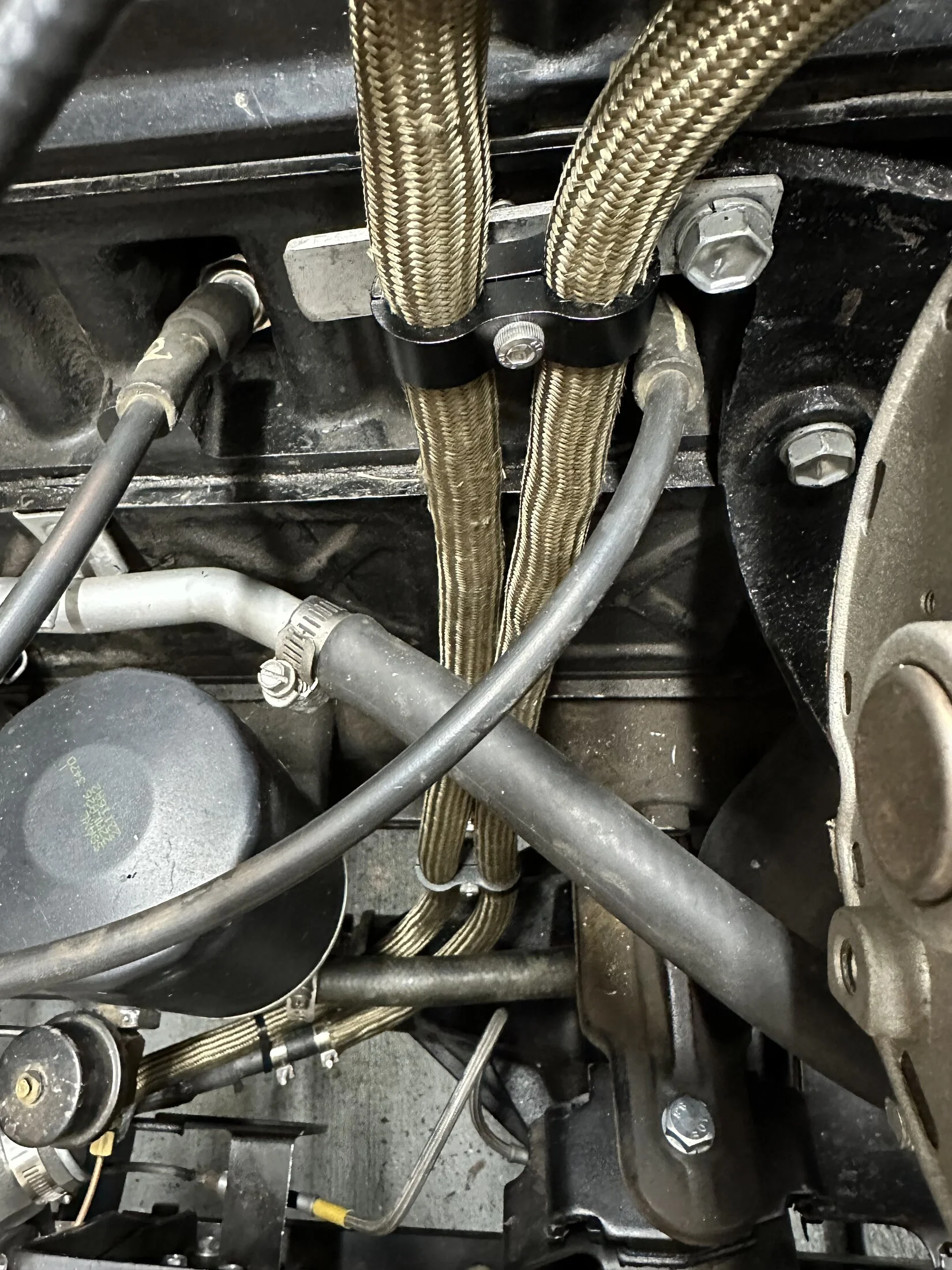

Up from the ex mechanical pump location
My replacement routing was like this, I am waiting on a 120 degree fitting to loop the return back away from the engine. Directly under the return are two cut outs on the heat shield and when the engine is running, hot air blasts up through those cutouts, directly on the return fitting.

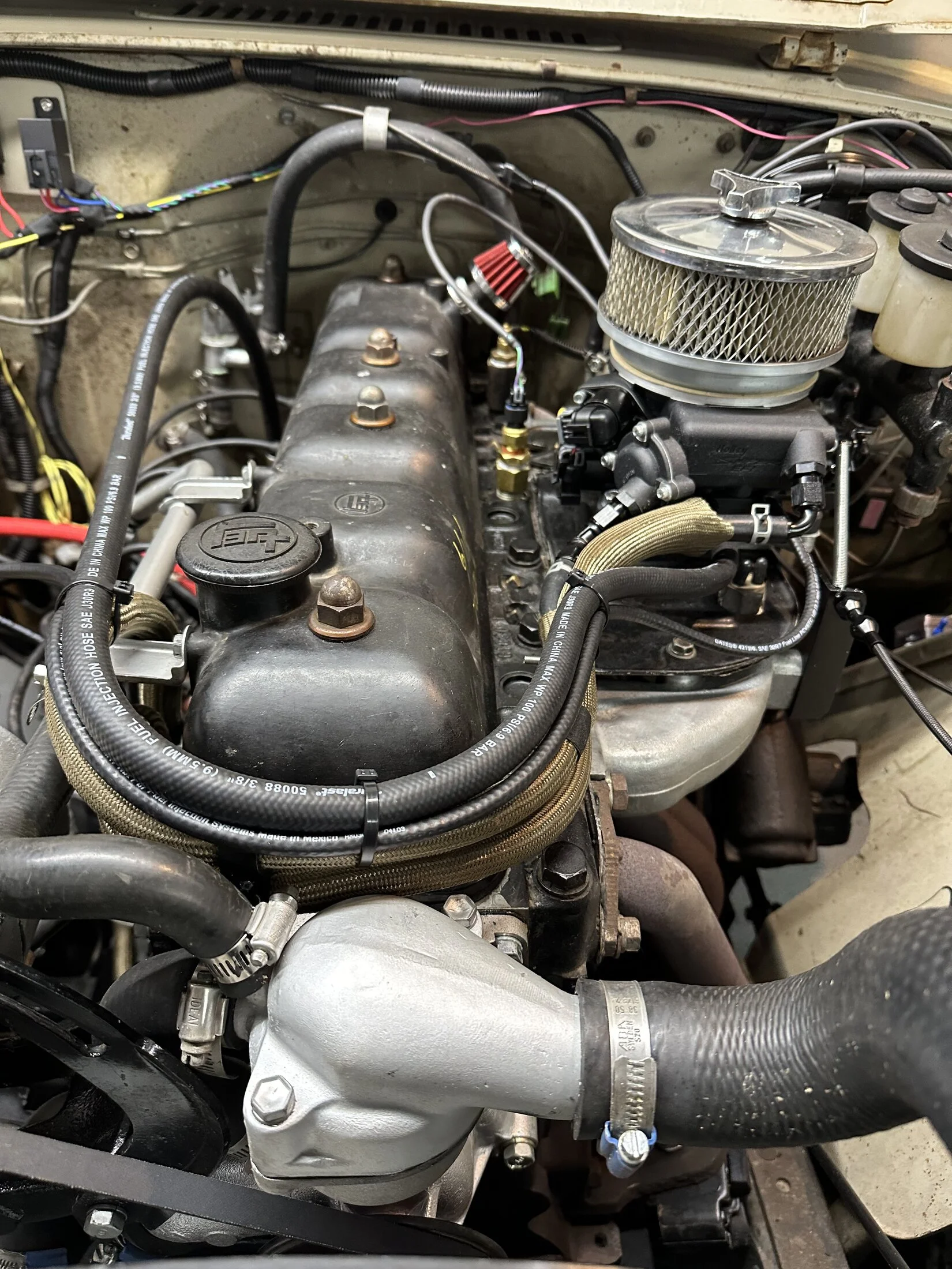

I ran a short section of aircraft fire sleeve as seen in the image below. I also now have a souped up 2F which does run a wee bit warmer but no issues so far this summer. I am also not in the heat and elevation like you were.

@StinkyPig i notice you have a returnless system, which in hindsight would have been a better way to do it. I had shielding on both the fuel feed and the return. I have since added the header wrap, and will be adding more.

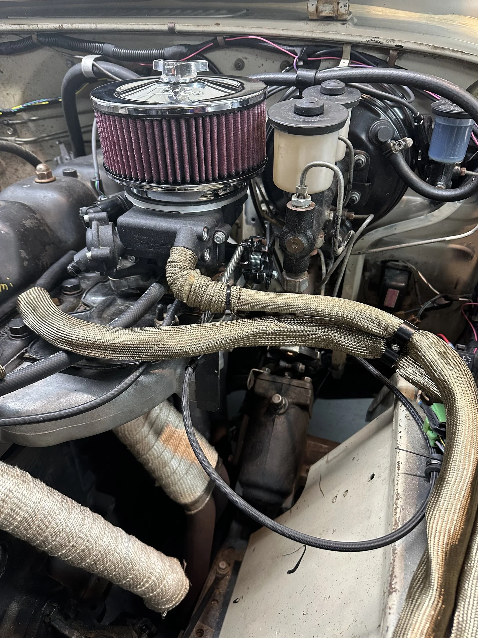

Until I go on my next long trip, won’t really know if the problem is truly solved, but the rerouting of the lines,( added a 150 degree AN6 elbow to the return line to get it away from the engine), additional heat wrap on the lines, and some heat wrap installed on the headers should be a good start.
Header wrap as well. Although waiting on more wrap to finish the job.
