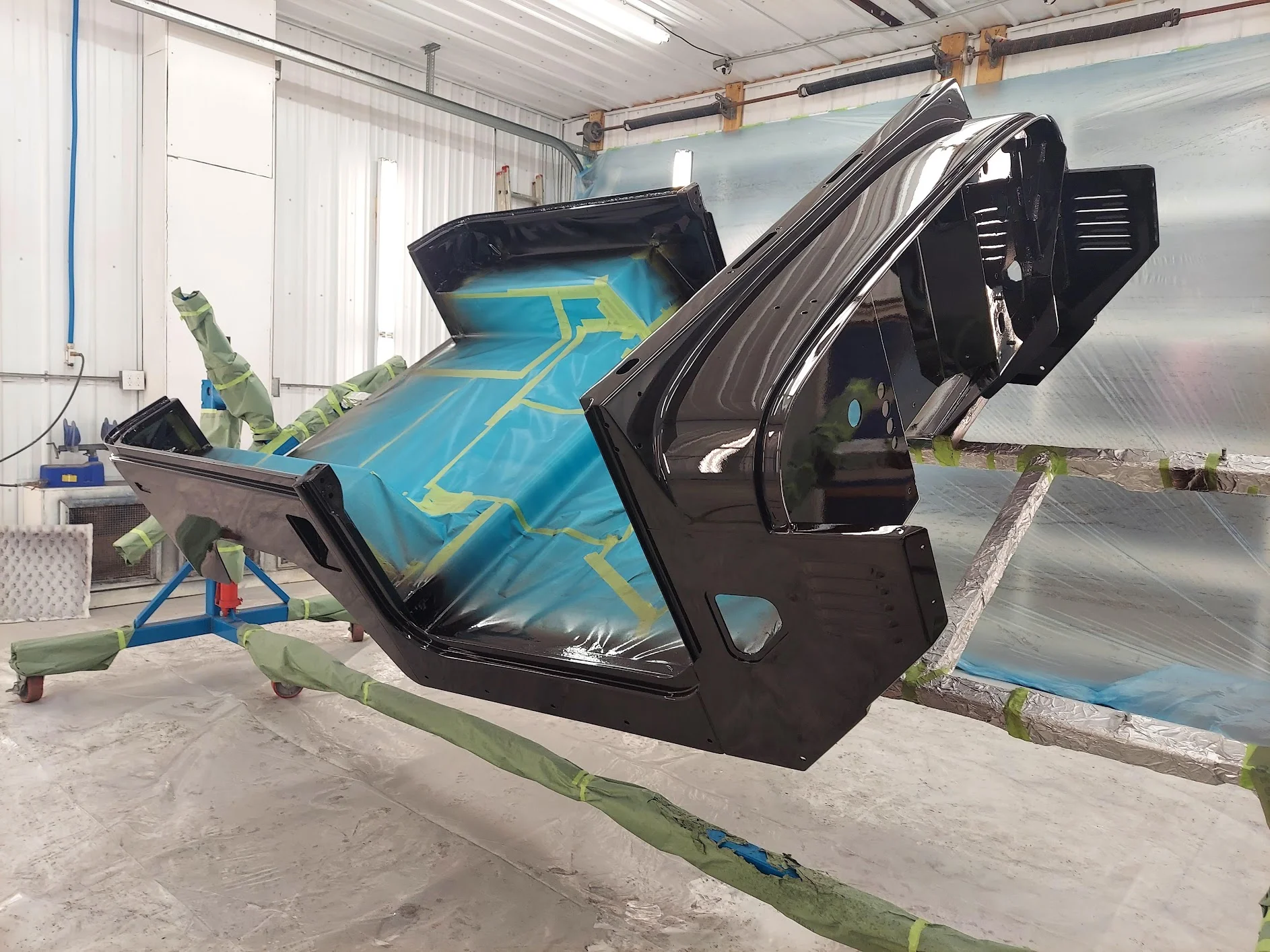

It took me a second to comprehend what I was looking at. This is the “firewall”. 😳

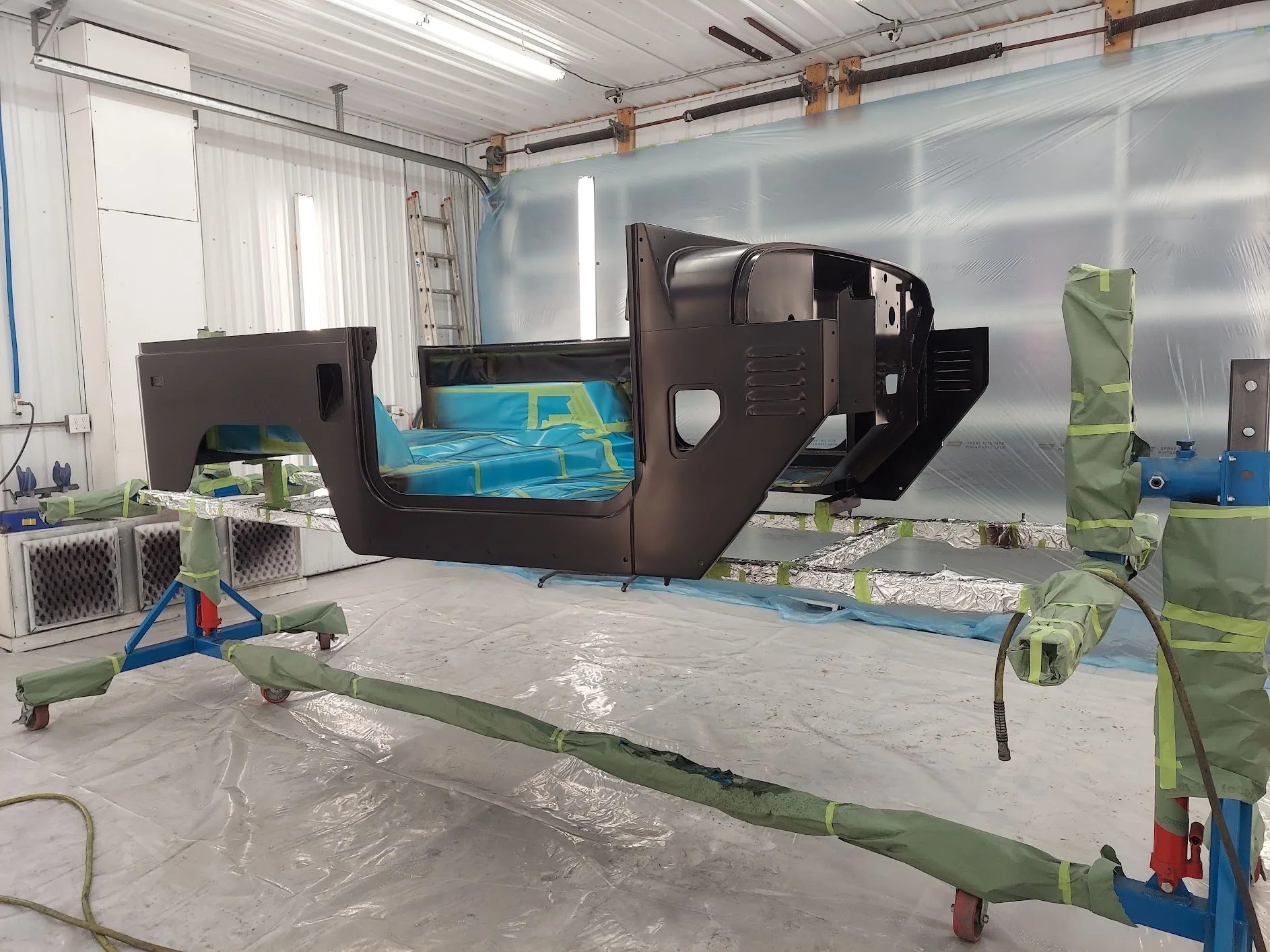

It’s covered because we’re going to spray under the tub and part of the interior with tintable (color matched) Raptor liner. I think they will even shoot a coat of clear on top of that for extra protection and durability. So wherever you see the portions of the interior that’s been taped off, that area will get the tintable “treatment”.
The liner is sprayed on last. It’s easier to tape and seal on the clear coat than it is on the Raptor Liner. The tub will rest for a few days before they mask off the painted area in preparation for the liner application.
Another photo bomb. 🙄
These shop pictures show some really good shots of the brown base coat..I think this is 2nd coat, not sure.
