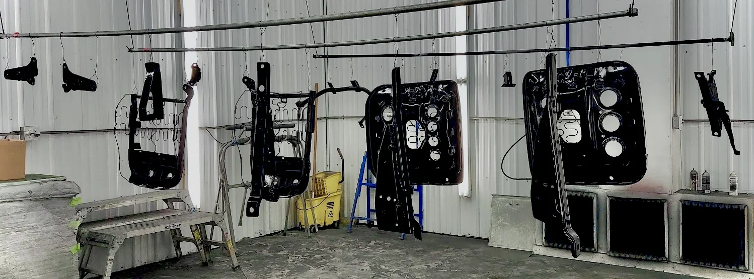

Seats are in epoxy.
Never to be seen, the “unsung” seat bases. Looking good in a fresh coat of black satin.

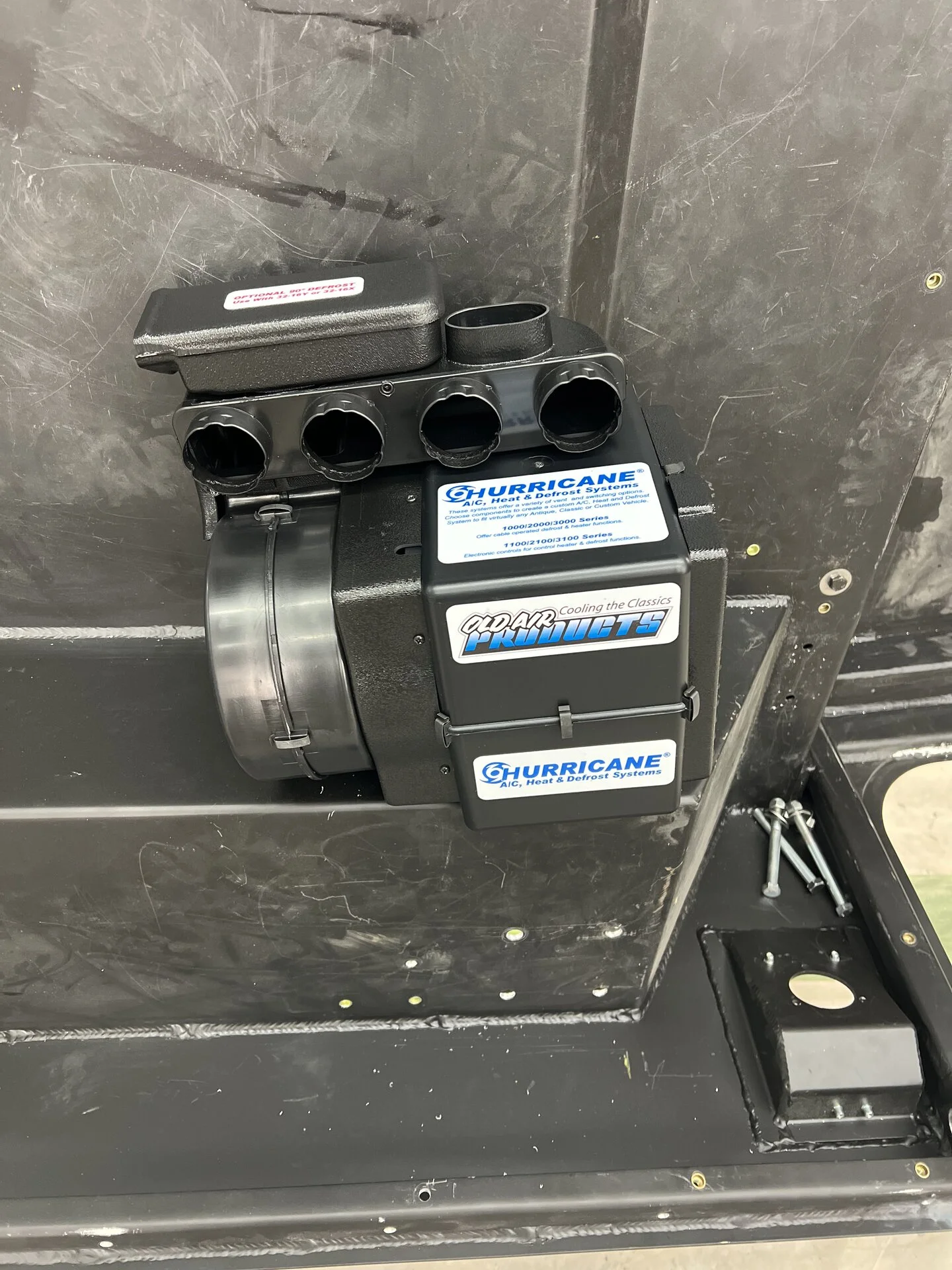

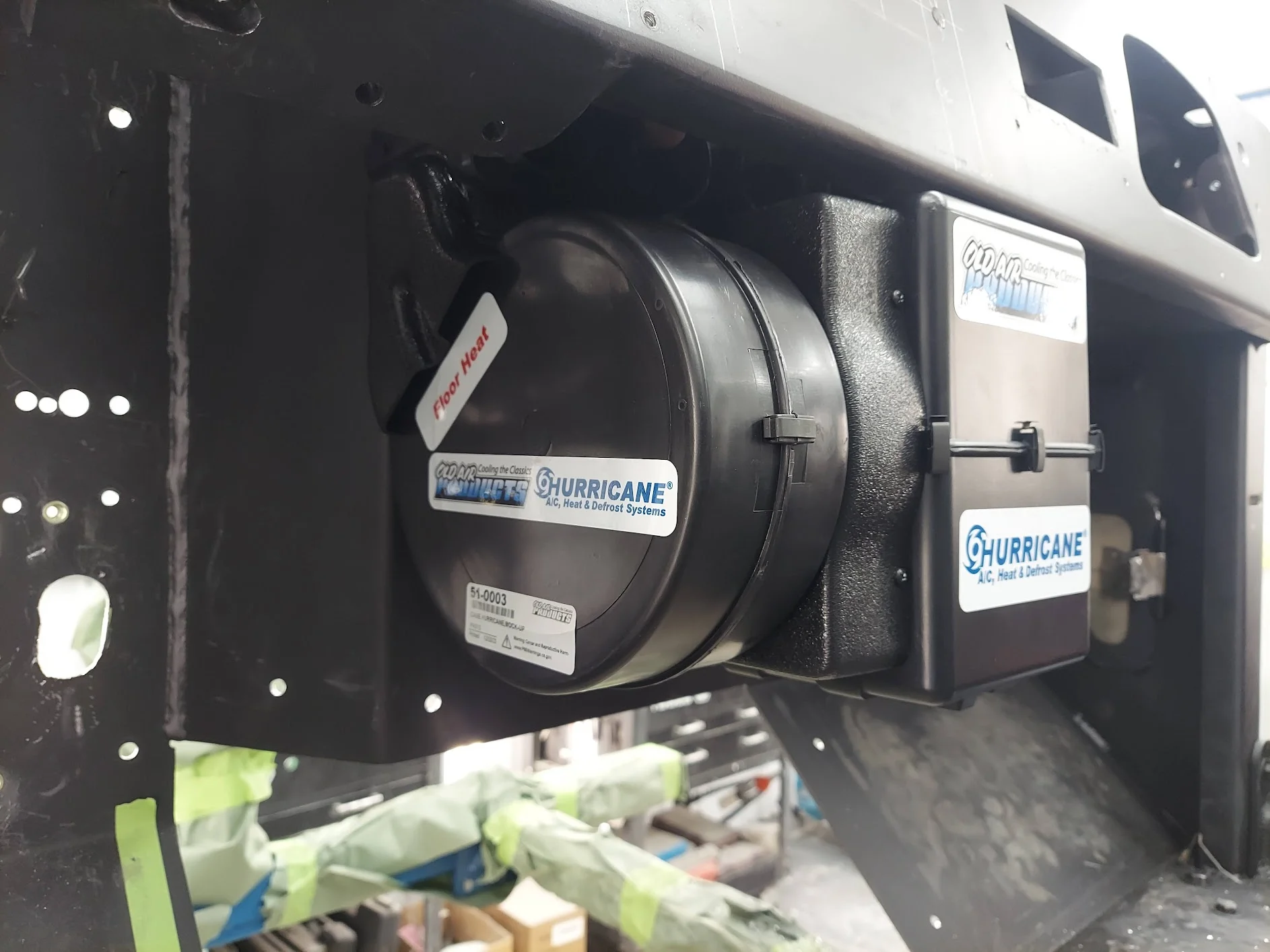

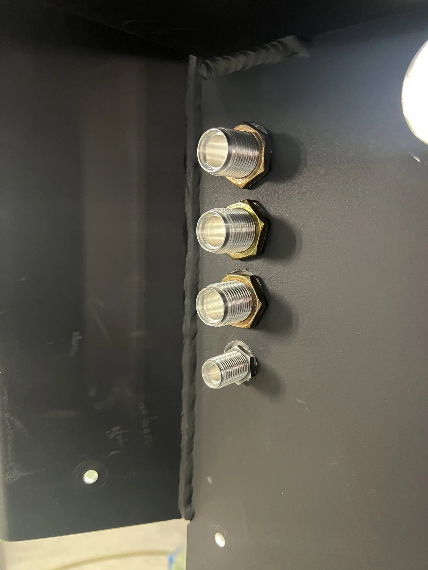

2.0 updating Heat/AC. PH I placeholder mock up.
What the… I love what I am seeing. Don’t know what I am seeing and really interested.
There is some custom work coming up Ref: AC/Heat. Can’t spoil it for the able bodied craftsman 😉.
Which OldAir model did you go with?
What you see in the pics is the “mock up kit”.
“Mockup Case for Old Air Products Hurricane A/C Heat and Defrost Systems
The Hurricane Mockup Case is designed to test fit into vehicle and check for clearance to make sure the Hurricane unit will fit into the correct mounting location.
There are correctly placed stickers to show where the fittings exit the case on the 1000/1100 (high exit), 2000/2100 (side exit/clean firewall), and 3000/3100 (low exit) units.
Included is both the standard defrost plenum and the 90 degree defrost adapter for checking proper fit and clearance based on your application.”

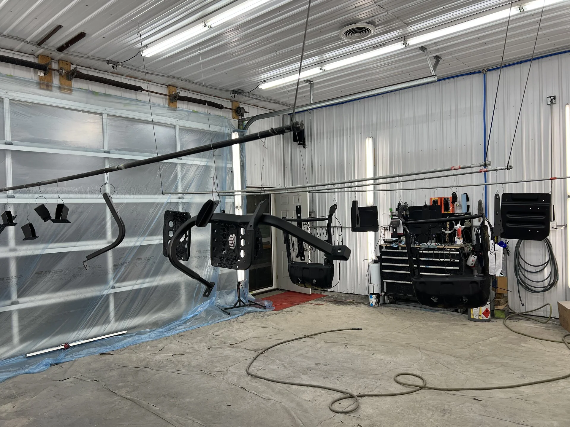

Black satin on all the front seat components. Also, we may see some color this week…:clap:

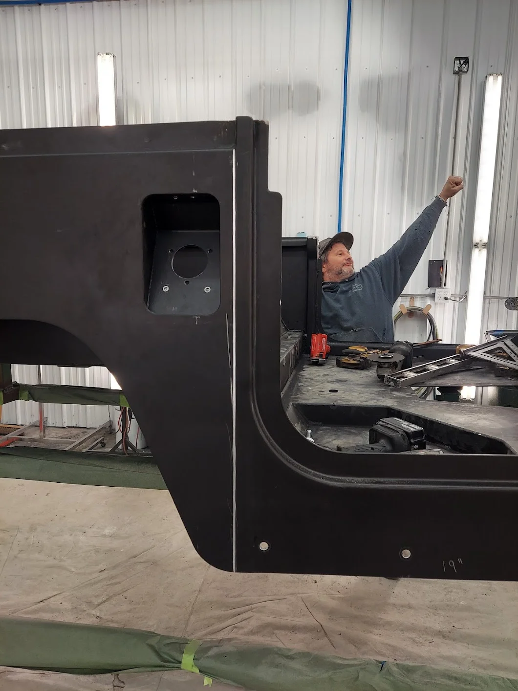

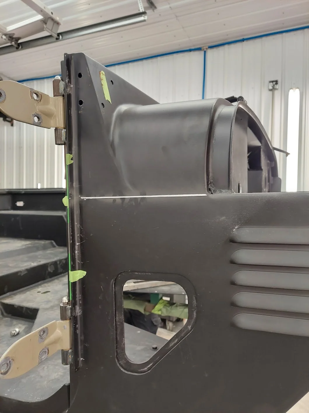

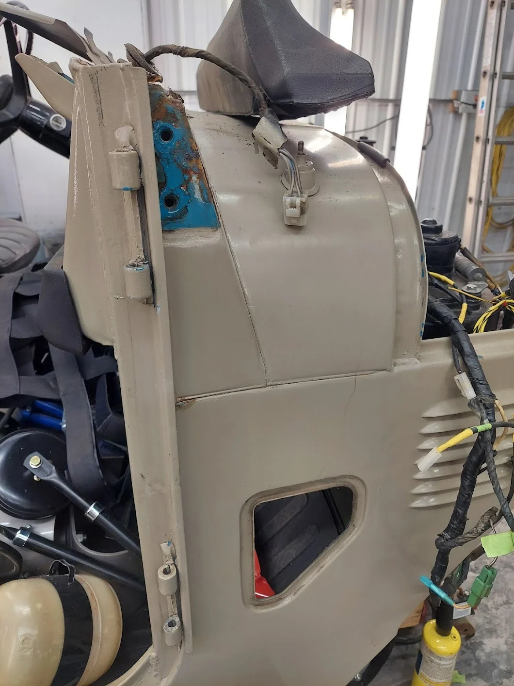

Adding some of the body seams for purely aesthetic reasons. Not trying to fool anyone with contour trickery :cautious:, just giving the AQ body more of the traditional/original “look”. There are quit a few nuances to the AQ tub that required “Smart guy above my pay grade” solutions. Especially in the HT application, seat(s), tank cover modifications Etc etc. I know @Jdc1 has something up his sleeve in terms off an After Action Review and some solid TTP’s that are forthcoming at the “end of the build BBQ. 🎟🍻😎
“Wilson Victory Dance”. Dan the Man has definitely made his way into the Lexicon of Mule 2.0
