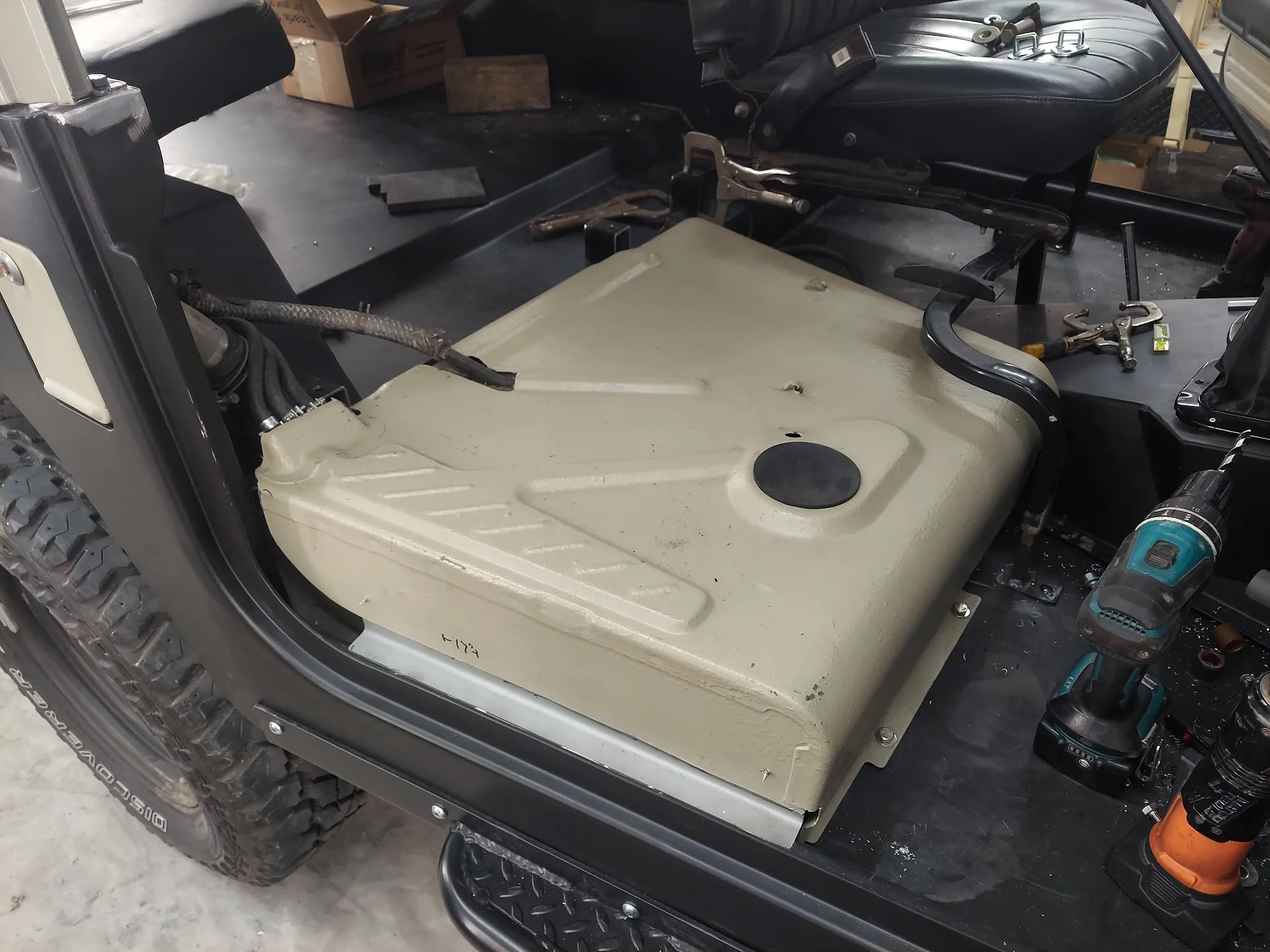

Added ”just a tad” to the tank cover. AQ tub is just a bit shallow.

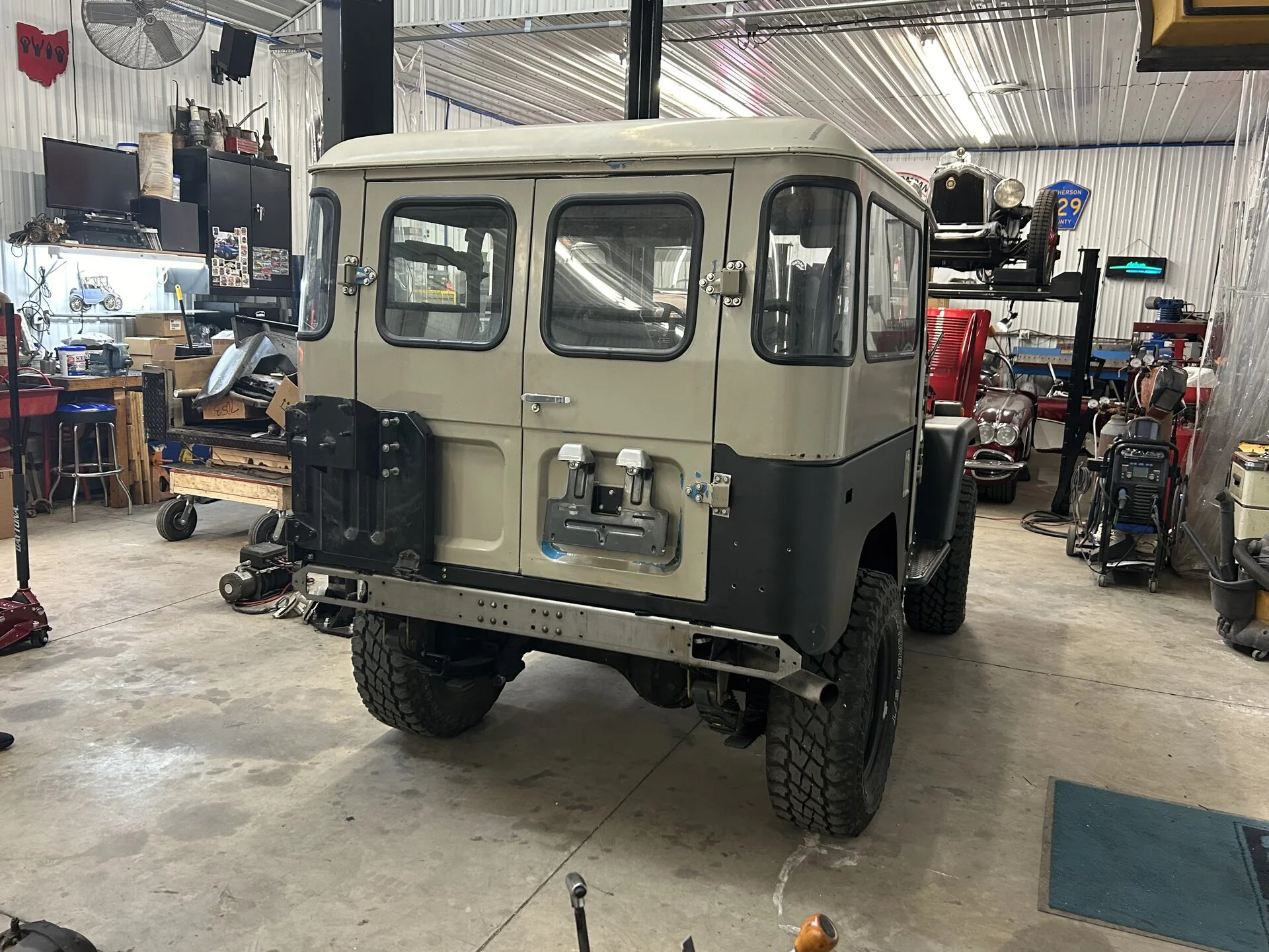

Coming together. All in all, the HT is in good order. There’s a small section of the HT that will need attention due to some very minor rust.
I couldn’t find another full AQ tub, cowl windshield build with a HT. There are some challenges with the HT that were overcome IOT make that a reality. Full disclosure coming.

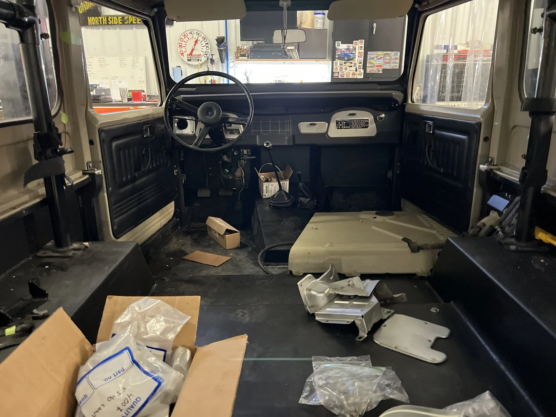

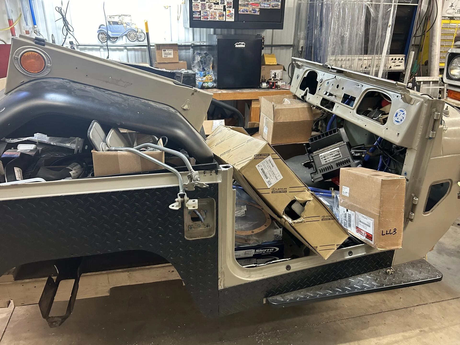

Started some disassembly this evening, she’ll be back on the rotator shortly.

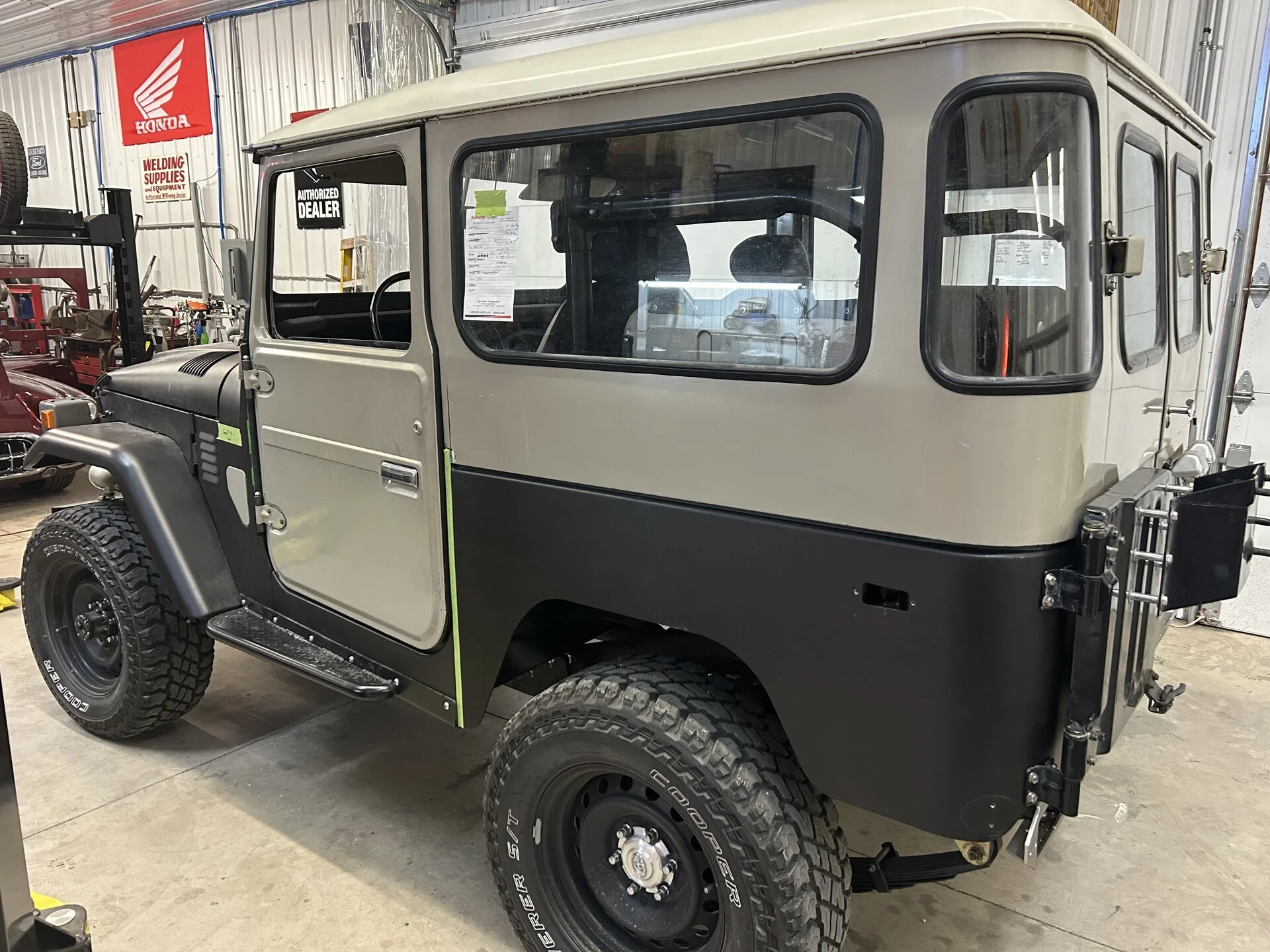

Going down “stockish lane” with the original spare tire carrier. Well, as stockish as you can on a full AQ tub.

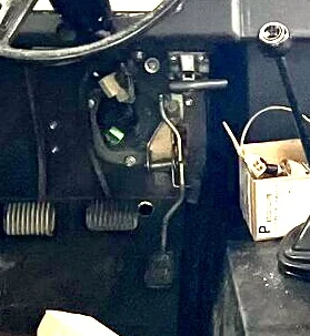

Test drove the pedals yesterday…👍👍
Very interesting build and thread - love it and I'm jealous of the full aluminum setup; I only have the Aqualu tub. I look forward to the info on the HT installation as I plan on adding one to mine (currently soft top only) and I'm sure the info will be helpful, even though I still have the OEM cowl.

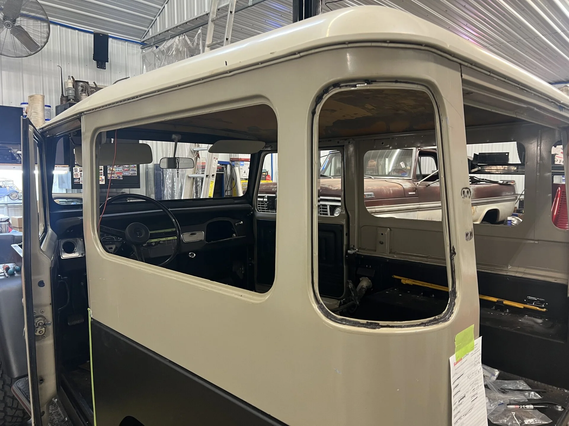

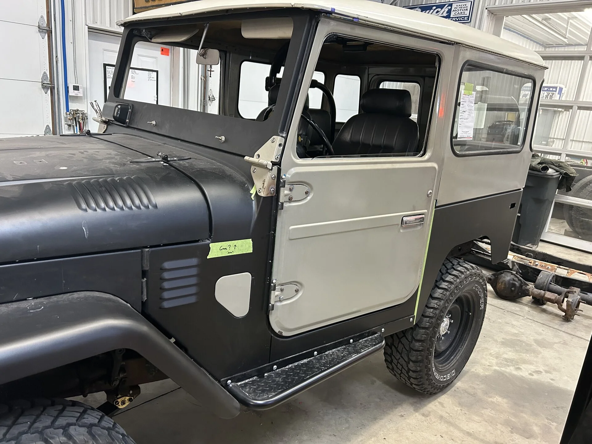

Using the stock steel Cowl and Doors, you should be ok on the HT, the issue that we ran across was the angle of the windshield creating an uneven(and unacceptable) gap at the door. If you look at the trucks that are using the full Aluminum cowl, the windshield angle is stood up more than stock.

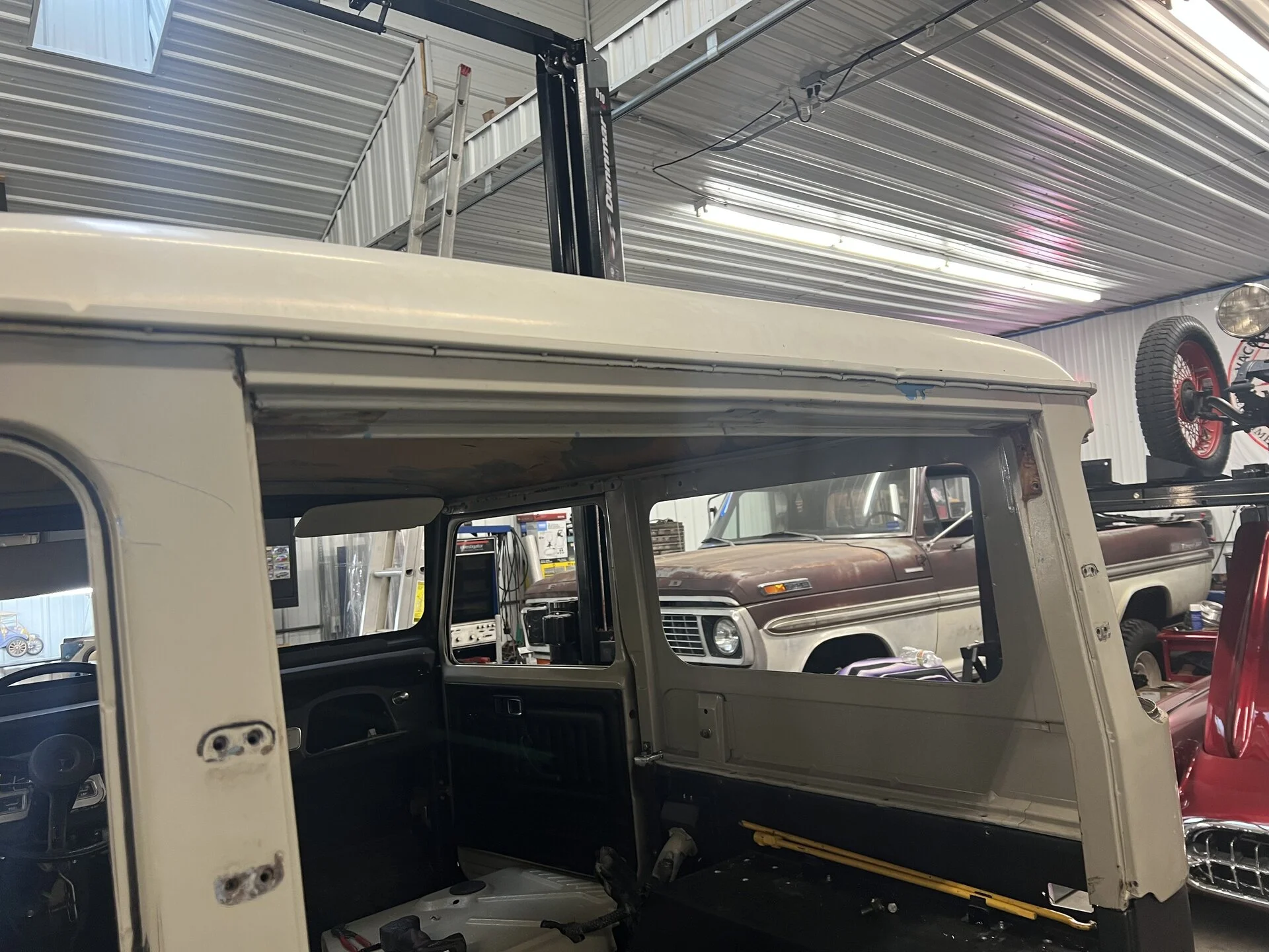

So far, so good on the HT disassembly. Keeping the fingers crossed that small area (right rear corner) of tin worm infestation is the only “negligible” problem area.
