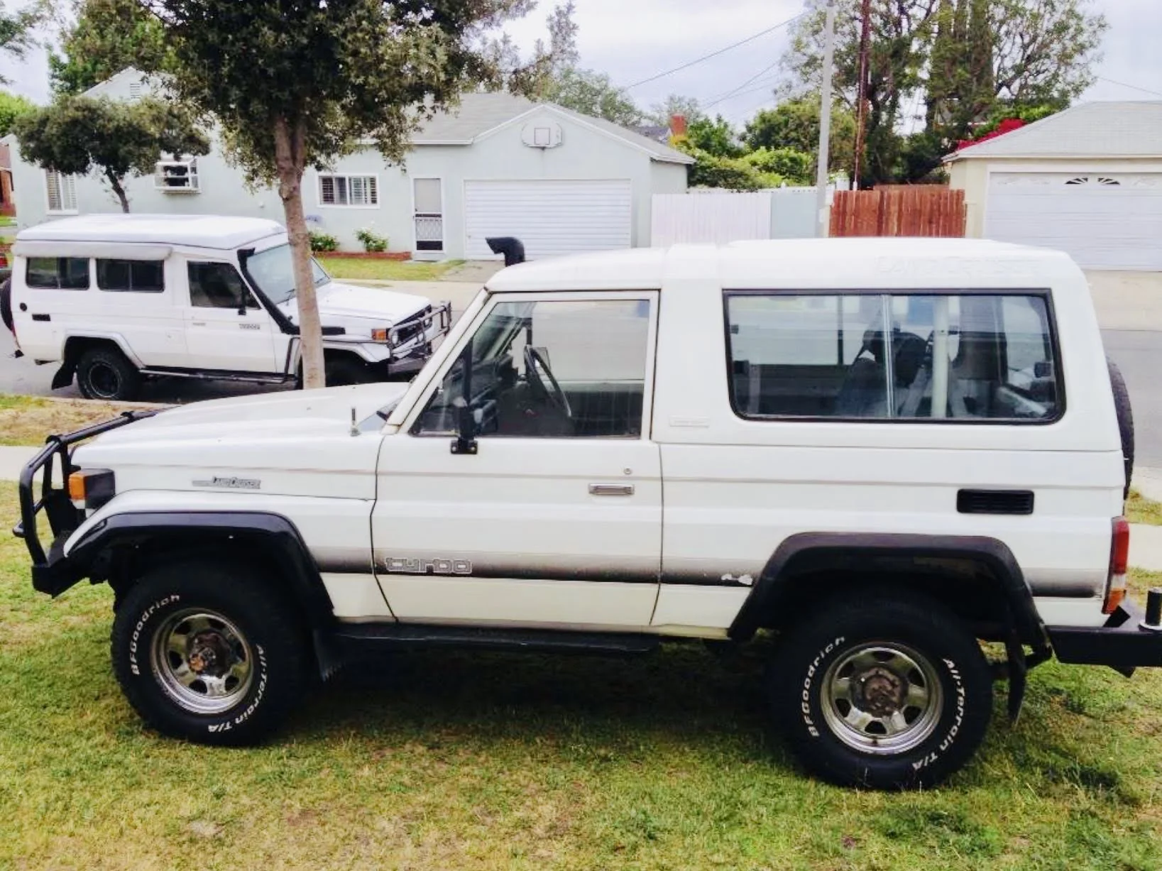

My buddy actually imported that cruiser to the US years ago. At the time it had a turbo 2H. He sold it awhile ago and it has changed hands a few times before this last full overhaul.
Here a picture of it in the background. My BJ74 is in front. This is around 2014ish.
Oh woah! There she is, fresh(ish) from Aus. Thanks for sharing!
