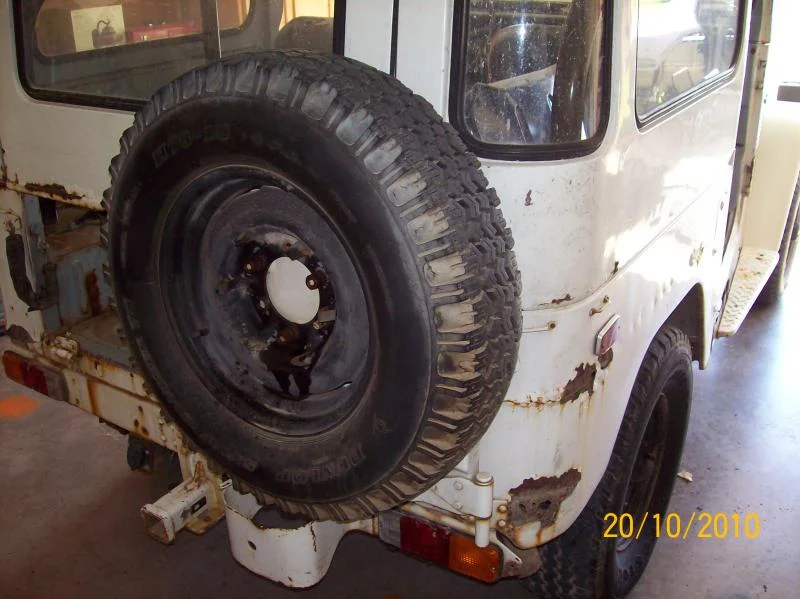

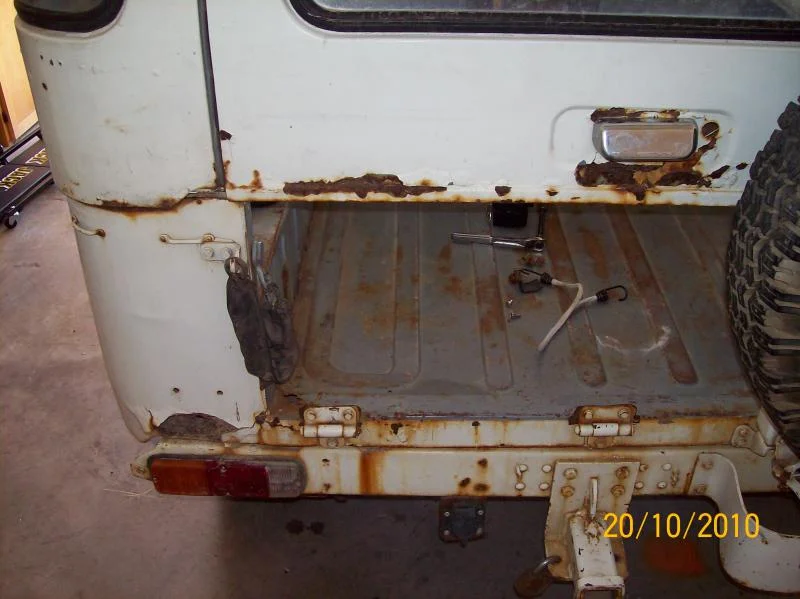

So I am a newbie and this will be my first resto. I got the cruiser off of ebay and it was rusted out a lot more than I was told. Not too happy about that, but now that I have it I am set to restore it. A '68 has been in my family since my Granddad bought it new but my uncle is a tightwad and won't let it go for a reasonable price. Therefore, this money pit. :mad: But i am looking forward to getting this one restored and driving it to his house and making him jealous since the '68 is on blocks now and has been sitting outside the past 10 years. :lol:
She's a beauty. advice: save your money and buy a complete tub. don't try to piece it together. too much time and frustration involved if you don't do that kind of work.
I was thinking about just getting a new tub. You are right. That will probably be the best course of action.

My $0.02, don't get obsessive with trying to make it perfect with all the original parts. You can sink truck loads of money into it to make it 100% original and most people would never know.
I've seen far worse... You can make a nice truck out of it and be proud of it.

Thats a Factory soft top model... (Which is why you have a pre 75 hard top on it) Go with a OCD beetle top and a new set of bows, and 1/4th of the resto is done!
Do you have the tailgate?
Okay. That is a new one to me. I haven't done enough thorough research on it. I didn't know that it was a factory soft top model. I wish I had the tailgate. I think that I am going to have a tough time finding one. By the way, how can you tell that it is a soft top model. (just for future reference so i don't look like a complete fool) ;>
p.s. thanks for all the encouraging words guys. It really helps knowing there are kindred spirits out there. I was thinking all day today how daunting of a task it was going to be to get her restored.
You can tell it's a factory soft top by the body side of the door hinges. The open part of the fixed hinge is designed to allow the pinned soft doors to be easily removed. Also, the footman loops on the back quarter panels. They didn't put those on factory hard top models.
