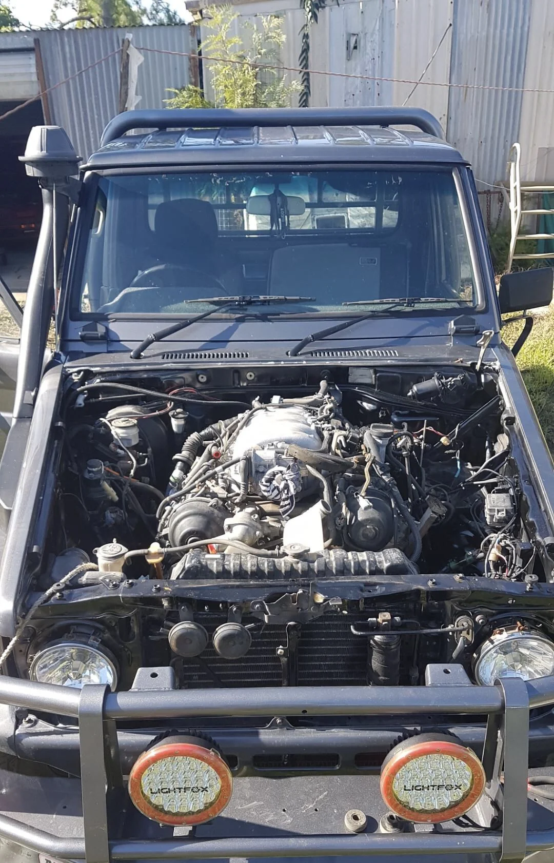

Hi all,
So here’s an update on my 75 series conversion. As some of you know, I’m dropping a 2UZ into it. So far, it’s going well... basically it fits!
The first issue, not thought about, is the radiator.. Does anyone have a suggestion as to what will fit, which would suit a 2UZ, that isnt custom. Also, for the people playing at home, I have also changed the manual trans to auto, so will need a cooler as well.
Cheers!

So the old radiator is not big big enough... the 2H cooling system is about 10L, and the 2UZ is about 14 litres. We’re going from diesel to petrol, and going from 6 to 8 cylinders.... so as I understand it ( and I am no f$&krn expert, complete newbie) I need to upgrade the cooling. I just don’t know what direction to go in 🤷🏻‍♂️

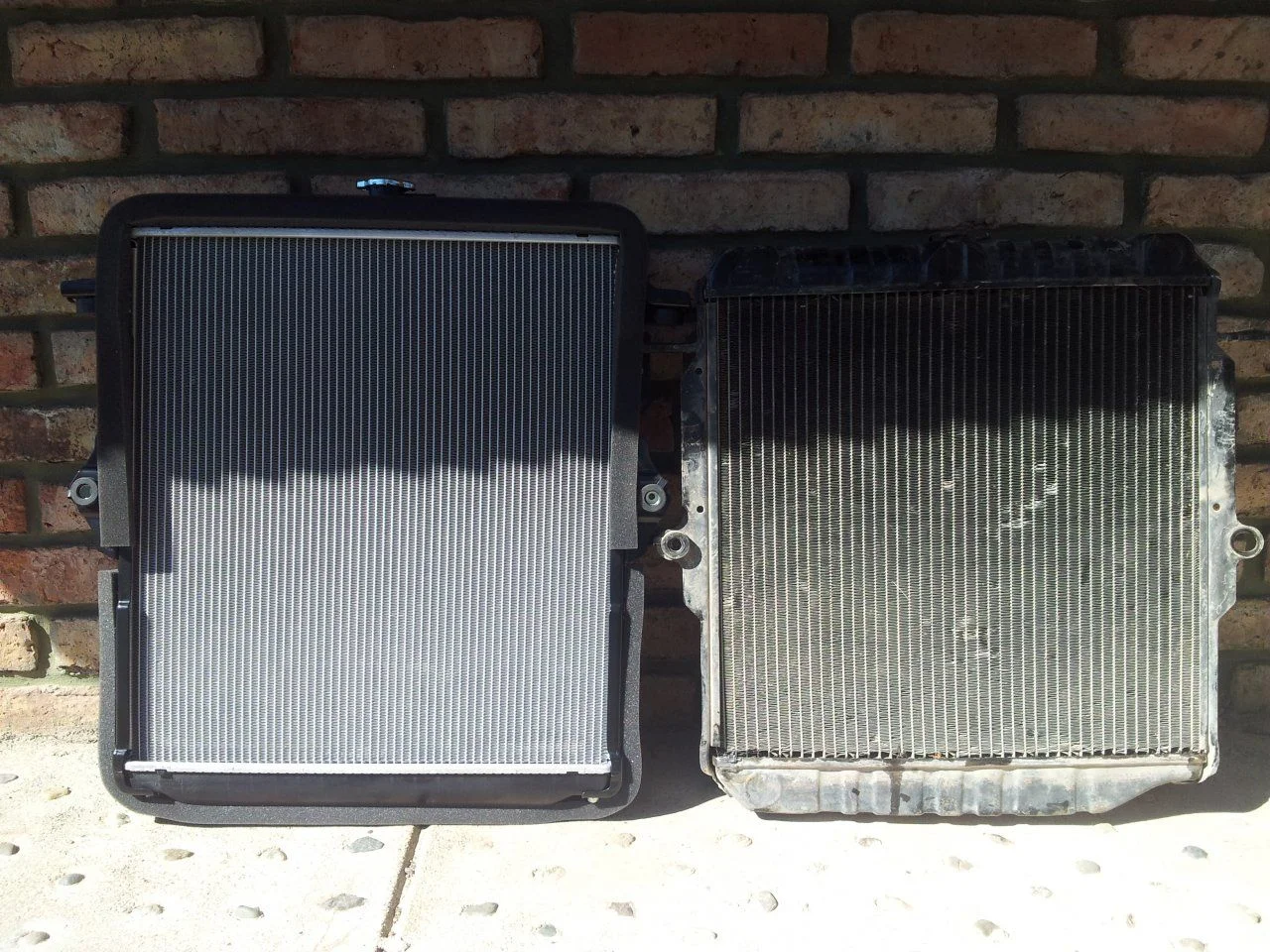

Here is a thread with pictures of the HD radiator. Heavy duty radiator for 7series found! - https://forum.ih8mud.com/threads/heavy-duty-radiator-for-7series-found.838448/
old_vs_new-jpg.1030300
