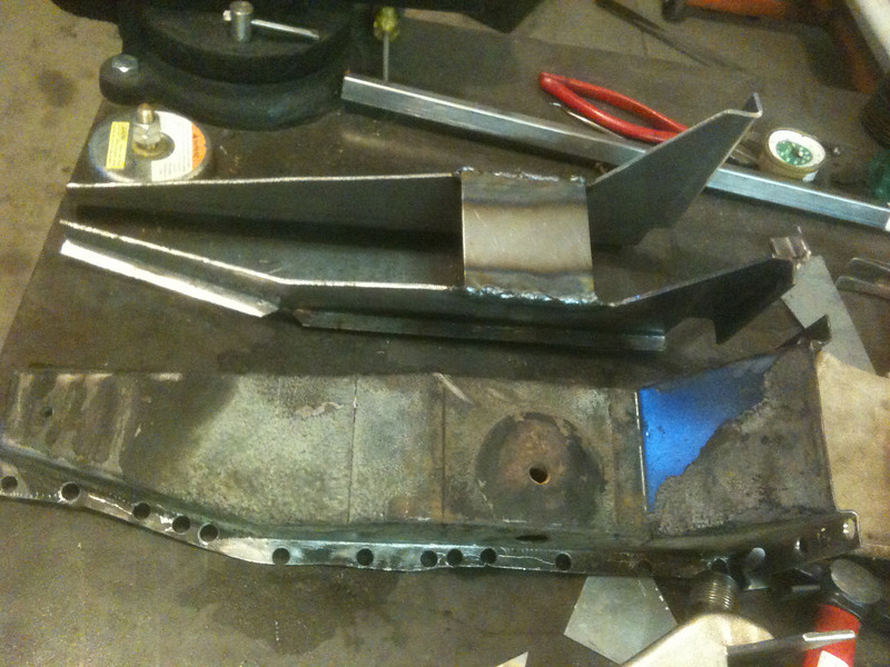

First pic: comparison of the body mounts.

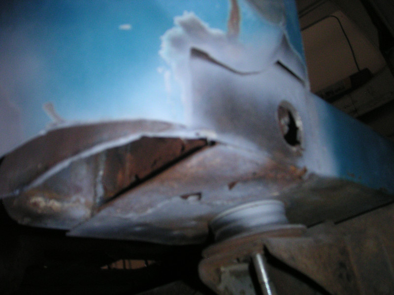

Next pic: the new mount in position. I cut a small notch between the firewall and the rib that runs up the firewall so that I can hammer the new mount into position and it will stay there until I weld it.
I forgot to account for the thickness of the bottom plate, so the other mounts will probably need another washer. :meh:

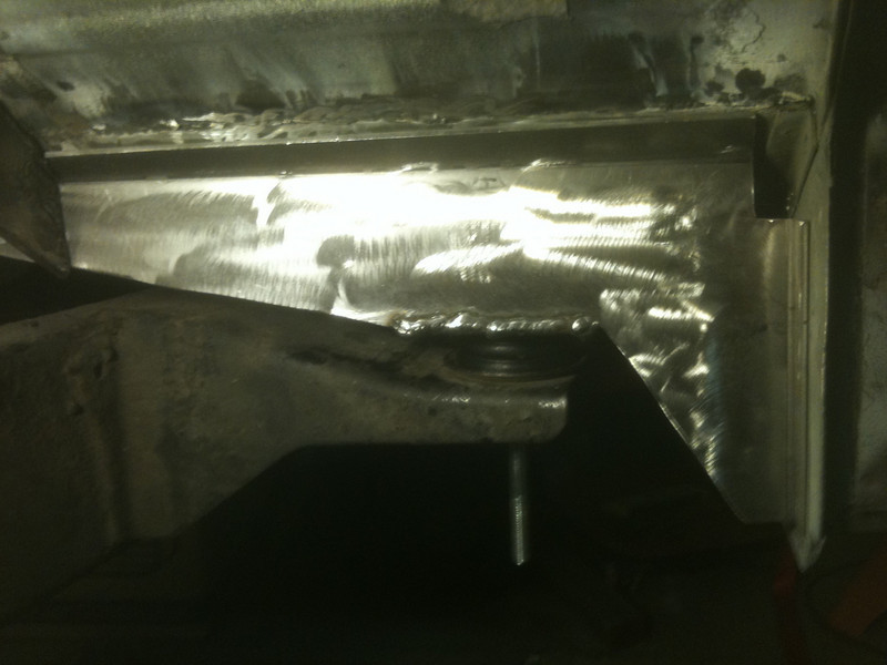

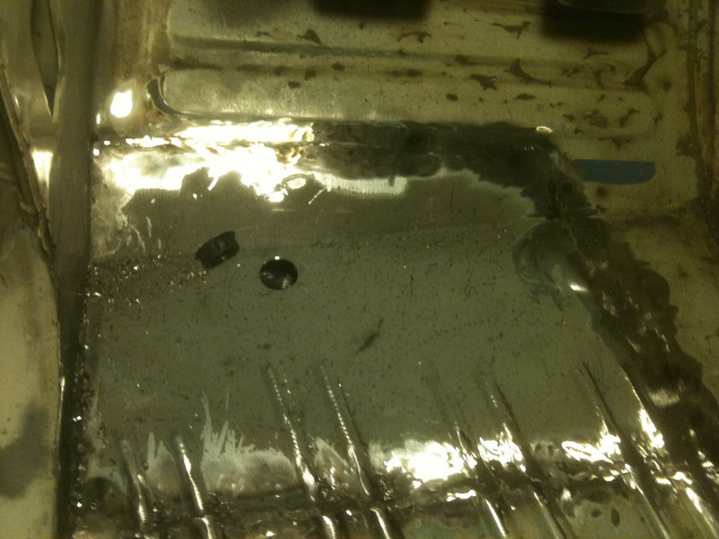

Final pic, the new floor patch. I drilled a 1" hole just above the bolt head, which is just large enough to fit a socket down to the bolt. I still need to clean up the welds, and fit an angled piece between the floor and rocker.

Those body mount brackets look better than the factory one's. Best part is you kept it OPEN on the bottom. I'd add another plate, same size as bushing plate, up front to tie together & make rigid. How many other mounts will you have to redo? Patience is the key for bodywork & from what I've seen so far, you got the skillz :grinpimp:
Thanks! Avoiding close up photography helps a lot. :cheers:
I'm still debating that additional plate. When I mocked it up in cardboard I had a gusset between the two pieces oriented vertical, right about where the bend in the rear section is. This is 10 gauge, and the tie to the rocker should prevent buckling from the outside. The bend in the rear section is now a lot shallower, but it should still add a bit of strength to the inside. The drawback is it will make it harder to get at the bolt with a wrench - though now I can get to it with a socket through the floor.:hhmm:

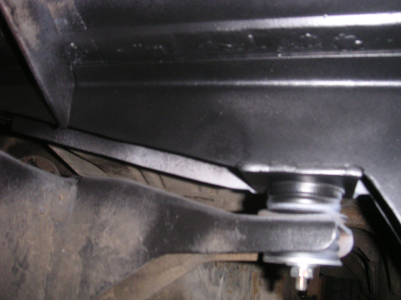

here's how the open front body mount worked out, I'm pretty happy with it:
Now on to the back corner mounts.
There is nothing resembling metal back there...I might try to do something open like the front mounts but the way everything ties together is godawful complicated. Maybe a piece of rectangular tubing all the way across the back. Dunno yet. Ideas?
I'd vote for the "keep it open" design you already have going on. Body mount bracing on those rear corners will be dependant on how much metal you still have or want to keep. Not sure how much of the factory look you're striving for, but I would trim up the rear valance area to cut out rusted areas & even it out. Then, angle brace to the OPEN body mount. That's what I did. Mine's chopped & bobbed, so you'll want to add more of a wider bracing area, for a full length :pig: to your mount:

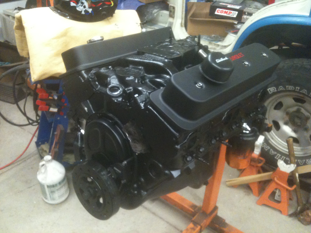

Well several home repair projects later, I've gut the engine buttoned back up. Still need to rebuild the carb, and choose an accessory pulley system. Probably wait until I can test fit the engine, but I don't have the transmission yet so that will be a while. I don't recommend rebuilding an engine a half hour at a time, it's hard to remember if you torqued everything.
I'm no fan of the SBC in general, but those anodized valve covers make yours look pretty good!
I also like the black, it looks ominous.
Your body mounts are pure art!
Thanks! In retrospect black is going to make it hard to see and work on, but so it goes. This one can legally run a 71 chevy, so that's exactly what it will do. That's about as simple as a motor gets.
