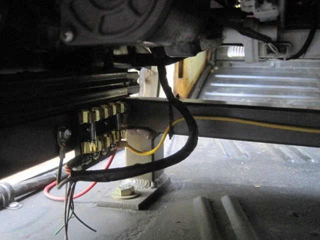

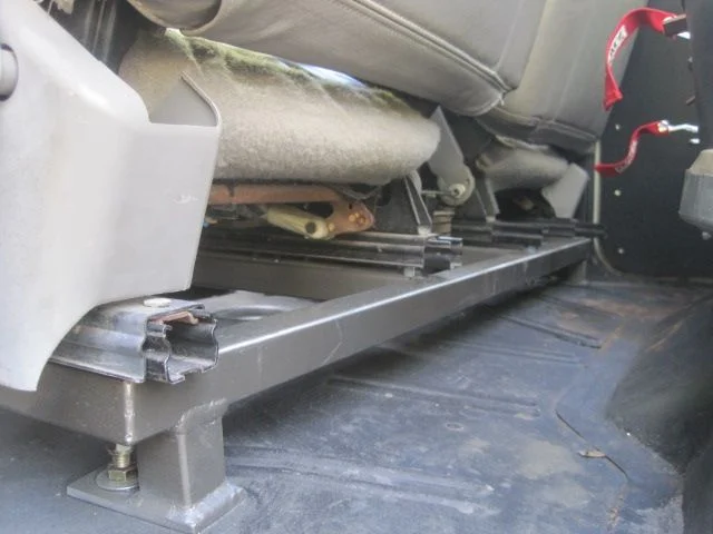

Under the front seat frame I installed a separate fuse panel for the power seats and will be setting up an aux switch for the rear heater fan..

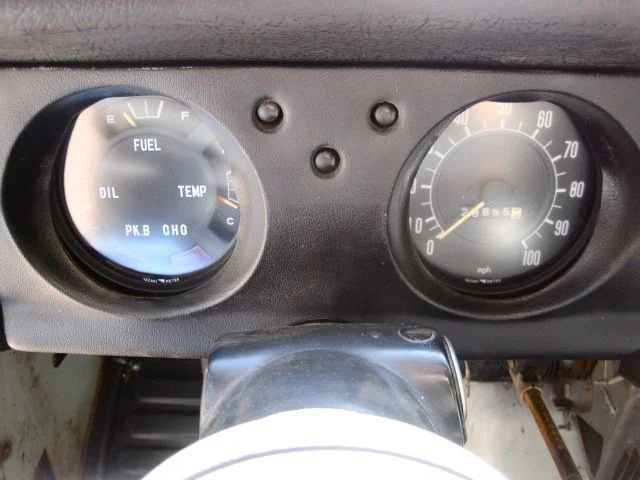

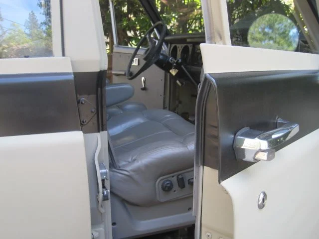

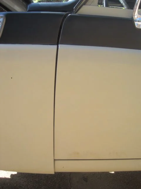

This photo just shows the gauge cluster after I cleaned it up and swapped the bezel with a nicer, less distorted one. The door photo just shows that I carried the paint scheme through the inner door and cab. Just because it's a temp paint scheme doesn't mean I can't attempt to make it nice.

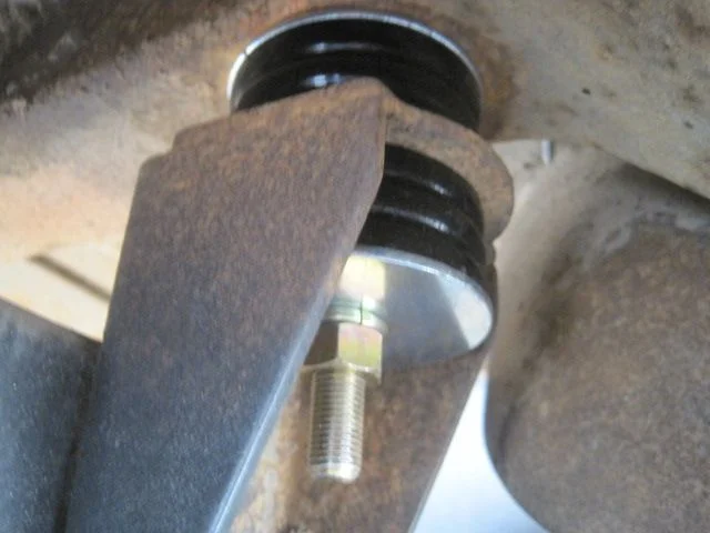

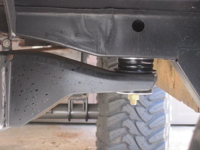

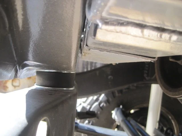

Installed new Ploy body mounts last night and oh boy are these under rated.... The body sits so much nicer on the chassis and look how much it changed the door alignment... If you have problems with door alignment I highly suggest inspecting your body mounts... I had four old body mounts flatten out by more that a 1/4" which will completely tweak your cab....
Hey Cruiser...I have those same seats in my Pig! Any chance I can pick your brain on a couple issues I'm having?
1.) Can't get the passenger seat to go forward/backward. Is there some relay that has to tie into the main/driver's seat?
2.) Did you wire up switches for the seat heaters? If so, I am having trouble finding wiring schematics to know which plug/wire set is which for those heaters.
Thanks man!
Thanks man!
I'll run out and see which wires I hooked up for the power actuation of the seat positioning. I believe there are two red or orange wires that must go to a hot lead and one black for the ground. I have not setup my seat warmers yet but will be installing switches on the dash for the seat heaters. I haven't looked for a wiring schematic yet for these seats but if I find one I'll send you the 411... If you find anything before I get back to you let me know...
You should not need a relay for the seats to work...
Awesome! Thanks Josh. I'm hoping it's something simple I have missed on the passenger's side, and not a bad switch/motor/etc. in the seat itself:/
I've got a feeling that you may have a bad switch.. My seats are simply wired by the two red and one black... No relays. I purchased an additional fuse panel that I mounted under my seats for a little added protection, and to clean up the install...

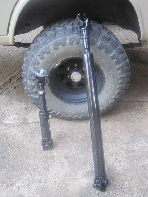

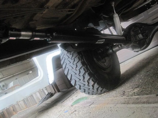

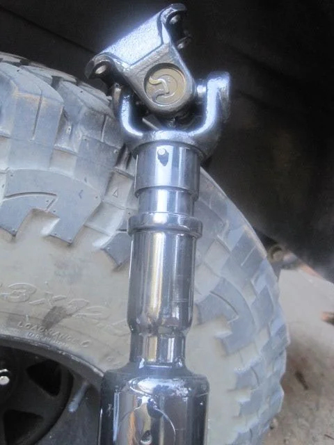

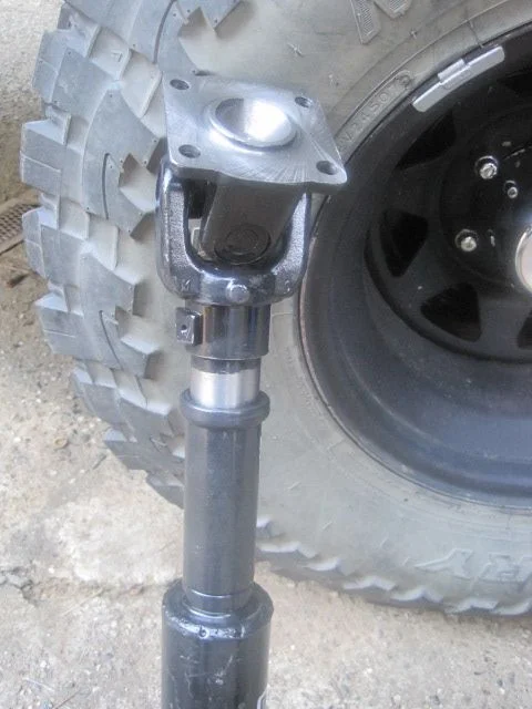

Got my drivelines back! They turned out great! I had Toyota Pickup slip yokes fabricated to both drivelines. The pickup slip yokes are longer which provide about 2 additional inches of travel over the stock land cruiser yokes...
On the front driveline I had toyota pickup universals installed which allow for greater pitch angles. Between the extra lift and future off road articulation these universals should help prevent binding or potential damage...
Both Drive lines were built with DOM tubing that is thick enough to handle excessive abuses and balanced to insure long freeway trip comfort...
