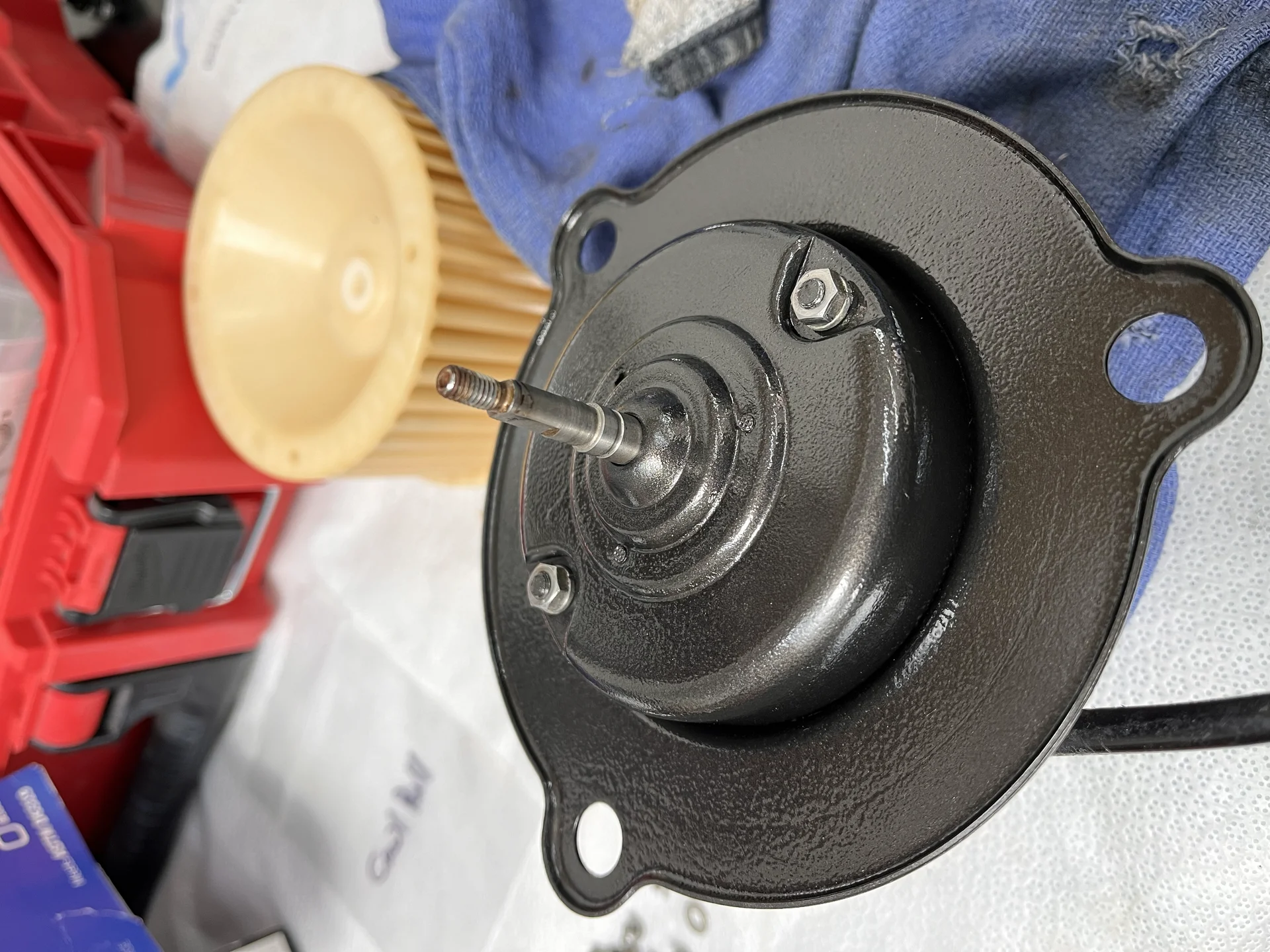

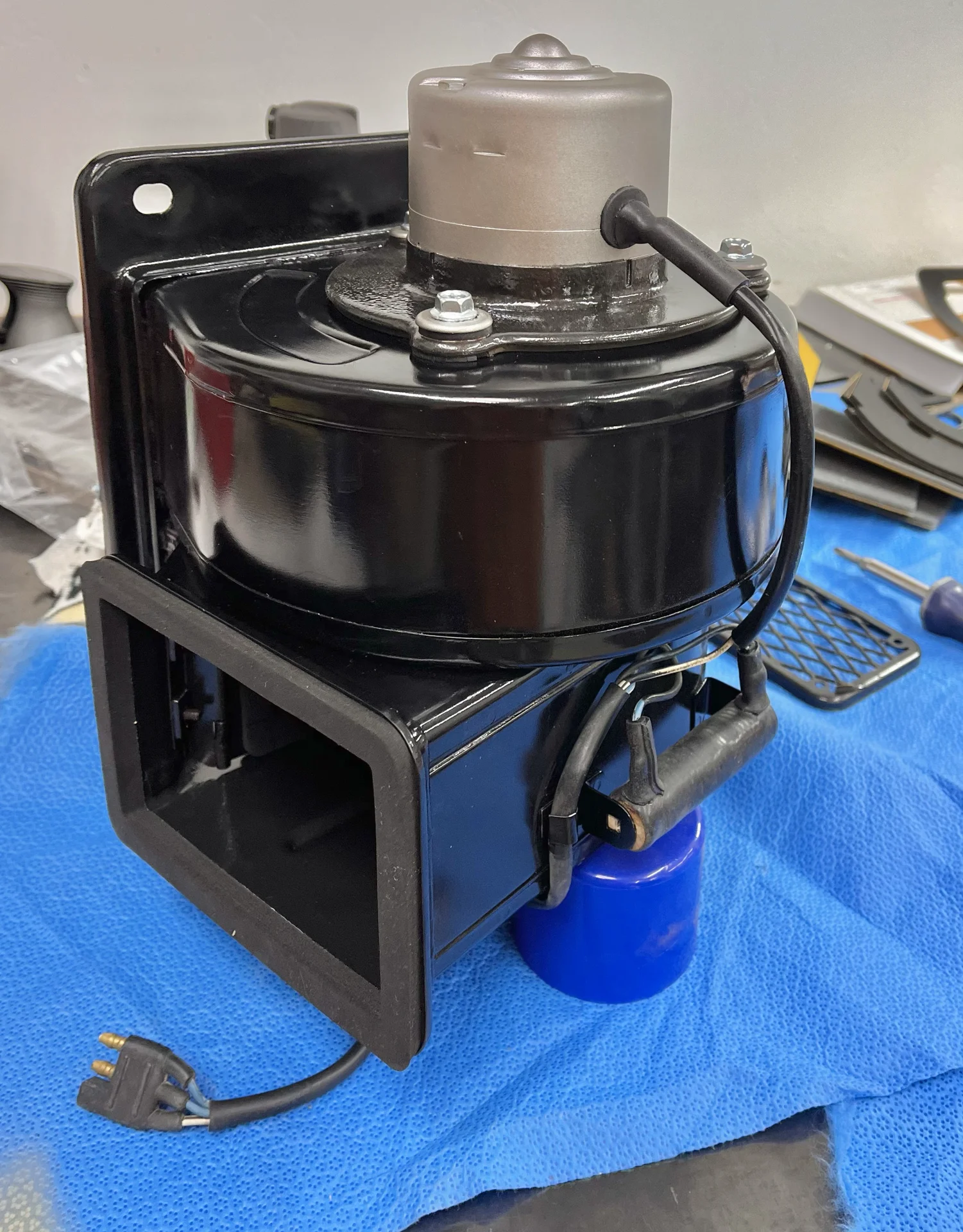

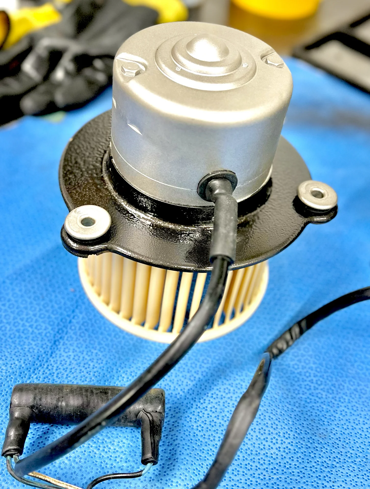

here is the blower fully assembled with new gaskets (I'll make a separate post for that)

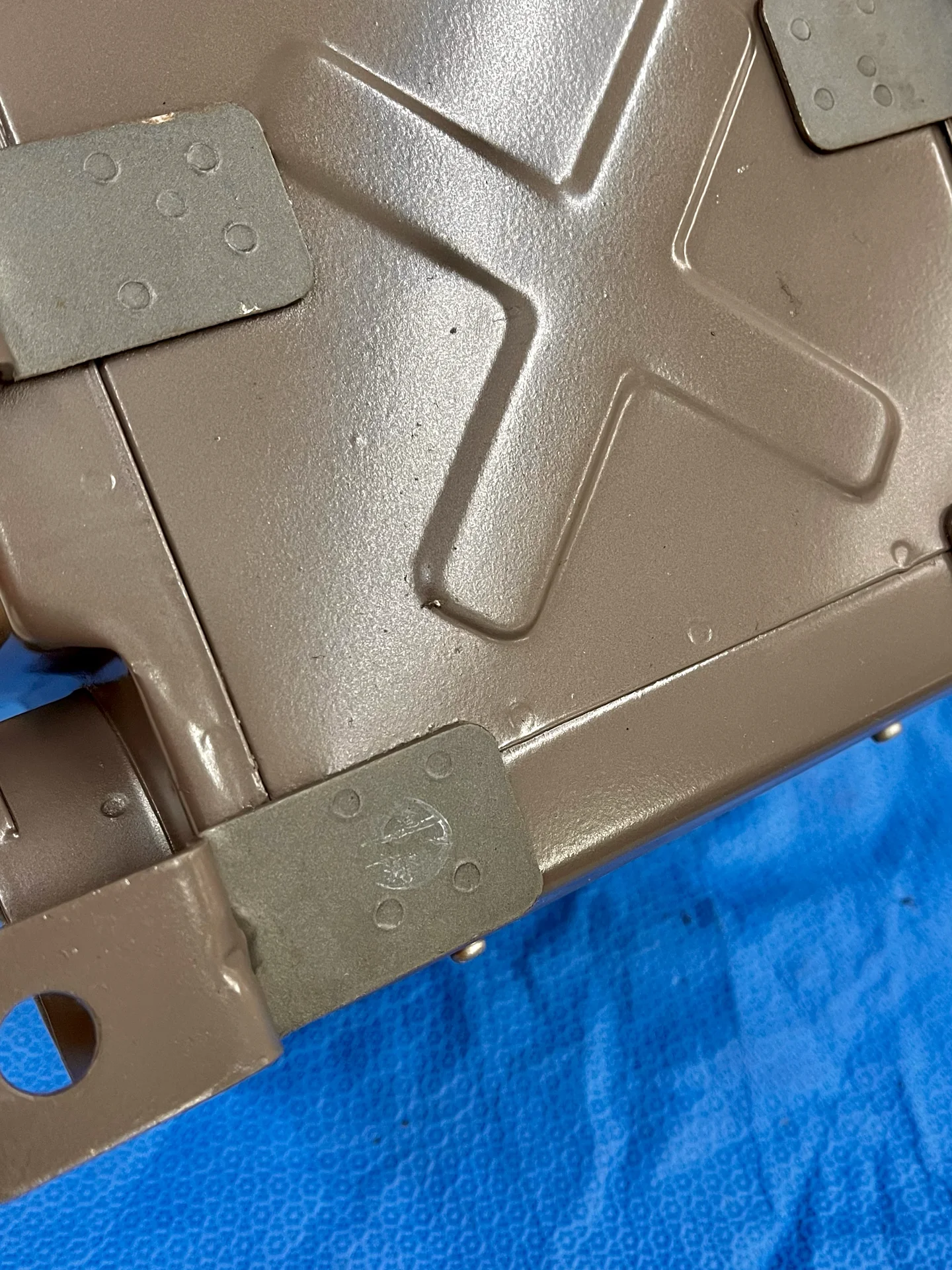

some pictures of the heater box after paint. not exact to the original (screws should be black, internal color is different etc) but the color is very close
here is a comparison of the original color to the new spray (I think it's anodized bronze - I'll double check if you need) if you look at the base of the mounting brackets, that is the original color along with the stamping in white
