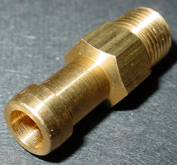

What’s the negative of converting all the hard fuel lines under the hood to rubber line?
Running something like this to the carb inlet
And a later fuel filter with barbs
This just seems simple and fast/easy to replace or work on. There is an electric pump in there now so the lines are all hodge podged. I have an OEM mechanical pump coming but am wondering if I should convert the nutted fitting to a barb (sending end) and do the same on the carb. Just run high quality rubber fuel line…
What’s the general consensus?
Thanks!
I run an electric diode fuel pump $10 last like 10 years - dirt simple, fast starts - engage the starter when the fuel pump slows/stops clicking. I like the plastic barbed filters - I can see gas flow. The paper element will not flow gas if wet with water - I put on a wet ones out in the sun for a few days to dry - good as new. I use yellow bottle fuel dryer in the fall, winter, and spring. I have a gascolator too.
I tried rubber fuel lines in the past, they degraded relatively quickly. I run metal lines like the stk metal lines were run, from the tank to the fuel pump along with the return lines with short rubber sections to connect them . I always run a metal line between the fuel pump and carb at a minimum. The fuel in the line is under pressure. Intially running metal lines can be difficult to install, but i think over time the metal lines will be cheaper and easier to deal with. I do have a quality tubing bender.
