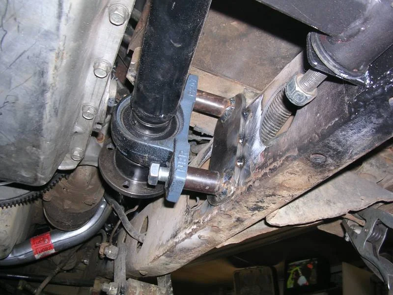

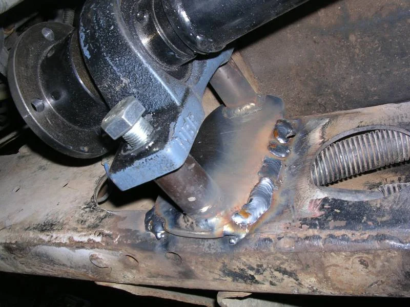

two pics of the pillow block under construction.... .250 wall DOM tapped for 5/8" fine. 1/4" plate to attach onto the frame. Nicely beveled for good weld penetration....
and two more....one tacked into place, one burned in good....fortunately, the fuel lines in the frame didn't catch fire....hehehe

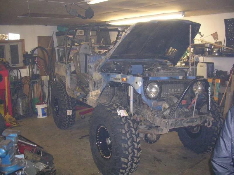

got the beadlocks assembled/torqued this morning, and 2 hours on the Lemon too....
pic 1....installed driveshaft....
pic 2....tires and rims.....
Good new, it moves on it's own!
Just some minor things left.....rear dif cover/fluid, rear driveshaft, tranny cover, skidplate....and exhaust...it's a bit loud....
