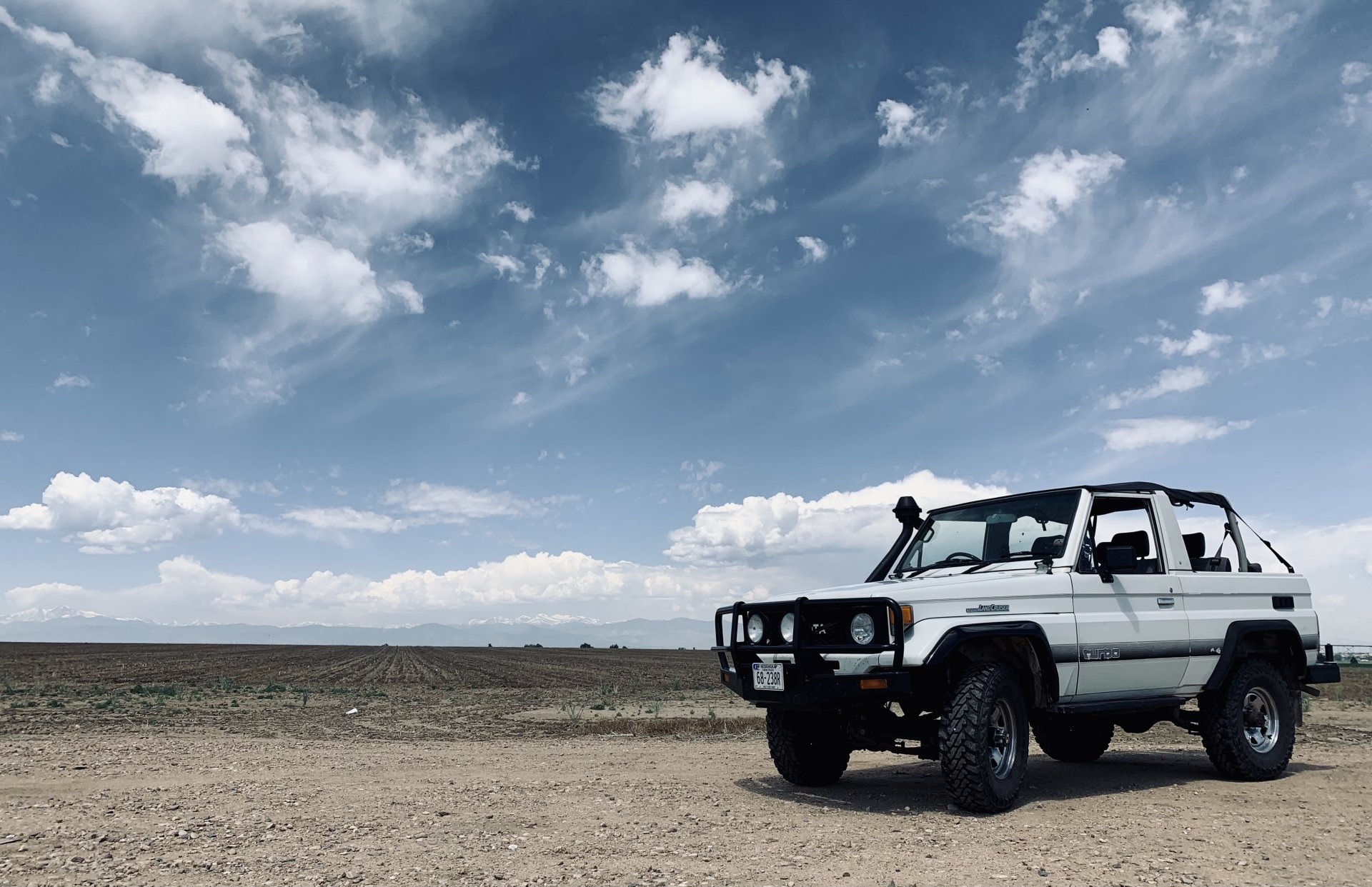

I run a bikini top and a factory repo top from the middle east on my BJ74.
Here's from my thread for the bikini.
I used a top for a 1987-1995 Jeep Wrangler. Reason $83 shipped for everything. If it doesn’t work, I’m not out much.
I used the smittybilt extended top and CJ/YJ header bar.
Top
Smittybilt Extended Top For 92-95 Jeep Wrangler YJ
Header bar/windshield channel
Smittybilt 90101 Windshield Channel for 76-95 CJ-7, CJ-8 Scrambler & Wrangler YJ
. I grabbed some screws for the top as well.
So I have an FRP fiberglass windshield, so no worries about rust. The Jeep windshields are completely flat and the 70 series slightly curved. I put a few relief cuts and bent it slightly back to better match the windshield curve. One I slipped on the saw and took a bigger chunk.
On the back there is already a threaded hole to attach the back straps. On the Jeep you just hook this under a ledge.
Velcro straps go around the bars from windshield to main roll hoop.
Same Velcro and pull strap on the back oem rollbar.
I also have the Full OEM top from the middle east. Great top.

Heya! Took off my frp top and looking for a bikini top that will fit. Maybe a bronco or jeep? I saw the options on previous post. Just wondering if anyone tried something else as well.
The jeep setup is by far the cheapest and works great.
