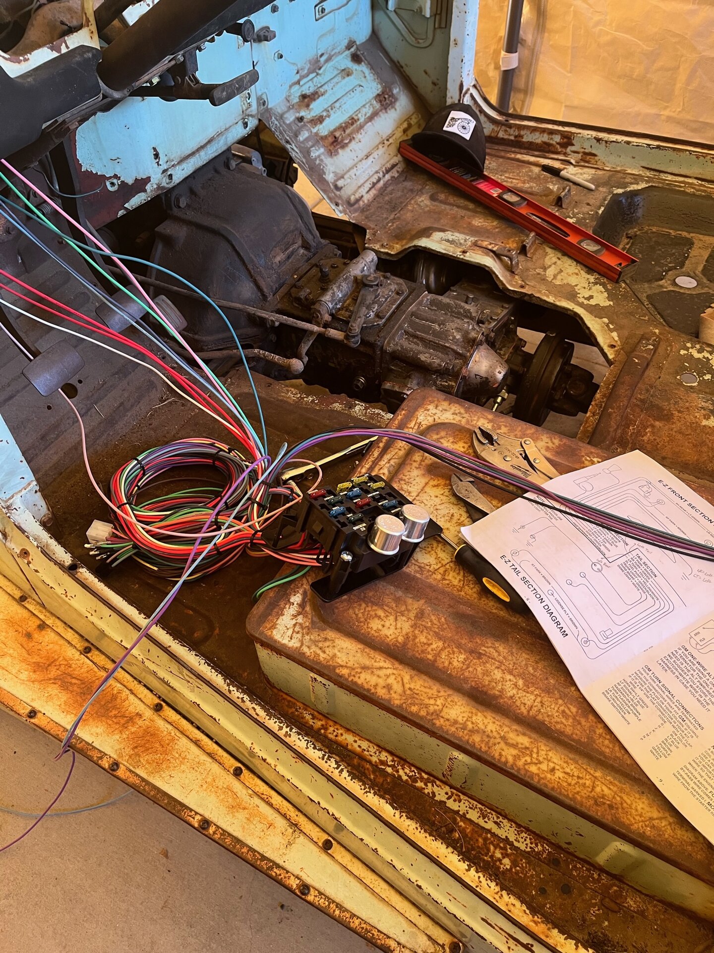

Ok, so it begins....lol! If any of you have experience using an EZ Wiring harness or any other GM type harness that ties into existing Toyota switches please feel free to respond. I've done harnesses on my other builds, but they had a GM steering column which made things fairly straight forward. This on the other hand is not. I'm using the EZ harness with a Dakota Digital cluster and the small Vintage Air heater.

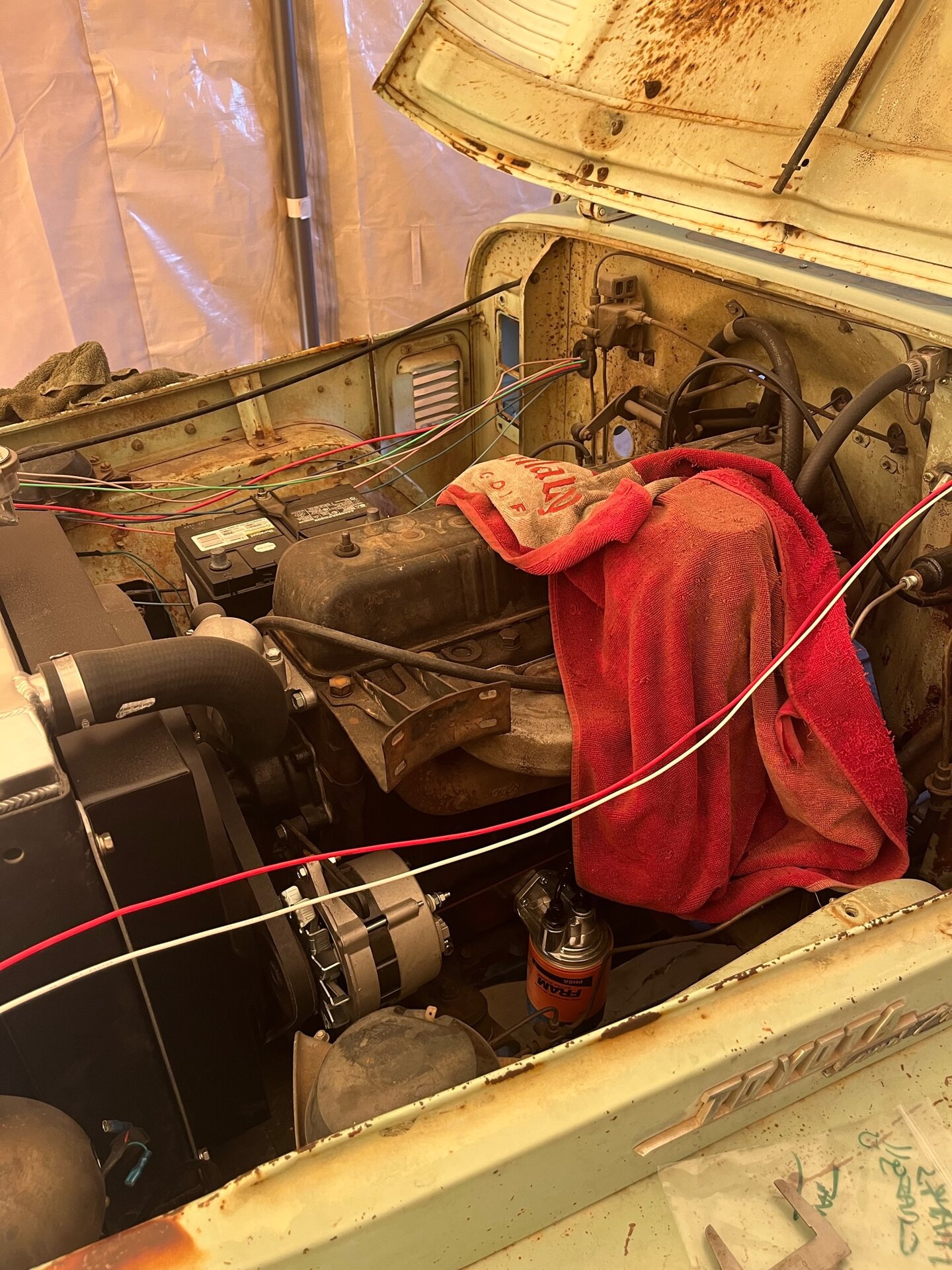

Well, I've already ran into an issue and that's the alternator. I'm going to switch out the stock one and put it a GM one wire that's more juice and makes the wiring less of a headache.
So, I had to fabricate a bracket for the 12 si alternator. I tried to mimic the stock one as much as I could in order for things to line up correctly. Here are some pics.
I ended up having the stock alternator converted to a one wire "internally" regulated type so I spent a better part of a day fabbing up a bracket I won't use. I'm making slow progress on the wiring, but it's getting there.

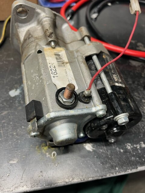

I was wondering if anyone could tell me what the black tab on the starter is for? I believe the red wire is for ignition. Any help would be great.

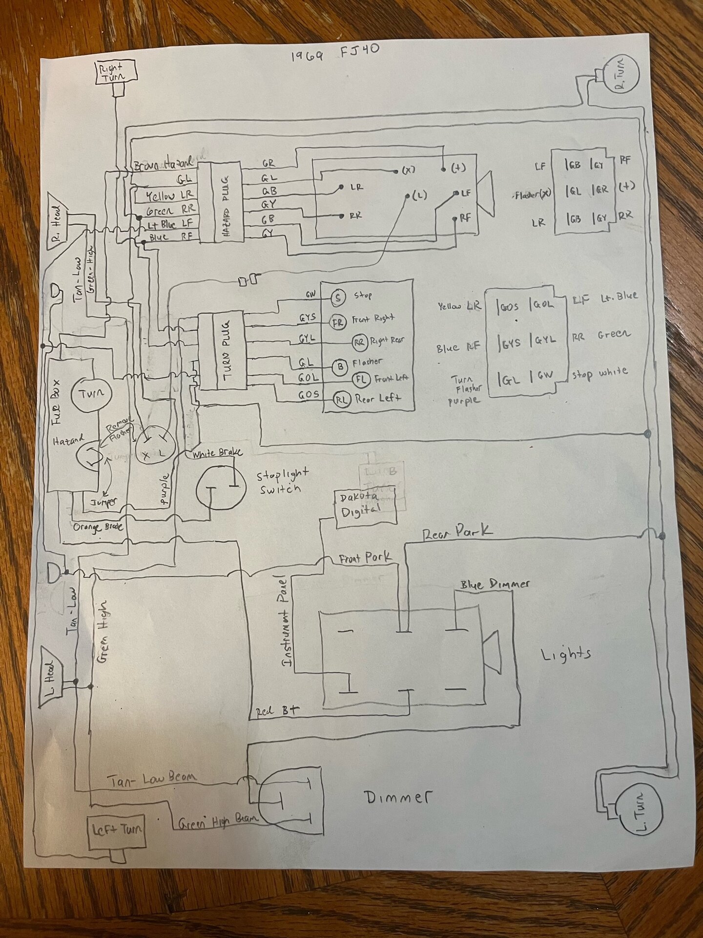

Some major progress has been made in the past couple of weeks. We now have functioning lights, blinkers, hazards, brakes, and license plate light! I still need to wire up the wipers, cig lighter, horn, and reverse switch. Using an aftermarket wiring harness is not an impossible route, but things are not as straight forward if you're not using a GM column. I basically made my own connections supplied by Coolerman and some help with his schematics. I made my own wiring diagram and I'm posting it here. It's not the easiest to follow and I plan to make a better version of it later on. Here's a pic of it for those interested in it.

Red wire on starter could be an activation wire for a previous charging system
I've used the "crank" wire to activate alternators before and it definitely works...

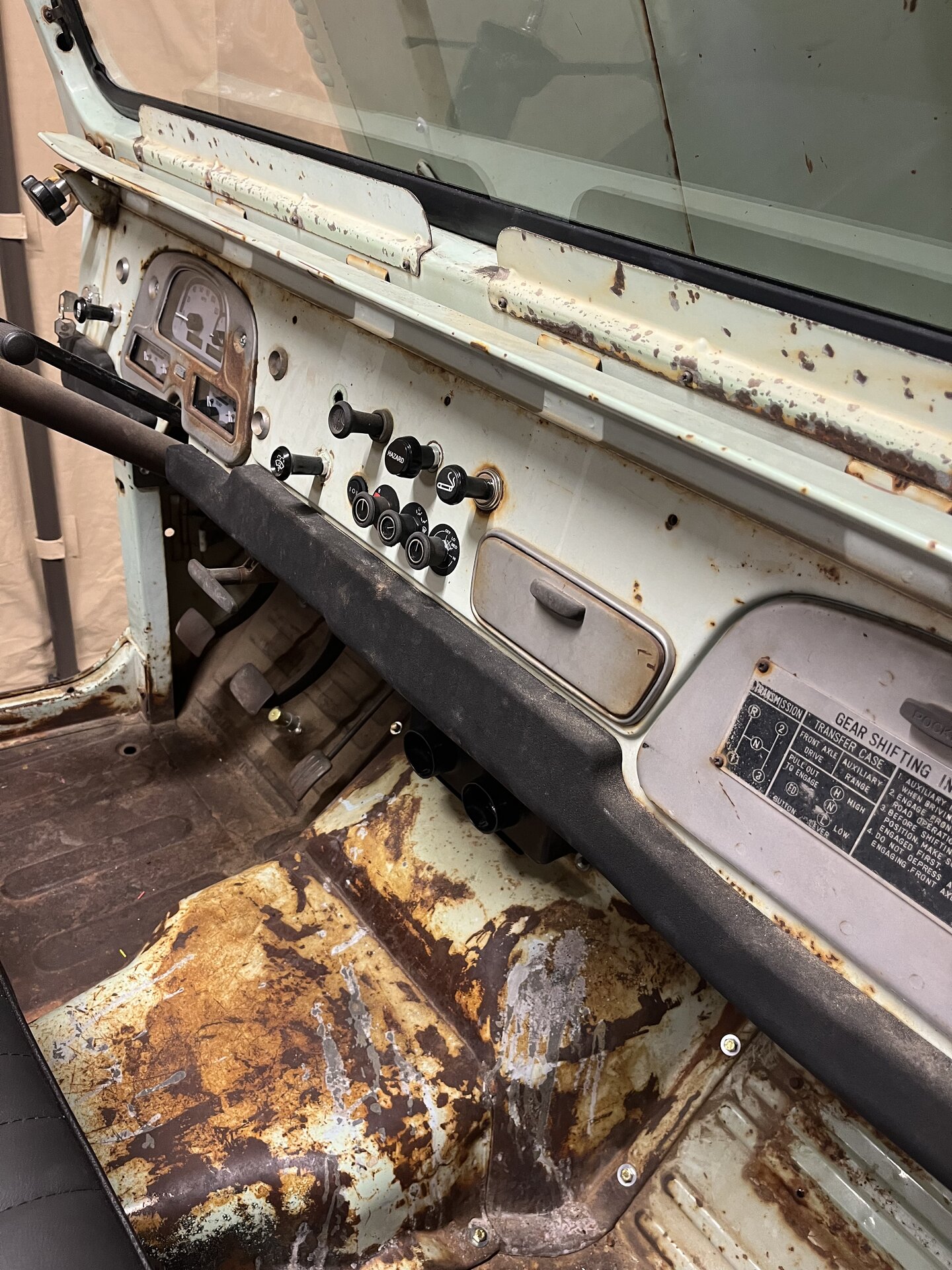

She's back on the road! The wiring is done for the most part. I still have to put some split loom on it and clean up some areas. The vintage air heater is in, but I need to get over to Home Depot and get a pair of hose adapters for the ducting. I put a steering wheel wrap on the wheel, but cannot get the horn to work. I'm wondering if the guts of it are to rusted since it won't spring back and forth. Mark's rebuilt carb is purring and it's running great. There are still a bunch of little things I want to button up here and there. Every time I look at it I see things that need to be addressed....kinda like an old house. Anyways, here are some pics.

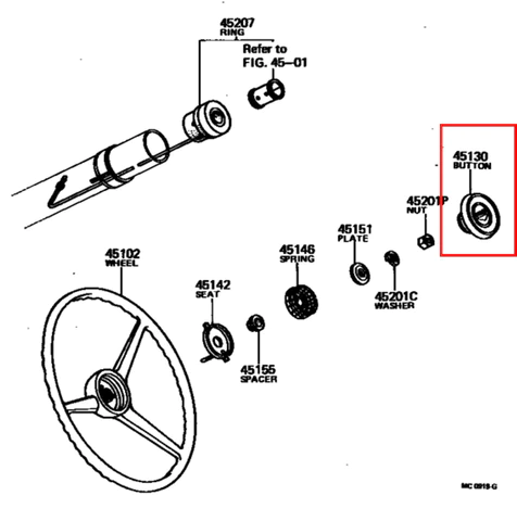

I'm trying to get this horn to work, but I think I'm missing a part. The spacer between the seat and the spring.
It's the part labeled 45155. Does anyone have one of these? I tested the ring contact at the top to the where the wire comes out in the bottom and it has continuity. When I assembled what I have back together the horn button is tight and has no spring to it. Is that what that spacer is supposed to do. Also, the horns are don't work. Not sure if it's the button or the horns themselves.
