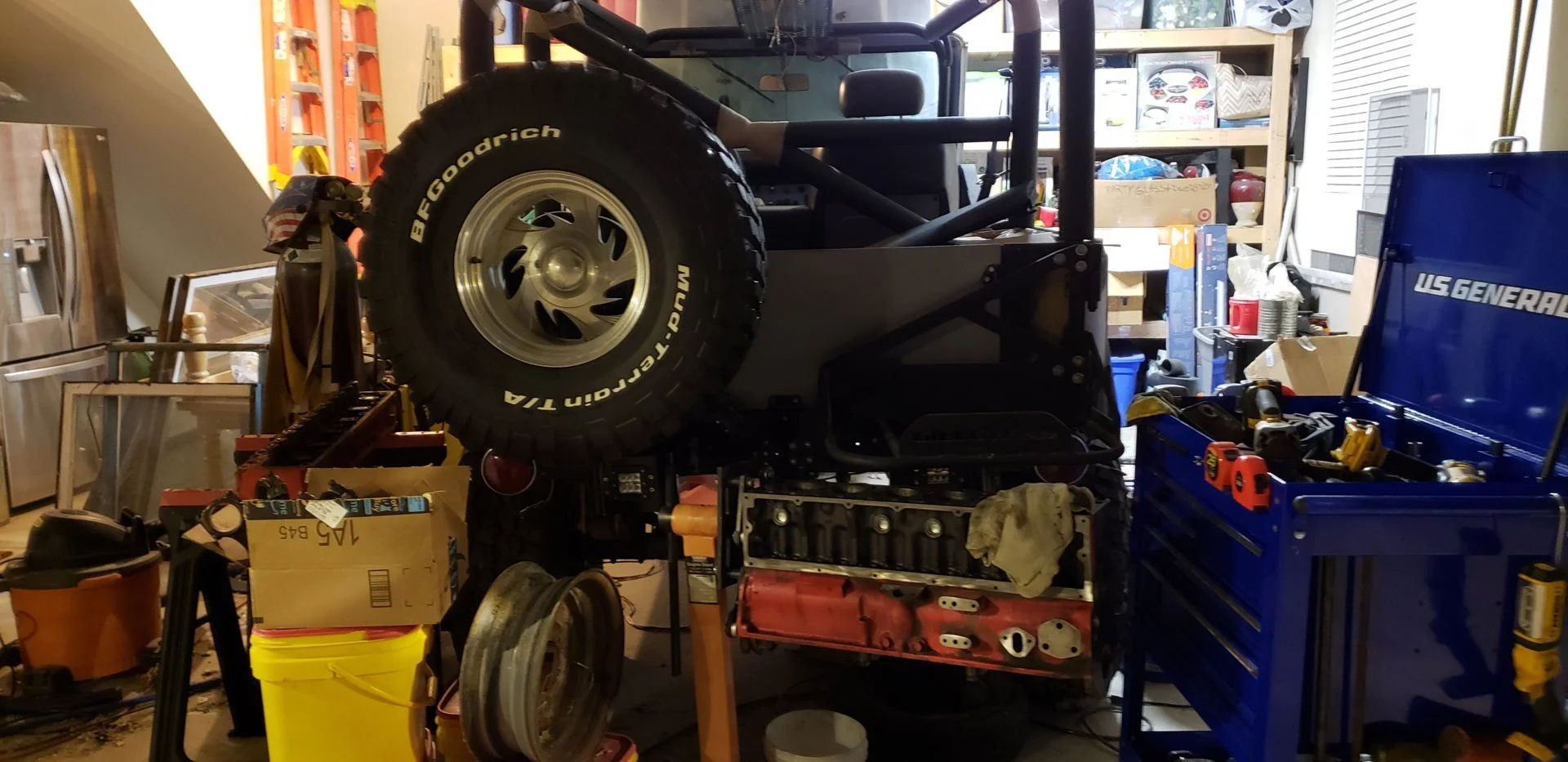

tor down the 2F today. looks to be previous build. bearings arent fully broke in yet. it must have been a popped head gasket. #3 hole has some pitting in the cyl wall and #2 has a small bugger in the top of the cyl to #3. decking the block will take care of it. and a skim on the head. it was WAY over carbed (a Edlebrock 750) ordered a 500 today. i have 2 choices for intake manifold: an Offenhauser split plane or single plane? it'll be a daily driver....sooo....? pics as soon as i help the wife do something

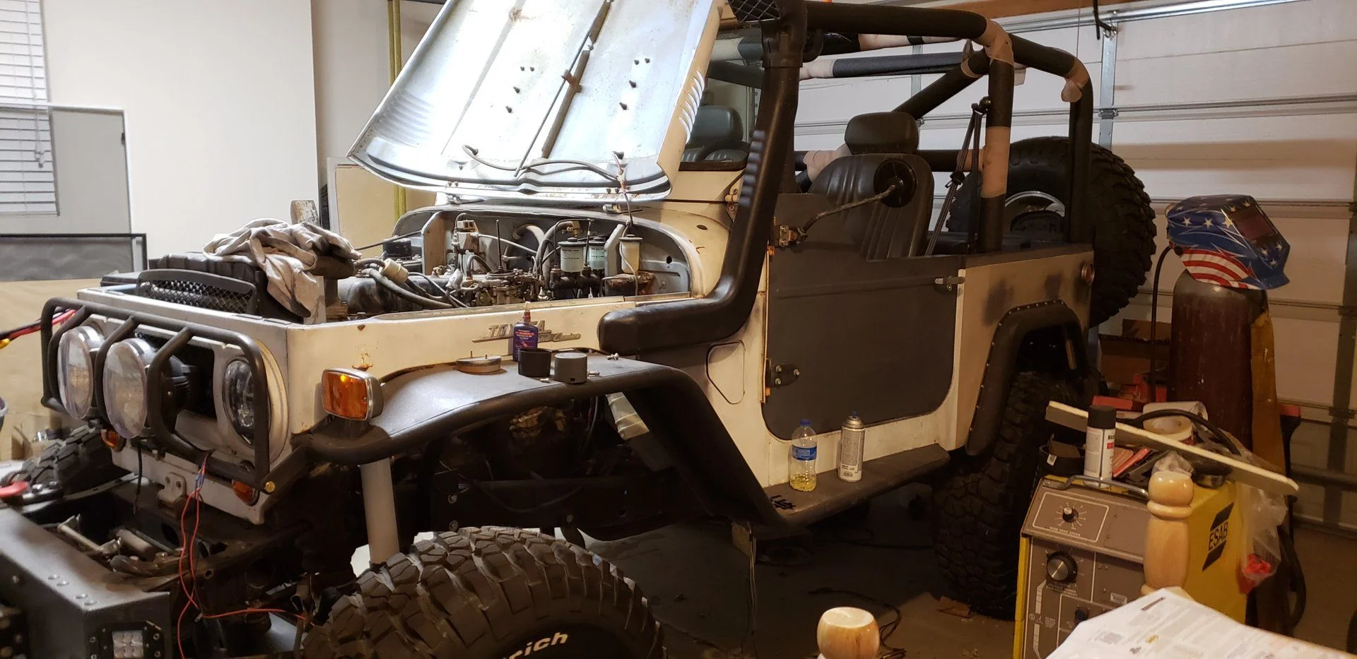

they're up. more to come. FJ60 axles, flipped on 35's. have original fenders and a bunch of other parts. 60 rims, 40 rims and tires. ambi door rubber and barn door hinges. etc.etc.etc........etc.
#1: don’t order ANYTHING until you have a machine shop tell you the block can be reused.
#2: A 500cfm Holley is a sure-fired fast-tracked one-way ticket to a set of washed-out piston rings. I wouldn’t break a fresh motor in with anything other than a perfectly tuned stock carb.
This doesn’t mean you need to buy one, even though you should consider it. Amongst all the volunteers who are going to come over and help you, perhaps one of them has a good running carb they would be willing to loan you for the 20 minutes or so you need to seat the rings.:idea:

brother im open. work till 5 home by 6. unless im on a well or inspection, then off at 3 home by 4. saturdays are my git it done days. sundays if i have to, but not preferred. wife said i can have a kitchen pass untill its done (honey do list freezes in place). the upoulstry guy wants the roll bar in a few weeks. i have a paint booth for use when the prep qork is done. i just ordered a gallon of chassis saver. (next weekend) or im prepping the fiberglass top and rear sides. paint is on hand. hot rodz flat petty blue and arctic white for the top and bezel. my big headache is my wiring

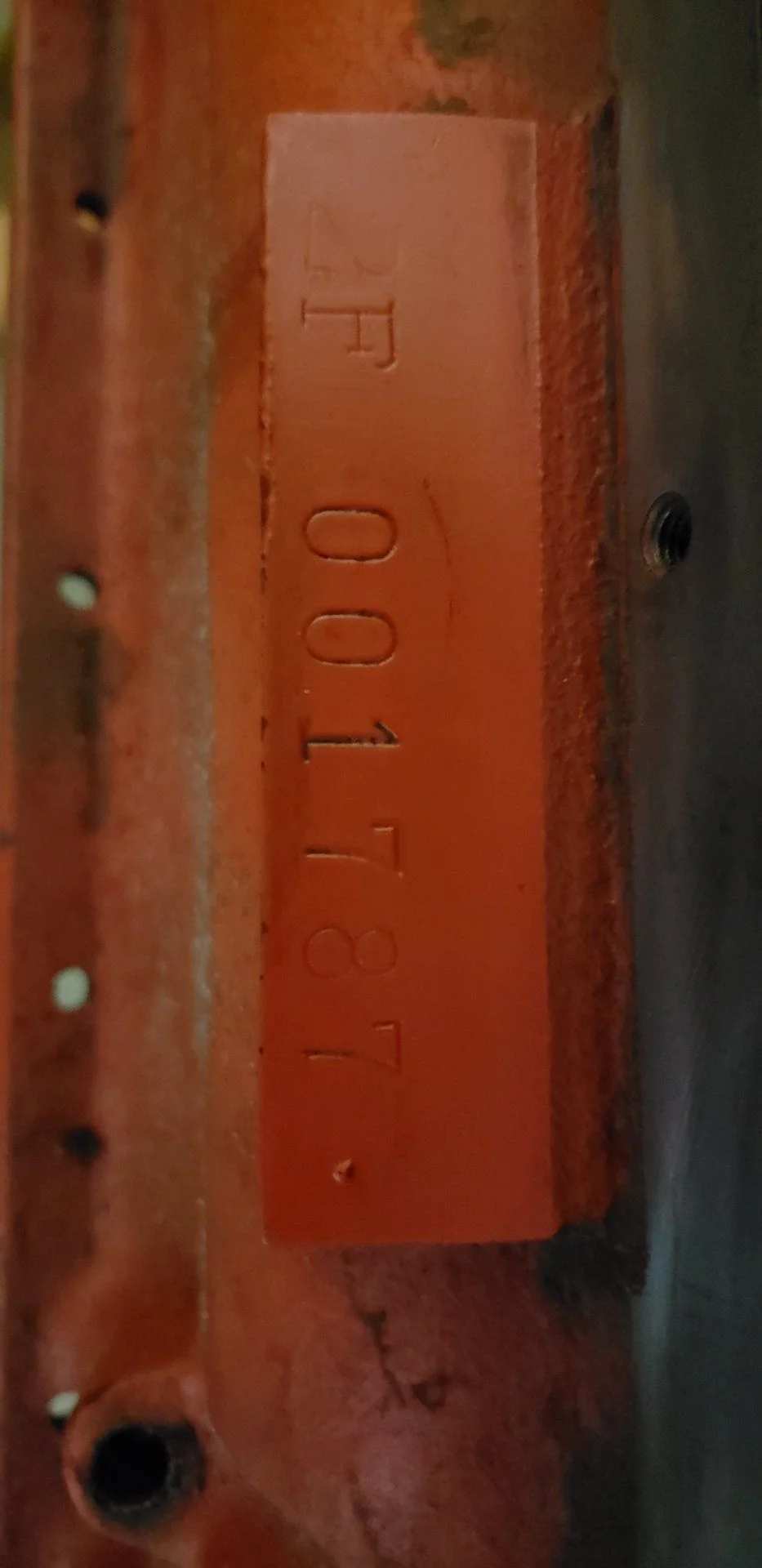

Hey UTAH Bob ,
again , Welcome to MUD .....................
u have a :
2F 001787 engine serial #
that puts it @ January 1975 Build Date ( I think ) o_O
so , the Donor Vehical was either a 1/75 FJ40 , or FJ55 if its a USA spec. 2F
Logic would conclude they built many hundreds if not thousands of 2F engines in the first 30 days of 1975 , U have a VERY early 2F
maybe @devo :poof: can double check my math ..........
where this comes in play if for ordering parts from / for your machine shop like @65swb45 suggested
Here is a :
2F Engine Serial Numbers Chart
The engine number is stamped on the right side of the engine block right above the starter. Engines listed are starting production numbers
based on a particular month and year. If your number is not shown you may have to "Best Guess" your production date.
