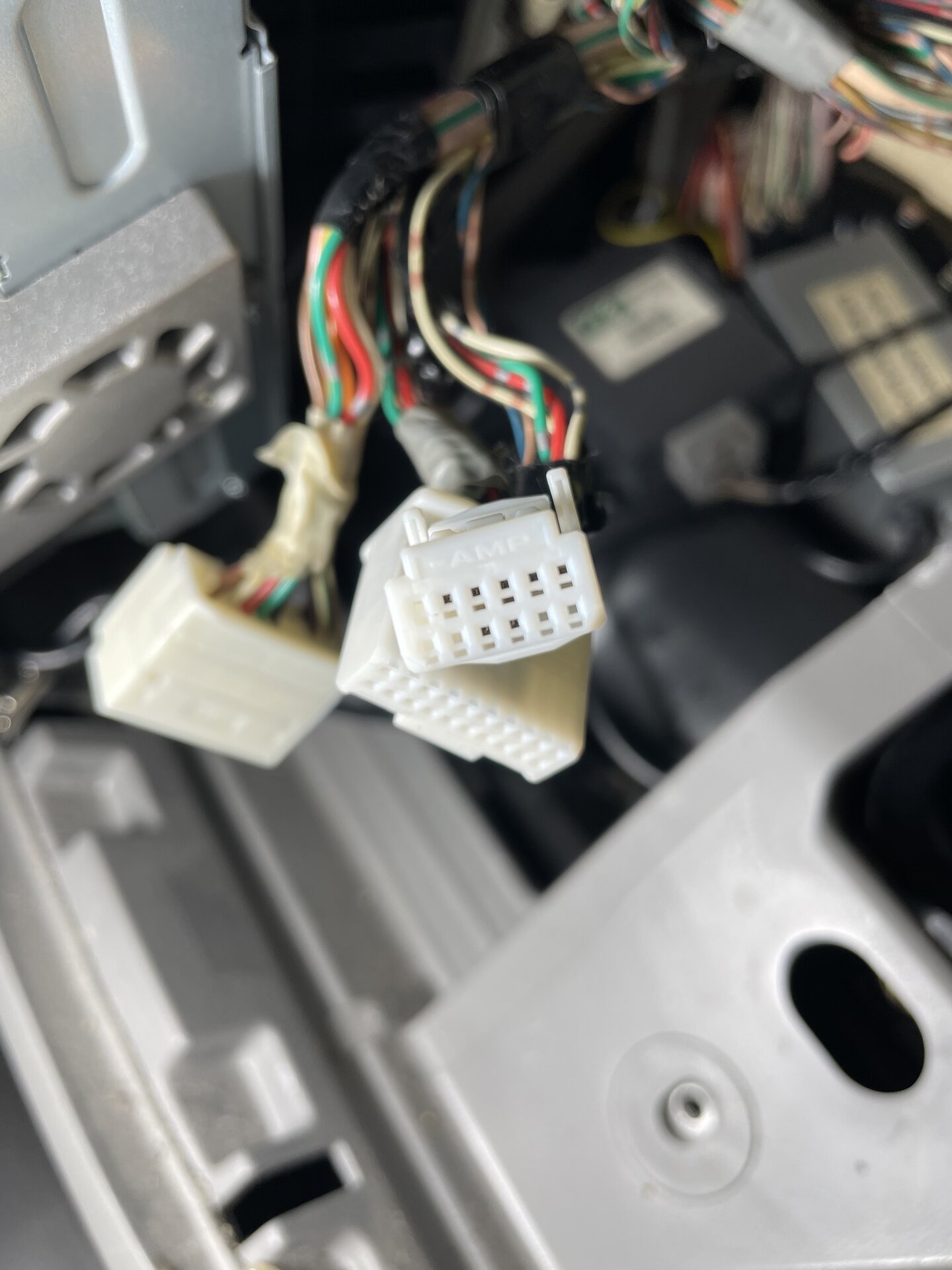

I only use the display for back up cam. It never comes on except when in reverse. I put the climate screen on and took a pic so you guys could see. Everything works fine. I tested and measured before I cut the harness.

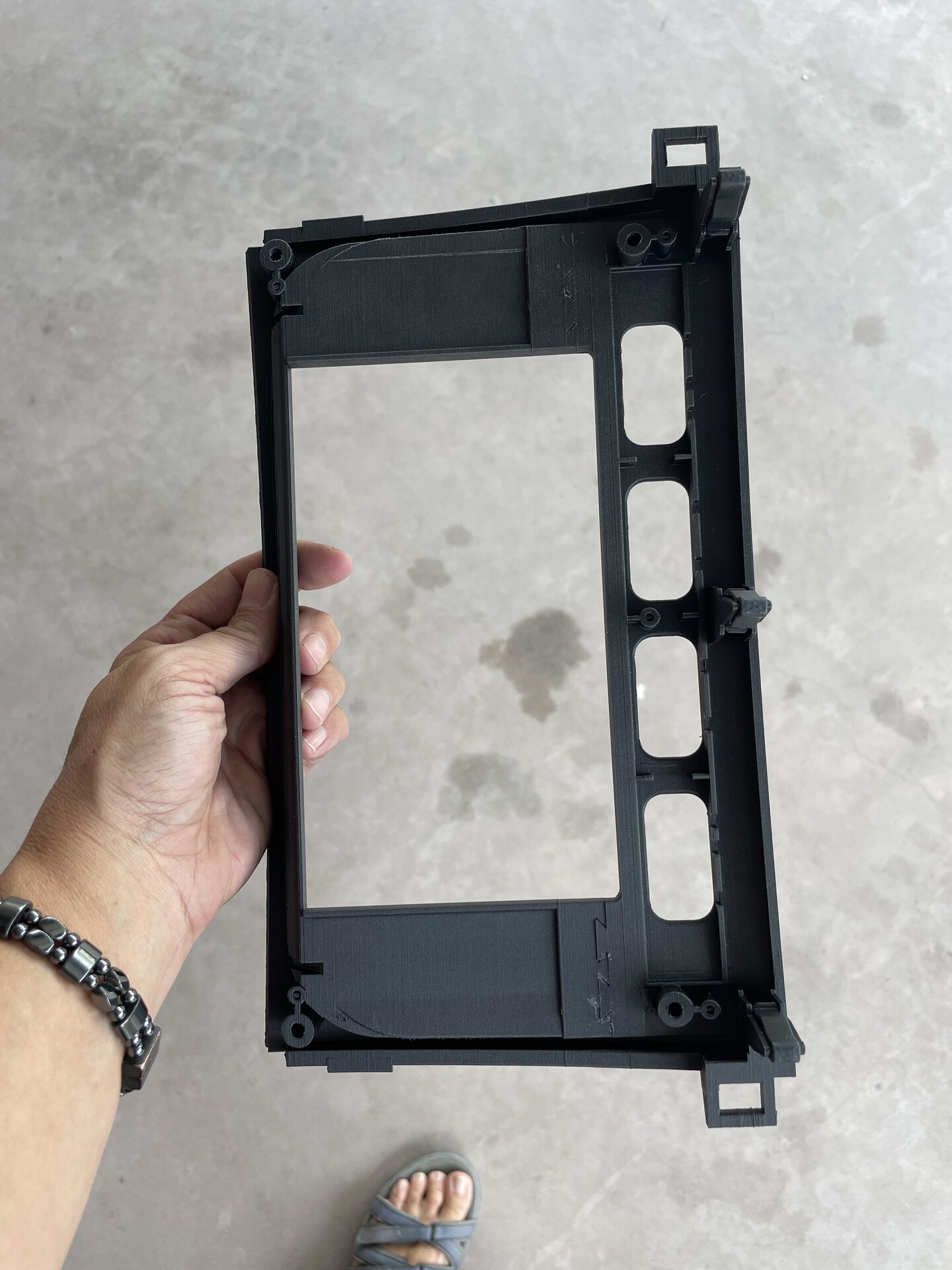

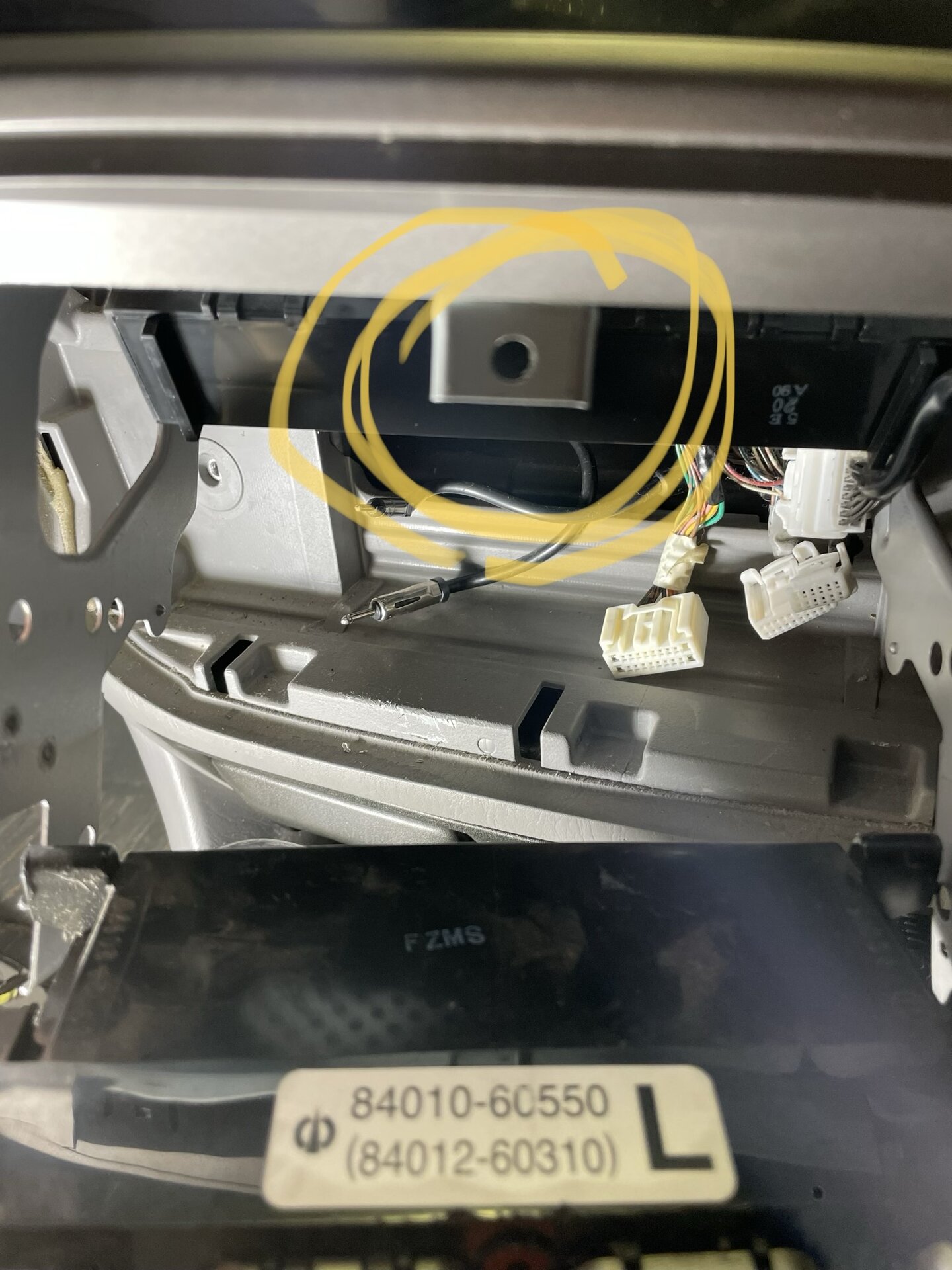

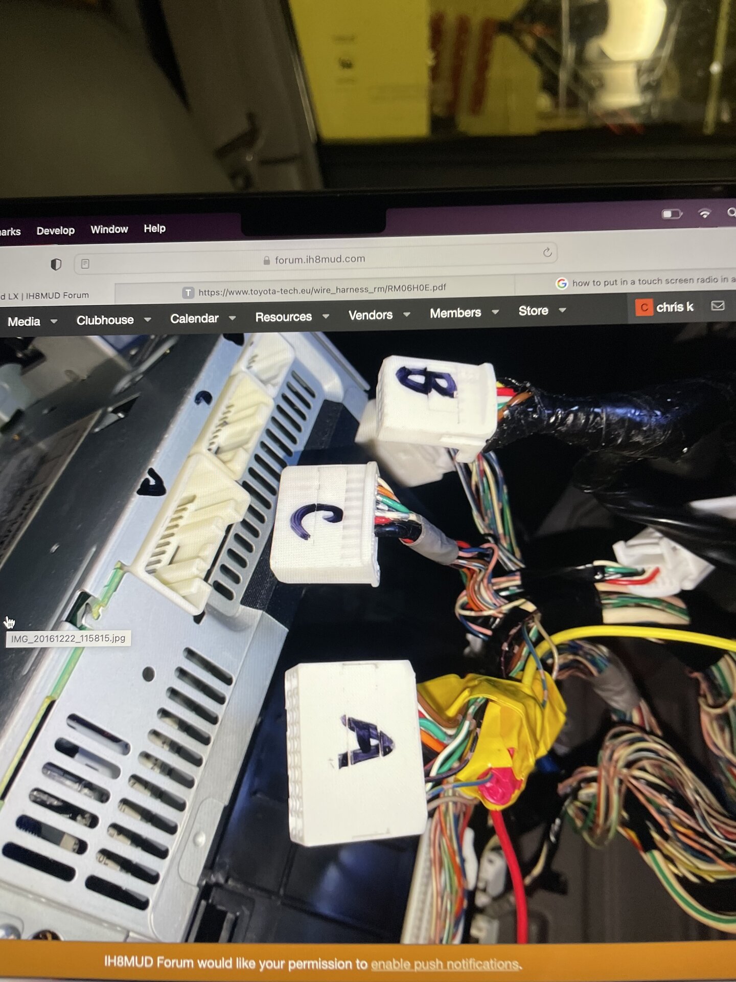

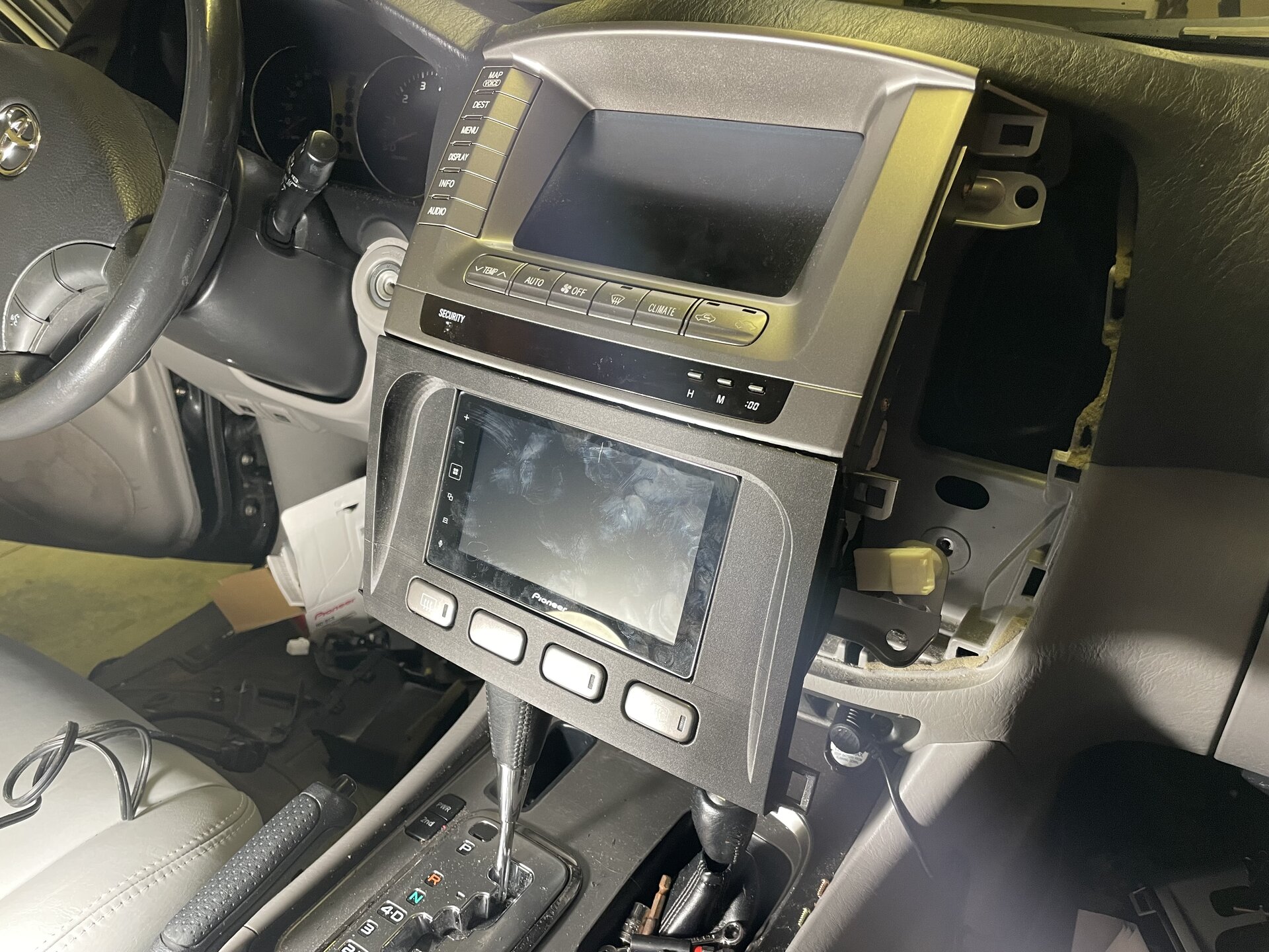

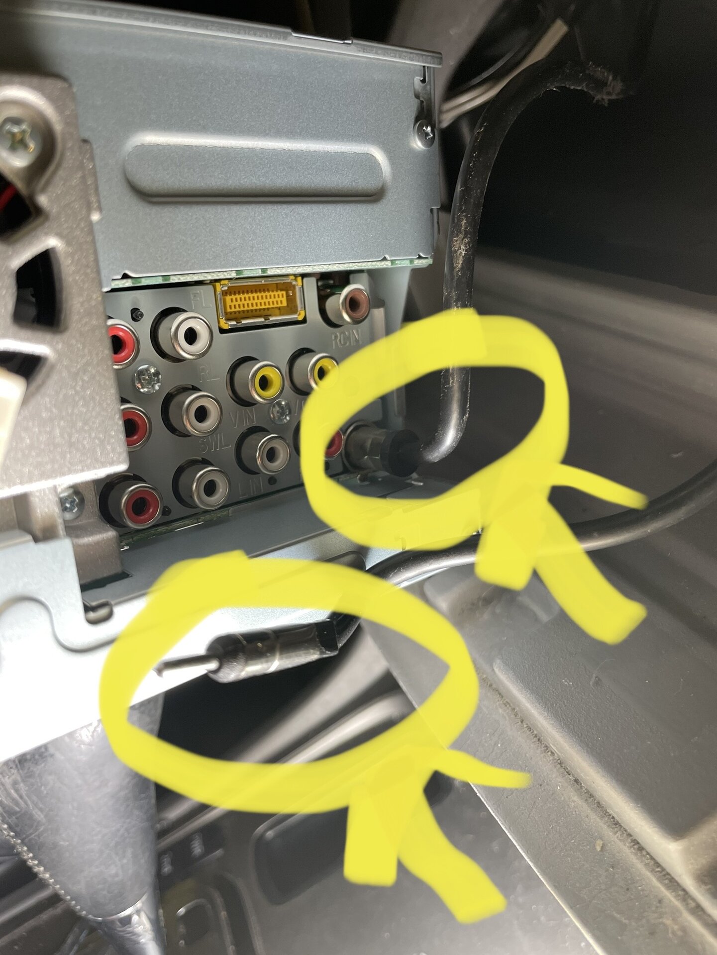

I order a Pioneer MVH-1400NEX From Proffits and the 3d printer part. They also talked about the work around with the 68 ohm .5 watt resistor. And I got everything out and will post the picture of 3d printer with the pioneer in it. But with these three connections coming out of the back I'm confused on just hooking it up in general as I'm novice to say the least. The 2 black cords came out of the Factory Toyo radio and only one will fit in the new stereo. Where does that smaller one go to? I did put a scratch in the screen as one of my pics you can see the metal piece at the top that you will have to remove. I didn't at first and that how I got it when trying to put it in from the rear. But it just pulls off easily. I'm think I labeled the connections right.. My question as well is B is that the internal factory amp. He told me to hook up the RCA cables from the pioneer to the factory amp. Lastly, the last pic I uploaded is the wires that are hooked up to the pioneer, which plug am I looking for to match up these wires to is it the A. Much help appreciated as I apologize in advance for not knowing a whole lot..

I don't even need it but I want one of those 3d printed part.
Is that on a website somewhere?
There are two antennas, search dual antenna, motorola, adapter.

I'll post the ABC connector pics.
around page 325 in the attached pdf.
Your car may or may not have extra not mentioned wires.

Thanks for the pics and help.. I order everything though here Proffitt's Resurrection Land Cruisers – We exist to preserve and enhance the legendary Land Cruiser in a way that nobody else can. - https://www.resurrectionlandcruisers.com/. Go on there and email them 3d part like the 2003 they did and its on their YouTube channel. Now I went home at lunch just to see if I could by pass the factory amp. I unplugged everything and put the resistor in the two pin spots but when I cranked it up the screen came on for maybe 15 secs or so but then went out. I'm assuming that I didn't have a good connection to the resistor? I just don't want to cut wires at this point. I went and plugged everything back up to the original radio just to make sure everything was working correctly. And Praise the lord it was..
