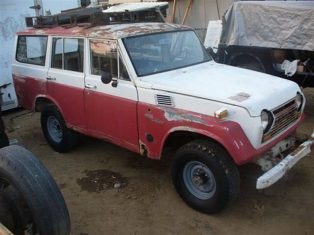

The VIN is F55-11106. What year is it?
Yup, that's a '68...and under 12 thousand, means you should have the front apron-mounted lights instead of the fender mounts....
Like these.
Ain't it cool!!!!!!!

I won the ebay auction 3.5yrs ago for the 68 while attending my first Surf-n-turf. My wife calls me at the beach and says I won a FJ55 grille for $500 bucks. She asked what makes a FJ55 grille worth $500? I replied "it comes with a free complete FJ55". The piggy had been sitting since '83. I had to literally dig it free from the hill side to load it on the trailer. I removed 18lbs of varmint poop from the interior. Spent 2 weeks carefully unlocking the frozen engine. I have worked on and off until now bringing her back to life mechanically. Now I have decided the time has come for her to see the road again:steer:.

Sweet. Love the early turn signals. What ever you do don't mod them. Try to keep them original. If not send them to me. I'd love to try to reproduce the lenses.
If your serious about doing a repop on the lenses, I could send you one. I have plans to keep this 68 original as possible.
Mine is FJ55-10816; does that mean mine is a '68 also? It has those same type side lights. Sorry for the highjack....
