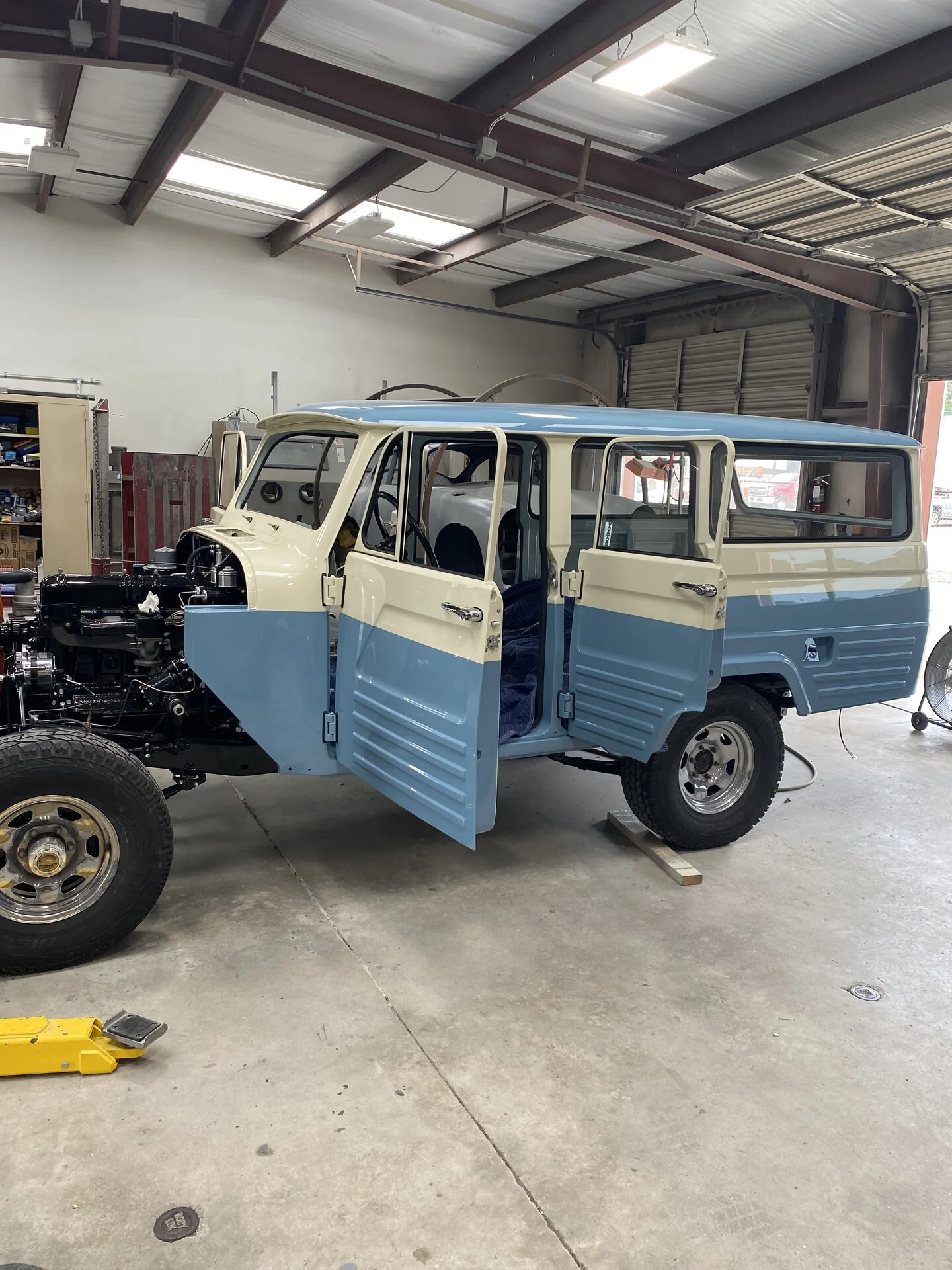

Hi everyone! New here to the Mud forgive me! Im in the home stretch of finishing @crustycruise LV build and I just wanted to see what luck everyone was having with oils.
What weights, brand, additives
Front/rear diffs, engine oil, 3 speed trans, T-case
Pretty sure I dont want to use synthetic for any of these, just good old non synthetic.
Let me know your thoughts!
Pics FYE !!!
