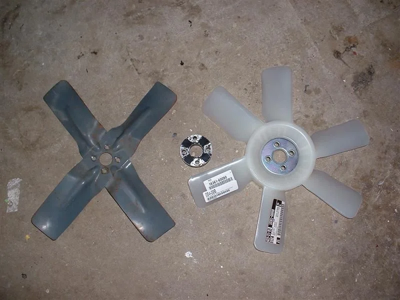

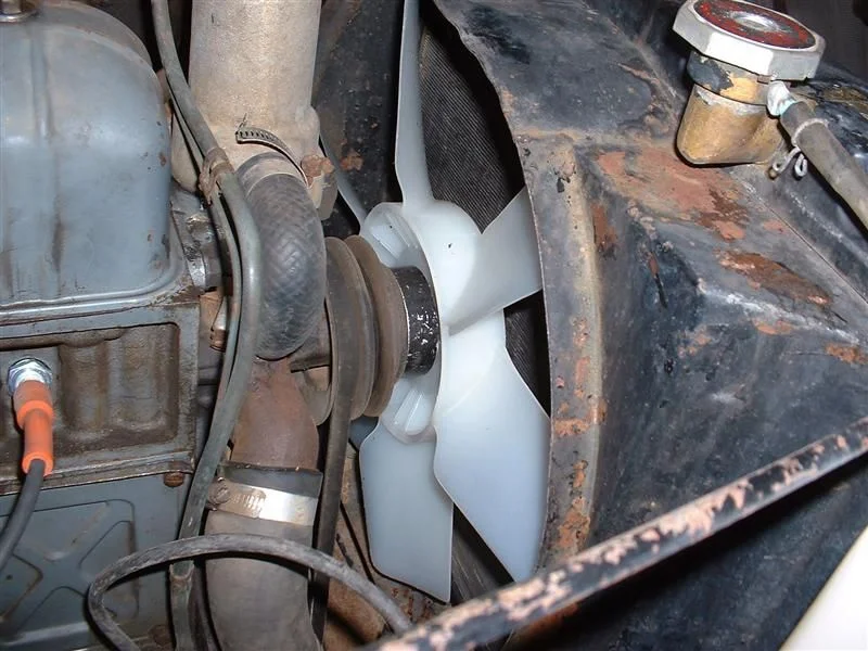

Installed a few parts yesterday and this morning. The clutch master has been leaking on the inside of the firewall and knew it had just a few pedal pushes left, so it was replaced with a new master, slave, hard line and steel braided line. It made a huge difference in the feel of the pedal. I have been a little leery about driving around with the factory steel fan, too many horror stories. It was replaced with a factory 6 blade plastic fan (non fan clutch type) and fan spacer to keep it away from the pulleys and belt. This new fan moves a lot of air compared to the stock steel one.

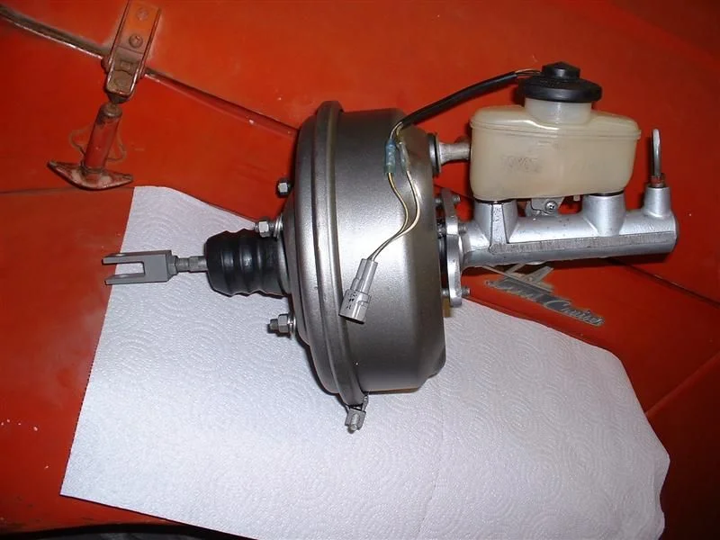

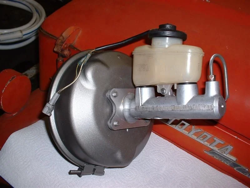

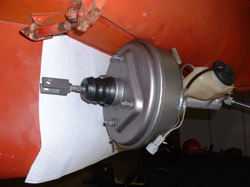

My brake parts are almost together, rear rotors and brackets from Poser, front outers from Orangefj45 and being mud-shipped via D"Animal, brake booster from Landcrusher909. I just picked up the booster this afternoon, ABS Brake in Orange rebuilt it for me, 1 day turn around $85.00. Picked up my master cylinder ('92 Toyota Supra) at the local pick a part, $20.00. Almost time to start wrenchin'.

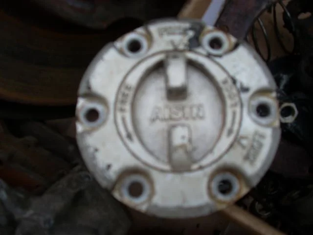

I just received these beauties in the mail today (Thanks, you know who you are;) ). I will run these as is for awhile, but will get them refinished.
