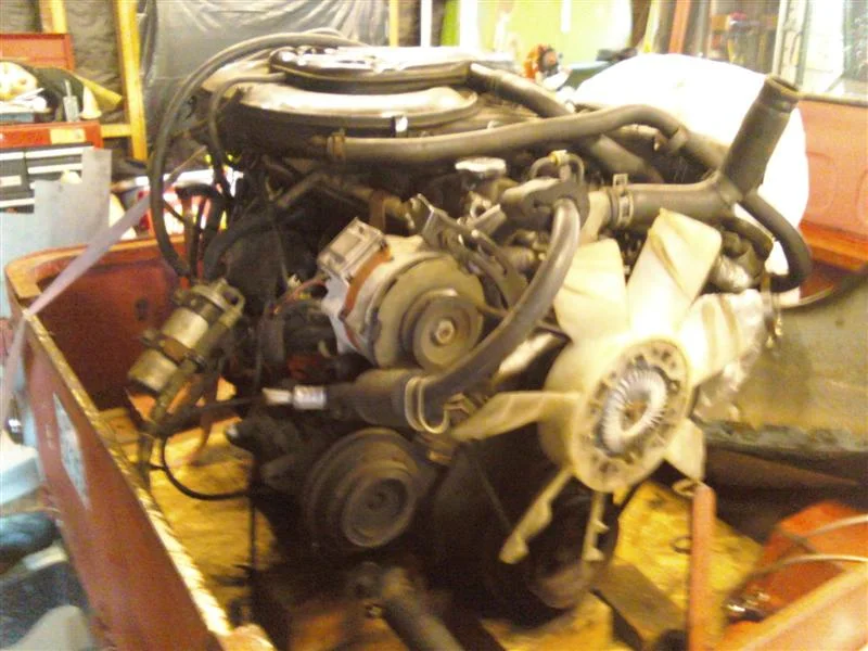

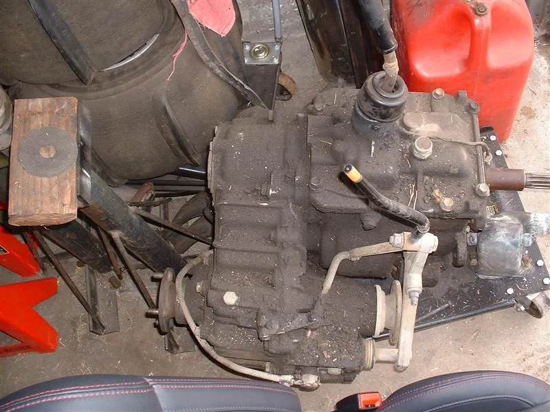

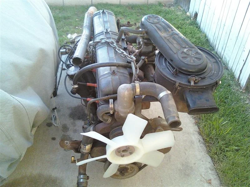

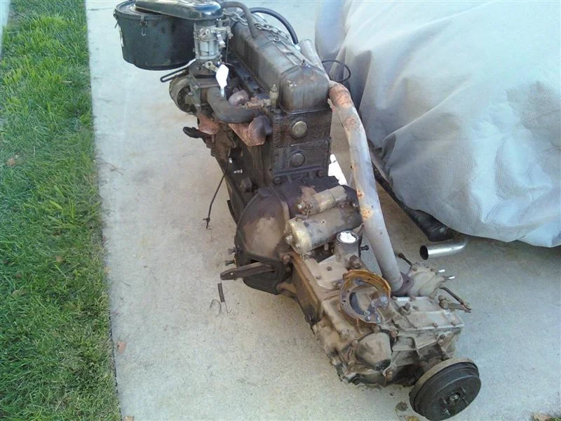

After the 45 run I decided I can not stand the F motor/3 speed combo or manual steering, so out with the old and in with the new. The tired F motor got scrapped out and is being replaced by a TBI fed 2F motor. I will begin de-smogging the 2F and installing an AFI TBI kit. The new motor will be backed by a 4 speed and split t-case out of an FJ60. I held out as long as I could about power steering and since I am the one driving it, it is getting power steering.

I have not gotten very much time to work on the 45 lately, but today I removed all of the smog equipment, in preparation for the AFI fuel injection system. After a thorough cleaning I will be installing all new seals, gaskets, repainting the head/ block/ oil pan and I might even polish the valve cover :grinpimp:. The 4 speed trans and split t-case will be rebuilt prior to install as well as a "twin stick" from Georg, I need to figure out what year rebuild kits I need. I forgot what year FJ60 they were removed from :hhmm:

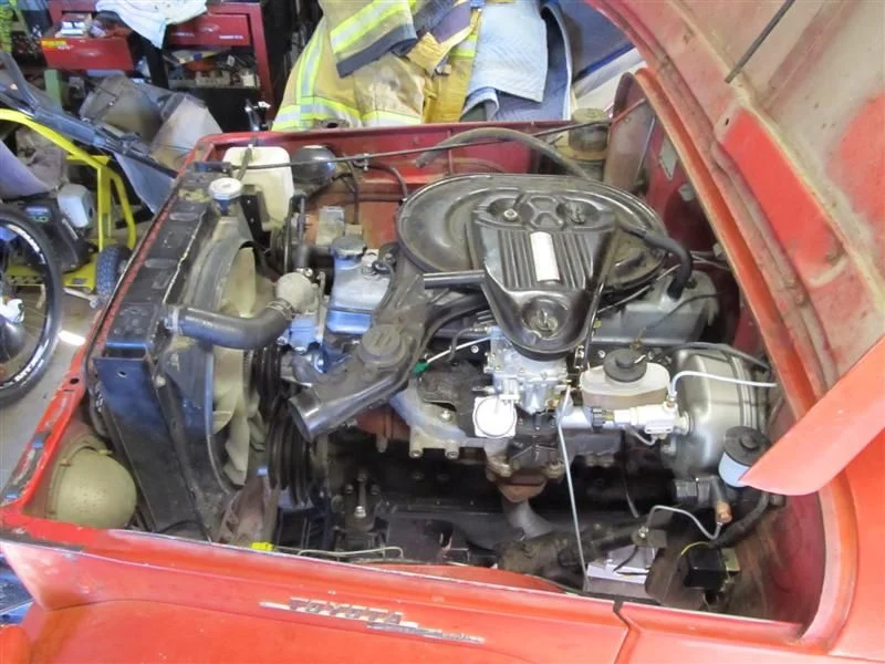

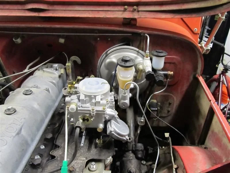

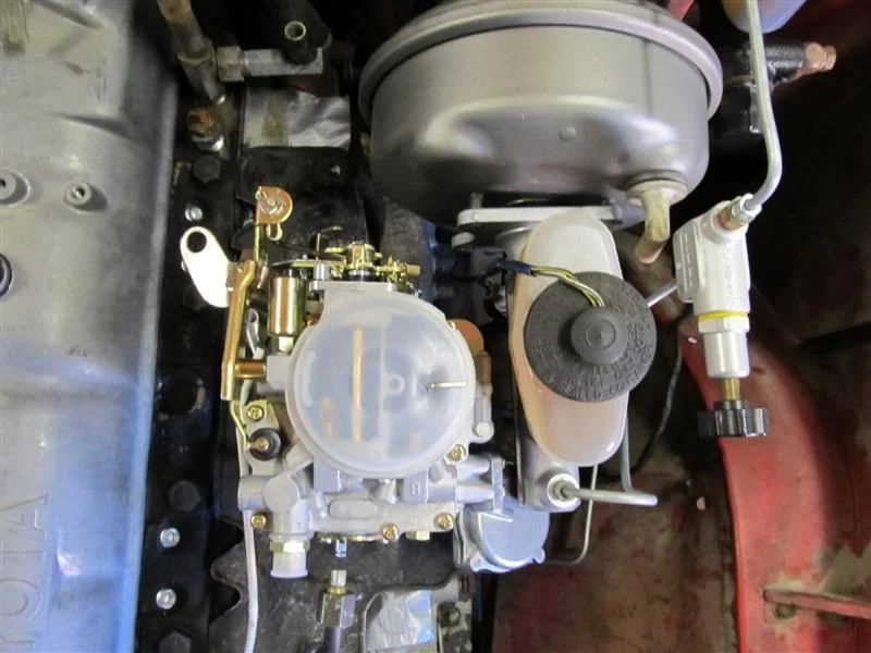

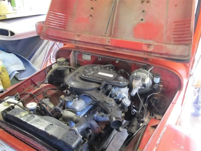

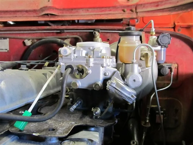

Wow! it has been a long time since I have posted on this thread. My attention has been on another vehicle, but now I am trying to get this one back on the road in time for the 45 run. My son leaves for Marine Corps boot camp in November and he really wants to attend the 45 run again this year. The "new" motor is in, a Trollhole carb is being used for now (TBI will be going in in the future). I thought it was going to be fairly straight forward installing said parts, BUT NO! The intake and exhaust sit farther away from the block than the F motor, so the carb was into the m/c. That being said, I had to remove the booster firewall spacer and trim the firewall rib (hated to do it but it was a necessity) I wont get into what all is involved to get everything to work (as I am trying to expunge it from my memory) but it was a classic case of 1 step forward and 5 steps back. Early firewall and later model parts don't play well together i.e. brake booster, clutch M/C, brake lines, accelerator cable, pedal for cable set up. Tomorrow the trans and t-case will be going in and more issues I am sure!! Anyway a few progress shots and a few headache shots to boot.
