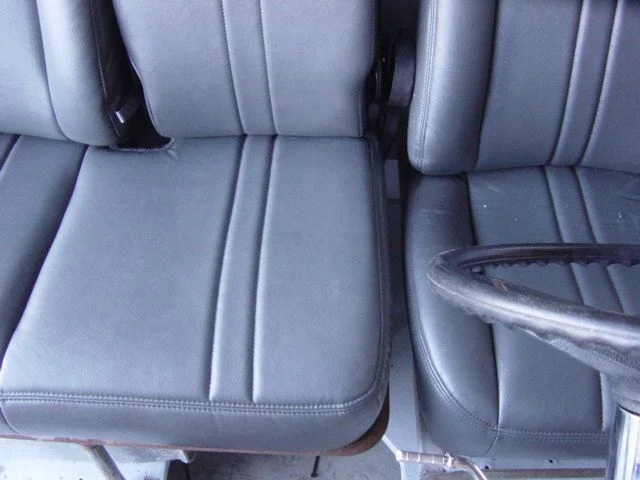

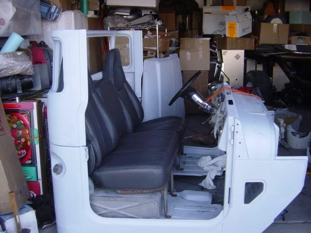

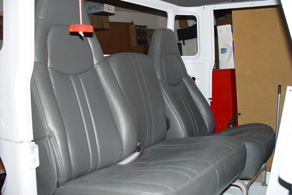

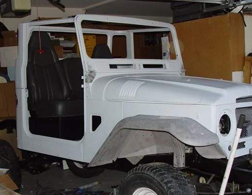

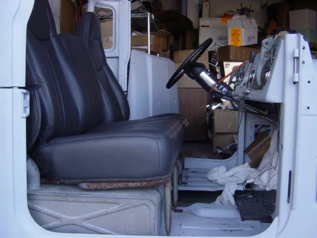

I am planning to use seats out of a 2007 GMC van (like they use for U-haul trucks). They are a bench on the passenger side, bucket on the drivers, just like the original 45 seats. They have bucket seat high-backs on both, and a fold down center back section with storage in it. I will post up pictures when I get home tonight or in the morning. I have not permanantly mounted them yet, but have done all of my test fitting. I am mounting both of them on the original 45 seat frames. They dont protrude into your leg space, and because they are designed for a truck cab, they have very upright backs that dont interfere with the cab back (the problem most buckets have in the 45). They even seem to fit around the filler neck nicely. I'll post pics.
pics of my seats
here are a couple pics of the seats... it looks like the passenger is higher than the driver, but that is because I still had it on the GMC mount at the time. Once I took it off of that and used the landcruiser tube mounting, it sits the same height as the drivers.

please post the pix , I have been looking, the best upright seats I have found are in the UPS vans I just havent found out who makes them.....
I like that, is the picture with the seats all theway back???
back
I dont have the sliding mechanism on the drivers seat right now, but yeah, the seat is as far back as it will go in this photo. I am pretty sure at least. I will be out int he garage again tomorrow, so if you want I can re-set the mock up, with the gas tank and proper seat mounts and take some more informative photos for you. The drivers seat back is even designed to fold forward, giving you access to the very small space behind the seat.
I intend to install headrest speakers (like a miata), so that I can actualy hear the stereo (and since space is so limited in the cab). But mostly I like hte high backs so that if I ever get rearended, my head doesnt bust out the back window.

I dont know the exact model, I grabbed them from E-bay after seeing them in a u-haul truck I rented. Mine were froma 2007 GMC "G-Van". The single buckets are easy to find on e-bay, it took a coulple weeks of waiting to find the bench. If you do go the ebay route (or any other route that involves shipping), have them remove the base from the passenger seat if you plan to use your OEM gas tank. The base weighs about 50lbs, no need to ship that! However, if you are using a out-of-cab gas tank, you might like the GMC base, it provides lockable storage under the seat, and is even shapped to go around the tranny hump perfectly.

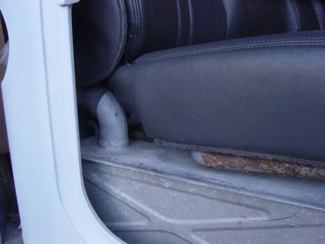

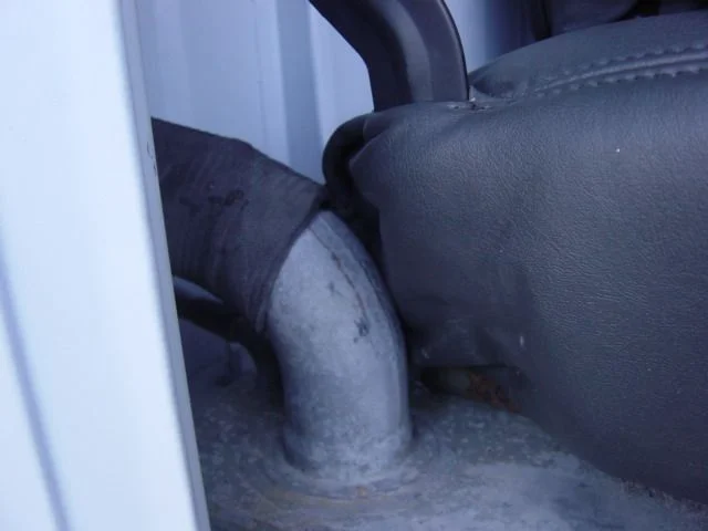

fuel neck
No, no problems with the fuel neck. I reset the mock up and took some more shots to better show how the seats fit. Since nothing is bolted down in these shots, the cab back panel skewed a little bit, but that is only because I didnt have it fastened, not the seats fault....
