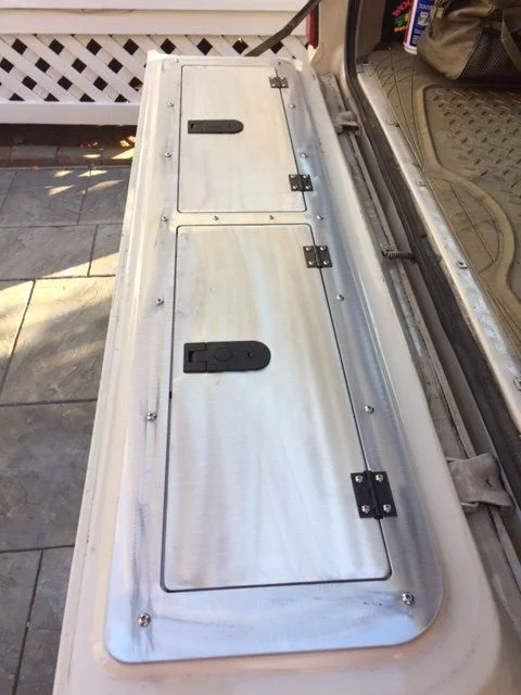

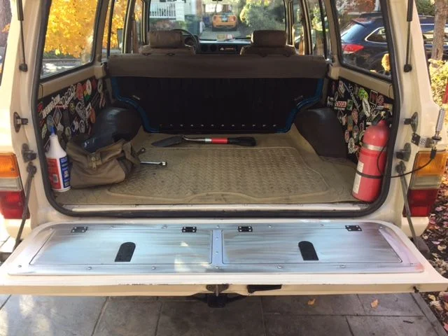

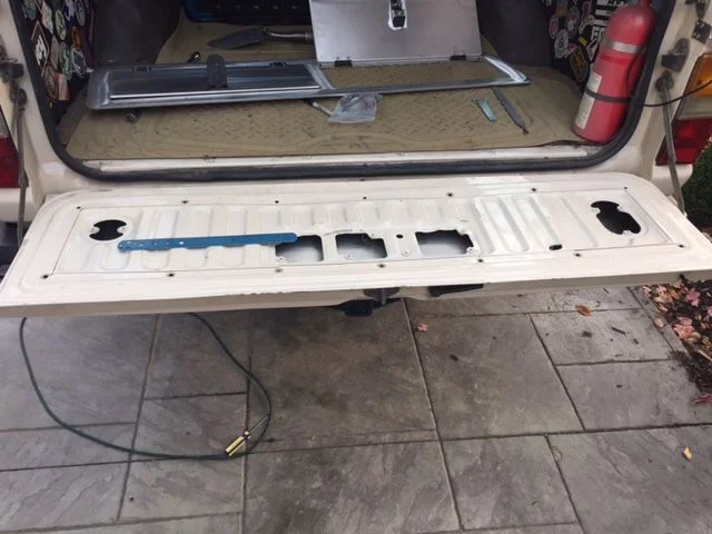

I just installed Jason's lid in my '84 FJ60. When I receive the item it was far more robust that I had imagined it would be. I was very impressed by the quality of the construction. The installation was fairly easy you can see in the image below how the measurements progressed. A good angle grinder with a cutting disc made short work of the sheet metal and cross braces. I cleaned everything up with my grinding disc. Then it was just a matter of test fitting, grinding, test fitting grinding, etc... I followed Jason's advice of installing all the bolts, then tightening everything down in a cross pattern (like cylinder head bolts) to avoid warping the metal. All told it took about an hour and the results are fantastic. Because the lid is so overbuilt, the structure of the tailgate now feels more solid. I was concerned that taking the cross braces out would be an issue, but it certainly feels far more sturdy then before when you try to bend or warp the metal. I gave it a good sit test and my daughter gave it the kid jump test and, again, it felt very solid.
As far as extra storage space, it doesn't give much extra room. I currently have my snatch strap, four ratchet straps, and three small bags of spare bolts and tools. My main tool kit won't fit (see pics). I still have extra space and I'm thinking it's just a matter of rearranging things and maybe streamlining my tools. I may still pull it out and paint it, but I was so impressed with the machining on the aluminum, I wanted to show it off.
All in all, I couldn't be happier. It was money well spent.
