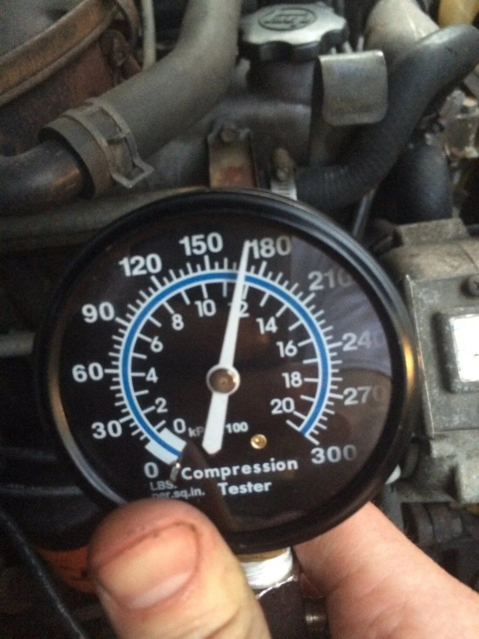

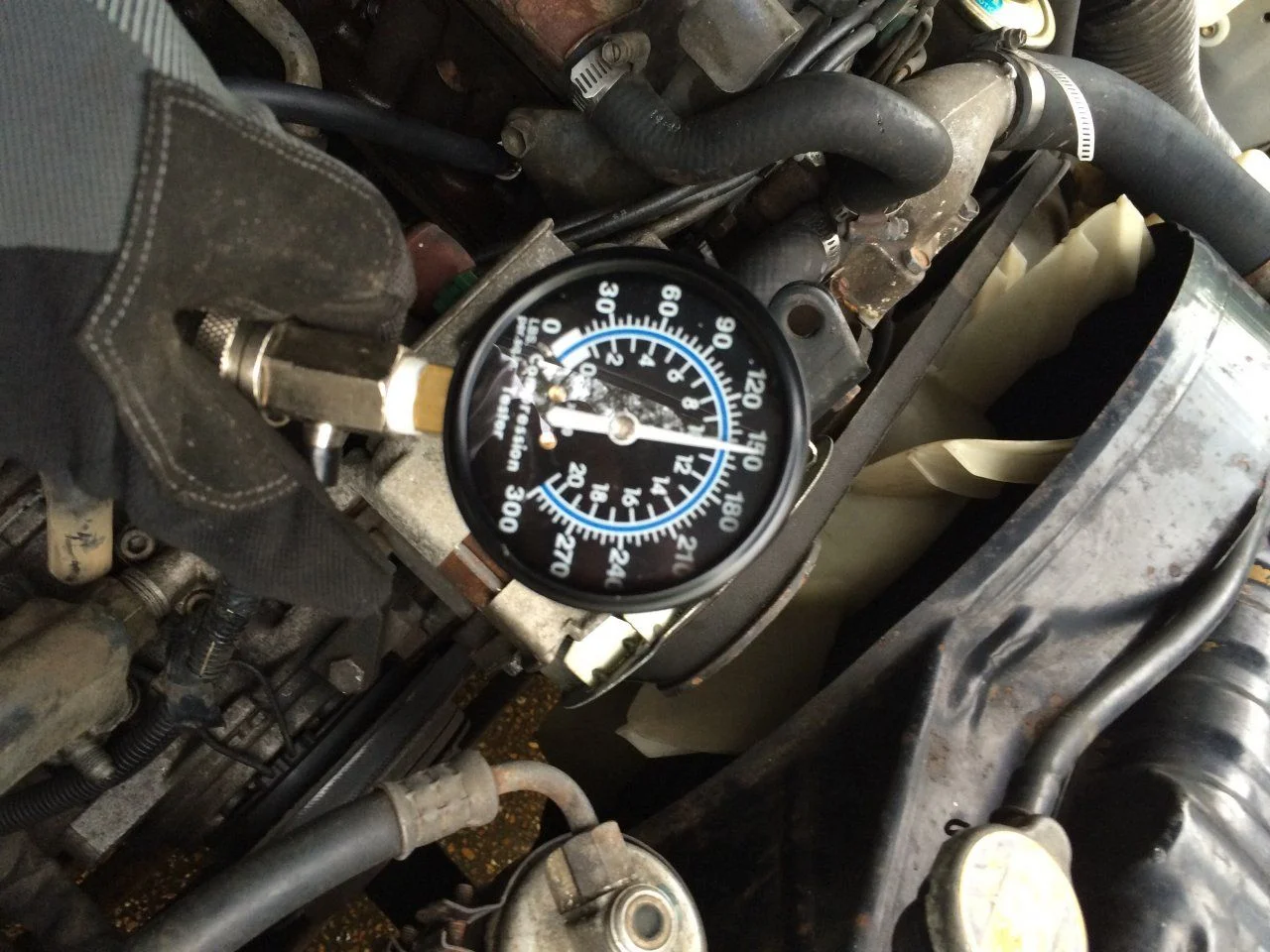

I bought this for the body and clean interior, and not the 2F (although it does have low miles). So, going to do a compression test on my engine this afternoon and see if she is worthy of cooling parts and such. Will post up results.
did a compression test tonight, because I was tthinking about putting some miles and upgrades (h55f) on the 2f before ultimately swapping to a v8. Of course cylinders 1-5 were dialed in, if not a bit high but it was more than warmed up when I did it (150 dry; 155-160 wet).
Wet
Cylinder 6 maxed out at 100 dry and 110 wet. My high tech oil injector
I squirted some fogging oil in the cylinder, and got it to move up to 115 and change. Still way off the other readings.

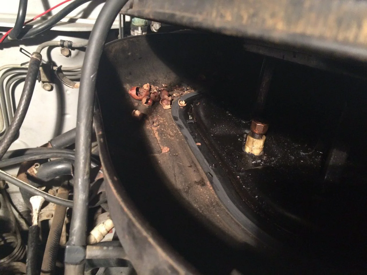

Plugs were all pretty smoked out white:
Changed all those out.
Checked out the air filter while I was noodling around (dirty and will order a new one), and cleaned up after the former residents:

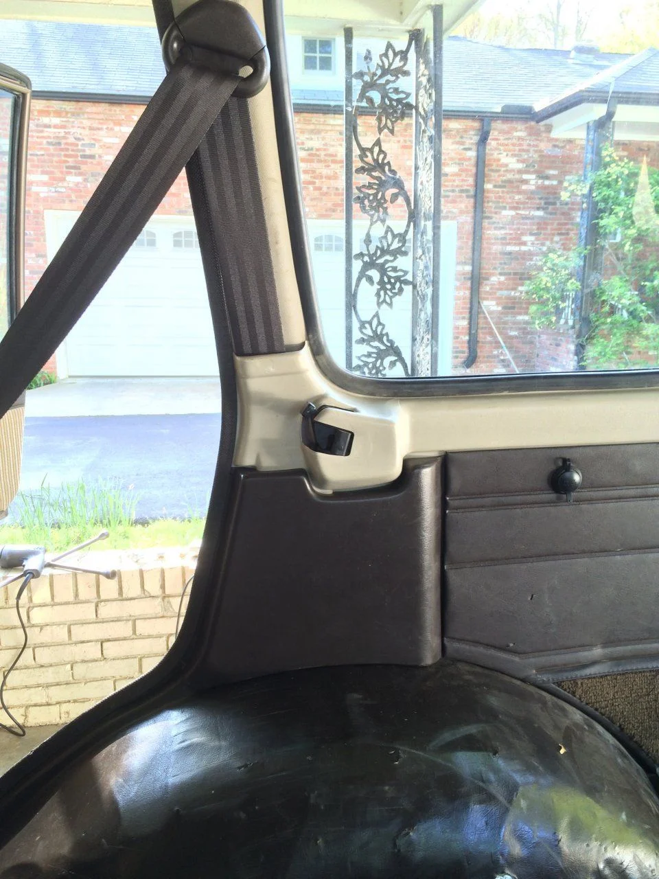

Me an' BillRiiiley survived with just lap belts in the back seat, but my wife insists that our kids need shoulder belts and a booster seat.
So, I purchased rear belts and trim pieces (several years ago) from an FJ62, and am finally putting them in.
I used this thread for instructions: https://forum.ih8mud.com/threads/fj62-rear-shoulder-belts-in-fj60.295136/

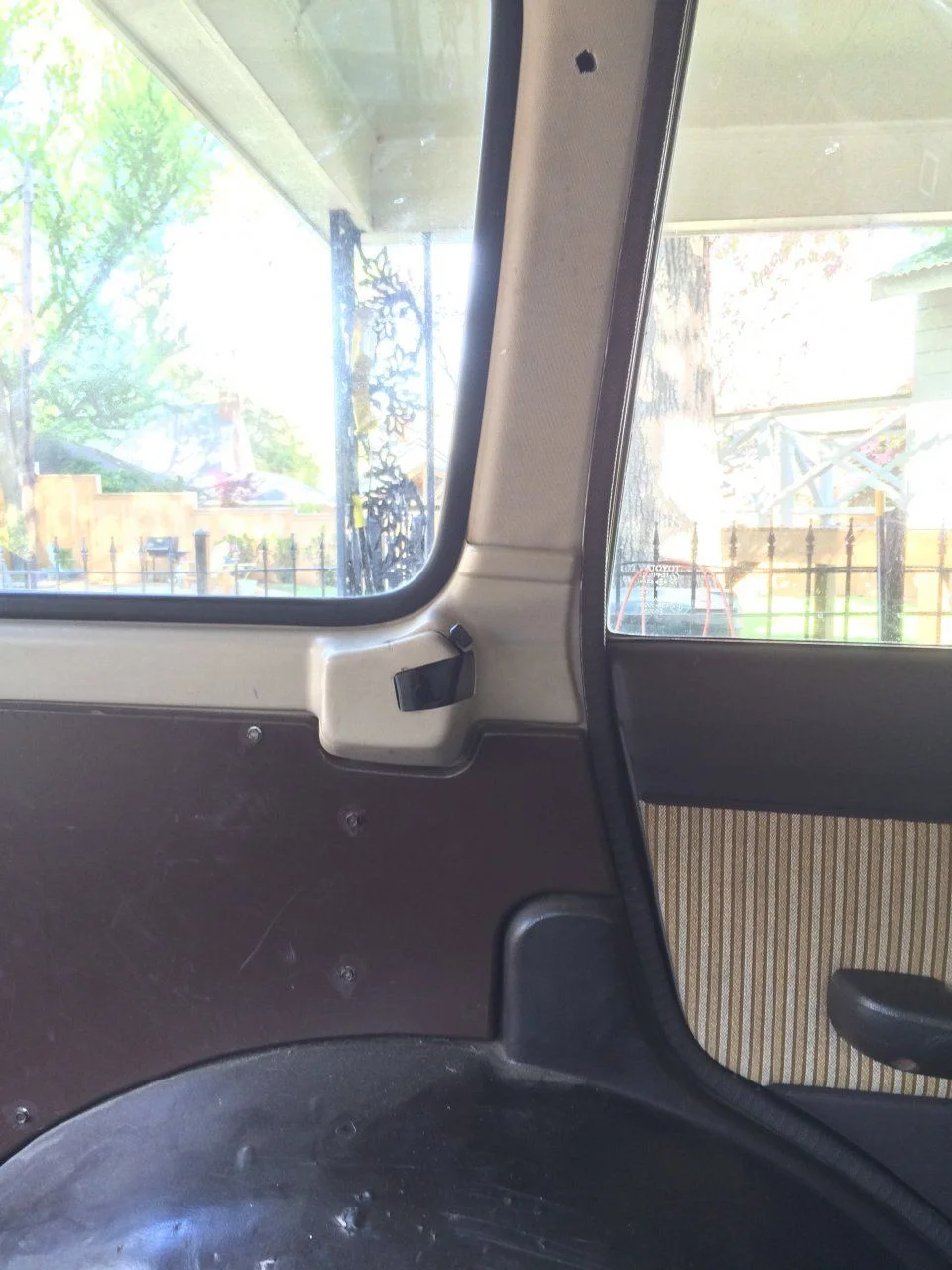

Here's the driver's side, not yet done, for reference...
And the finished passenger side...
Well then....
There are also other nice predrilled holes in the 60 that allow 62 parts to be inserted.
