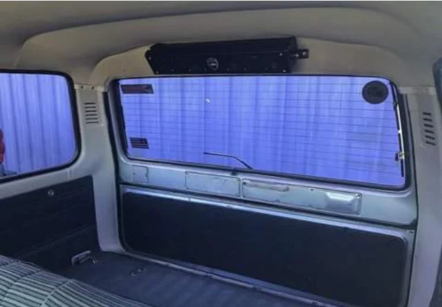

I had 5.25” speakers installed in the front so I could keep my factory speaker covers. I also had a Wet Sounds sound bar installed in the rear above the hatch. It sounds great! Note the period correct purple tint ..

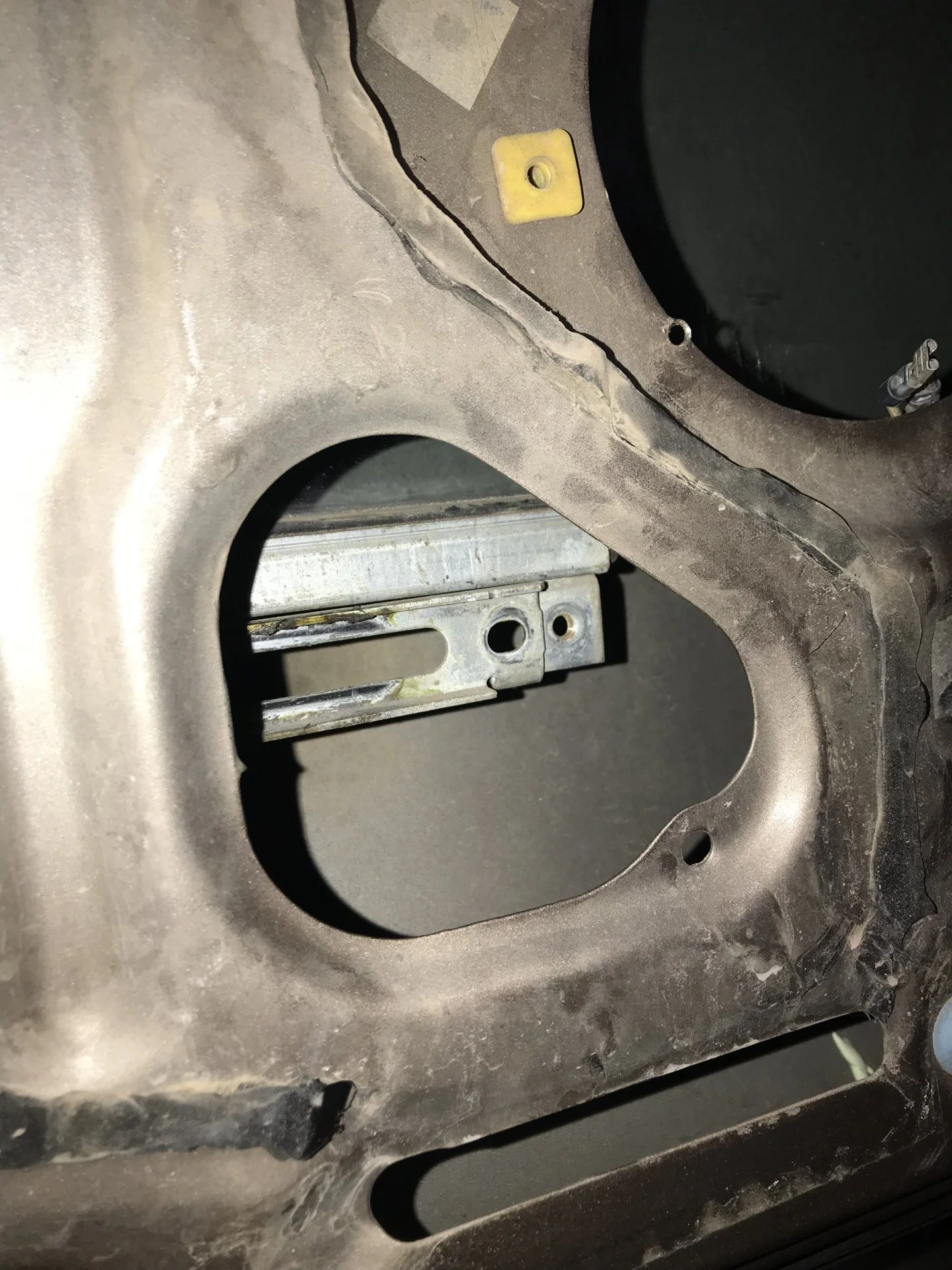

Spent an exorbitant amount of time time trying to install the front door windows back into the doors. Is there a special trick to getting things lined up?
With the window regulator all the way, the window bolts won’t line up with the regular bolt holes. I rolled the regulator about 3/4 of the way up and I can put the bolts in but the window will not go down, feels like the regulator is binding. It just seems so simple but I know I’m doing something wrong.
Some of the bolts are shorter than the others. You may have a long bolt keeping the window from going down.
I’m an idiot with these windows. Just figured out that the bottom track in the regulator slides to line up with the window holes.
Slid the track over Bolted it in and goes up and down perfectly. Learn something new every day.
